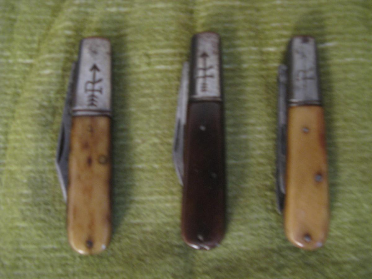

Here are my 3 Russells - the one on the left is the fake - but an old fake - notice the pins.
Thats a good looking old knife, Ken, thanks for posting a photo, amazingly Russell looking in other ways. I would be curious to see the knives with main blades open to the half stop, showing the tank marks. And also curious if you can see any saw marks, which way they go?

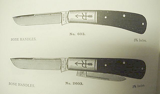

Here is a catalog cut Steve :wink:
I have a single blade Iron handle Russell Barlow that has a long match striker pull somewhere ::nod::

a couple more catalog pics, listing white bone, brown bone, and showing sawcuts in both directions. Descriptions include, Iron Lined Steel Bolster, Steel Lined Heavy Steel Bolster

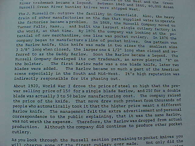

15 cent Russell barlow. Hope this is clear enough to read.
