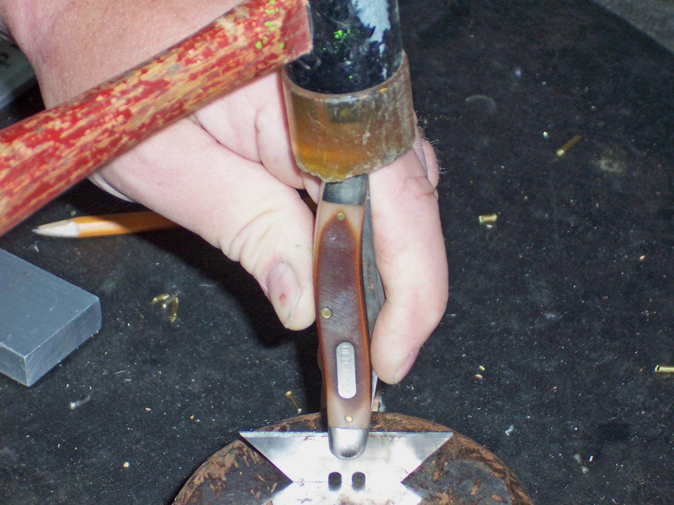

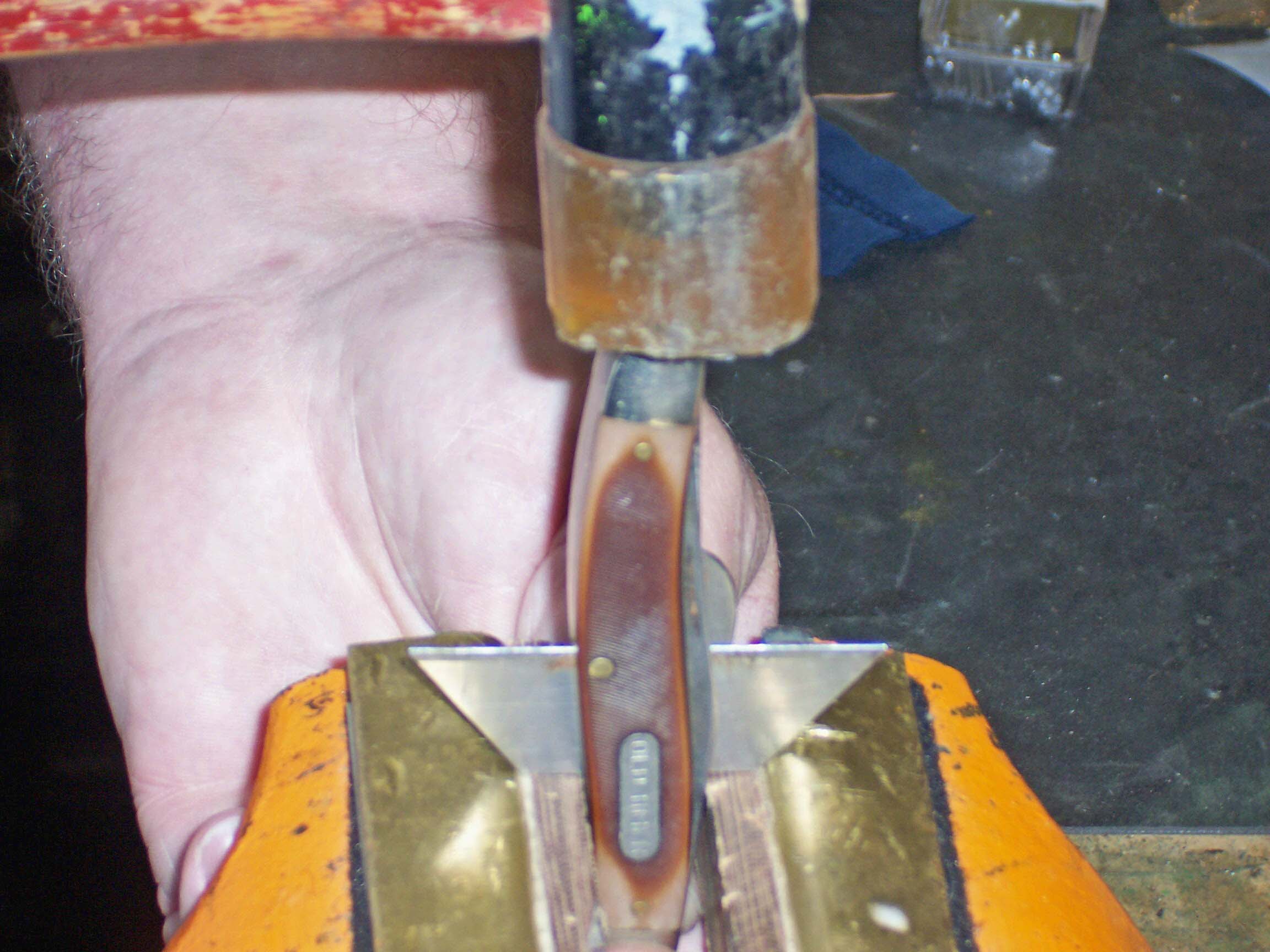

Step 1- Position a heavy duty disposable razor blade between the blade & liner. If the knife is multi-bladed, place the razor blade as close to the center of the knife as possible. Be sure that the razor blade does not bite into the liner, but runs parallel between the liner & blade.
Step 2- Tap the rear bolster of the knife with a soft-faced hammer to avoid damaging the bolster.
Step 3- After cutting the first pin, continue on to cut the rocker pin. On this step I moved the knife to where it is suspended between the canvas Micarta faces of my vise, so that the sides of the knife can pass on either side of the razor blade, & the between the jaws of the vise.
Step 4- Continue tapping the razor through the last pin. Be careful and don't hit it too hard or pieces of knife can fly in all directions. Just tap lightly & the knife will fall apart.

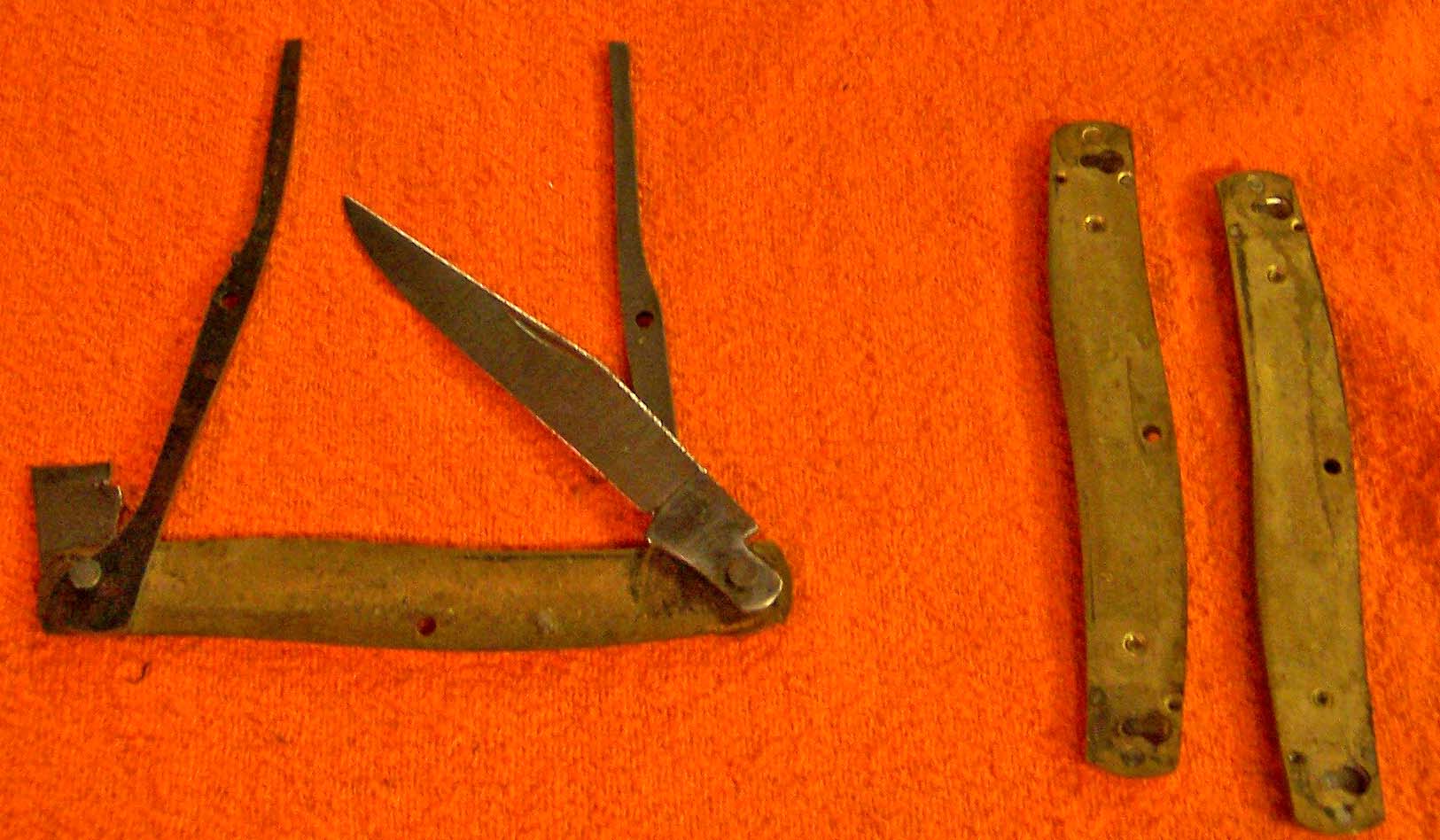

If you were just looking for a pic of a Swinden type knife apart, with rivets intact, then I also have such a pic.
Note:
It was a Muskrat pattern, 77OT, with a broken blade.
Hope this helps,
Note:
Hope this helps,
