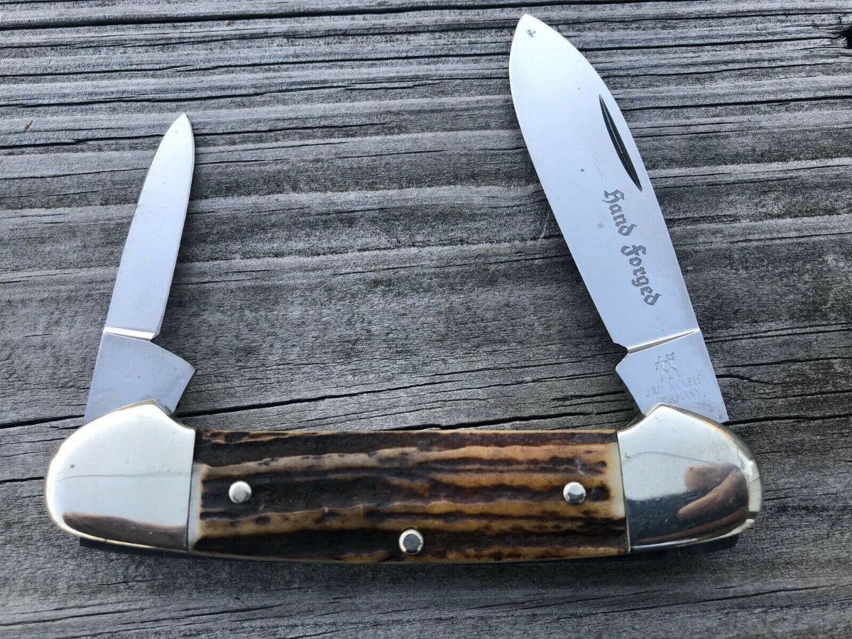

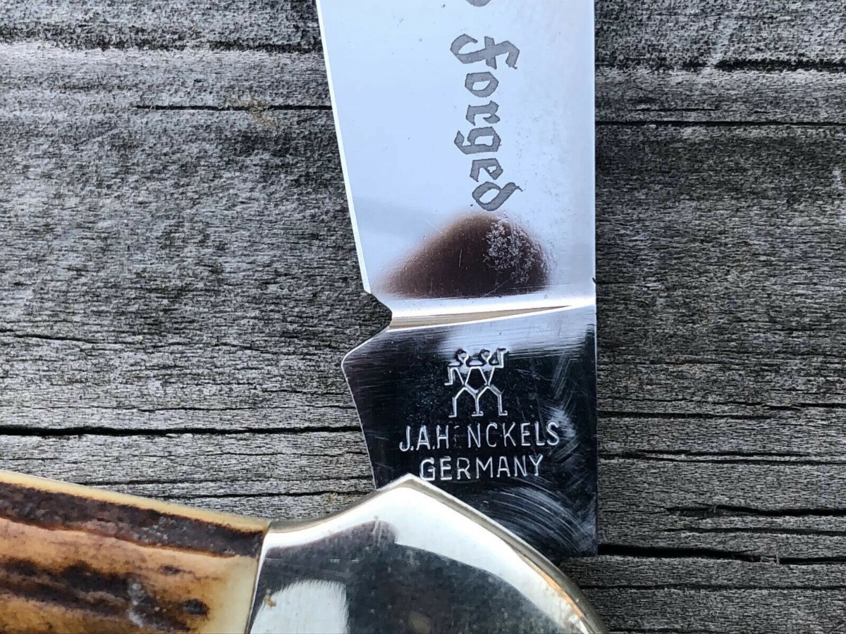

I was searching eBay for Henckels this morning and came across this nice looking stag canoe. The stag is perfect front and back. The seller does not mention any buffing or repairs to this knife but I’m pretty sure that, from the close up photo, this knife has been buffed. My questions are, does this look buffed to anyone else? If buffed, then did some one etch the main blade with the words “hand forged” after the buffing? Does the etching “hand forged” look odd to anyone else? What is the age of this knife? And how would this have such great stag if it was old and in bad shape with buffed blades? Other than being reworked? Very curious about this one. Here is the link: https://www.ebay.com/itm/VINTAGE-GERMAN ... 0667.m2042.

Looks original 1970's vintage to me. If buffed the etch would be gone. And I highly doubt it was re etched. This is a common font for German etches. Most German knives had good stag up into the 1990's. JMHO.

That canoe looks exactly like a Boker to me. I have a Henckels trapper that is identical in every way to a Boker trapper. I think Boker made all the more recent Henckels knives, but don't know for sure. Read the info under the Henckels for sale forum on this site.

I know Boker made Knives for Henckels. It’s interesting that he has an A.G. Russell stag canoe from Germany that looks identical to this. Do you guys not see that rough surface under the shiny on the close up in the second photo? That looks like it’s been buffed plus all those marks on the tang that go in a different direction than it would be marked from opening and closing. On other photos you can see rough under the shiny in other locations also.
It’s hard sometimes to tell without seeing it up close in person, that’s why I am asking. I like this a lot if it’s not been buffed and may bid on it.

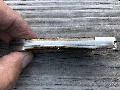

To me it looks like there was some pitting on the blade between the word Forged and the blade tang.
On the EBay pics listed with the item there appears to be a significant gap between the pin heads and the stag;
I know absolutely nothing about these knives, but the pin in that photo doesn’t look like it was properly spun (or peened). I wouldn’t expect to see those types of gaps in a factory knife. It just seems a little “wonky”.
Just my 2 cents worth.
Jeff
Hey … it’s a pocketknife for gosh sakes. I’m not selling the Mona Lisa….Bullitt4001

Jeffinn wrote: Tue Nov 12, 2019 3:08 am To me it looks like there was some pitting on the blade between the word Forged and the blade tang.
I know absolutely nothing about these knives, but the pin in that photo doesn’t look like it was properly spun (or peeled). I wouldn’t expect to see those types of gaps in a factory knife. It just seems a little “wonky”.
Jeff
Thanks Jeff, I noticed those pins too and that made me think it had been rehandled as well. Whoever did it has done a great job of picking nice stag for these. The A.G. Russell he is also offering has those same looking pins on it as well and the stag looks terrific too.
I worries me that he says these are mint and I don’t think they are.

This knife is all original, made by Boker for Henckels some time between about 1970-2000. It is common for handle pins to be proud on German made stag handled knives.
Very good looking knife, about the best i have seen of these 'Henckels' with the "Hand Forged' etch.

I can add nothing to what has been said. But I will say it looks good to me, that is to say from the older solingen knives I’ve had I see nothing wrong with it. It’s a real looker.
