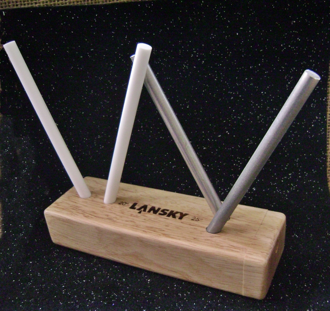

I tried freehand and scratched up some blades pretty bad. That was with a Smiths Tri-stone.
I have and tried a clamp type system similar to the Lansky rod system. I don't like the clamp. As has been said, there can be problems keeping the blade clamped.
I now have the Lansky Turnbox 2D2C. It has 2 diamond coated rods (medium grit) and 2 ceramic rods (fine). I insert the rods in the 20° holes for pocket knives, 25° holes for kitchen knives. Once the rods are inserted, they are at the optimum angle. Hold the blade straight and sweep it down the rod for one side, back to the top of the other rod for the other side of the blade edge. Arm hair shaving sharp in no time.

I just got one of those a couple of weeks ago. Haven't really done much on it yet.Steve Warden wrote: I now have the Lansky Turnbox 2D2C.

Even handles the small blades many seem to have trouble with.jerryd6818 wrote:I just got one of those a couple of weeks ago. Haven't really done much on it yet.Steve Warden wrote: I now have the Lansky Turnbox 2D2C.

Steve, that looks a lot like the old Steamboat Sharpener I used to have. But it was 4 ceramic rods. Worked great for touch ups.

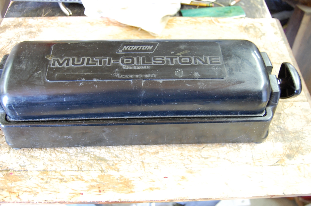

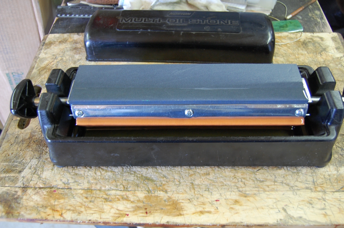

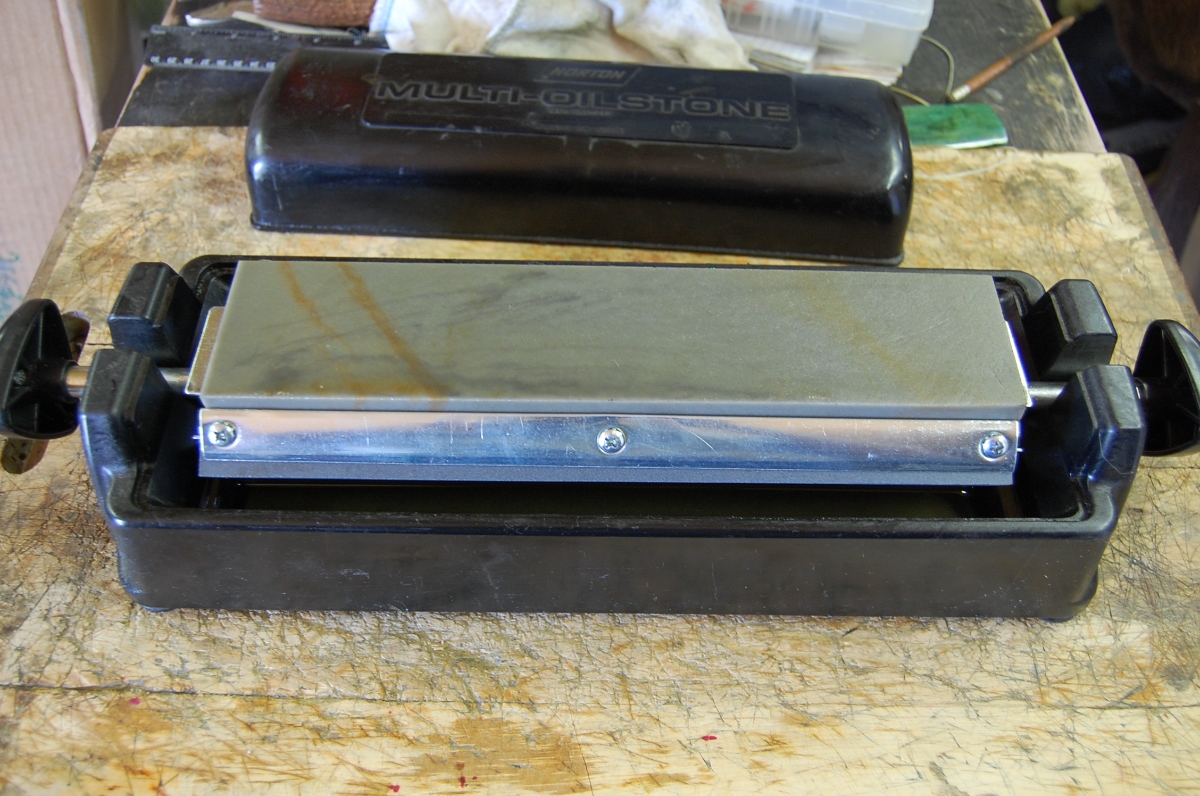

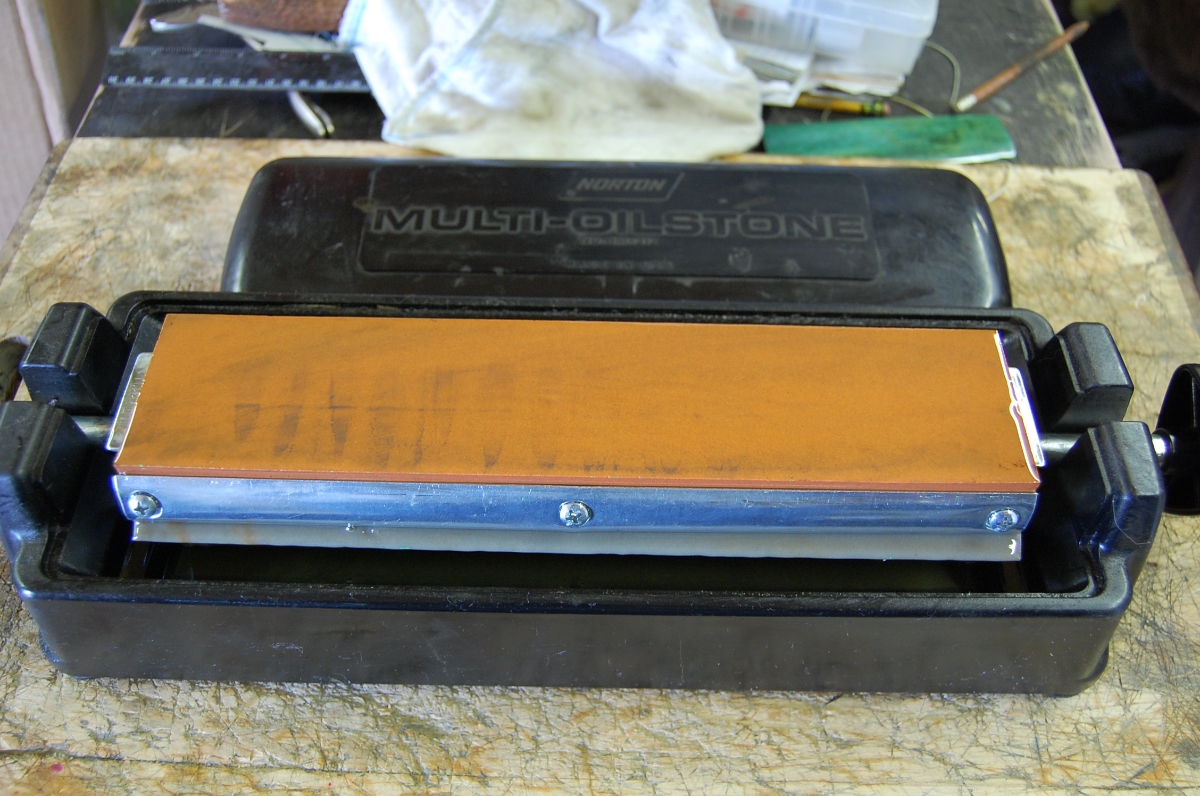

Guys, I've probably got more sharpening "systems' than most and it seems like I always go back to my Norton 3 stones in oil system. I have a course , medium, and a hard Arkansas stone in it. works for me. Terry
If it ain't broke, don't fix it!

That is a nice looking sharpening station you have, Terry.
That seems like a very worthwhile tool for sharpening as are the others mentioned. Of the systems mentioned, I like that one the best.

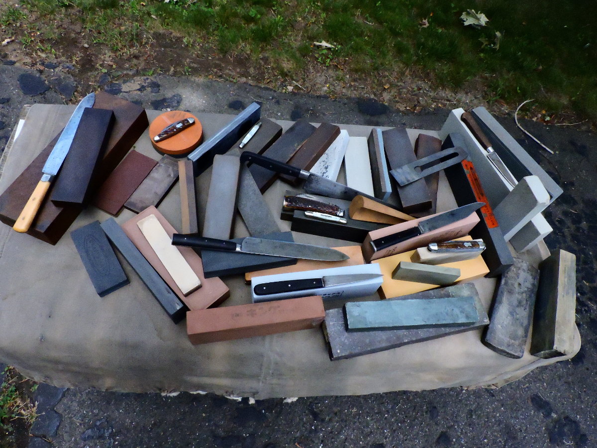

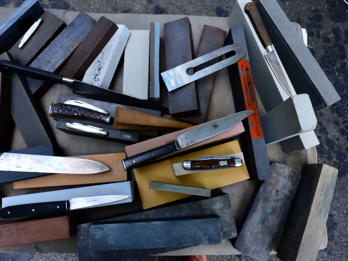

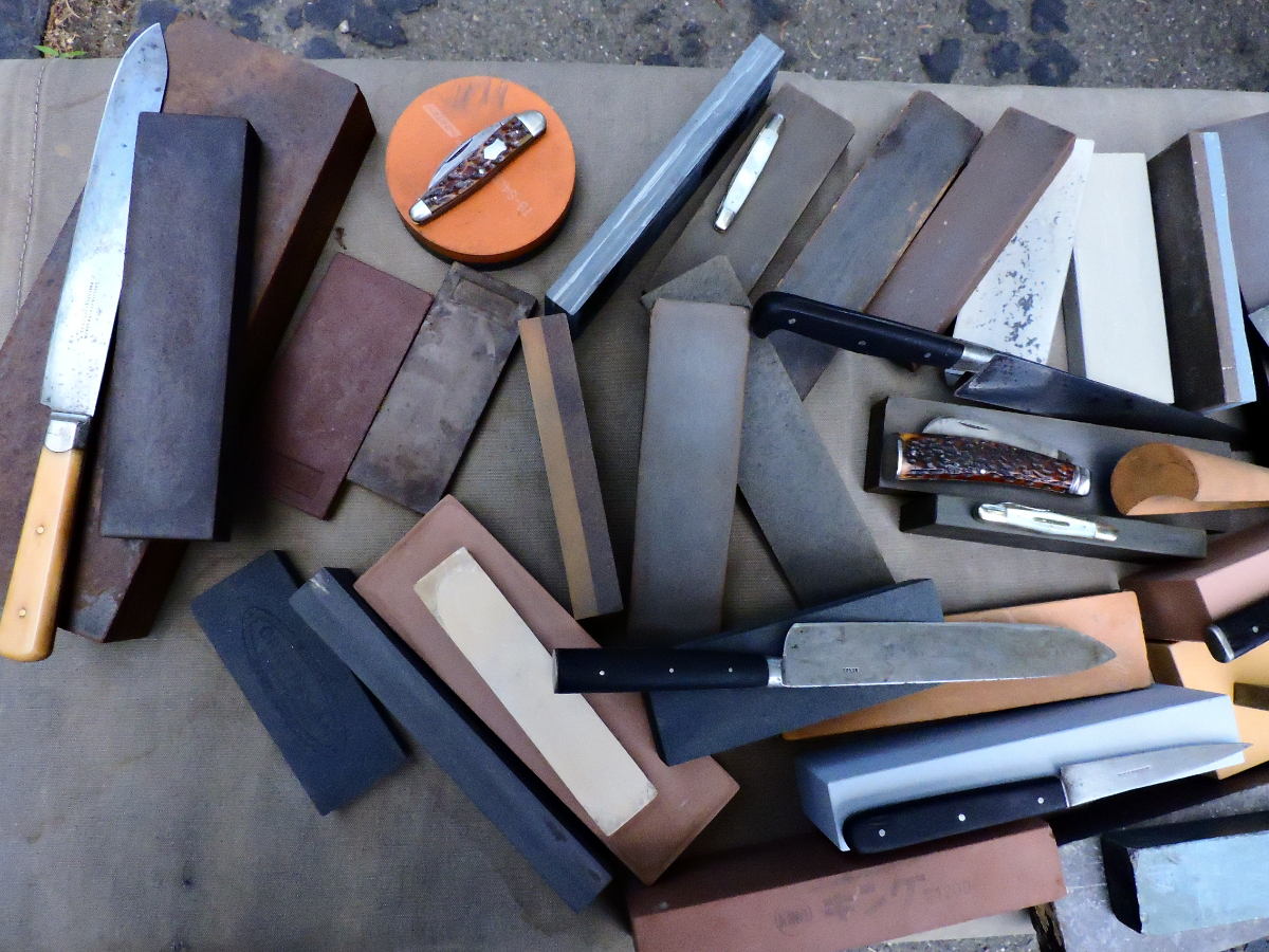

Personally, I've always been a fan of the loose stone. They are quit portable and you can use both sides and the edges if you choose.
Here are most of my "sharpening systems".
For the most part I like the water stones but any of these are available to me by a mere reach.
I wish I knew more about Belgium water stones. I think I have four of them. In using them I think I get remarkable results.
I hope my imagination isn't playing tricks on me. For all I know they could be chunks of some paving stone.
I hope that's not the case.

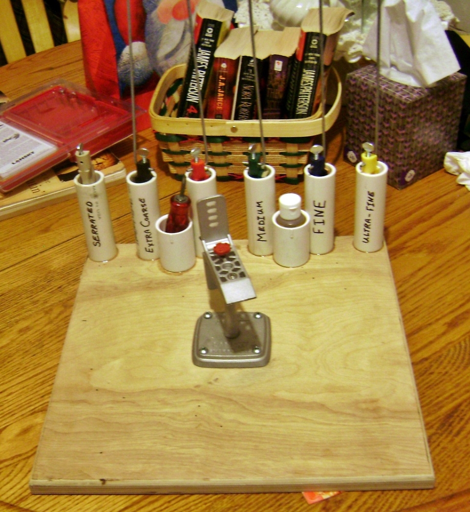

I don't know about you guys but in my experience, there just are not a lot of people who have a clue about sharpening a blade. I mean people that hunt and fish, etc let alone just take on average kitchen duty. I think the sharpening systems available these days are great but make no mistake, they ain't magic. You really need a good working understanding of the way an edge is formed or you're setting yourself up for frustration and failure even with what appears to be the most fool proof system. I prefer free hand sharpening. It takes a lot of practice but to me is much more satisfying and let's face it, this is a hobby. I' must own 15-20 various stones and when I'm in the mood I'll happily do a 4-5-6 stone progression depending on the steel just because, I can. I've got a TSProf system that I use on recurves and other funky shapes and I love it. But I much prefer free hand sharpening. as others have said, to each his own. If you can make it sharp to your satisfaction, what else is there to say.
-the problem with society today is, no one drinks from the skulls of their dead enemies anymore..-

I think you've got it exactly right Cletus.Cletus Awreetus wrote:I don't know about you guys but in my experience, there just are not a lot of people who have a clue about sharpening a blade. I mean people that hunt and fish, etc let alone just take on average kitchen duty. I think the sharpening systems available these days are great but make no mistake, they ain't magic. You really need a good working understanding of the way an edge is formed or you're setting yourself up for frustration and failure even with what appears to be the most fool proof system.

Had to Google that one. DANG that looks complicated!Cletus Awreetus wrote: I've got a TSProf system that I use on recurves and other funky shapes and I love it.
Pricey, too .. ... ..
