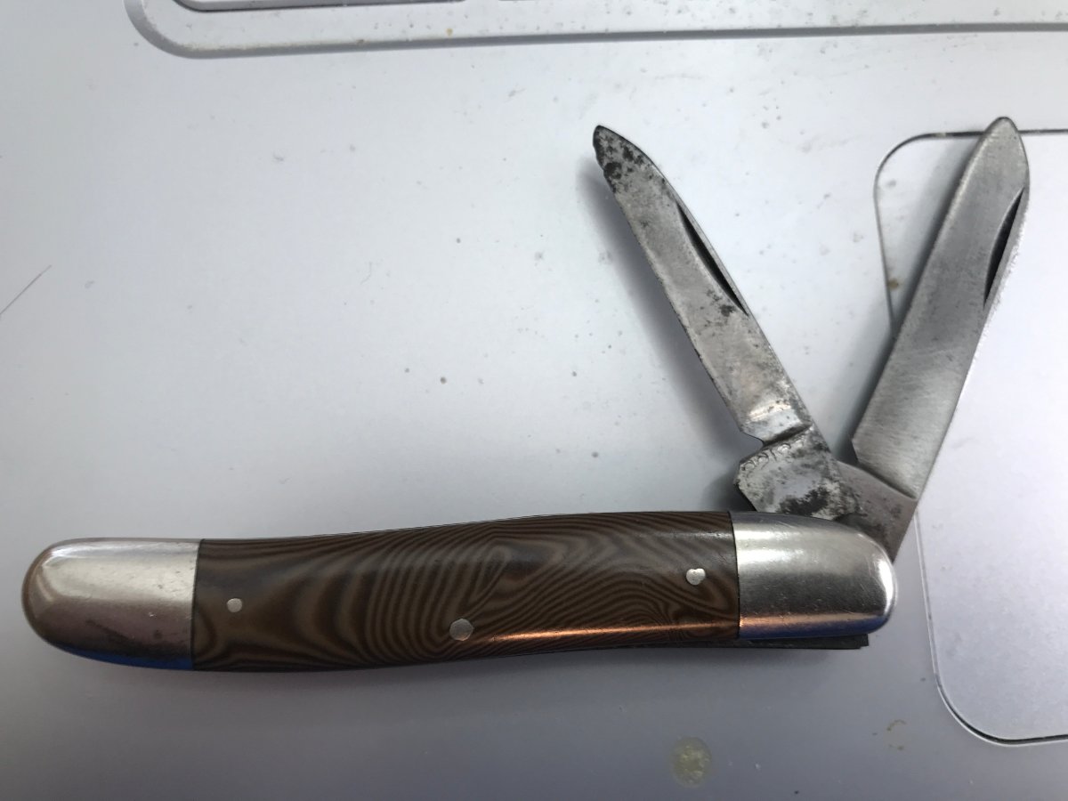

I picked this knife up today it is really nice condition but the knife model is not legible due to a poor stamp. Can anyone tell me what model it is and what this celluloid material was called?

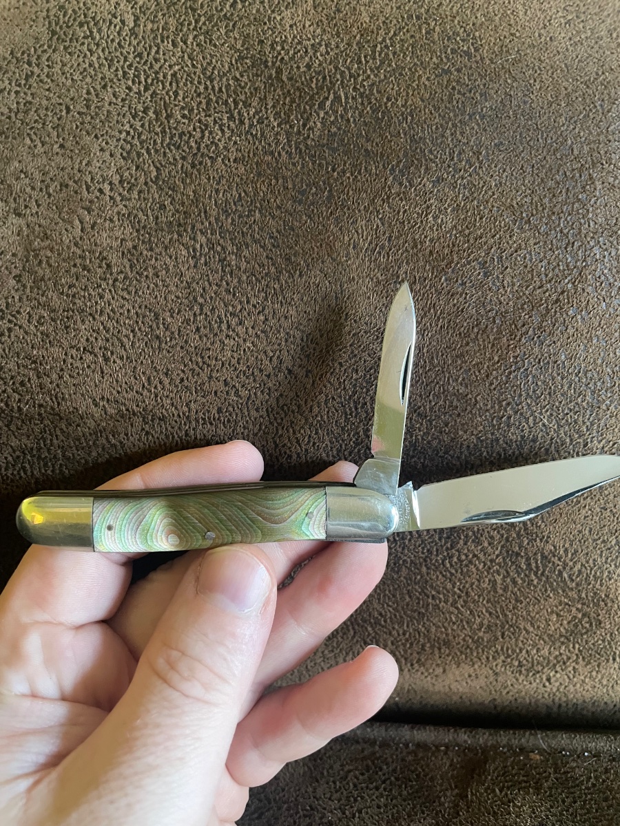

Red: I have the same knife with the same handle material and a spear blade and it is stamped 22187. The 2's indicate 2 blades and 2 bolsters. The 18 is a "serpentine stock jack". The fifth number should be a 4 on both yours and mine for that handle material, celluloid. The C denotes the "clip" main blade.
I can't see the fifth number in your stamp but it doesn't look like a 4. So, it's a bit of a mystery. Maybe factory mistakes?
The handle codes(5th digit) are:
0=metal or iron, 5=genuine stag
1=white fiberloid, 6=ebony
2=French pearl/tortoise shell, 7=cocoabolo
3=genuine pearl , 8=white bone
4=celluloid/colored fiberloid, 9=bone, Rogers jigged
Anyway, it's a nice knife in nice condition and I've seen number variations before. Good luck with it. J.O'.

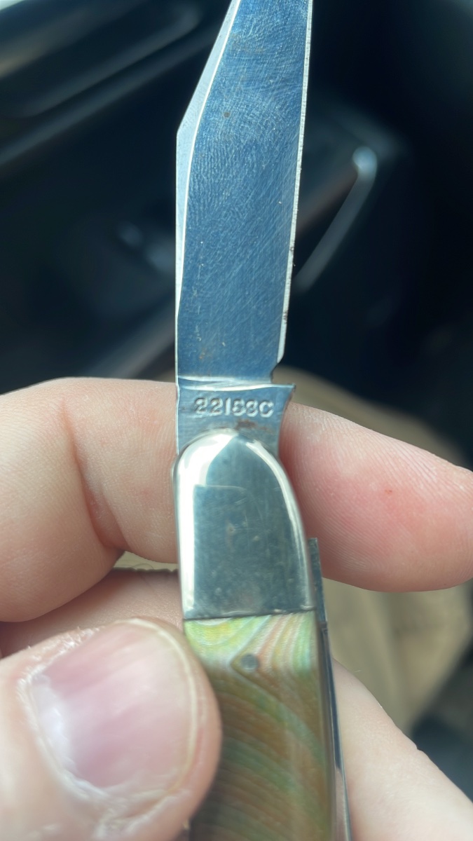

Thank you for your response! I have looked in ever reference guide I have as well as plenty of internet research. Unless the knife is stamped wrong I don’t think it exists😂. It appears to me to say 22158C but the 5 and 8 are not good stamps at all.
