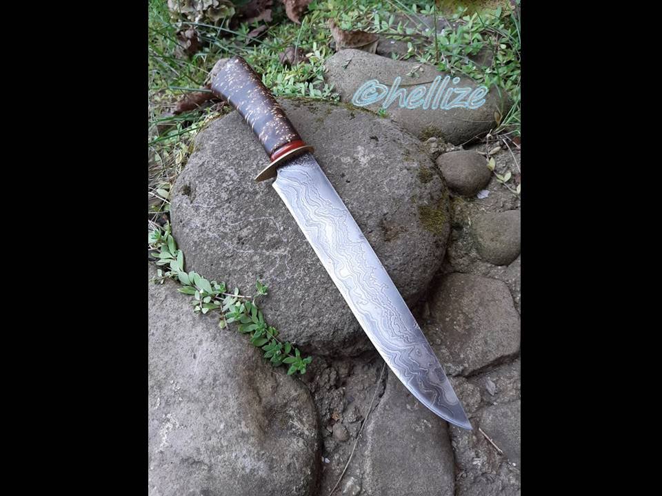

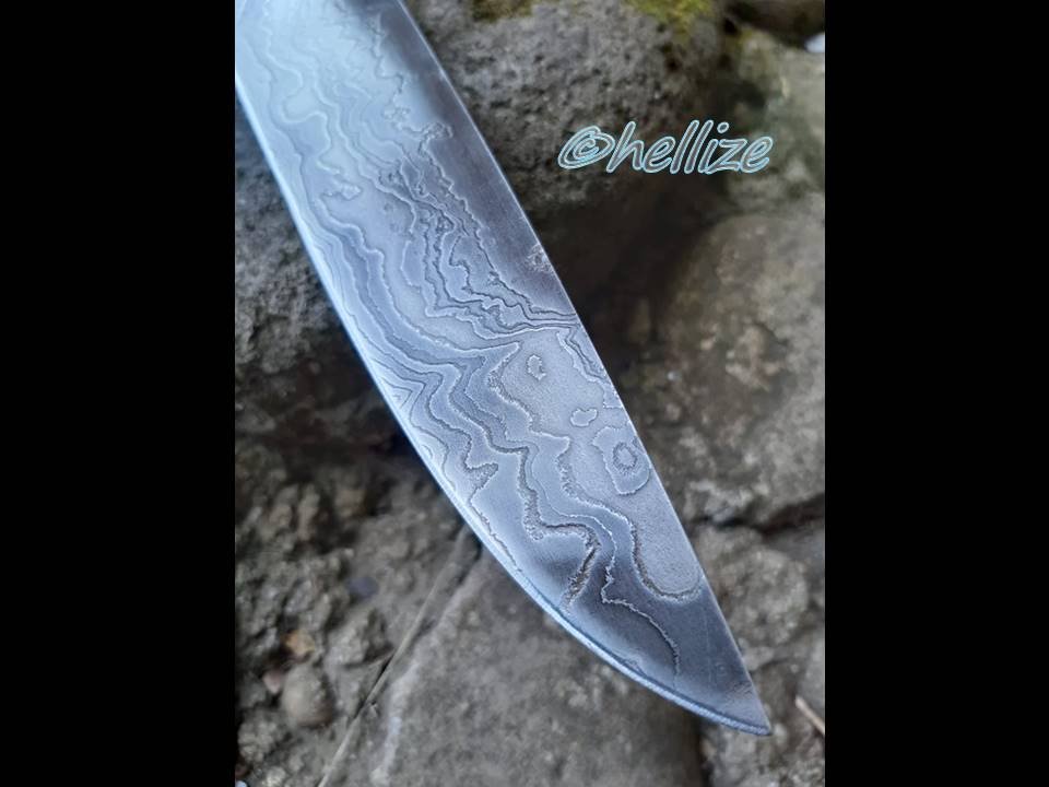

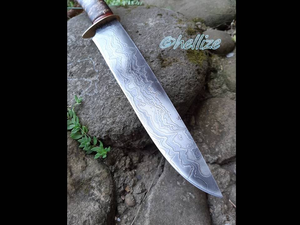

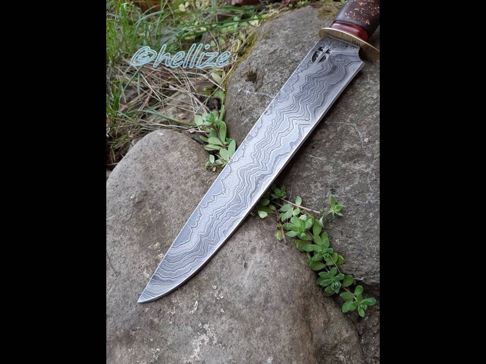

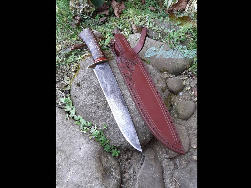

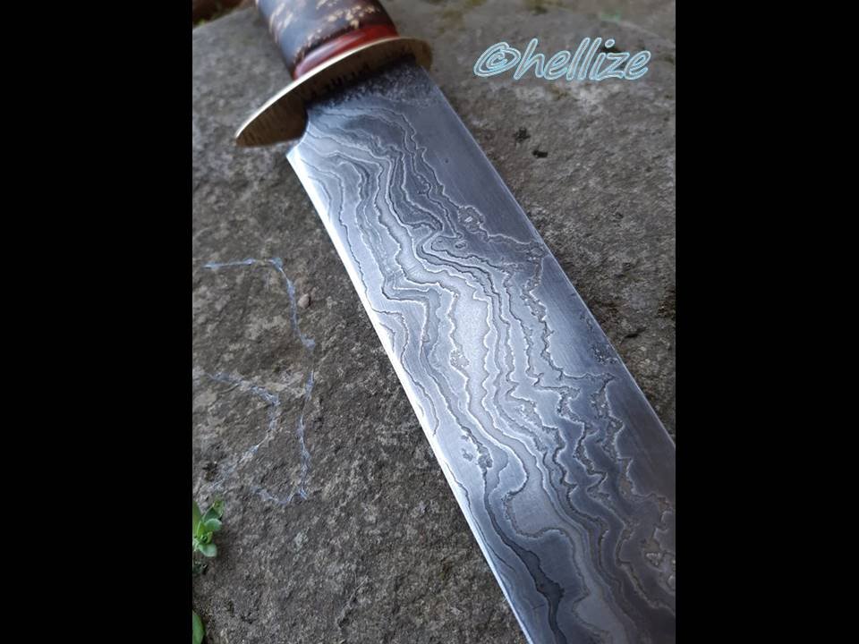

Hello

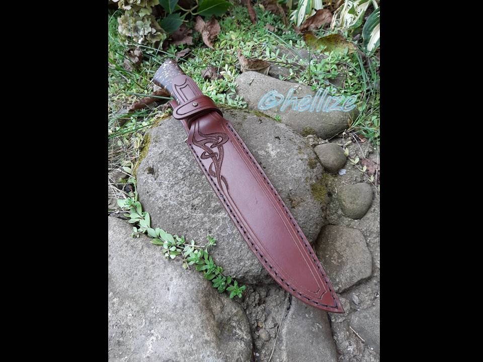

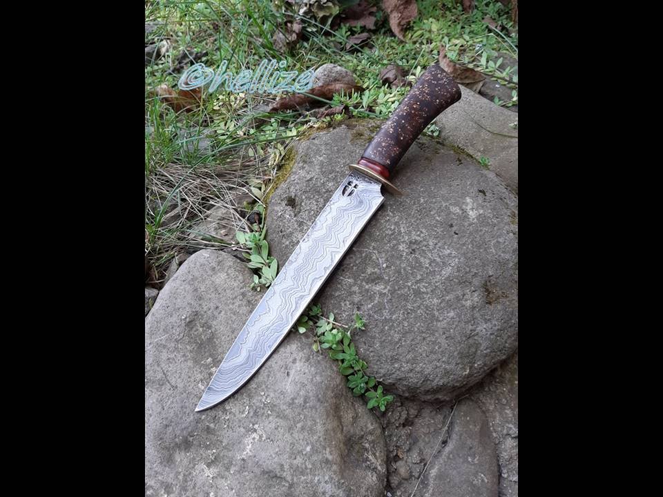

It is 37 cm long, the blade is 23.5 cm long, 4.1 cm wide and 4 mm thick.

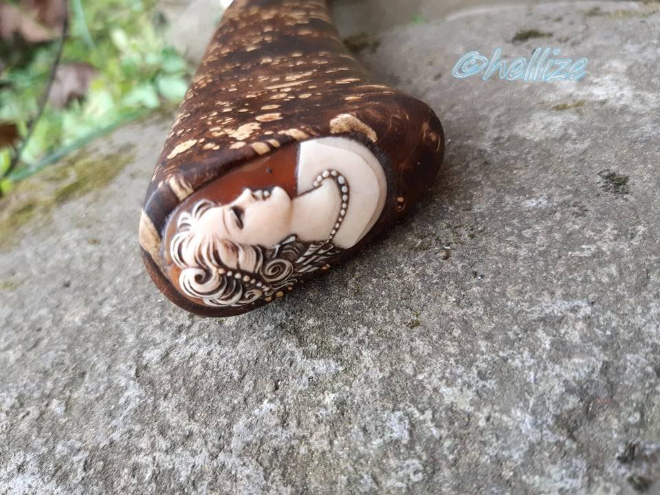

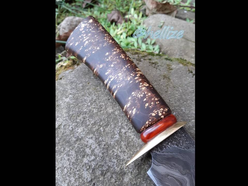

It has stabilized burl handle and bronze crossguard with a bit of crimson resin and ancient camee at its end.
The damascus blade has been forged of 5160, 1.2516 and L6 with around 70 layers.
The sheath is made of thick cowhide.

That is so cool, and that Cameo . . . I just can't find the words . . .

Love the blade, love the burl, love the brass, love the Cameo, great work!!!! ::nod:: ::nod:: ::tu:: ::tu::

Absolutely gorgeous creation Csizmar! The cameo pommel puts it over the top!! ::tu:: ::tu:: ::tu:: ::tu::

Wow! Almost speechless. This might be your best ever!

I love the size of your masterpiece! It has such form and balance! VERY nice!

That is a very fine knife, Hellize. I like the Cameo, it really is a special touch. But...If you smash something in the head with the pommel, the cameo might be damaged!

Dinadan wrote: Sat Oct 09, 2021 12:33 am That is a very fine knife, Hellize. I like the Cameo, it really is a special touch. But...If you smash something in the head with the pommel, the cameo might be damaged!
Thanks! :)
But without it, the handle would suffer damage either way. This is just not that kind of a knife ;)
I did make knives before with reinforced handles with iron or brass caps for such things.
