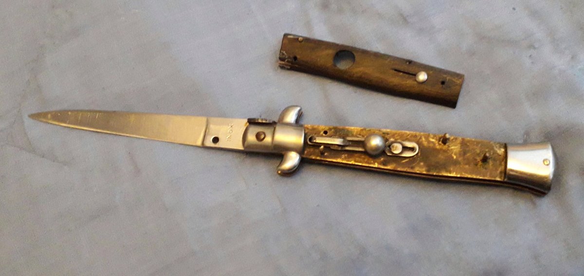

Hi guys , ok i got this old horn handled switchblade as a gift for doing some work on a friends knife , it doesnt work 100% but im going to dismantle it and re build it , now these are iligal to carry in the uk and ive not owned one since the 80's and they was illegal then as well i think , so all it says is INOX (stainless steel) on the blade , what era would you think this is from ? I was thinking possibly 60's 70's ? Ill take more pics as i repair it

It has the most modern button setup , I’m not exactly sure when this was implemented ,,,,probably 70/80s >

It's a cool little knife to bring back to life Paul. From what I can see it appears to be a swivel bolster release model and the liners aren't "D" stamped, as well as it having a flat-grind blade, so it appears to be a newer model from after 1962, but those observations are only my opinion, wait for Bill D. to see it and he give you more accurate information. It'll be fun watching you re-build this knife Paul, please keep us posted along with pictures!

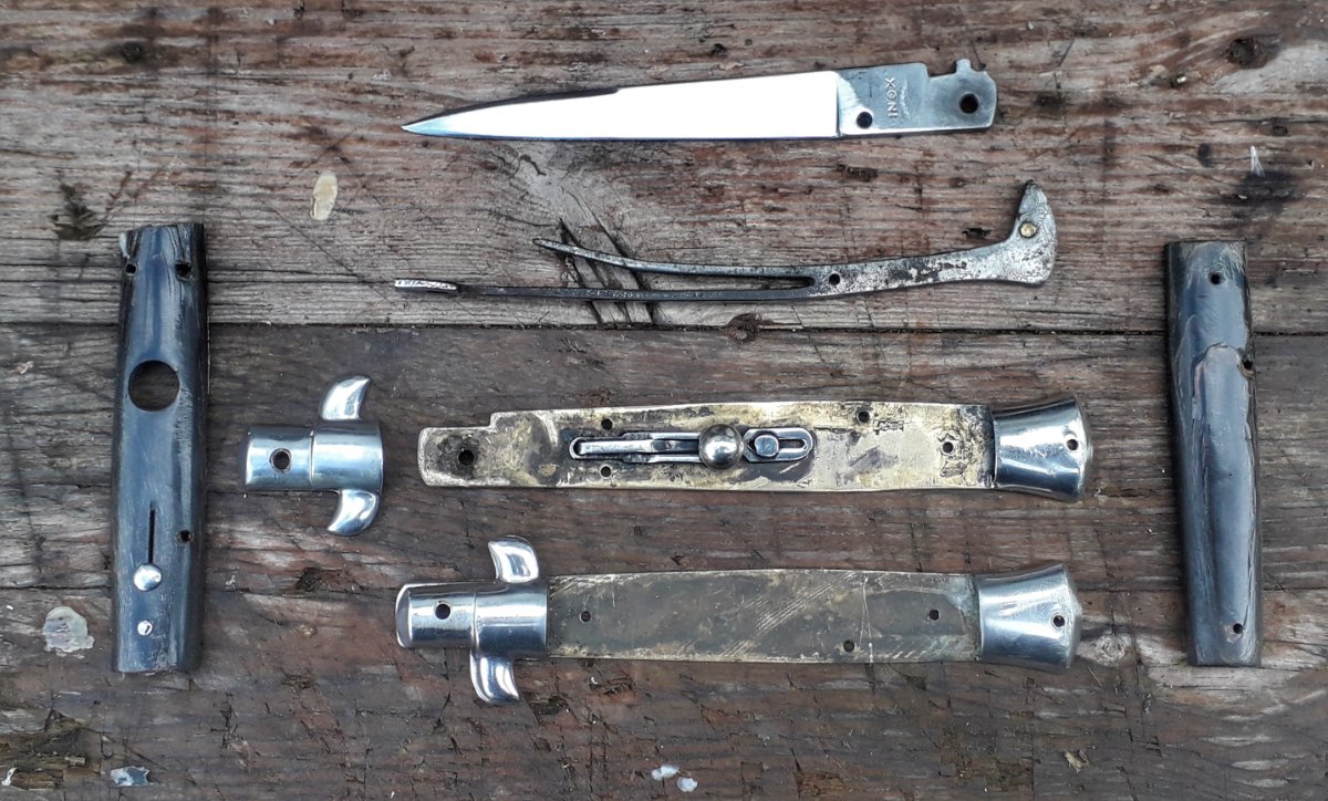

Well thats it broken down , im going to put Stag scsles on it will need a good clean and possibly ill need to make a new button side liner as the pin hole has worn so the blade doesnt close all the way in

This will be a great project Paul. If the blade is peeking you definitely should build a new liner, cuz the peeking will bother you to no end if you don't correct it. This is just a suggestion and haven't tried it myself, but, I'm wondering if you could put a drop of solder in the existing catch-hole and then drill a new hole into the solder. I know this has been done for pivot holes, but don't know if it would work for the catch hole. As I said, just a suggestion. Your knife will look teriffic with stag covers too!

Cheers Marco i was thinking about doing something with the hole but might be easier making a new liner ? Although ive never done that before , this is my first switchblade restoration, so fingers crossedMadmarco wrote: ↑Mon May 17, 2021 7:13 pmThis will be a great project Paul. If the blade is peeking you definitely should build a new liner, cuz the peeking will bother you to no end if you don't correct it. This is just a suggestion and haven't tried it myself, but, I'm wondering if you could put a drop of solder in the existing catch-hole and then drill a new hole into the solder. I know this has been done for pivot holes, but don't know if it would work for the catch hole. As I said, just a suggestion. Your knife will look teriffic with stag covers too!

I'm sure you'll do fine Paul. I can't honestly say if building a new liner would be easier, I guess it's something you'll need to decide. I would suggest you do whichever method you're most comfortable with. If I can offer any assistance along the way, please just let me know, and I'll try to help if I can.

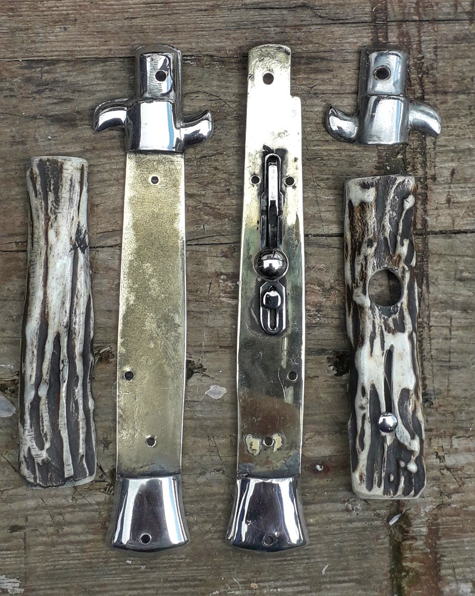

Big thanks to JJ for the message anout sorting out the hole on the liner i did a bit more today , outer cover was fun lol , im happy with how they look

Thanks JJ and thanks for the help mate via messages appreciated, im a big antler fan so thought what not Im taking this build slowly abd doing bits here and there as in no hurry

It's coming along nicely Paul. Your choice of covers is spectacular, that's some gnarly lookin' stag. Would you mind sharing JJ's method for repairing the catch-hole for future reference? Thx!

Cheers Marco and this is what JJ said to do
i typically repair "blade peek" on Italian knives fairly easily by simply "moving " the worn liner metal back into place

I can't say I understand what that means Paul, but thanks all the same.zed6309 wrote: ↑Tue May 18, 2021 7:29 pmCheers Marco and this is what JJ said to do
Re: Inox horn handled switchblade
I think basically buy tapping the bit thats pushed upen back into place to make the hole it's original sizeMadmarco wrote: ↑Tue May 18, 2021 7:35 pmI can't say I understand what that means Paul, but thanks all the same.
