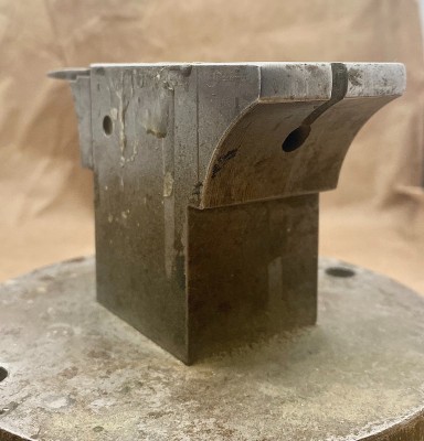

- Posts: 34
- Joined: Tue Feb 22, 2022 3:18 pm
Re: Stiddy, Steady, Cutler's Anvil
Okay folks, first try. Did my best with the band saw, and took a whack at it with the belt grinder. It's not perfect, and I have a bit of stuff left to do to it. But here's what I's starting with:
It is made from a 6" round of D2 1-1/2" thick. The initial cuts were done with an 18tpi blade. It was later replaced with a 10/14 blade. I think I can somehow get an 8/11 which might work better. This is a tough steel to cut on the band saw. All of the grinding was done at full speed and a 2x72 36 grit aluminum oxide belt. So far it still looks to have a lot of life left in it. I started grinding vertically with the stiddy laying on its side. I was able to flatten the top (somewhat) and cut in the step/ledge. I did the 4 corners then changed orientation. I thought I might be able to get a better surface that way. After some time at that I switched to the 2" small wheel and ground the remains of the arcs. I took this opportunity to thin the small horn (tongue) to where the smallest part is right at 0.125. This is not quite thin enough for most usage and will need to be thinner. However, I would like to finish the rest of it on the mill. I think if I can flatten either the top or bottom, then I can do the other side parallel. There are several holes, and grooves I would like to drill/mill int this, and then once completed the D2 should take a good heat treat.
The band saw threw a tire, which for Bosch is an in-house repair. Luckily for me it is a warranty repair. However, the second one is still pretty chunky in the arcs and I will probably wait for the saw to return so that I can reduce some of that mass, before attempting to grind it into submission. I am also considering investing in some ceramic belts to see if they might take some of the drudgery out of it. As well, I am hoping that a 24 grit might do better than the 36.
All in all this has been a fun project so far.

- Posts: 34
Thanks for your wonderful comments. It is almost there. But the second one, is definitely going to wait for Bosch to send me back my saw.

Here are some pics and measurements of my stiddy:
The round base is 1-9/16" tall with a 5" diameter.
The anvil section is bolted to the base through the bottom and is 1.5" by 1.75" (flared out to 2.75" at the top) and is 2.5" tall.
The face (surface) of the stiddy is 1.5" by 4".
