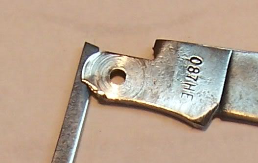

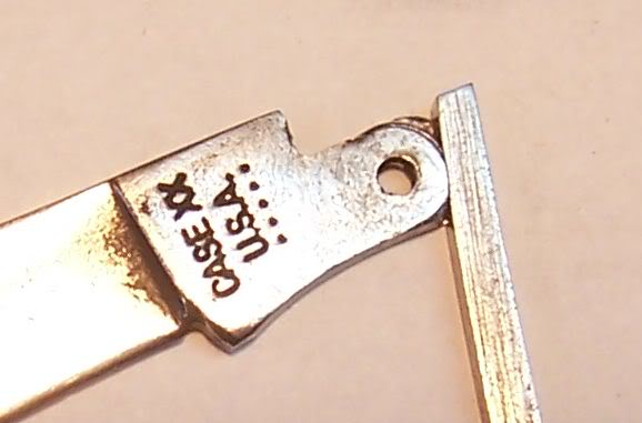

Here is one that had a loose pin that allowed just enough space for the odd wear pattern to start years ago. The worn area of the tang is deep enough to cause the knife to lose its snap even if it hadn't worn a divot into the backspring. Both of these together made for a blade with no action at all.
TIG welding is the only method I've found that is precise enough to replace the metal without heating the entire blade to the point of it losing it's temper. That's the plan for these two pieces.
I know I've described this problem before and the procedure that I use to fix it, but I thought this time I'd supply pictures of the process as we go. I should be headed to the welding shop within the next few days. Careful grinding on the tang and backspring should restore the action on the old knife. Give me a few days and the next pictures should be of the repaired pieces before installation.

Are you going to weld and re-drill the pivot hole or will you just drill it slightly oversize to get rid of the out of round and use a larger pin?

Elvis wrote:Here is one that had a loose pin that allowed just enough space for the odd wear pattern to start years ago. The worn area of the tang is deep enough to cause the knife to lose its snap even if it hadn't worn a divot into the backspring. Both of these together made for a blade with no action at all.
Please show this procedure as the welding is done.
I am very interested in a new fix for knives with this problem.
I have seen this same ware pattern on many knives over the years.
My only solution was to replace the blade and spring or grind everything and blend the spring which changes the shape of the knife in the end as I would have to reshape the back bone of the knife after re assembly.
Thanks for sharing this procedure Bob.
I look forward to seeing how it is done.

jerryd6818 wrote:Are you going to weld and re-drill the pivot hole or will you just drill it slightly oversize to get rid of the out of round and use a larger pin?
Steady as she goes on this one. ::pray::
Steady as she goes is right. First I'll trace out the exact shape and size of the remaining intact piece of tang to give me a guide as I regrind and normally there is no problem with the hole. TIG welding uses a rod (in this case) that is about 1/16" and the guy that does my welding can add the needed metal without filling the hole. Its what he does for a living and he's gotten very good at it. My biggest concerns will likely be grinding the blade back to 1 or 2 thousandths less than the width of the backspring and making sure the backspring grinding is as seamless as possible. After that, it should be a straight-forward reassembly since we're using the original handle material.
If the hole were to see some added metal, I'd take a small Dremel attachment (after grinding to the correct width) and try to bring the hole back to match the other blade in the knife. I'm not a fan of enlarging the pin size except as a last resort. It is a good option that is nice to have as a fall-back should problems arise, but I try to save it if I can.

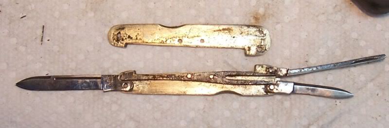

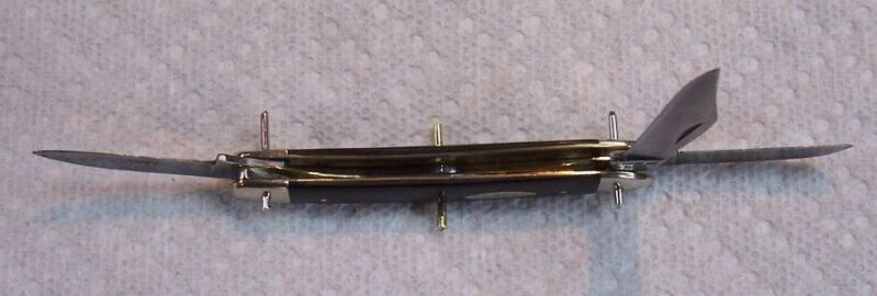

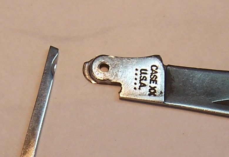

Thanks Mark. Checking back I did take pictures after it was taken apart, but none after that. Here's what it looked like with the offending parts rubbing the way they had been for years.
You can (barely) see the spring sticking up off of the liner and the flat piece of tang that remained in original condition. This was my template for grinding after the welding (I just traced it onto a piece of paper) like I did on the knife this thread is about. Sometimes not enough of the original shape remains and another blade from the same maker can be used or since the measurements aren't critical to the thousandth, trial and error can give you a good fit if you're careful not to remove too much. As little as 1/64th of an inch (or less) extra metal on the round part of the tang will put extra snap back that the knife has never seen before. Caution should always be used as too much extra metal could result in a broken backspring. As good as my welding guy is, we've never gotten a welded backspring to hold once it had been broken into two pieces. Never.

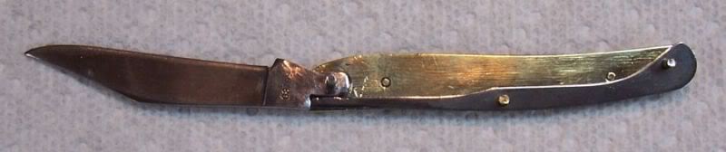

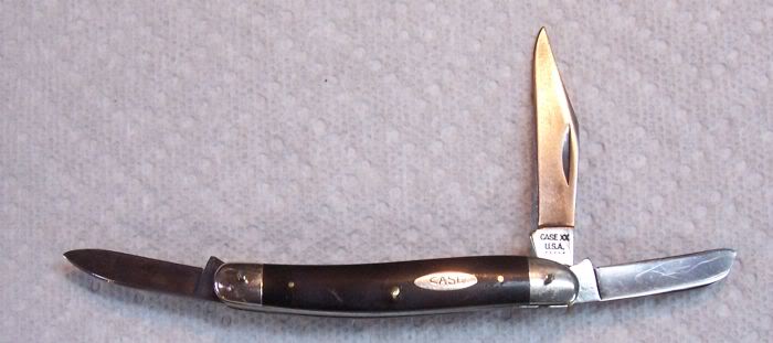

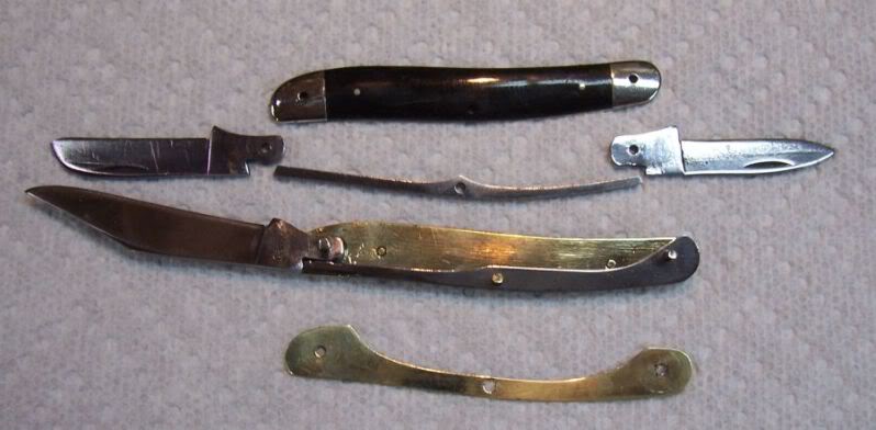

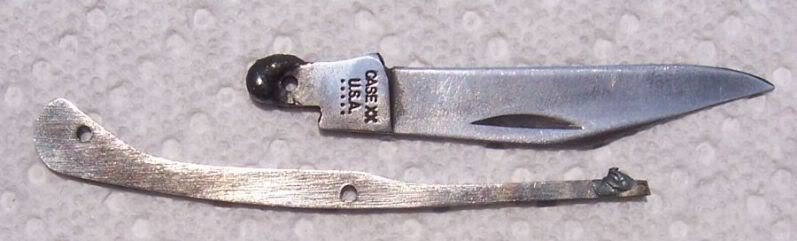

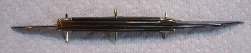

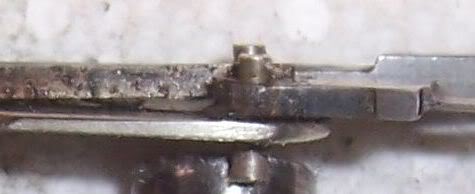

Got some real progress to show today. The first pic is of the preliminary fit together which allowed me to give it a check to make sure the snap was okay.
The next one shows the same thing with all the parts lined out for assembly. The initial fit used the old pins which weren't long enough for putting the knife back together.
The third pic shows new pins holding her in place now.
The next two are just different angles of the knife before peining the pins (which I hope to do tomorrow).
A test run of the blade action looked like good news all the way around. We'll soon see if that still holds true when it's finished.
Questions or comments? Anybody think I'm nuts for going to all this trouble? ::woot::

I received a PM asking what rods my welding guy uses and I had to plead ignorance. He asks me if he's welding stainless or carbon steel and takes it from there. The welds don't seem that much harder than the rest of the tang, but without proper testing, it's hard to know for sure. In this case since the tang and backspring were both welded I think it's safe to assume they now have the same hardness in that spot so uneven wear shouldn't be a factor.
As for your welding guy Kaleb, the person who sent me the PM mentioned certain rods that produce a welding bead that is around RC 58. Since modern (factory) blade heat treating methods leave the tang a tad softer than the blade area, I'm wondering if 58 would be too hard and begin to wear on the backspring. I'd also like to mention that he is always careful to clamp the blade or backspring in a vise with only the part that needs attention sticking up. This allows the vise to act as a heat-sink helping to prevent heat transfer to the blade area so we don't lose temper.
This method has worked well for me and is the only way I've found to correct this problem short of using new parts which often just aren't available on a lot of the older knives. Your biggest hurdle in using this method will most likely be finding a welder with the talent and patience to do it. I highly recommend bribery with folding cutlery. :mrgreen:
Edited to add that the knife has been reassembled and just looks like the last pictures of it with the pins peined. End of lesson I suppose, but I'll be here for questions and I hope this has been helpful to someone.
