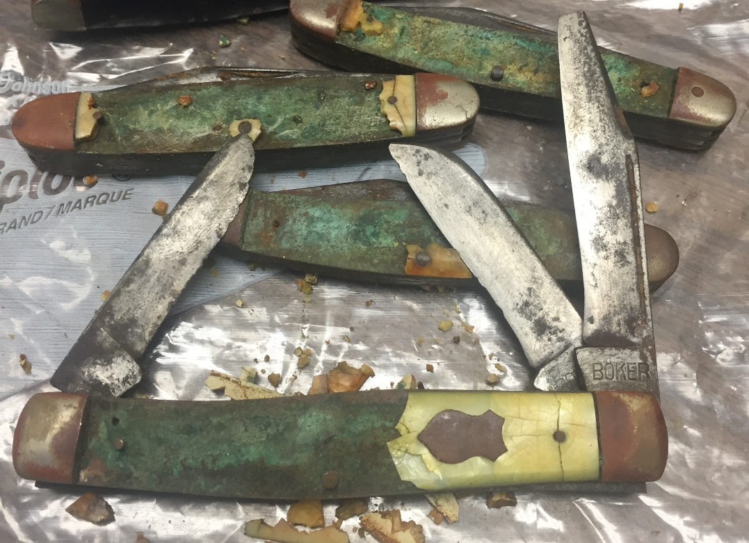

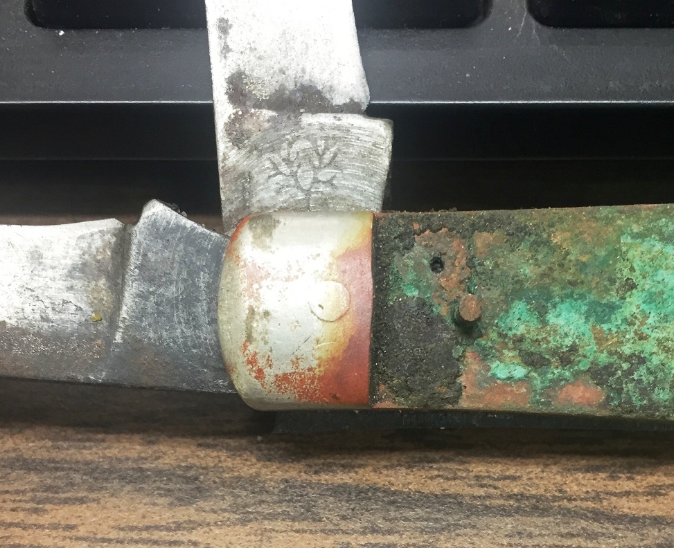

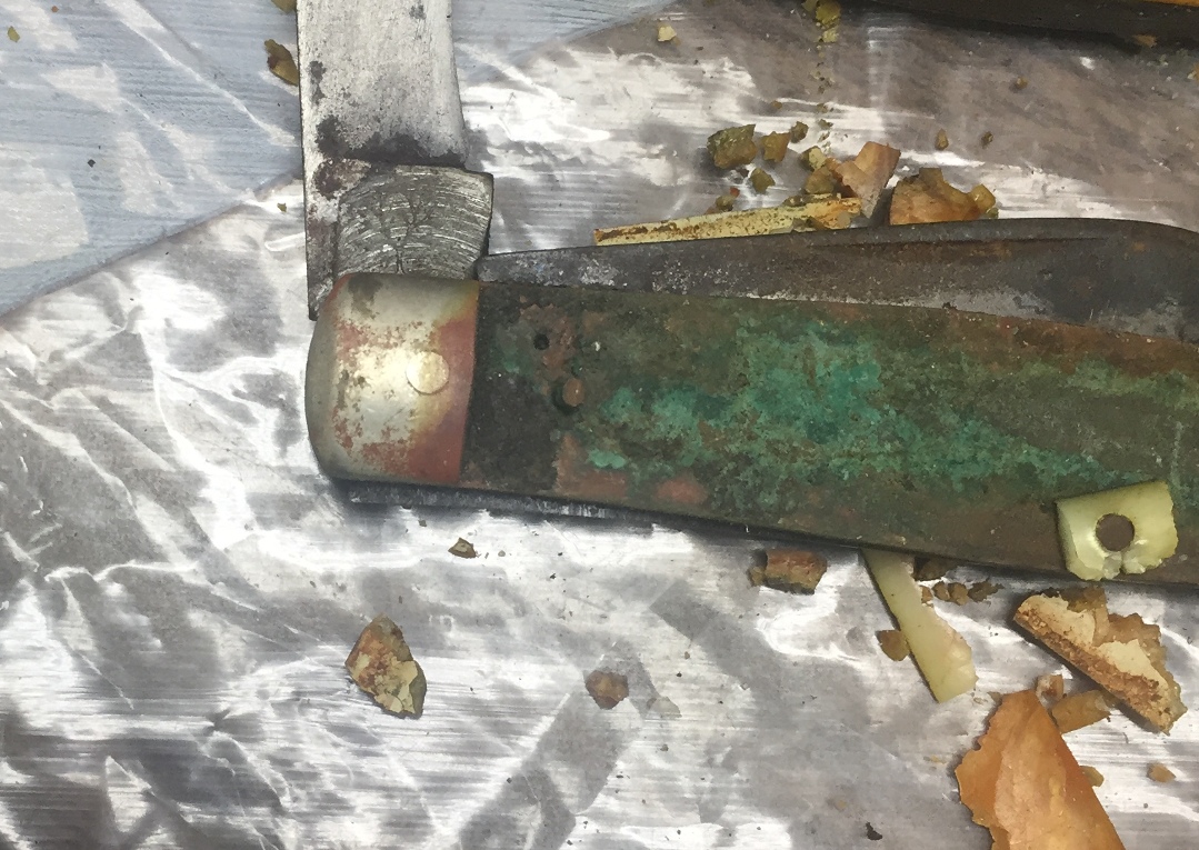

I got this knife (among some others) and it is in pretty bad shape.
There is 2 or 3 Camillus folders in the bunch but I figured I would start with the Boker. The scales have gassed and broken to pieces. The liners are steel so it looks like no brass in this knife. Here is a couple of befores.....
This poor knife was COVERED with crap. Looks like maybe old oil mixed in with the dirt and old scale material.

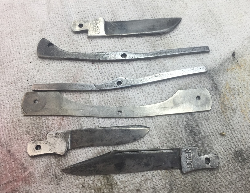

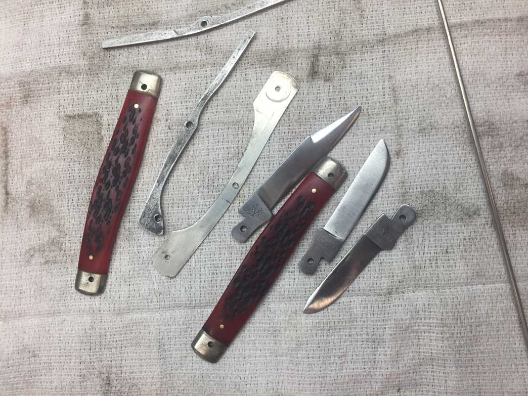

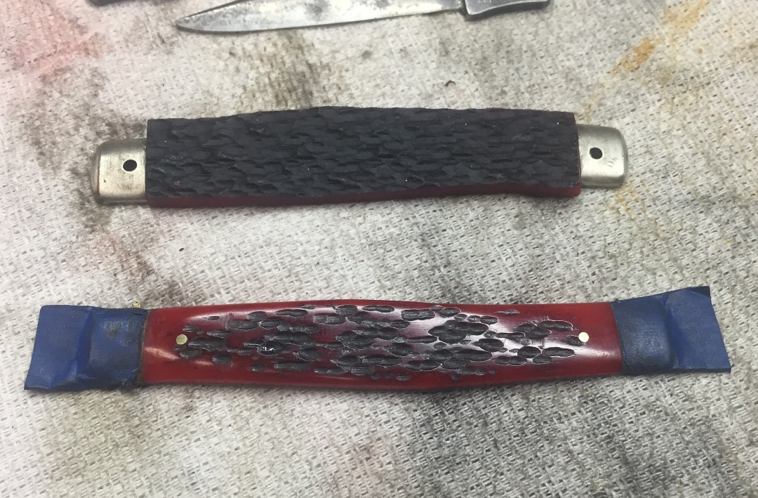

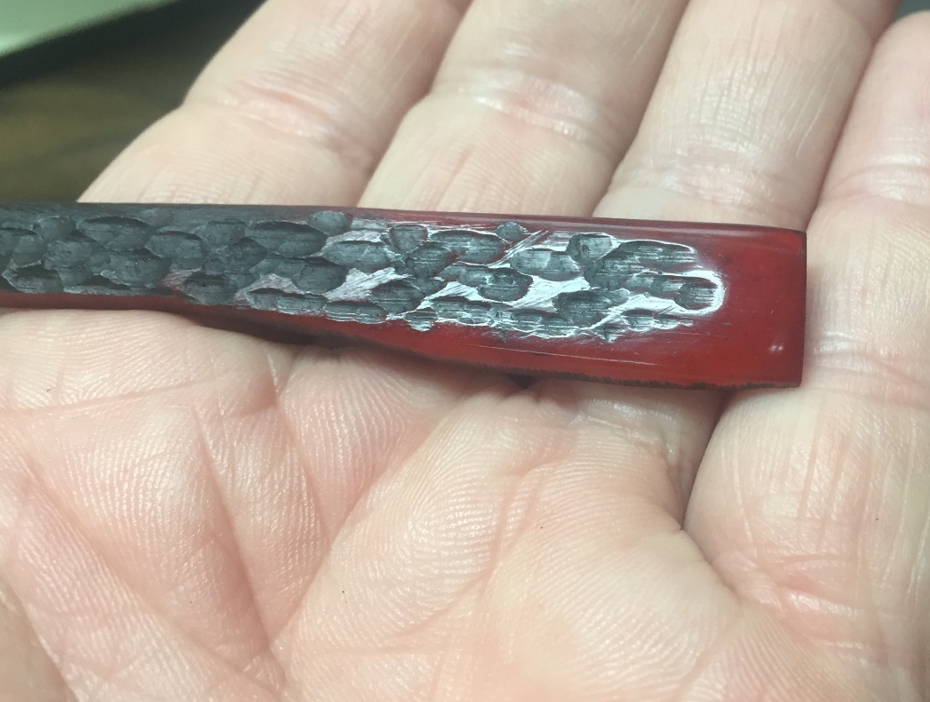

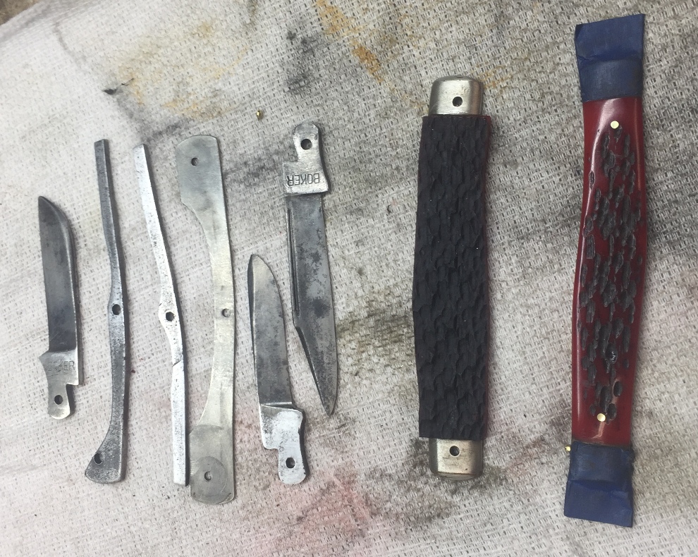

I had a busy weekend, so I didn't have a chance to do much. I did get it apart and fitted one scale. I chose Culpepper's Catalina Crimson for this rescue. I filed and sanded a piece of the scrap so I could see what it should look like when finished.

So far, it has cleaned up pretty good. The gassing of the cell had destroyed the shield. It was so thin that it cracked badly while I was taking it out. SO, no shield on this old guy.
The blades evened out pretty well. Not a lot of blade loss after I got a good shape back to them.
SO..... Onward!

Mike, I thought Bokers were suppose to loose their shield. I that was an identifying characteristic of a Boker.Meridian_Mike wrote:Well, I am going to give it the "old high school try".....LOL.glennbad wrote:Anything will be a save on that one, Mike!

LOL.... you may be right. I have several that have lost their shield.doglegg wrote: Mike, I thought Bokers were suppose to loose their shield. I that was an identifying characteristic of a Boker.
Only problem with this one was, it was pinned on and the dog gone shield was HOLDING what was left of the scale on....LOL.

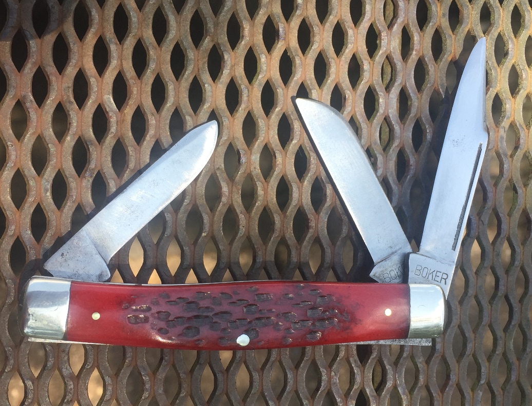

Part 2 of the Boker rescue.......
It was a HOT day Saturday so it was a good day to be in my shop.
I got the scales glued on earlier in the week, so they had over 24 hours to dry. I started filing one side and sanding some so I could see what the finished product would look like. Here is what the blades and springs looked like after a basic clean-up. I also had to re-shape all the blades. I worked on the blades for an hour or 2 before I decided I didn't need to take any more metal off.
This is getting close to re-assembly time. Well, no pics of getting the shape like I wanted. I had to continue to take off scale material to thin it out like it needed to be. SO..... boo-boo #1, I started with scale material that was to thick. That was among a few other things I didn't like....BUT, I am still learning. Here is the final pic of my latest restore attempt. Onward!
- Meridian_Mike
- Posts: 4981
- Joined: Mon Apr 21, 2014 8:36 pm
- Location: Mississippi
Re: Here is a Boker I am trying to rescue
Before and after......
Thanks for looking everyone!"Life is tough.... but it's tougher if you're stupid."....John Wayne
Well done Mike. I'm particularly impressed with the reprofiling you did on the main blade. Excellent work all around.
Phil
