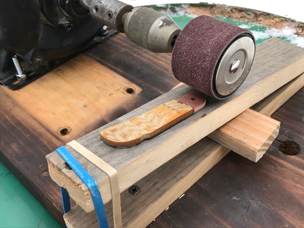

I'm an absolute novice to folder making, having made only two. I can offer that the way I thinned down stock on one is with a home built drum sander. It has a bottom on a pivot to adjust the thickness of the sanding, like a veneer sander. Here's a picture. It's crude but it did what I needed it to do.

Re: Commercial Blade stock miniumum thickness available.
Interesting.....
I can see how that would give you a uniform thickness for almost anything you are cutting.
Good thinking outside the box!
Thanks! I feel it works equally well for the steel parts like blade and springs if you have a flat surface but takes some time to remove stock.
