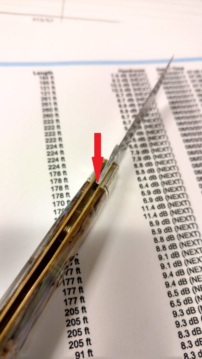

If you're saying that the spring tension is so stiff that it is a nail breaker, then this is what I do...
I take a jewelers file to this corner of the blade tang. I just round it off slightly, you don't always need a lot to affect the opening pull. If you take too much off, you can affect closing snap, so just a bit at a time. Oh, and tape off the blade while doing this!
Make sure to flush or blow out the filings, oil generously, and work the blade a bunch.

glennbad wrote: Fri Jun 12, 2020 1:22 pm If you're saying that the spring tension is so stiff that it is a nail breaker, then this is what I do...
That’s a cool tip, thanks for sharing it!
After reading your post, I remembered a very special knife in my collection that I acquired with a broken blade and fortunately, and after a long search, I was able to get a replacement blade. But, after that, the problem has always been getting the new blade to start opening. I tried everything I knew, busted both thumbnails several times, used many different lubricants, and only got slight improvement. Glennbad, after I read your post, I tried your suggestion, and bingo, a few file strokes and it worked like magic! The closing snap is a just a touch weaker now, but that really doesn't bother me at all. Thanks for posting that suggestion! :D ::tu:: ::tu::
Herb
