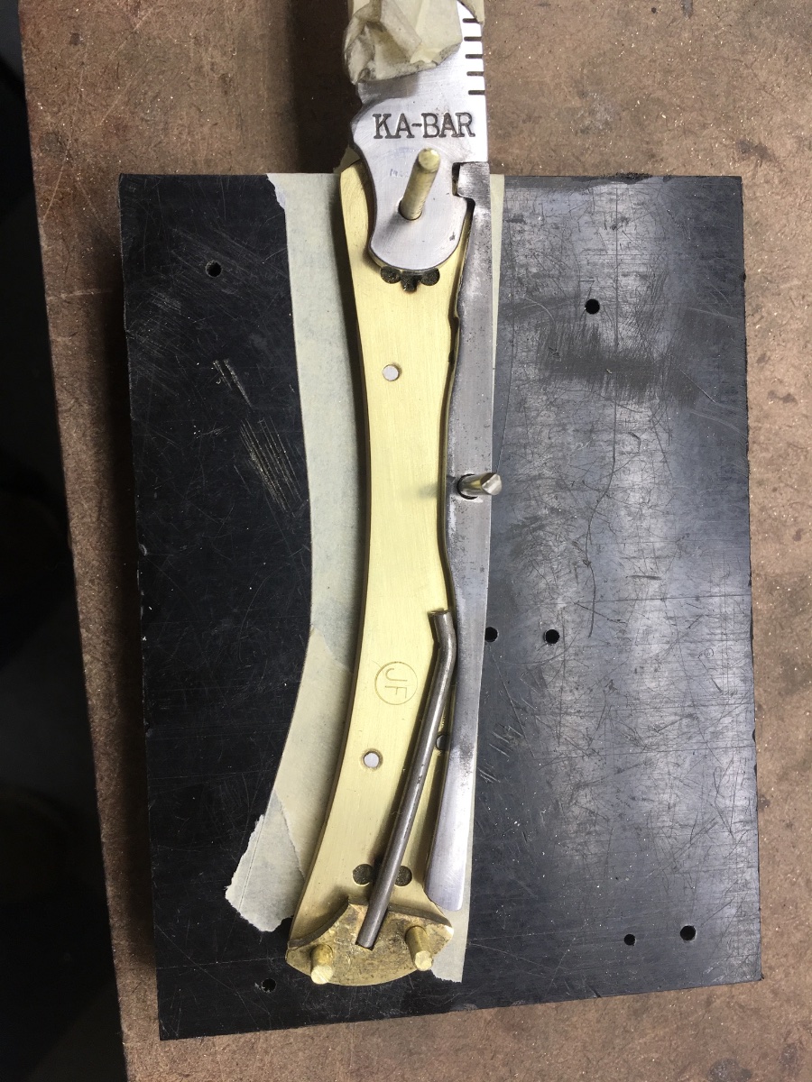

The standard lock back knife is fairly simple (at least the ones I’ve worked on so far have been). The mechanism on your knife should look something like this:
[attachment=0]E739A137-699D-42AB-AB23-C7D72F94F436.jpeg[/attachment
This is a Ka-bar mechanism but the Schrades I’ve worked on are similar. I haven’t had a Frost apart but I’d assume they’re similar as well.
