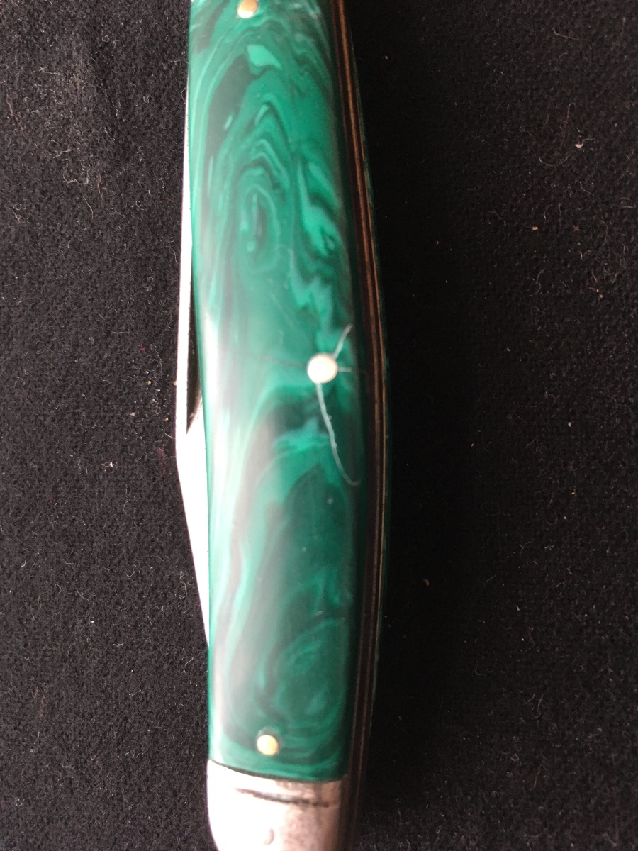

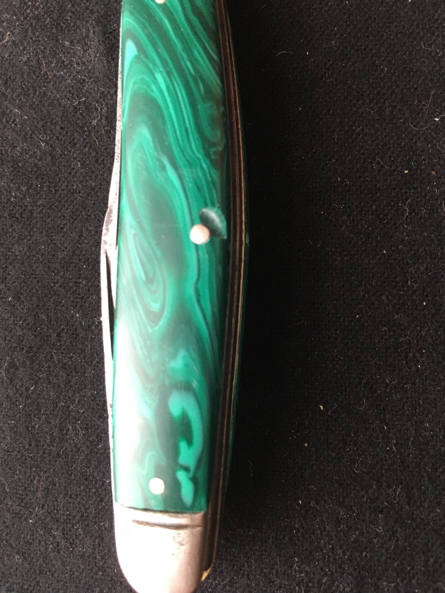

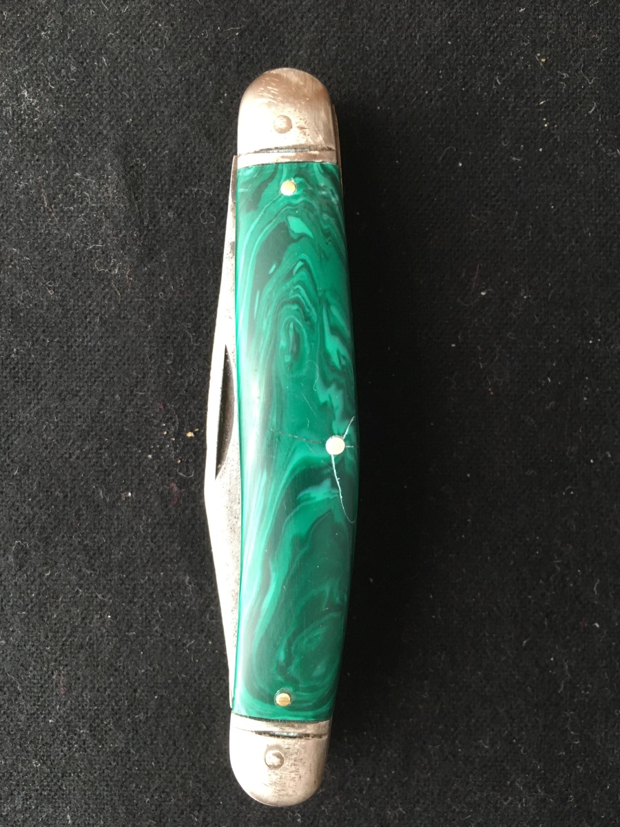

This Westaco knife came to me with no scales and was dirty as all get out. I took it apart and cleaned it, and after working on a few other little projects decided to try to assemble the handles the "right" way. The material is another Jantz product, their "Malachite". It's harder and tighter than the acrylic I had used before, so I was hopeful.

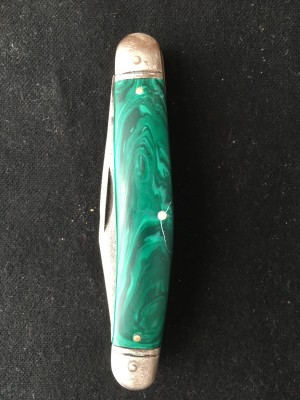

I got the scales pinned to the liners just great, but when I went to drive the pin for the spring pivot, I cracked the scales around the pin hole. I used a compressor which I bought from Orvet here on AAPK, which worked pretty well. I tapped the pin as gently as I could, but still got chipping. I got some of the larger pieces and used superglue to put it back together, but doggone it! It went so well up to that point...
So do I drill out the holes in the scale a couple thousandths bigger? I'm flummoxed. The knife will still work, of course, and it's be an EDC for me, but I want something I can show off without making disclaimers...

I didn't think about the pressure of the pivot pin by itself causing a problem, but it makes sense. As for peening, I used a countersink bit to create the smallest amount of countersink in the scales. That seemed to work OK on the liner pins for me (but my tapping was MUCH gentler than I had to do to get the rocker pin in). Had I got the pin in without a problem, I think I could have peened it OK...But I first have to get the pin in OK.
Your suggestions give me something to think about, thanks!

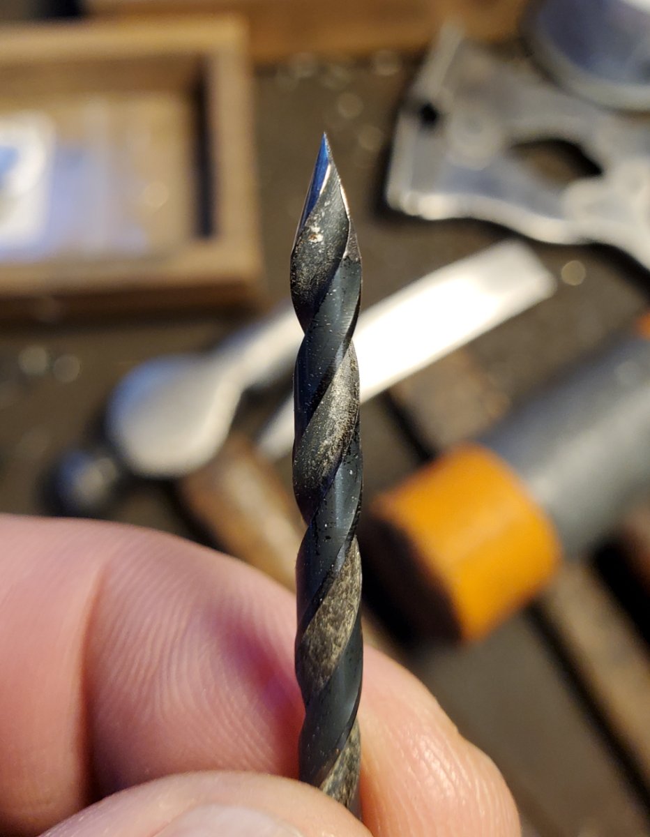

Do countersink the holes in the covers as well with at least a 60 degree countersink. I make my own with a far steeper angle, you'd be surprise how far down the pin expands when you peen.

You're attempting to use one of the most brittle handle materials available. Even I have only successfully pinned one reconstituted stone handle and I swore I'd never do another. It doesn't matter how well your pin matches or how you chamfer the hole, that pin has pressure against it (unlike the scale pins) it's going to chip out unless the pin is not touching the reconstituted stone. The only way you might get it to work is to counterbore the hole in the handle material with a slightly larger bit then peen a round head on the pin. I'd rather try to put a pin in glass.
Re: pinning the springs in place without breaking scales
Kaleb is absolutely correct.muskrat man wrote: ↑Thu Apr 22, 2021 9:23 pm You're attempting to use one of the most brittle handle materials available. Even I have only successfully pinned one reconstituted stone handle and I swore I'd never do another. It doesn't matter how well your pin matches or how you chamfer the hole, that pin has pressure against it (unlike the scale pins) it's going to chip out unless the pin is not touching the reconstituted stone. The only way you might get it to work is to counterbore the hole in the handle material with a slightly larger bit then peen a round head on the pin. I'd rather try to put a pin in glass.
I avoid using reconstituted stone handle material like the plague. The only time I have been consistently successful in using it is using a partial piece pinned & glued to the liner but with a much tougher material at the rocker hole such as stag, bone or micarta. In other words using it as a band or as a diagonal stripe on a handle.
Like Kaleb said, I think I have successfully re-handle the pocketknife with this only once or twice in 15 years. It is probably the most brittle material on the market, as far as I'm concerned.
