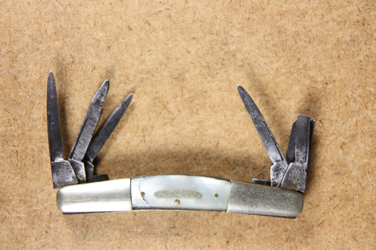

One that I bought early on for a dollar junker to practice on was this Mfrs Union Cutlery 8 blade Congress from 1888 with Mother of Pearl. 4 of the 8 blades are broken. I would not recommend one like this to practice on, I still have not done anything with it. Keep it simple is best until you get the hang of it.

OLDE CUTLER wrote: Tue May 11, 2021 1:10 am One that I bought early on for a dollar junker to practice on was this Mfrs Union Cutlery 8 blade Congress from 1888 with Mother of Pearl. 4 of the 8 blades are broken. I would not recommend one like this to practice on, I still have not done anything with it. Keep it simple is best until you get the hang of it.
That is a nice one! I have a four-bladed Wostenholm that's around the same age with one broken blade (presumed to be a nail file) and a chipped tortoiseshell handle (about 1/4 is missing from one scale). I haven't touched it at all. It's also one of a very few I have in a display case. It's also special in that it is the oldest folding knife I have. The tang stamp lacks "ENGLAND" which means it's a pre-1891 knife.
How many backsprings does it have?
It has 4 backsprings.
