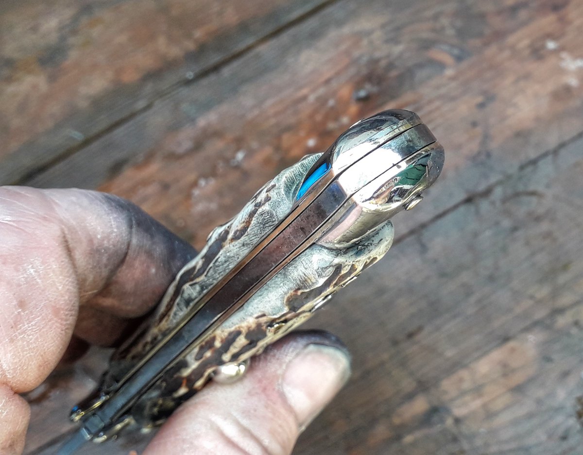

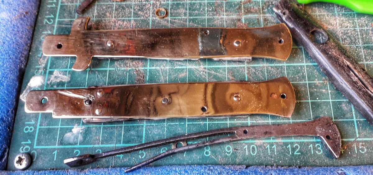

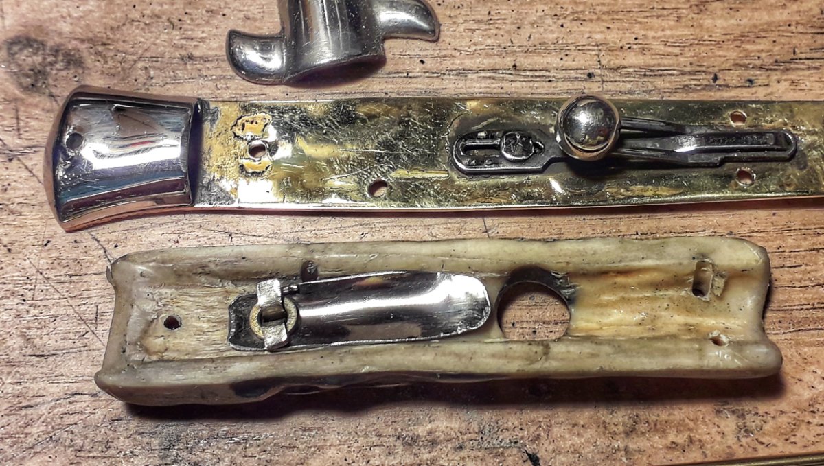

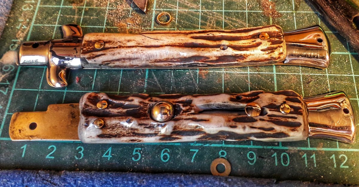

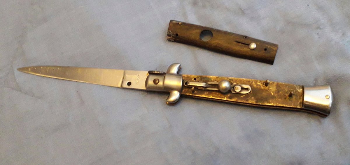

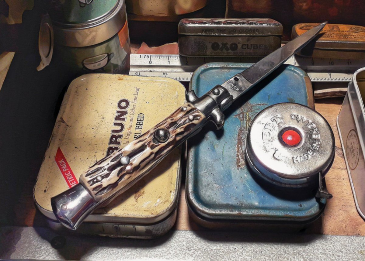

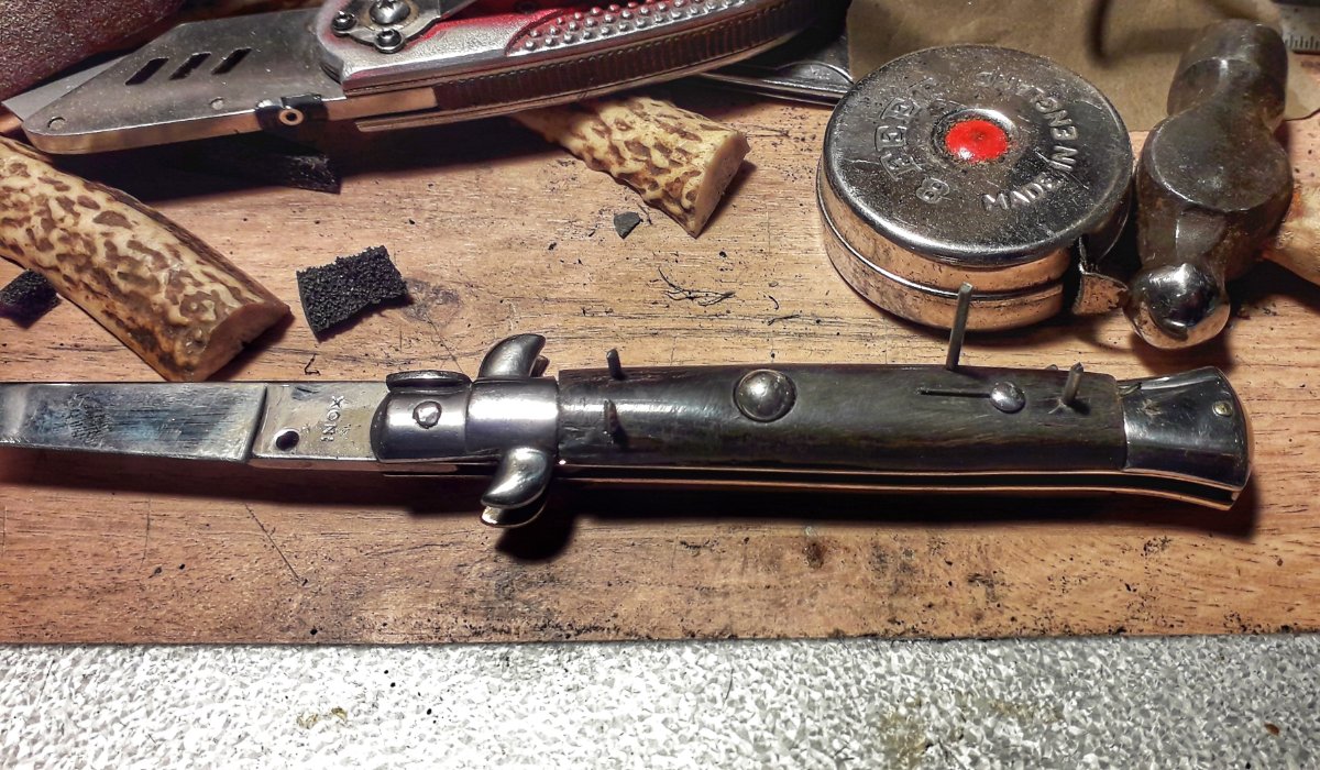

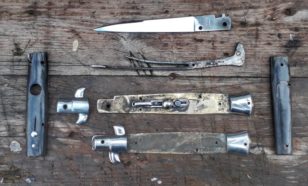

Thought i would startca new post as this has turned into a full restoration project, this was given to me for services done to a friends knife , sadly illegal in the uk since 1958 but will be restored and hidden in my collection , it came in bad condition , blade flicks out by itself and blade sticks out when closed, i sorted the initial problem and with advice from JJ ill sort the other issue ::tu:: today i cleaned it up and did the stag scales , still got loads to do and will be taking my time as my first switchblade ::tu:: sorry the pics are not in order :roll:

Thanks guys , my 1st switchblade but a fun project, i ordered brass pin stock and got a SS pin for the main pivot and a SS pin for the bottom bolster , going to take my time on this one and get it right ::tu::

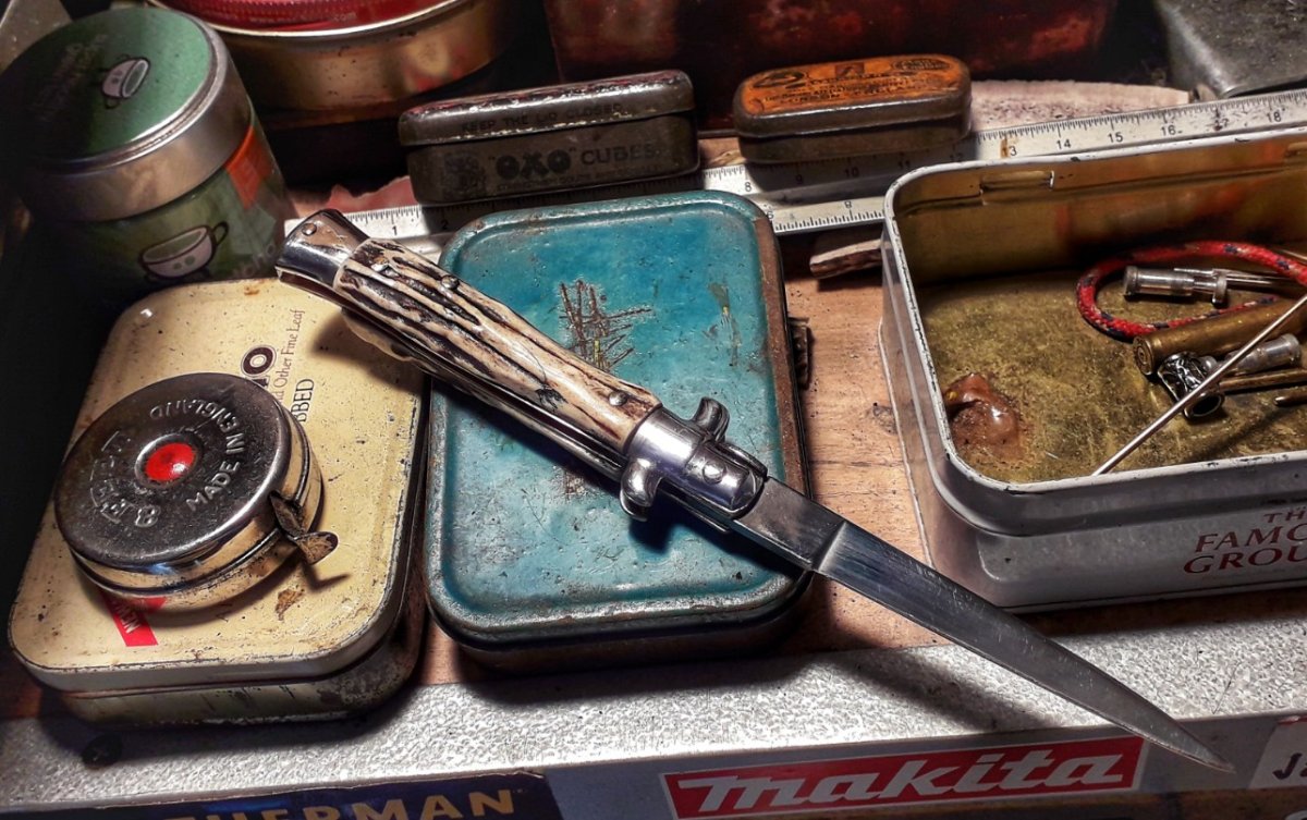

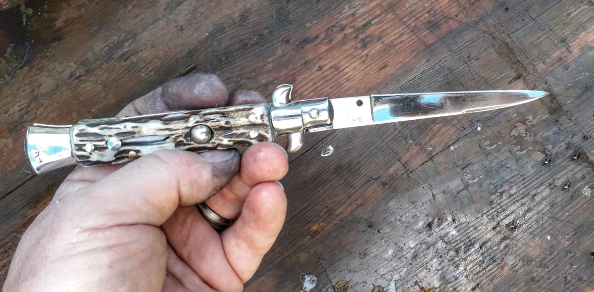

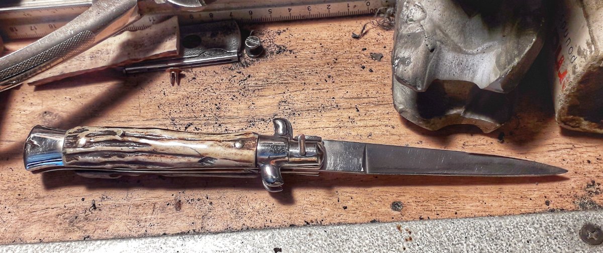

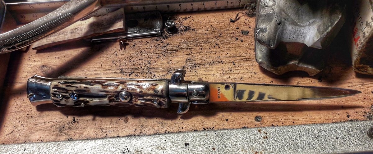

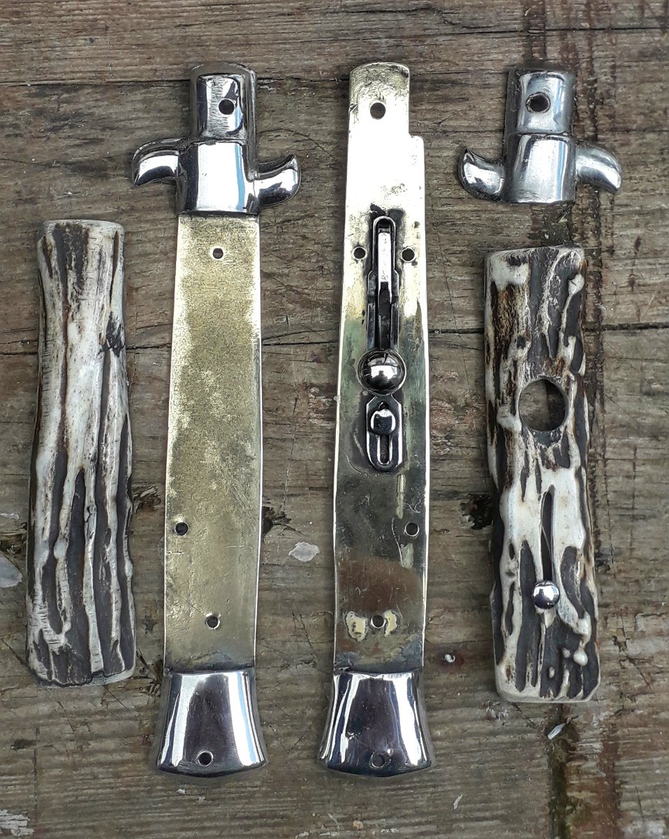

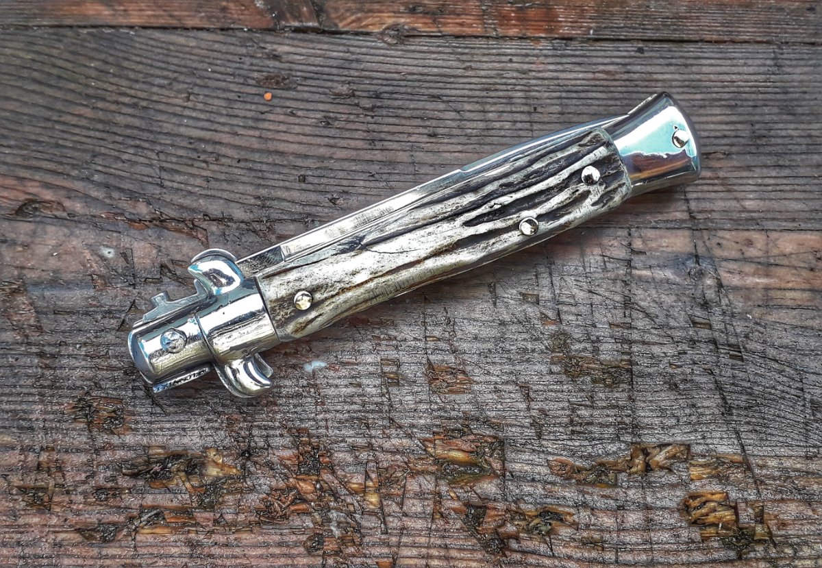

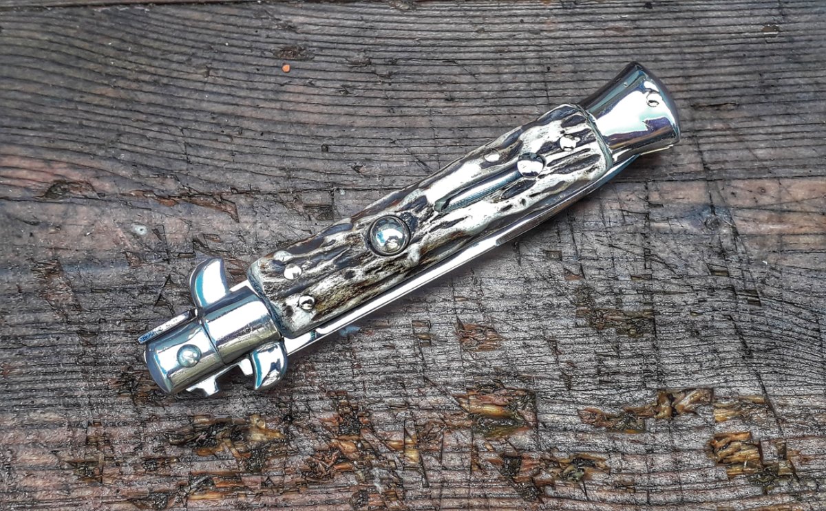

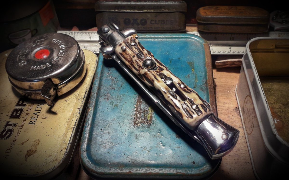

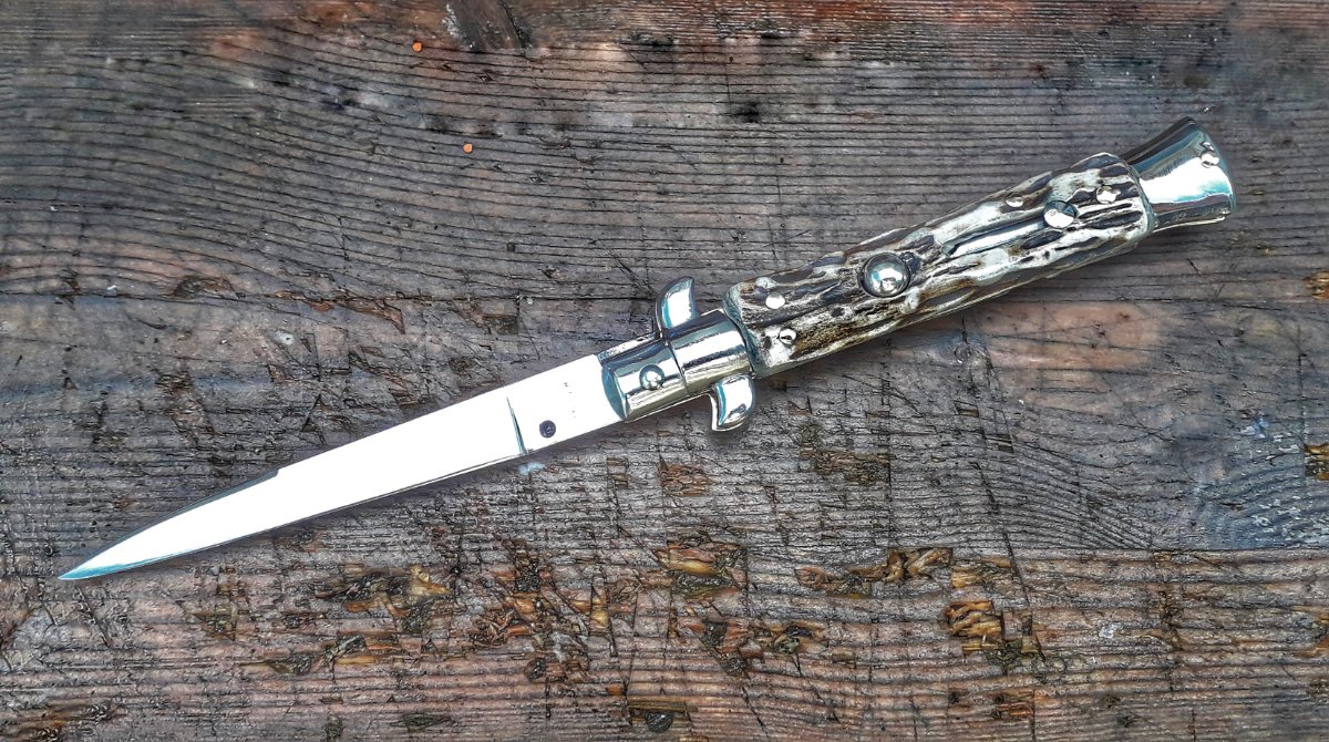

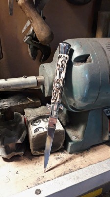

Hi guys , well i took my time, i re worked the liner pushing material forward and now have no blade peak ::tu:: SS main blade pin fitted like originally, brass pins to hold on the Antler, now many will noticed the wider slit for the lock, sadly the original one snapped , so i had to make a new one , it actually is more solid and works better, its tight together put i didnt over pein the main pin as i didnt wsnt it to not flick open properly, im very happy with it and love the Stag handles as im a bit fan of stag ::tu:: sorry the pics are jumbled lol

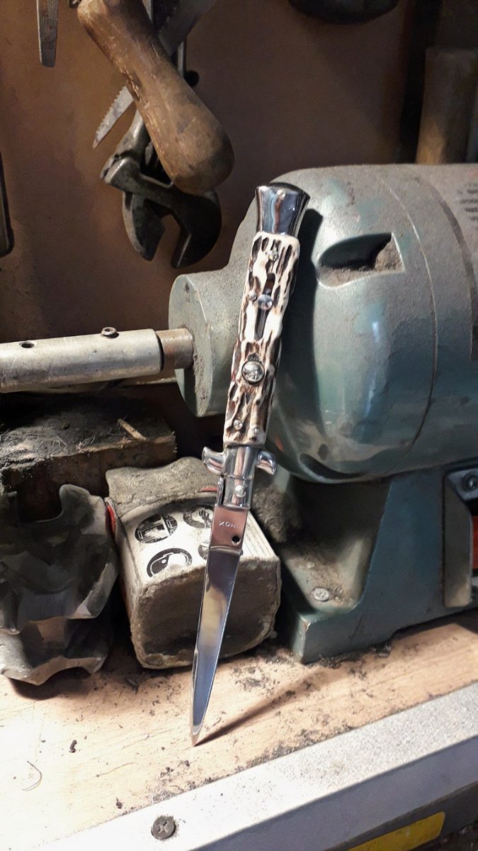

Glamour shots :D ::tu::

Thanks guys and thanks again JJ as it worked a treat as no blade peak ::tu::

Thanks Scott ::tu:: i was a bit gutted when the tab broke off the original lock but the new one is much more solid ::tu:: and to me stag makes everything pretty :D

Very impressive Paul. Congrats on bringing that old soldier back to life. You did a fine job of milling out the front cover which can be difficult without the proper machine, and your very intuitive safety invention is simply outstanding. For many years auto knife enthusiasts have complained about the safeties on their knives becoming loose and sloppy, and as a result builders came up with a new design that ensures they stay tight, and now this new system you've created might someday be yet another fix for safety problems. You might want to consider putting a patent onto it. The stag you used is nearly perfectly matched and gives your knife a teriffic appearance. A top-notch effort all round! 8)

Thanks Marco , im almost glad the original safefy broke as im sure it would of at some point after it was all fixed together , this safety holds in place much tighter and is more solidly constructed, thanks again for your comments there appreciated ::tu::

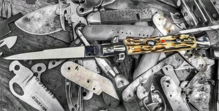

Red dot added ::tu::
