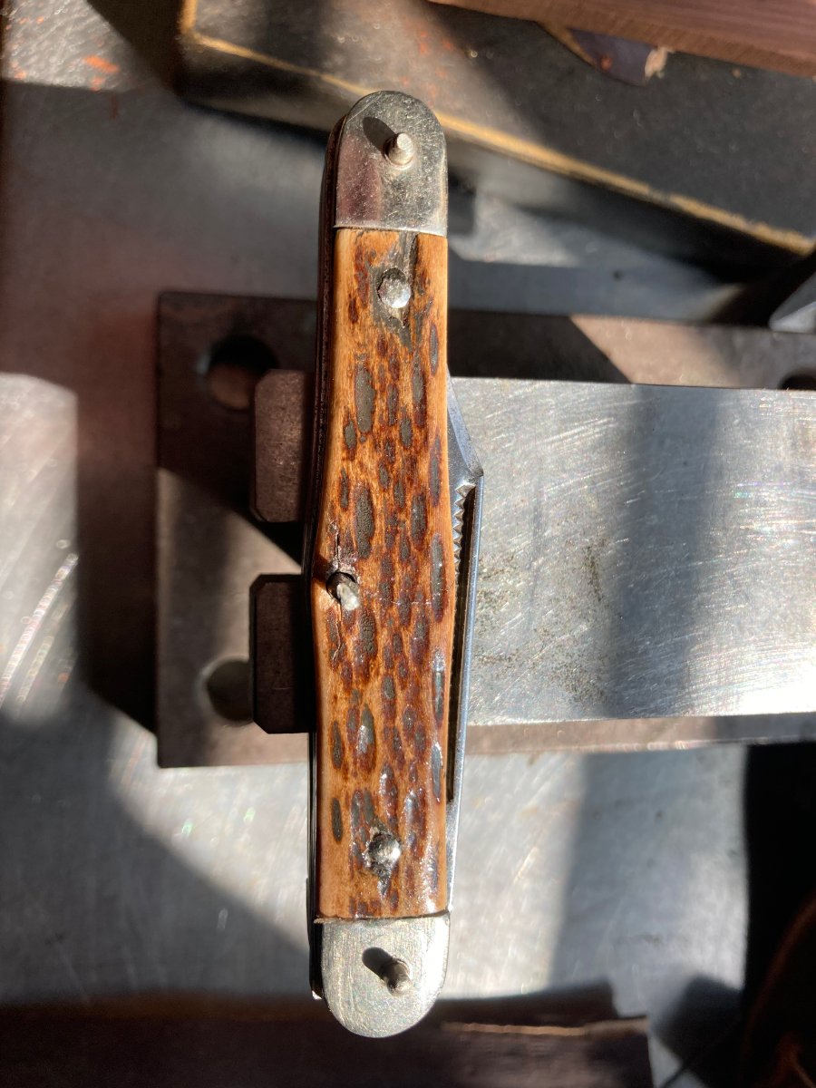

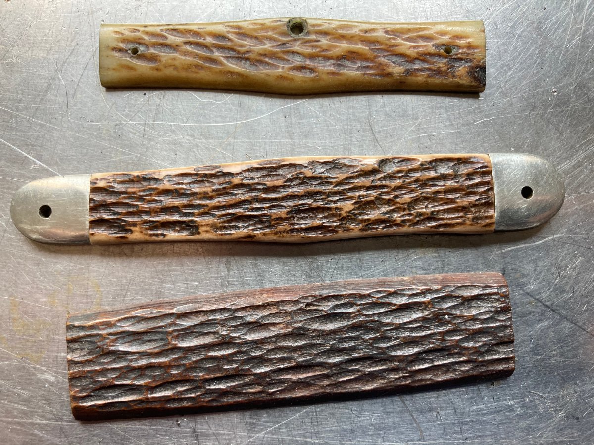

I recently decided to get back into working on knives after a couple of years. My first attempt turned out just fine. So I decided to repair another Camillus 72. I had a pair of vintage jigged brown bone handles to work with.

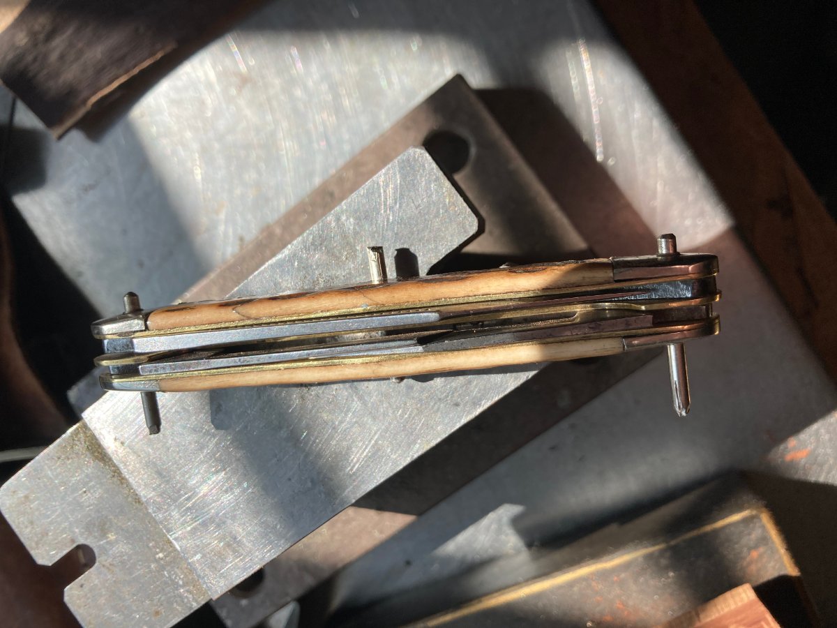

Everything was good. All that was left was to reassemble the knife. Unfortunately I was a little cavalier about compressing the back springs. When I went to install the rocker pin I ruined to project when the hole on pile side wasn't lined up and I forced the pin through, or almost through and bent the scales and cracked the new bone handles that I made. At first I only noticed the small cracks below the rocker pin.
That did not bother me so I started over and the whole thing went together as it should. I decided a little Zap a Crack would stabilize everything and that would be that..... Then I looked at the handles through a jeweler's loop and saw that cracks had gone all the way through top to bottom. And to make matters worse the master blade rubbed so bad against the liner that it was hard to open and close. Bear in mind that I was in mock up, meaning that pins were in but not finished. That way I can check the blade function before finishing the bolster pins. Oh well.

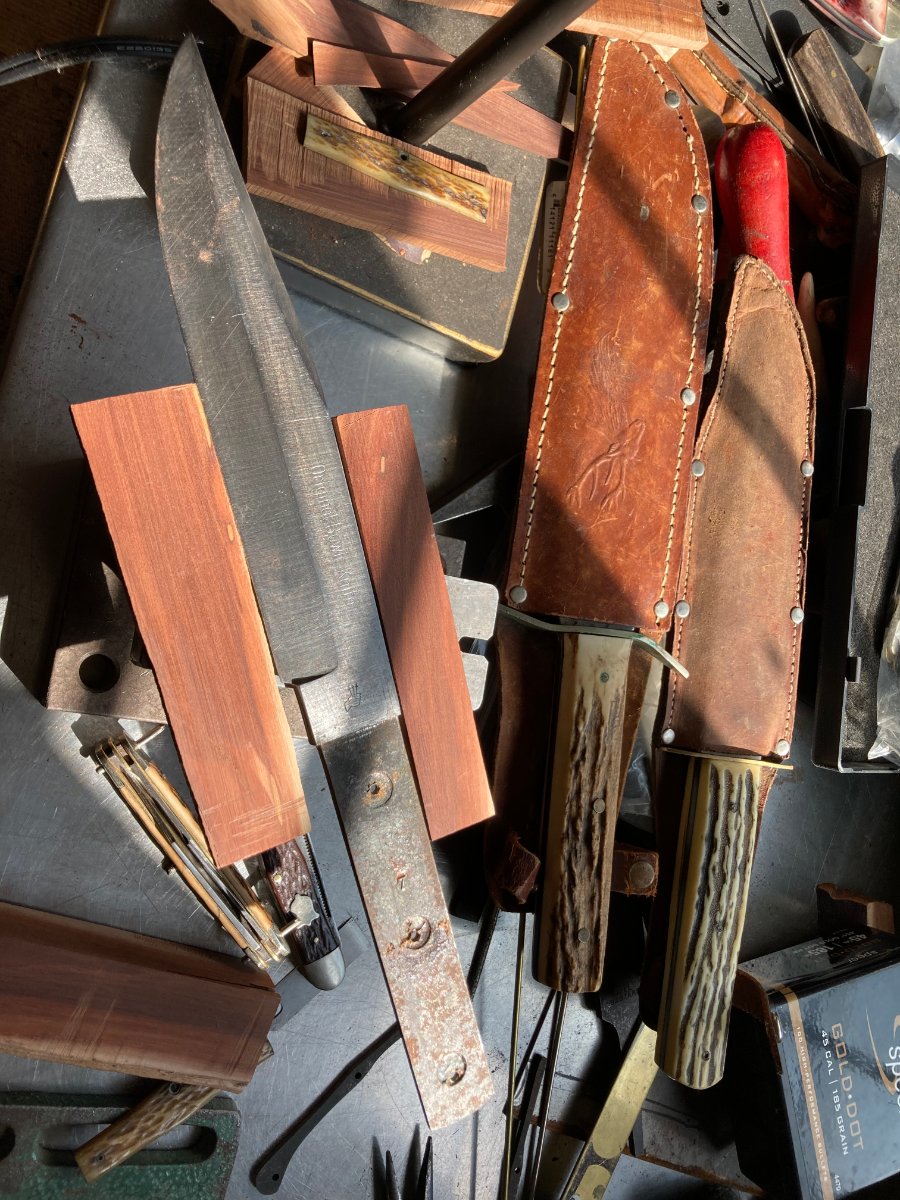

I decided not to dwell on this and have shifted gears to work on one of my fixed blades.

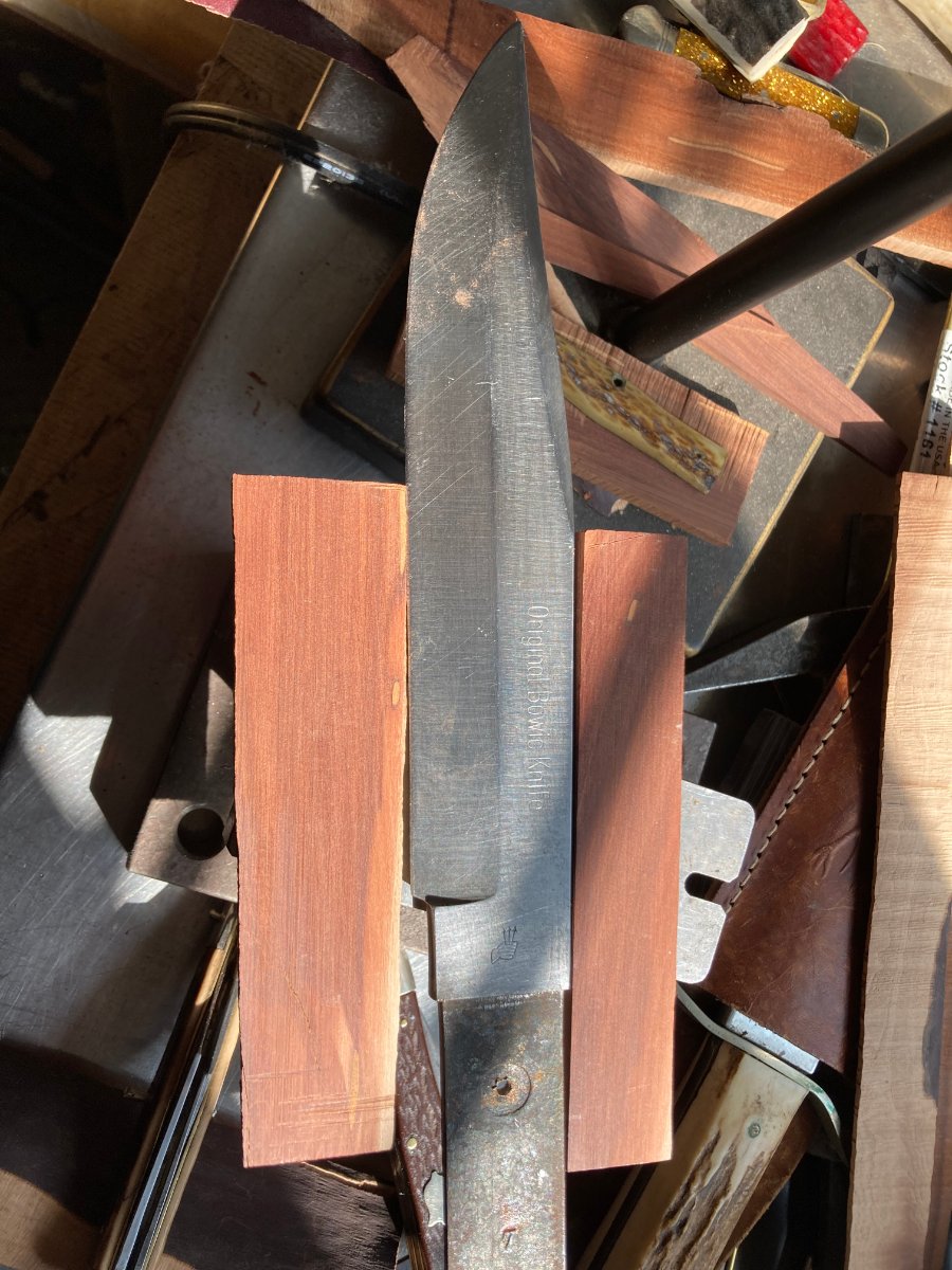

I do have another 72 that I picked up for donor parts. When I'm ready I will use the secondary blades from the first 72 and the master from the second and start over. This time I am going to put some Manzanita wood on the 72 as well as the fixed blade. I used Manzanita on TL-29 mod many years ago and love the way it turned out.
I'll post the results of both knives when they are finished. For those new to knife repair this stuff happens and there is no point in getting too bothered by these accidents!

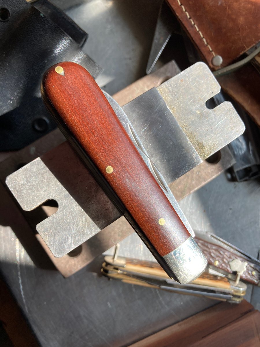

Thanks Glenn, the TL mod sports a wharncliffe mod to the screwdriver blade. Your mods a few years back inspired me. :D Using Manzanita for knife handles came about when a friend gave some to try. There is no finish on that one. Sanded it smooth and then buffed it with red buffing compound. The wood is dense and has a natural oil content. And the chips and left overs make a great fuel for the bar-b-que! Of course the 72 isn't the first knife that ever ruined so I know what you mean. I have chucked more than one across the room in the past. It's still frustrating but I've learned to deal it and learn from my mistakes. ::facepalm::
