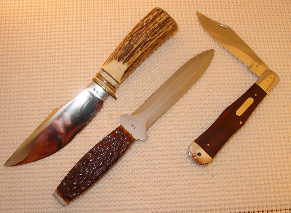

Here are the first 3 knives I made many years ago. All using a 1"x30" grinder. Still have 2 of them. I gave the middle knife to a good friend.
Those are awsome looking Knives by the way !!!

btrwtr wrote: Fri Nov 25, 2022 4:14 pm Sounds like you are off to a very good start and good advice above. I'm sure your work as a tradesman will give you a leg up on knife work.
I made a good number of knives using a 1"x30" belt grinder. The larger the piece the more dificult for me to get good results but it can be done. I would say that a decent 3 speed drill press is a top pick if you don't already have one.
I was told long ago that if you start with some very basic and less expensive tools you will find out through the work what you need most down the road. I've seen some go headlong into the process and by stuff that I wish I had only to find out they didn't have what it is necessary to carry through.
Those are amazing! Wow!

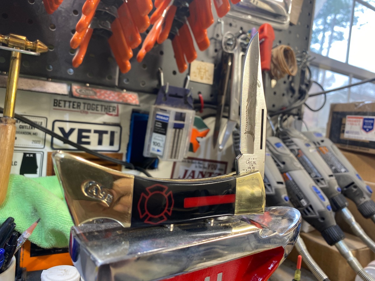

Yes delrin and other synthetics will burn easily. When buffing that stuff I use pink scratchless rouge and very light pressure.
Just did this one today for a buddy who is a retired Fire Fighter.
Just did this one today for a buddy who is a retired Fire Fighter. 962A2365-F188-4C34-8530-7ED897A7BFF7.jpeg
That's beautiful.
I'm a retired fire fighter, is it for me? :D :D
