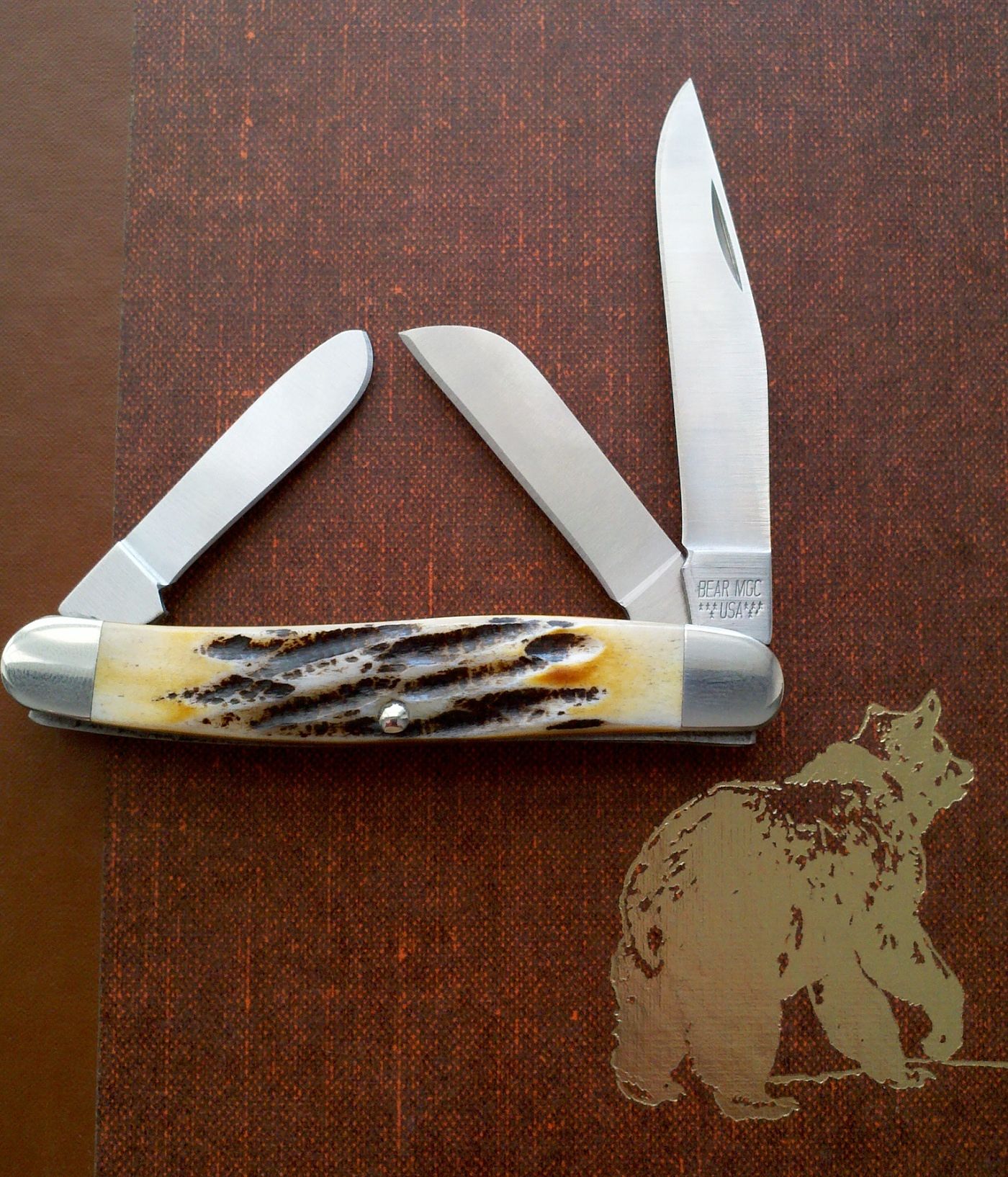

This past Tuesday (7/17/12) I went hunting for a Bear & Son pocketknife to purchase and use; I only have one, a 2009 Remington BSA replica and it has never been out of the box. I wanted to put my money where my mouth is and buy a "using" USA made pocketknife; I found this one at ACE Hardware in Tarboro NC. The label on the box is marked 4" but the knife actually measures in at just slightly under 3-7/8" OAL. The label is spartan:
547
4" Genuine India Stag
The information below concerning this knife model was copied off of the Bear & Son website this past week:
4" Genuine India Stag Bone™ Large Stockman
Model: 547
• High Carbon Stainless Steel Blade
• Liner Lock
• Nickel Silver Bolsters
• Hollow Ground Master Blade
Retail: $62.49
My review:
The knife is built with a wider Turkish clip master blade, and the usual spey and sheepfoot secondary blades commonly found on a Stockman, all of stainless steel construction. The liners and springs appear to be of stainless steel construction as well. I have carried and used the knife for the past week and am favorably impressed so far. The "walk and talk" on the two secondary blades is perfect. The master blade is a bit "crunchy" when opened and closed, but not excessively and the quality of the snap is not effected; I oiled the blades with some SMKW Coon P knife oil and all blades improved in their action. I expect the slight crunchiness of the master will improve with use. The was absolutely no side play or wiggle in any of the three blades - the knife is well fitted. The stag handles are nice looking, well fitted, well matched, and finished with a semi-gloss polish, the knife lacks a shield. The rounded bolsters carried well in both tight fitted jean pockets and in the very loose fitted pockets in my Columbia fishing shorts.
I didn't get to use the knife on any hard cutting (wouldn't you know it!) but I did cut and fit a Better-Built liner for my truck tool box - the master made a sharp, clean cut. I used the sheepfoot to clean some rubber drippings from my hammer handle (broke a piece off last week, glued it back on, and dipped it in liquid rubber to repair) - the blade sawed the rubber right off. I did need to touch the factory edges up using ceramic sticks - the factory edges were sharp, but not perfectly clean - the ceramic had them just right with a few strokes for each blade. I had read various things about Bear and the fitting of the blades - this is what my knife is like; no blades rub on another or on the liners - everything fits right, closes correctly and opens without busting a thumbnail - I would rate the pressure needed to open the blades as between moderate and hard (harder than the typical Case, softer than the screwdriver blade on electrician knives). Bear has apparently begun date marking the master blade tang with a system similar to Case's dot system, my knife has eight marks, which I assume means 2012 production.
I think this knife represents great value; the MSRP is $62.49 but the ACE Hardware price was $29.99 plus sales tax (not a sale, the everyday price), the knife is made in the USA and works great. I will use this knife for an EDC and will buy them for gifts when I don't want to buy a $50.00 or $60.00 dollar knife for a gift. I would recommend one for your use and to support a USA company trying to hold the line against cheap imports. Old Hunter

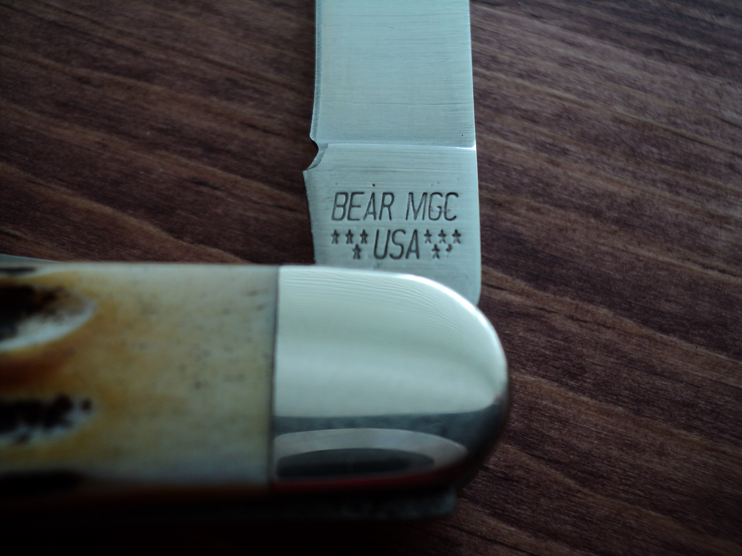

I added the close-up photo of the tang - the date marks appear to be five point stars - there are eight well formed marks and one partial or stray mark.

My review:
Re: Bear & Son - 4" Stockman #547
It will serve you well.I,like you only had bullet knives win it came to Bear.So I started to buy a few Bear MGC and Bear&Son knives.I'm very happy with the Bears I have now and plan to start collecting the Custom Heritage knives they have.There Bear-ops division have some really nice stuff as well.Since we are talking about USA made knives make sure you take a look at the new Bulldog, USA made knives.They as you may know are bin made by Great Eastern Cutlery.

Nice Looks like Bear has put the Turkish Clip on that one.

Thanks for taking the time to write up the review OH, great job! I can't believe that knife was only 29.99, fantastic deal. I have a Bear with that stag bone, it is some good stuff, they do a great job with it I think..looks classy and rustic at the same time, and is functional by allowing for a sure grip.

I have an update on the Bear & Son 547; been doing some whittling lately and decided to try the sheepfoot on the Bear 547 for that purpose. It wasn't sharp enough for whittling so I got out my old Browning Arkansas stone and some honing oil to touch the blade up. Much to my surprise the Bear stainless steel blade sharpened very easily to an extremely sharp edge - I was pleased. Sometimes I struggle with stainless to get the edge I want (a late 1980's Blue Grass Cutlery Winchester being my toughest ever, then my Buck's being easier than the BGC-WIN but tougher than the Bear). At any rate this knife sharpens readily - time will tell how long the edge holds. OH

B&S stainless is easy to sharpen and gets razor sharp. Edge retention, 8 out of 10 IMO. I whittle with my 547, nothing major as I have zero talent but it'll make big sticks into smaller sticks with ease.
