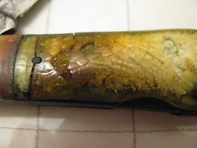

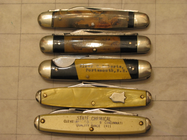

Re: Outgas?

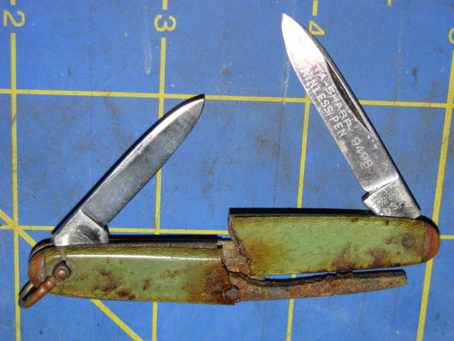

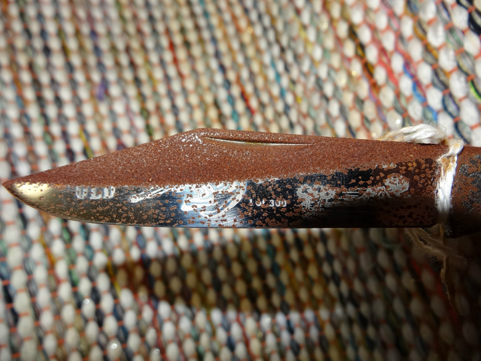

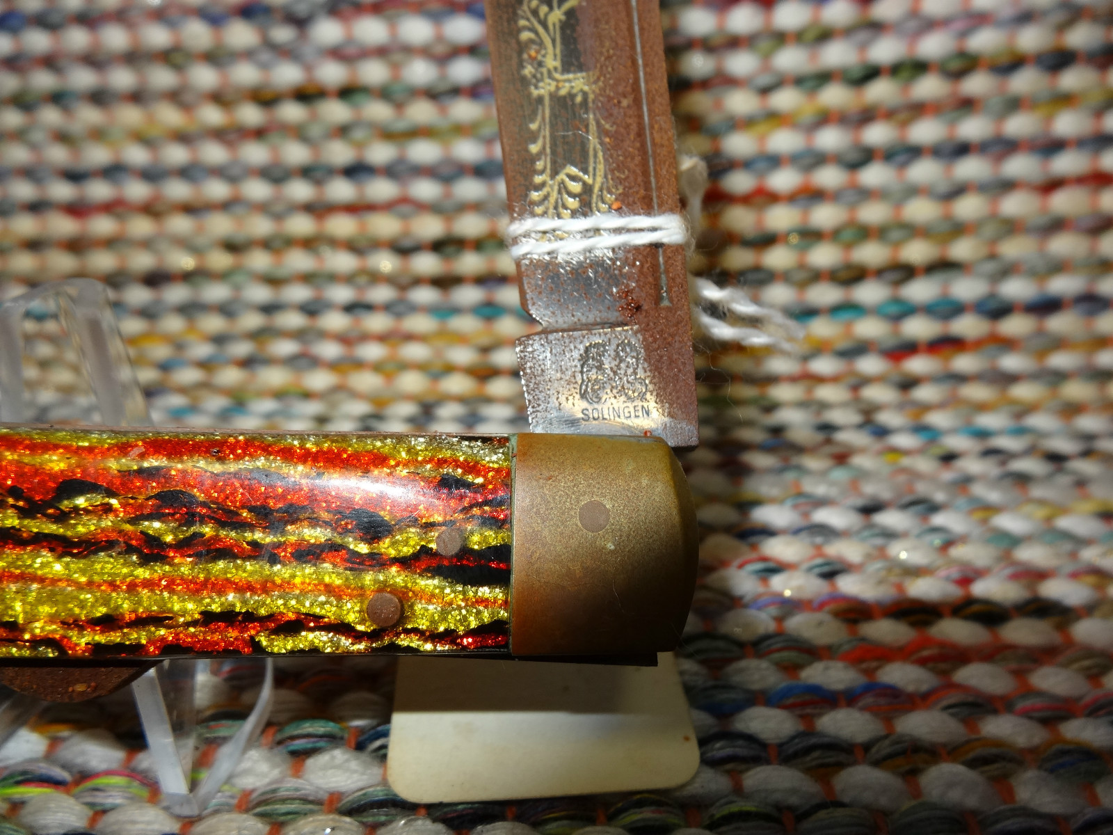

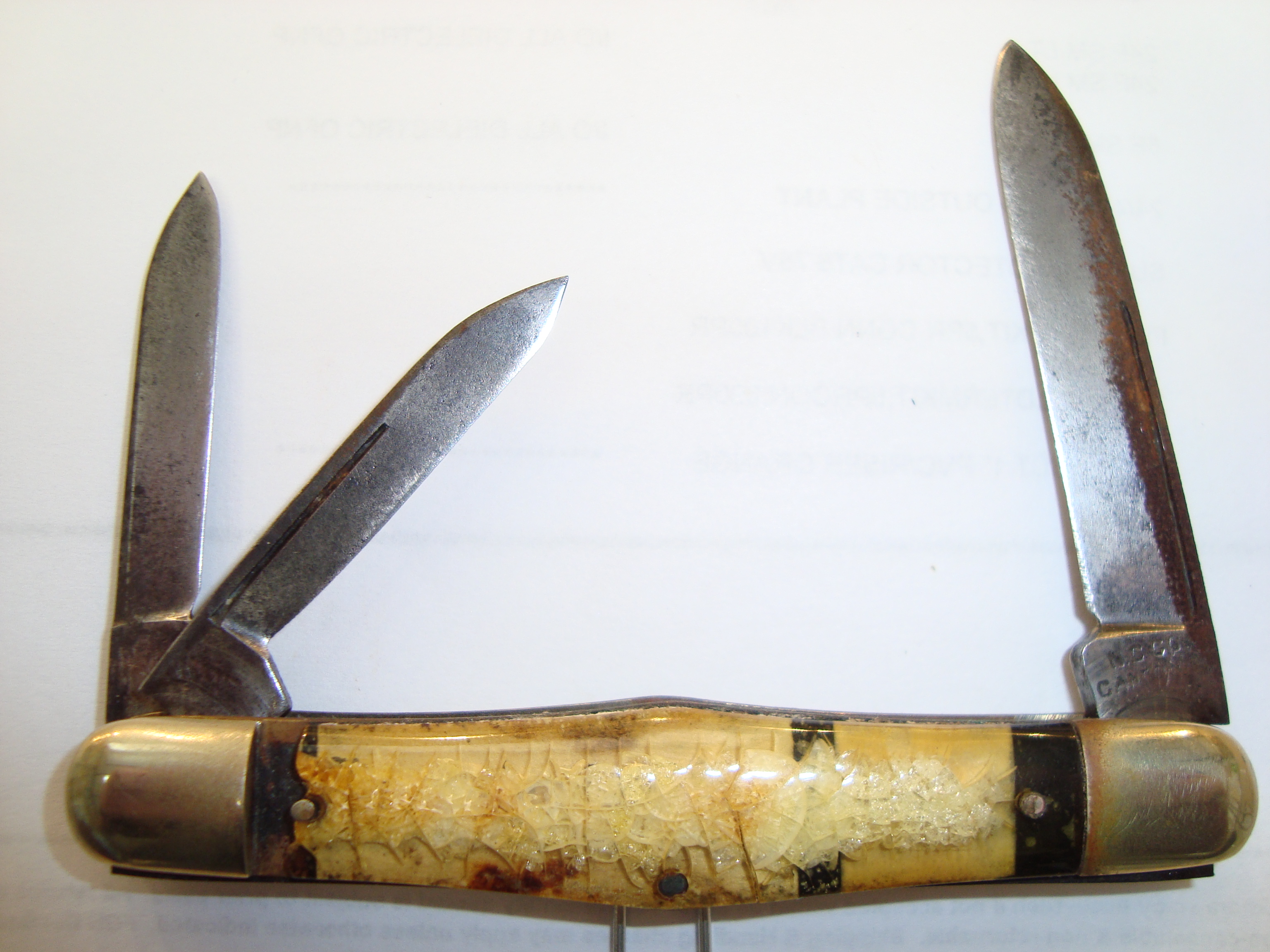

Here are 2 pics of classic outgassing on knives. The first was not my knife, the second is. I ended up putting new covers on the second. It is a serviceable knife now, but still has been permanently scarred by the outgassing.

Re: Outgas?
Do you think the newer Celluloid is as bad as the older ones or probably just as bad. That is a really great and scary example of how bad the damage can be from outgassing handles.glennbad wrote:Here are 2 pics of classic outgassing on knives. The first was not my knife, the second is. I ended up putting new covers on the second. It is a serviceable knife now, but still has been permanently scarred by the outgassing.
Richard
Re: Outgas?
If it is true celluloid, there is always that chance, no matter when it was made. We've even seen the more recent Bulldog cell knives go bad.
While it is also true that certain colors/shades of cell seem to do better than others, the outgas process can happen anytime, anywhere, for no reason at all.
Very strange and tricky stuff, that is why it is always good to keep cell knives apart from your regular handle material knives.

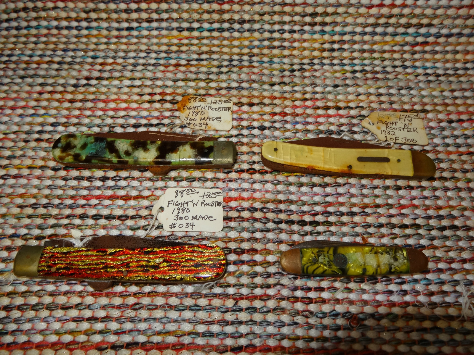

Case Classics,Fight'n Roosters,Bluegrass Winchesters,Buck Creeks are among the Latest that I know that are real gassers.
I think the Case Classic gassers led to the prolific amount of Prototypes with exotic handle materials. When originally made,you could put all the real prototypes in your hand. I think Parker first started getting rid of them as water damaged finds,before the prototype epidemic.

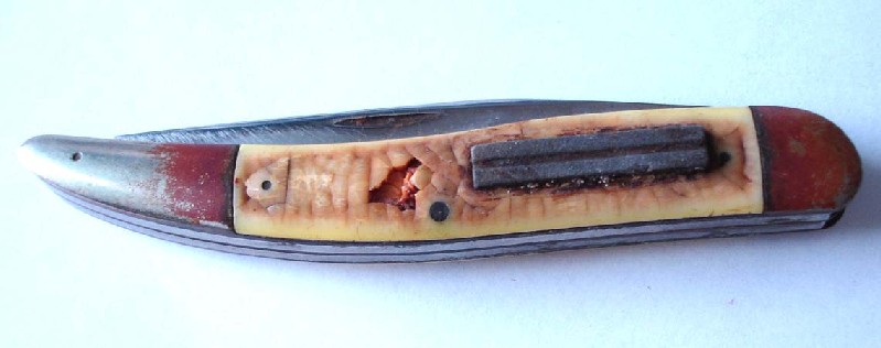

Here's some gassy Fight'n Roosters.

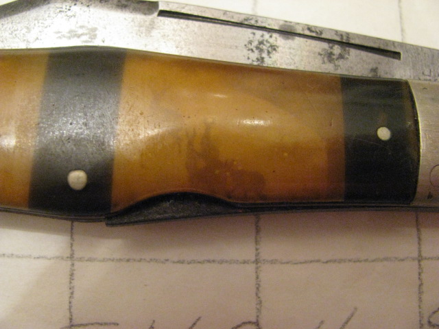

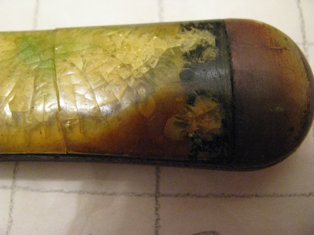

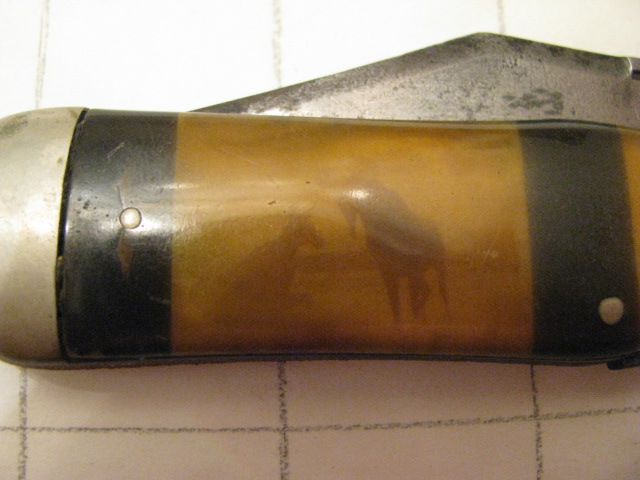

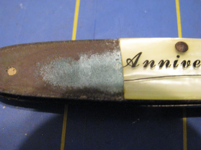

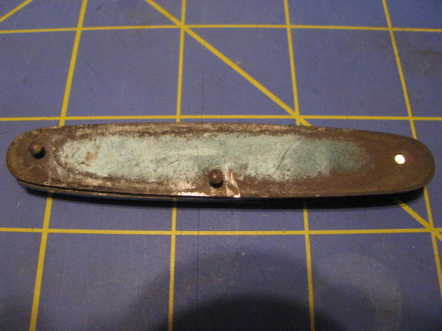

To add to what was already posted;the really insidious part of out-gassing that many times it will show little or no damage to the surface of the celluloid but is raising havoc where the scales meet the liners.What is really strange as well is I have had several examples where one side of the knife completely deteriorated and the other was untouched!One example;an old Novco letter opener knife advertising the US Navy pre-flight school had completely eaten away the scale and brass liner while the other side was perfect.
Some of the examples pictured:A Sta-Sharp 2 blade knife completely ravaged and the stainless steel blades unmarked.
A letter opener knife I cut apart to use the blade to re-construct a Presto letter opener looked fine on the top and under the scales advanced corrosion.
An Aerial Cutlery Co coke bottle folder;again relatively unscathed on one side and destroyed on the other.
I had a Buck Creek lockback that I got brand new and within a year it started to outgas.I kept cleaning it and one day I went to release the lock and the back end of the knife broke off.The scales looked like new on the outside.
On the other end of the scale I have a Novco easy open that looks as good as the day it came out of the factory almost 90 years ago.
