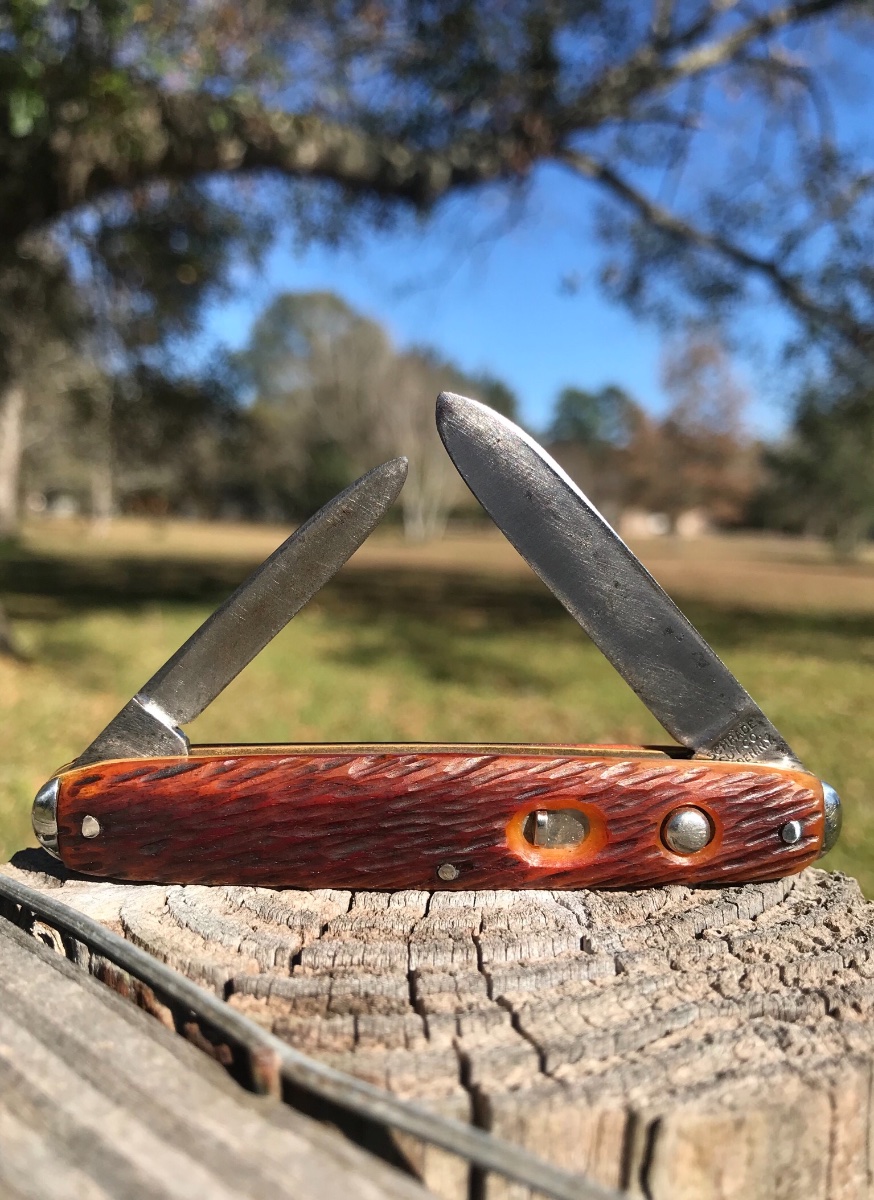

So, since I’ve been waiting for my bone to come in, I decided to fix something else. The original celluloid was torn buy the button, and I couldn’t leave it like that.
Before: After:
Before: After:

How did you make this repair?BFORSE wrote:So, since I’ve been waiting for my bone to come in, I decided to fix something else. The original celluloid was torn buy the button, and I couldn’t leave it like that.
After:

This is a “replace” fix. Searching online for celluloid with the proper thickness and pattern was a virtual bust.
Then there was the problem of forming that celluloid to the correct contour of the shell. It seemed like a hopeless case, especially the amount of effort for such an inexpensive knife; so finding a willing donor was the only option I had left. A perfect donor was found that had his tip snapped off, and fairly decent celluloid. Having some experience with shelled knife repair, I knew I had to be very careful when bending the tabs. The most nerve racking part was removing the celluloid. I started with the donor knife first just in case I tore the celluloid. I used a blow dryer on the lowest setting to help make it a little more flexible; take some of the brittleness out. Then I carefully, slowly, started to push the celluloid tabs on one side off the shell. Once that was accomplished, I removed all the celluloid from both knives so I wouldn’t have a mixed batch on my knife. Then I cut the tabs off of the original celluloid that had the tear, placed it on top of my donor piece, lined up the contours, taped them together and used the old celluloid holes as a template for cutting new holes in the donor piece. I used a Dremel with a very small engraver bit, and cut the holes out. Then I used a tapered sanding bit to fine tune my cuts. All cutting was done with the dremel on the lowest setting and without any force to minimize friction that could melt the celluloid.

Excellent job, and nice detailed tutorial! Very impressive!
If you have opportunity to pick up a Foredom, which is a rotary flex shaft tool, I'm certain you won't regret it if you do any amount of work with a Dremel at all. The Foredom can work at very low speeds and has lots of torque. Usually the Dremel needs extremely high speeds to be effective, the Foredom is the opposite; low speed, high torque.

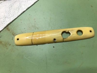

Thanks Byrd! Well, I’ve pretty much finished the chicken coop and painted a cat portrait by the time I started my week long thanksgiving break.
Next comes the hours of thinning the slabs and routing the holes for the buttons and locks. I would periodically hold the scales to the light to see my thin spots.
So, originally I had decided to go back with faux ivory, then it was suggested that I go back with bone. I liked the bone idea better. I knew this would be a massive undertaking but I also knew that I would learn a lot in the process... this was definitely not a plug and play project and I didn’t have much to work with.
I decided to use one bone slab as a test piece and use the other nicer looking bone as my slabs. I had just enough width to cut two pieces from one slab. My thinking was that the two slabs would be, for the most part, identical in grain and color.
Of course I took my time and sawed it but hand so I wouldn’t be in a hurry and make a mistake with the band saw. So that took some time. I also had some mineral spirits left over from painting so I through the knife in to loosen up any old grease oil and lint.

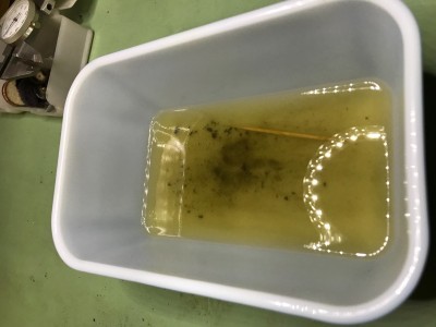

So while the knife cooking in the mineral spirits I tried my best to compensate for the shrinkage and tape together the remnants of the celluloid handle for a template.

It is important to test fit your button and lock with the bone slab as you take material away.
While test fitting one of the slabs I found the reason why one side originally split and fell off. The dimensions were slightly off from the factory; the spring and button were putting excess pressure on the scale. I notice that the curvature of the spring did not match the other.

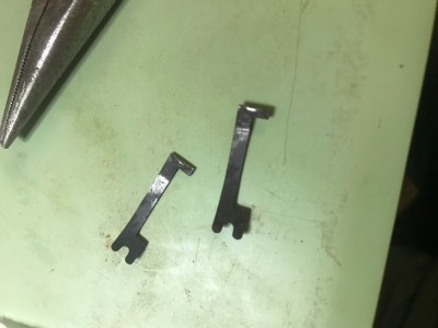

So.... i knew the odds of success going in, and for me personally bending a spring had been about 50/50... but not this day.
100% fail... WHERE’S MY BALL PEEN! Obviously there must be something wrong with my head that needs fixing. So now what? Where do you go to buy a NOS spring for a 80 or 90+ year old schrade double switchblade??? To the best of my knowledge you don’t....You pull yourself together and start thinking of a solution. This popped into my head, but would it work? It had to!
A little dremel and hand file work and you have yourself a replacement spring! Make sure you go slow and constantly cool the metal before it gets hot.

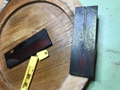

Now I think I had originally said I would do a pick bone but I don’t think that would be an accurate jigging pattern for the particular date of this knife so I tried replicating the pattern that might fit it the best. It turned out alright but not as close as I would have liked, partially because of the thickness of the bone and me not wanting to jig as deep Incase it broke.
Time to DYE!!!
All I had was a water based leather dye and by this time I was ready for this project to come to and end so I dyed it several time till it dried, wiping off what would come off in between coats. It was finally done. A good EDC that may hold up for another 80+ years.

Wow BFORSE, beautiful work!
Excellent job on the jigging, I would say, also on the spring rebuild!
Dan

Nice Job, looks like you do his everyday. Beautiful knife.
Harold

Great job on the rehandle.
