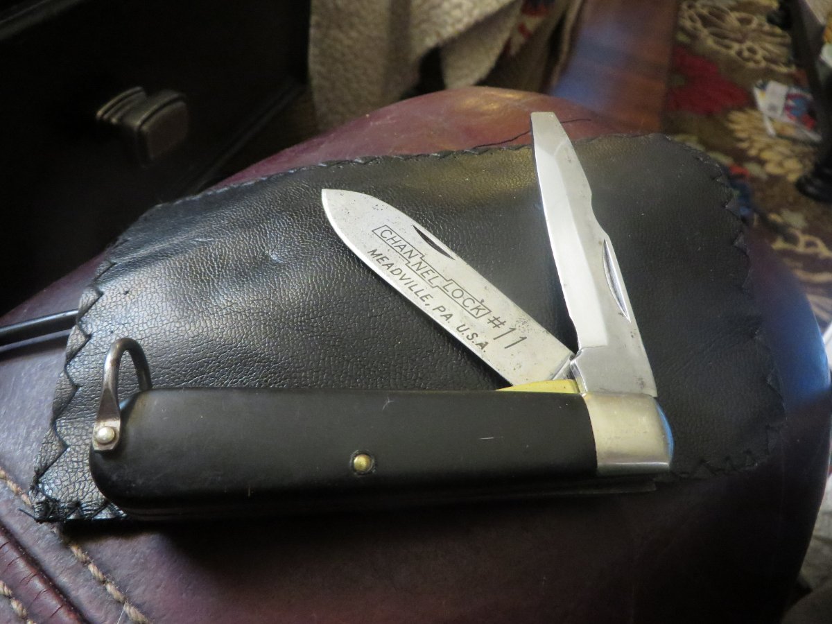

I primarily collect old Gerber folders. Many have brass and wood handles, and of course tarnish is a serious condition. I sometimes buy several knives to get the Gerber I want and have accumulated several such as a Camillus electricians knife that cleaned up to look almost unused. On the other side of the coin I see some who say you should leave the "patina" intact. I have been sharpening knives with whet stones for 50 years, and can put a shaving edge on a knife without leaving a single scratch on the blade, and I do so with every knife I own. I also use 600 grit sandpaper and jewelers rouge to remove discoloration and superficial black spots. That's about as far as I care to go with a knife, and don't feel I am hurting the value of a vintage knife, after all they are a tool, and should be kept in the same condition you would a micrometer or precision scale.

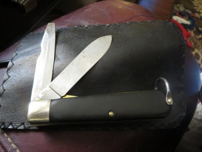

Got a Camillis electricians knife that was horribly neglected and filthy. To my surprise, very little cleaning revealed an almost new knife, obviously never used. I used jewelers rouge on a felt pad and rubbed by hand. The channel lock etching on the blade was totally intact.

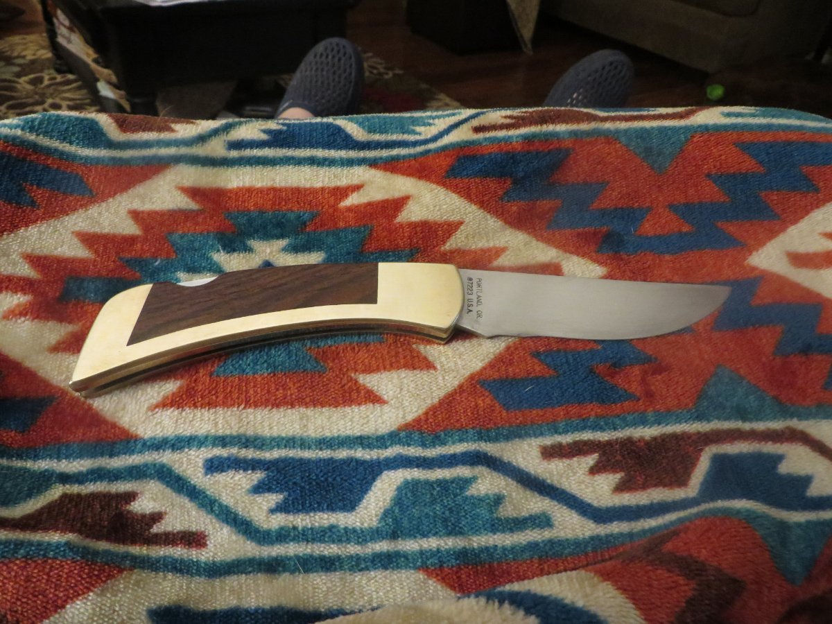

Here is what was a badly abused Gerber Sportsman III. It is somewhat rare, and the blade was badly scratched and the handle tarnished. It also had the dullest blade I ever saw on any Gerber. I carefully removed the scratches with a die makers stone, and then polished it to a low gloss finish with 600 grit sand paper and jewelers rouge on a scrap of felt. It is obviously not a new knife, but no longer shows the abuse it suffered...I also stoned it back to a shaving edge using a tri-hone...
