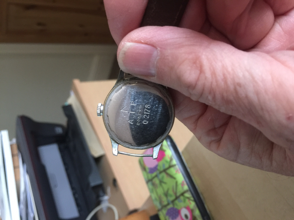

This one of two Cortebert ATP watches I own. This one is interesting because the ATP marks have scores through them and the watch reissued the RAF some time during the WW2 or shortly after the end of hostilities. Its unlikely that any records exist now most being lost or destroyed after the war.
Like knives there are schools of thought to cleaning, I will do the minimum to get it working but leave its "patina" alone, I have resumes in the past but it never looks right to me.
This works now, it was bought as a non runner but I stripped and reoiled and fitted a new main spring.

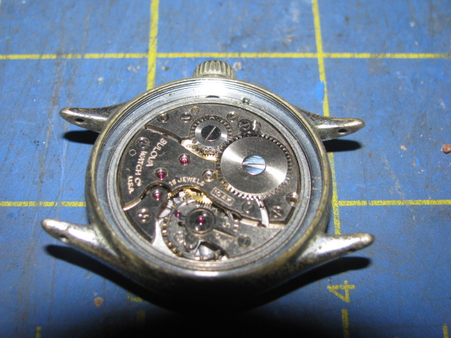

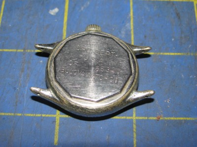

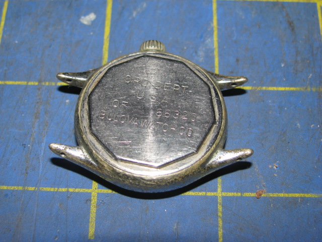

Looking through this post I thought I remembered having such a watch in my pile of parts watches and the like and sure enough I did. Pulled the case back off and found it is a 15 jewel Bulova.Doesn't work though;the balance wheel doesn't seem to function;looks like it might be off the pivot points. The case is a bit corroded but the internals seem to be intact. Is it worth having it fixed? Case is stamped "Ord Dept- of 66320 -Bulova Watch Co" in three lines

I would say it is worth repairing but it all depends how much that's going to cost you. I've not got any Bulova but they are good watches and were issued via the USA ordinance dept. Can you take a photo without flask K7K? The numbers would then be legible and i suspect you would be able to get a clearer idea when it was issued.
I like the look of the watch and i would repair it. Since giving up collecting knives I've taught myself how to service and repair to a degree my military watches so if i can get the spares thats the only cost. A quick look on the UK eBay does reveal a market around £100 -200 but you will i suspect see higher retail prices.

knife7knut wrote:Looking through this post I thought I remembered having such a watch in my pile of parts watches and the like and sure enough I did. Pulled the case back off and found it is a 15 jewel Bulova.Doesn't work though;the balance wheel doesn't seem to function;looks like it might be off the pivot points. The case is a bit corroded but the internals seem to be intact. Is it worth having it fixed? Case is stamped "Ord Dept- of 66320 -Bulova Watch Co" in three lines
You describe it having a broken balance staff. Common non shock jeweled movements.

GerryD wrote:K7K I've just found this thread on MWR looks like its WWII and army ground forces http://www.mwrforum.net/forums/showthre ... PT-Watches
OK I looked at this site and the case number on mine is OF 66320. Inside the waterproof case it is a 15 jewel movement marked 10 AK whatever that means. Not sure if it is broken or dislodged but the balance shaft(the thing with the spring on it) does not turn when the watch is shaken.
I am going to take it to my local jeweler who is into vintage watches and does a lot of repair work and get an estimate to repair it.
10 AK refers to who actually made the movement for them.
