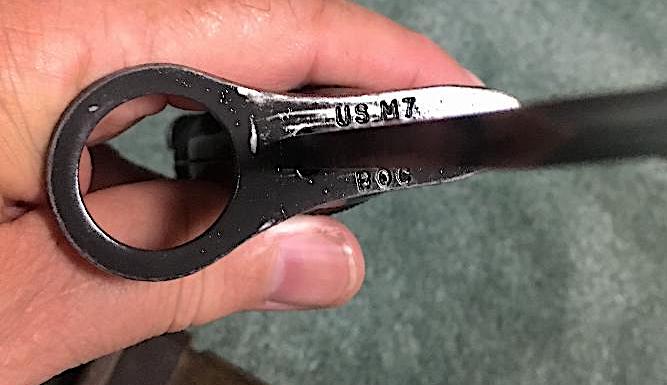

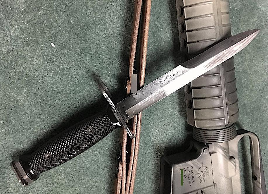

I just picked up this old M7 bayonet at the gunshow today. BOC would be Bauer Ordnance Corp I think. Probably circa 1969.

I believe that YOUR M7 is a very early production version. If you look at the backcut, the grind is very nearly a 90 degree grind. This is very much like the backcut on the M4, M5 and M6 bayonets. The early M7s had backcuts that looked more like the left most bayonet in the picture below.
The M7 was introduced in 1964, the same year that the M16 began phase in. Bauer was one of the initial manufacturers of the M7, producing about 1M of them.
