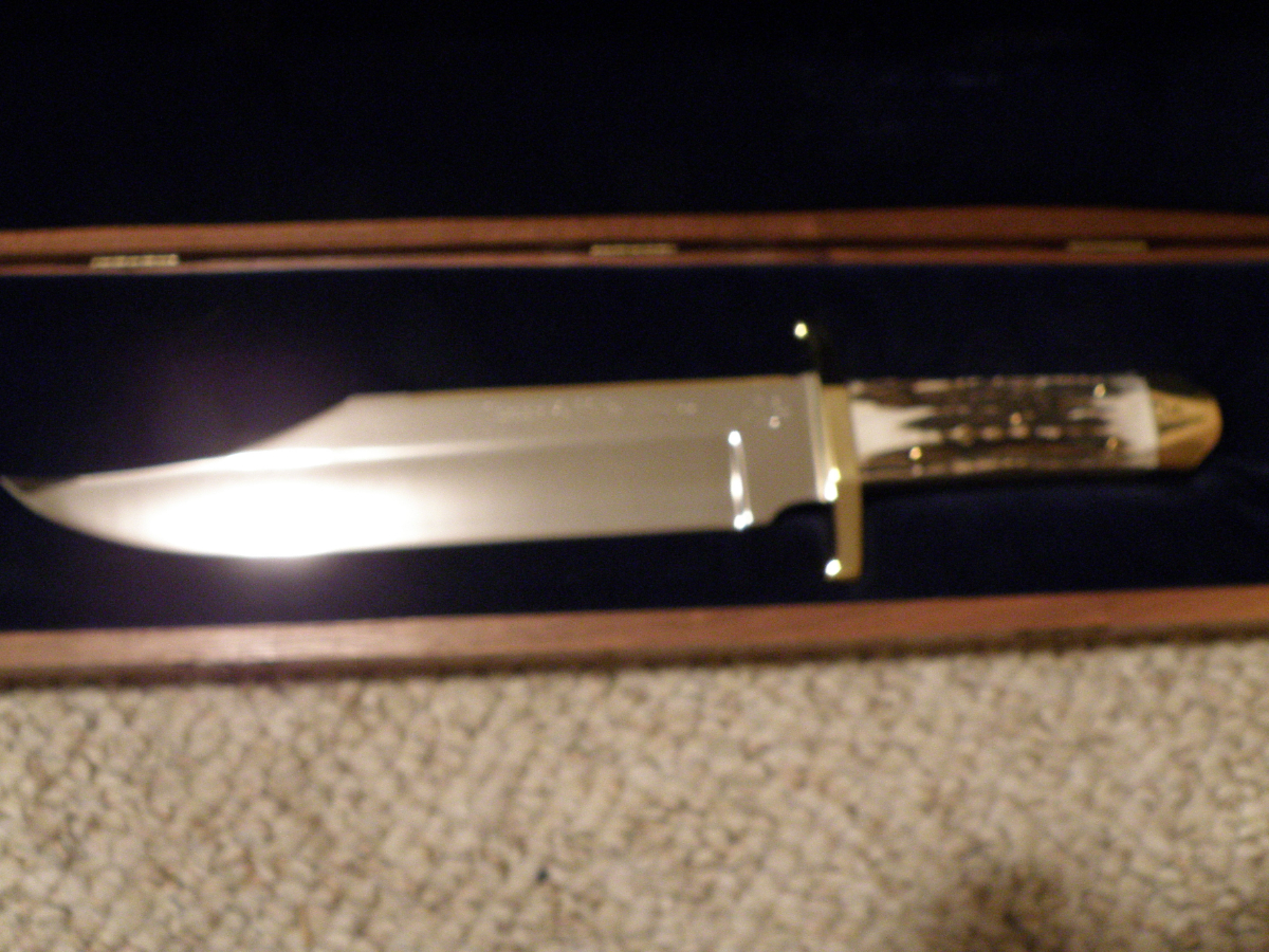

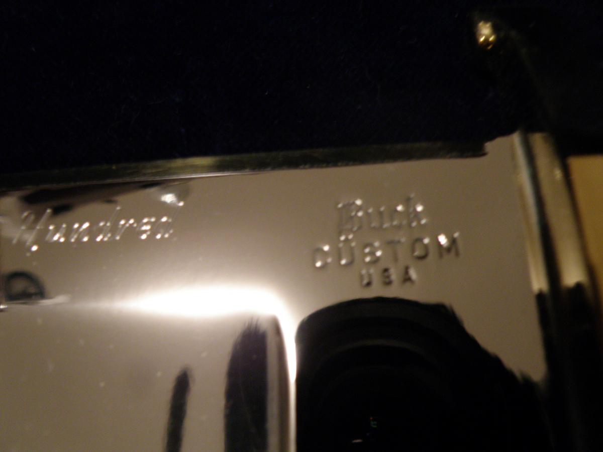

The first Buck "Custom" from the custom shop was in 1981. It was a large 903 pattern stag bowie. This knife was made for Cutlery World and came in a walnut presentation box and retailed for $600. From my research there were 3 variations, the prototypes and 1-14 had the brass blade catcher inlaid on the spine of the blade, 15-21 the brass was overlaid with rivets and 22-100 were just brass overlays. The tang was longer than other 903's to accommodate the large brass pommel. Per Leroy Remer (Former Buck custom maker) the stag on the handles was never matched side to side.

kossetx
Posts: 118
Joined: Thu May 04, 2017 5:02 pm
Re: When did Buck start stamping stag knives CUSTOM?
Post by kossetx »
Nice knife!!
There was a factory stag 3 dot 112 that sold the other day on ebay. It had only the 3 dot buck stamp but it came with a correct and marked as "stag" 112 box so even some early stag wasn't marked on the blade. The box was custom for the knife being like a 10X series box not the shorter 11X series box but it was Buck marked.
