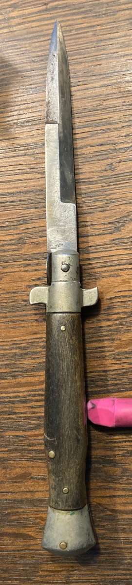

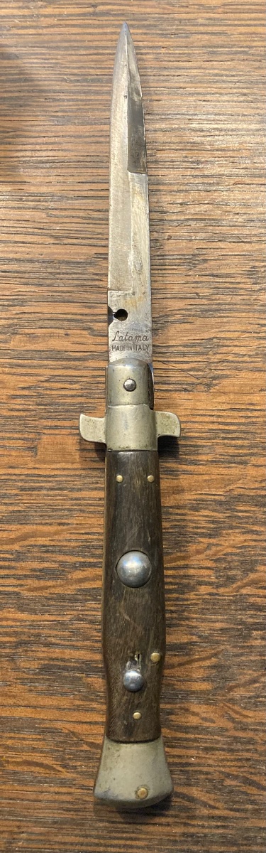

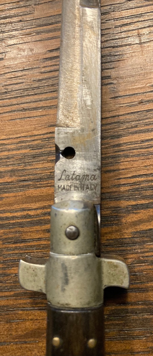

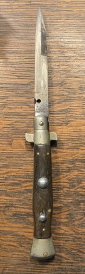

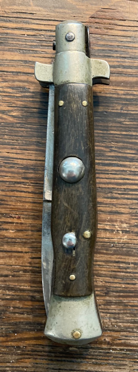

A good friend gave me this 7-7/8" Latama over the weekend. From what I read it is a Wasp body, pre 1951?????. Needs a bit of repair, when lock is released it fires open. Other than that it is in pretty good shape.
Regarding "peek", does not, pic attached.

Nice!! Flat guard, I think it's an earlier one.

8) wow what a friend :) that is a Latama Flatguard wasp body picklock yes most likely from 1940's , restoration is a sticky subject as some would not touch that knife and leave it like it is and others would want to restore it and pretty it up :lol: .
i would not touch it and would leave it like it is , it is worth a pretty penny for sure ::tu::

I think it looks awesome as-is, high on my bucket list. I would think the elongated sear hole has it peeking when shut. The corrective measure to fix that is probably more harm than good in terms of the knife's antique integrity, would involve laser welding or something along those lines. If you polled 20 collectors, half would say get that done half would say leave it alone, maybe even 70/30 to leave it alone.

Beautiful old picklock John, wish I had friends like yours, oh, never mind, I actually do. My pal Herb just sent me free of charge, a beat-up slant bolster model to restore, so it seems I do have friends like yours. It appears the ramp leading to the sear hole has worn down and joined the hole, thus the firing when unlocked cuz the sear-pin has nothing to seat itself into. This is strictly the opinion of a knife accumulator more than collector, but I know if the knife was mine, I would want it in perfect operating condition for me to enjoy. As-is it's simply something for people to admire and comment on about how much they wished it was working, how fortunate you are to own it, and how valuable it is, which are all valid points to a collector, not so much to an accumulator. I believe automatic knives are to be used by some, played with by others, and loved by all! Whatever you decide to do with your new gift, enjoy it! 8)
