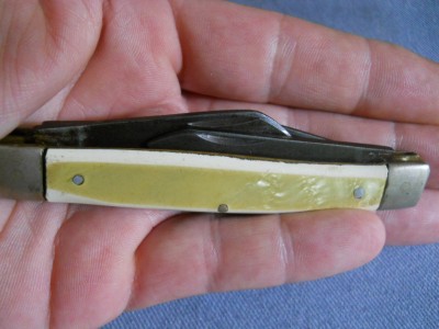

Goins` Encyclopedia dates the curved stamp: c. 1926 - 1938
I have a nice example of it - the clearest curved stamp I have ever encountered.
It is on a stockman that measures nearly 4 inches!
I'll edit in a picture.
..... Joe
..... Joe

Re: help with the Colonial tang stamps
Good info thanks. First time I have herd of it.Joe Dirt wrote:Goins` Encyclopedia dates the curved stamp: c. 1926 - 1938
..... Joe

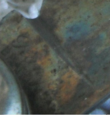

In Scott's post on the Palco Forest-Master, chetr1200c posted a link that I've copied, to a Colonial Ranger Brand that is in script.
(Thanks and hope you don't mind, Chet. )
The later (1970's) "RANGER'' knives are stamped in block letters.
Goins` dates this script stamp to 1938... the first year of the shell handle knives made by Colonial.
I enlarged the pic of the stamp as large as possible while trying to keep fair resolution.
http://www.ebay.com/itm/ws/eBayISAPI.dl ... true&rt=nc
In Goins` book - there are quite a few images of the "markings" that were used by Colonial.
NOT ALL of these "markings" were tang stamps. Some are shields and others are blade stamps/etches.
Also, at least for the "Sure-Snap" image, it is from advertising... these autos were tang stamped in 3 straight lines:
Sure-Snap
Colonial
__ U.S.A.
The space ahead of "U.S.A." is cut-out for the lock and there is slight evidence of "Prov." being stamped there
before the lock notch was cut in the tang.
...... Joe
Now Chet... NEVER ignored, my friend . Maybe everything else, but NOT ignored!
This knife has "Pat. Pend." under the stamp. It's most likely for the integral bolster/liner.
Unfortunately there no patent No.'s to go with it - hence Pat. "Pending." I don't recall ever seeing No.'s on these.
I'm REALLY bad with Google's Patent Search but maybe someone else has better understanding
of how to navigate around it.
Maybe use some key words like "integrated" or "integral" or anything else the one piece liner/bolster
may be called, and search Colonial Knife Company. IF the patent was granted - it will give us a date
for these solid construction - yet hollow tip bolstered knives!!!!!!?
Many companies made knives like this, so I don't know if the patent was even granted.
..... Joe
