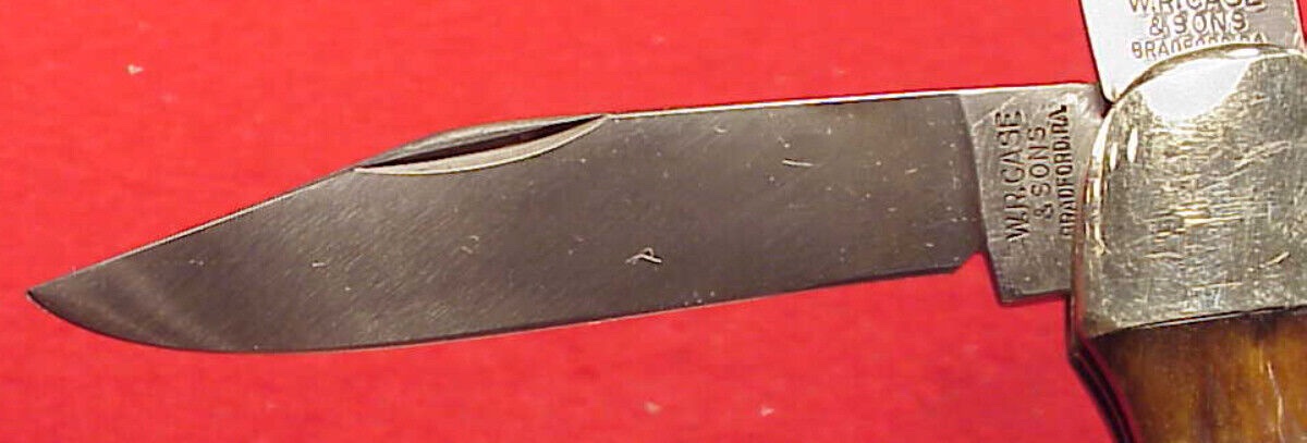

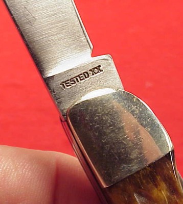

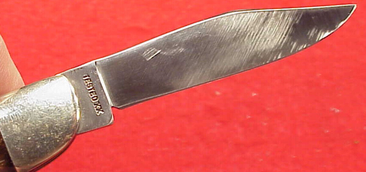

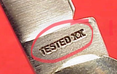

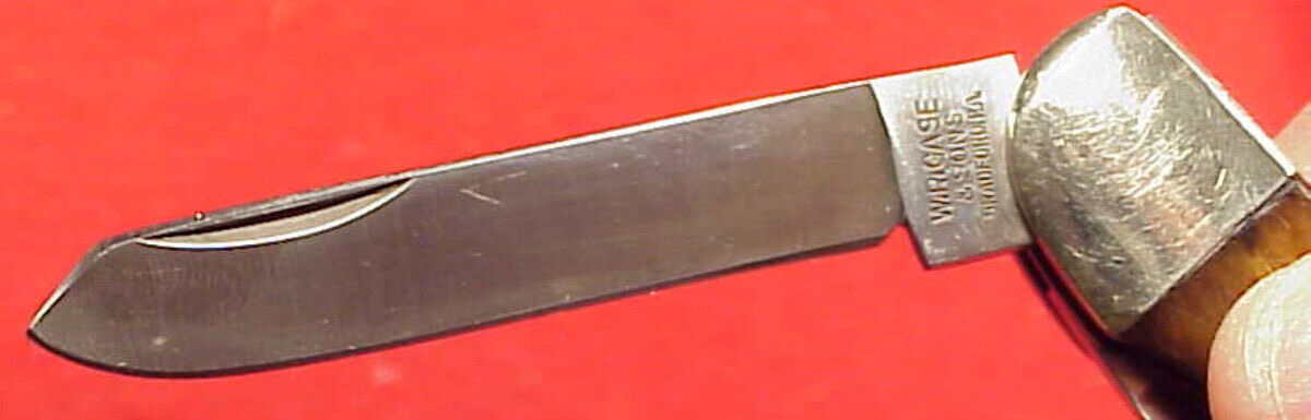

Agree, it’s “not right” IMHO. I don’t think the pattern existed in the W.R. Case & Sons era (Witcher says it first appeared in the W.R. Case line during the TESTED era in late 1920s*), and if it did it wouldn’t have been stamped “TESTED XX” since W.R. Case didn’t have the right to use that mark until acquiring the rights to it from competitor Case Brothers, as a result of their bankruptcy. At which time W.R. Case changed their stamp to CASE BRADFORD or CASE’S BRADFORD, and began using the TESTED XX and CASE’s TESTED stamps.

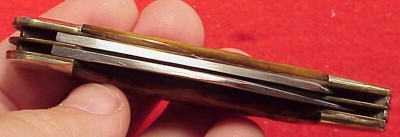

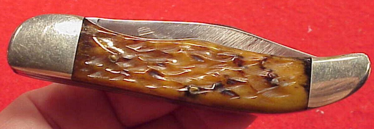

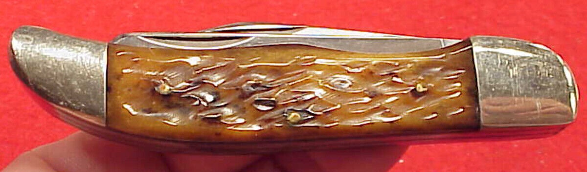

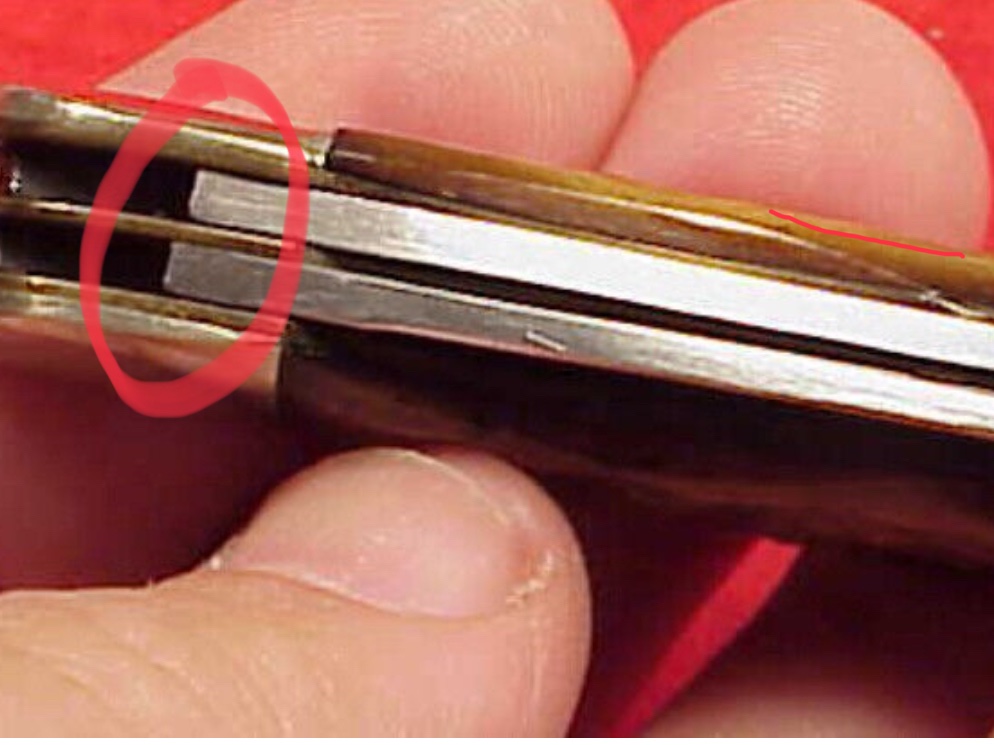

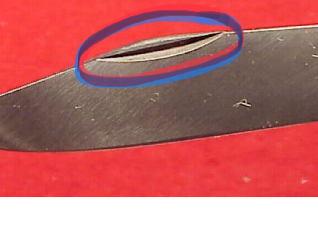

As if that’s not enough, I don’t like the jigging, nor the nail nicks running off the blade, nor the grind marks on the blades. The butt end of the tangs aren’t evenly set in the frame. (I suppose it might be an optical illusion created by photo angle, but I don’t think so.). Then there’s the stamps - look cold stamped to me. I’d be interested to hear what those who’ve seen and handled a lot of older Case knives think. ::shrug::

I’m no expert in spotting counterfeits and I could see that was a fake. The “tested xx” is no where close in apprearance to what it should look like. That stuck out like a sore thumb. I hope he didn’t pay a lot for that stamp, he didn’t get his money’s worth.

First of all, are these blades stainless? They look like re-stamped Frost or some other Japan-made knife from the late 80's or 90's.
The jigging looks like no Case jigging I've seen, even the older ones, but having said that, who really knows. The bone scales look older than the blades lets just say that.
