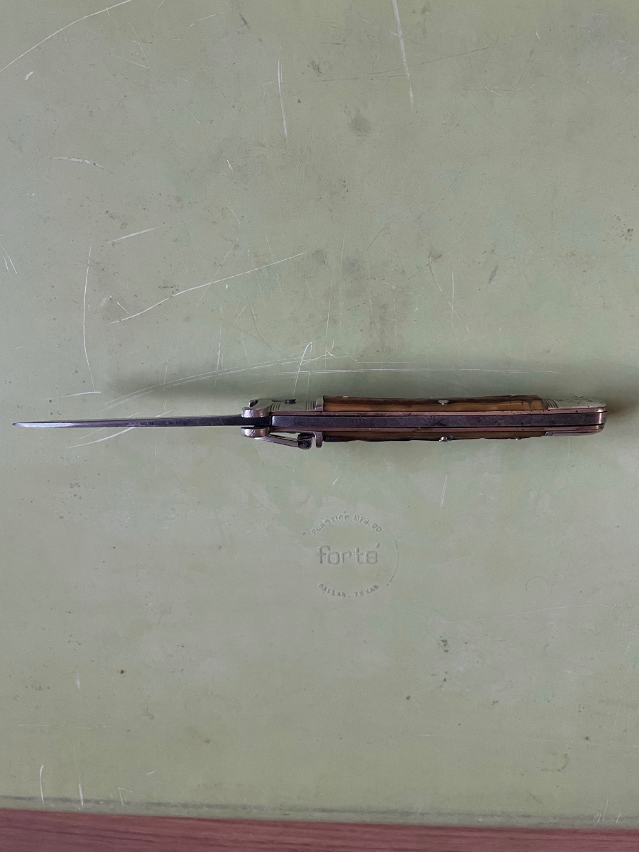

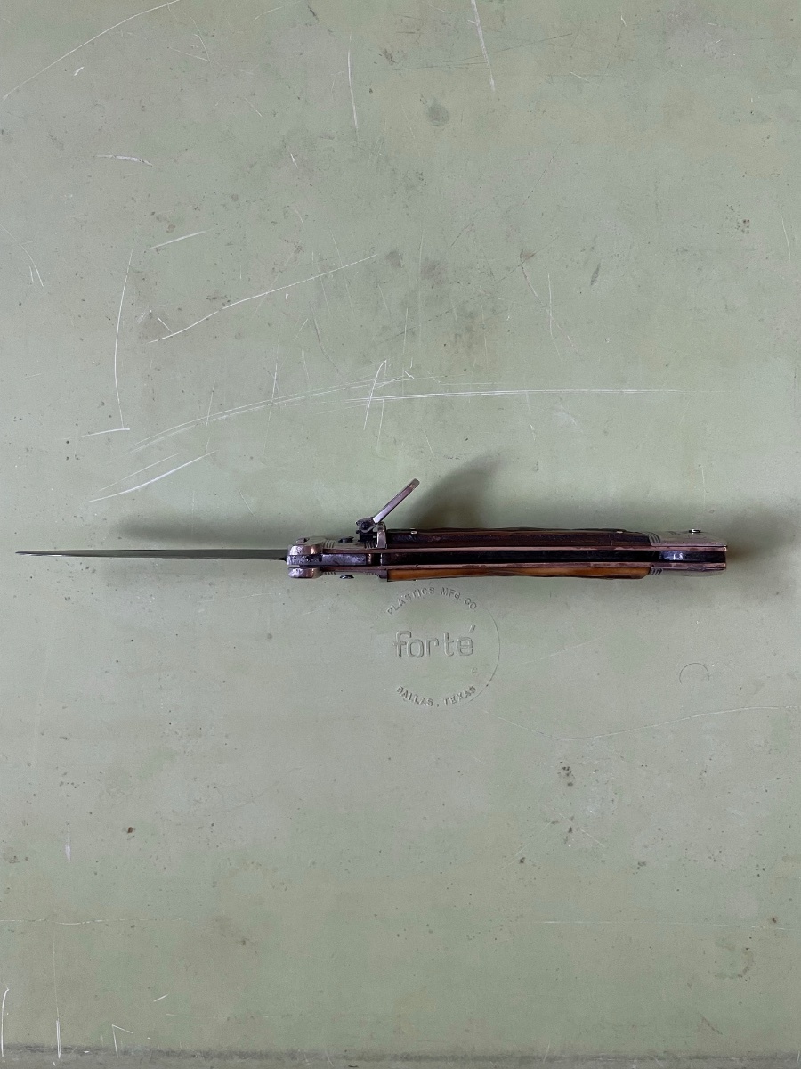

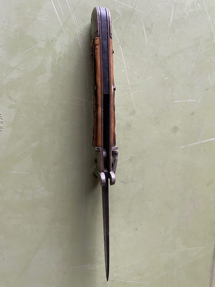

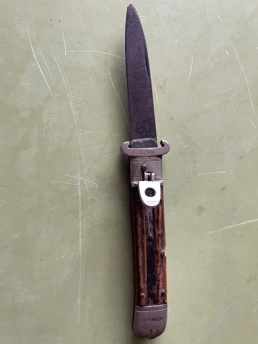

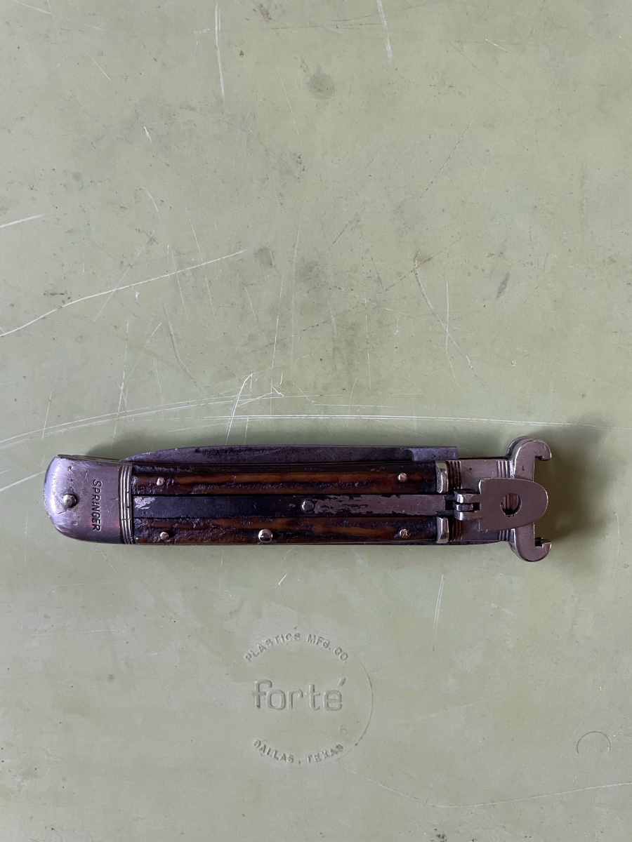

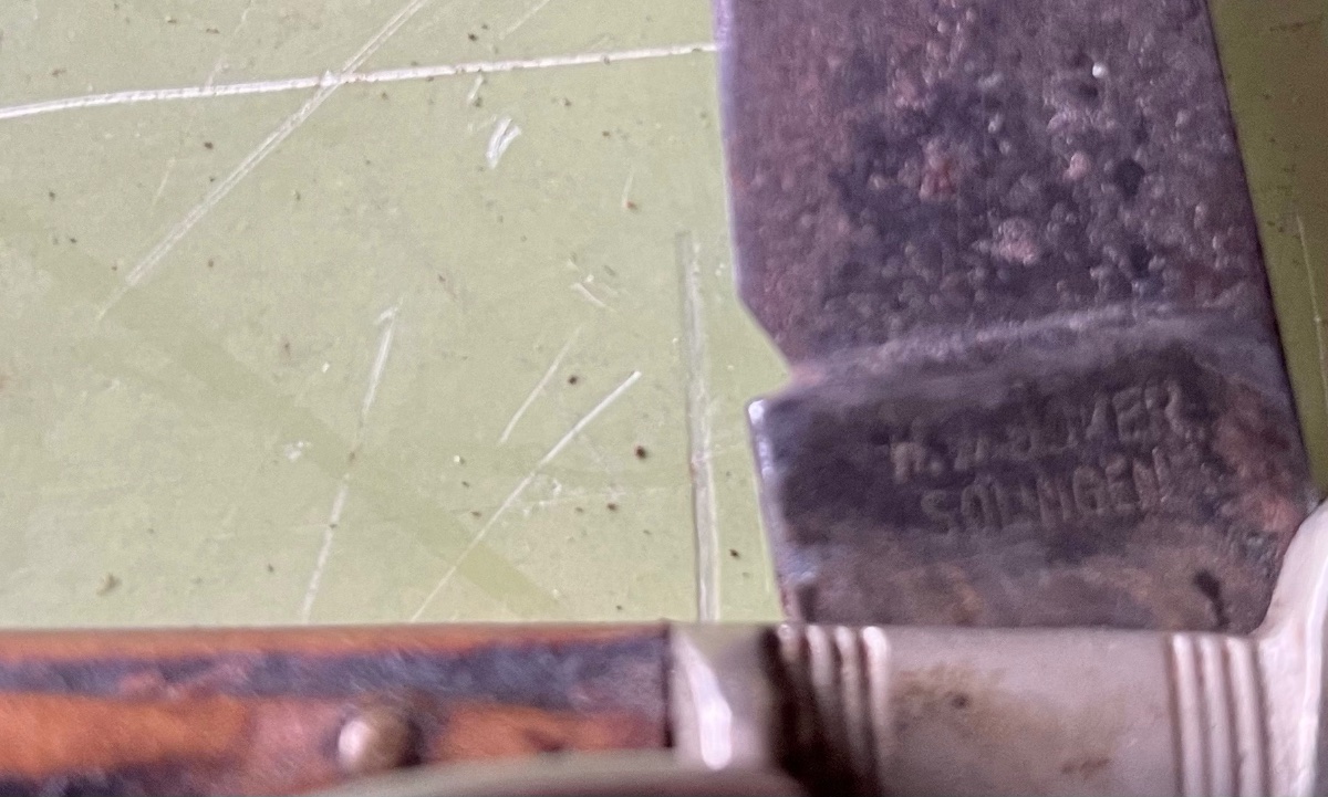

I recently acquired this old “H W Boker” shell puller that has a worn, chipped blade, no kick spring and worst of all, a broken back spring. Since I believe the tang mark is rare and it has nice stag scales and nickel silver bolsters and liners, I’m going to attempt to restore it using a donor “springer” from the same era with the same dimensions. (The donor knife has a working mechanism. But it has a very poor blade that a previous owner had mangled with a bench grinder.)
I’ll post results and possibly a sequence of my progress when I get going on this project. (I thought folks would like to see my recent acquisition anyway.)

Unless the backspring is an exact fit, you will be better off making a new one.

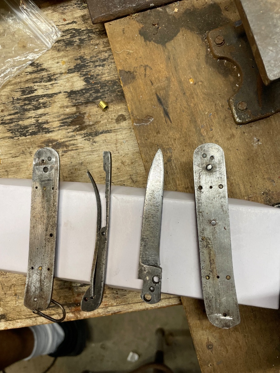

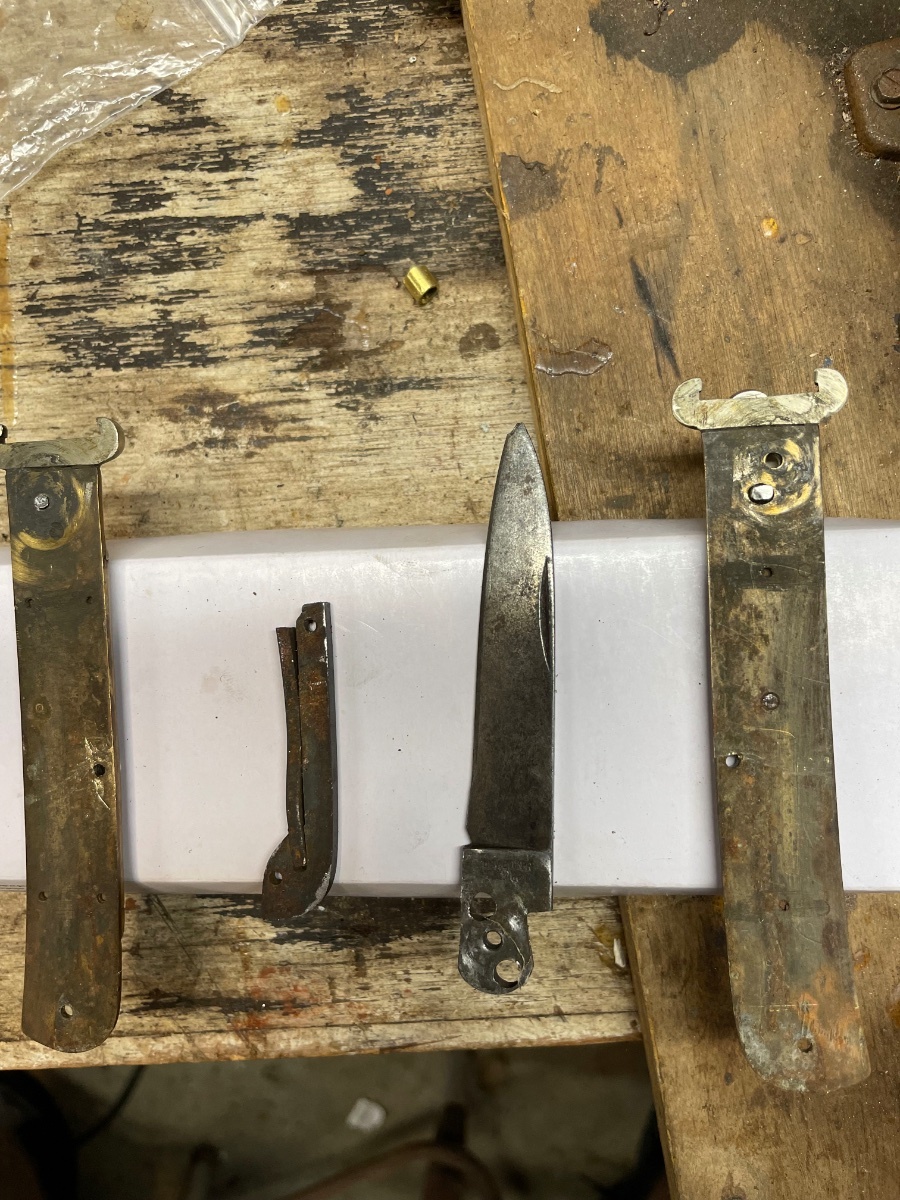

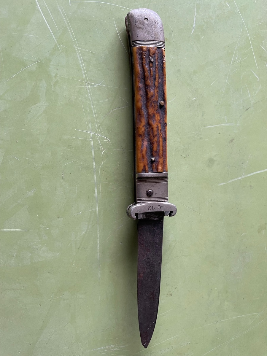

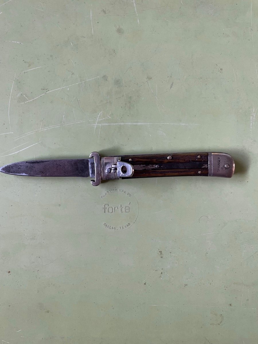

Here’s the Boker shell puller that I was able to repair to working order. The project was more involved than I thought, but I had a good parts knife that provided a good back spring and kick spring. The processes included:
1. Grinding the kick spring to accommodate blade action.
2. Drilling the blade pivot and bolster to accommodate a new pivot pin.
3. Turning a new pivot pin from a nail using my drill press and a mill file.
4. I “delicately” welded the blade sear hole in the worn area to create a smaller opening.
5. Using needle files, I carefully filed the hole to the size of my sear. This step included lots of “trial and error” fitting.
6. I then reassembled the knife and cut and peened the pins.
7. Finally, I profiled the damaged tip.

Thanks for the compliments! I was a bit apprehensive to tackle this one, but the stag and the nickel silver were nice, plus the tang mark was a bit unusual. This was my second attempt to actual try to spot weld he sear hole smaller. (I practiced on an old lawnmower blade to get the correct setting on my cheap little welder. )
I’m happy with the result. It’s not good as new, but it’s better than it was!
Thanks to all who have contributed switchblade repair tips to various forums, especially Bill DeShivs!
