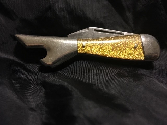

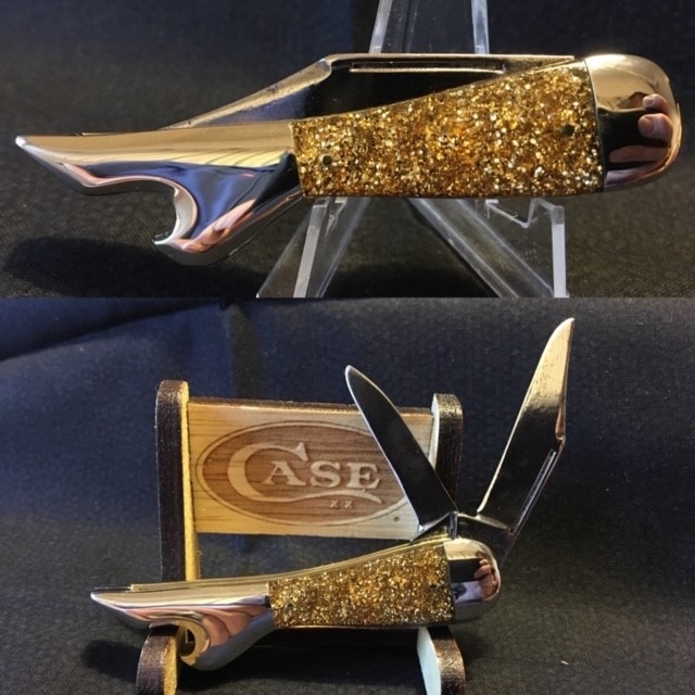

Also here are a couple of pictures for comparison, courtesy of a Case Collector’s Club member. Note the “depth” appearance of the celluloid, versus the acrylic.
Every one wants a short cut, but there is no substitute for looking at (and handling) a lot of knives. You should study pictures of celluloid objects - there are hundreds if not thousands of pictures of celluloid knives here at AAPK - the keyword search capability is your friend! Celluloid has a “look” about it that is difficult or impossible to duplicate, especially celluloids with “swirled” and other patterns. Here is a good place to start viewtopic.php?t=54365
