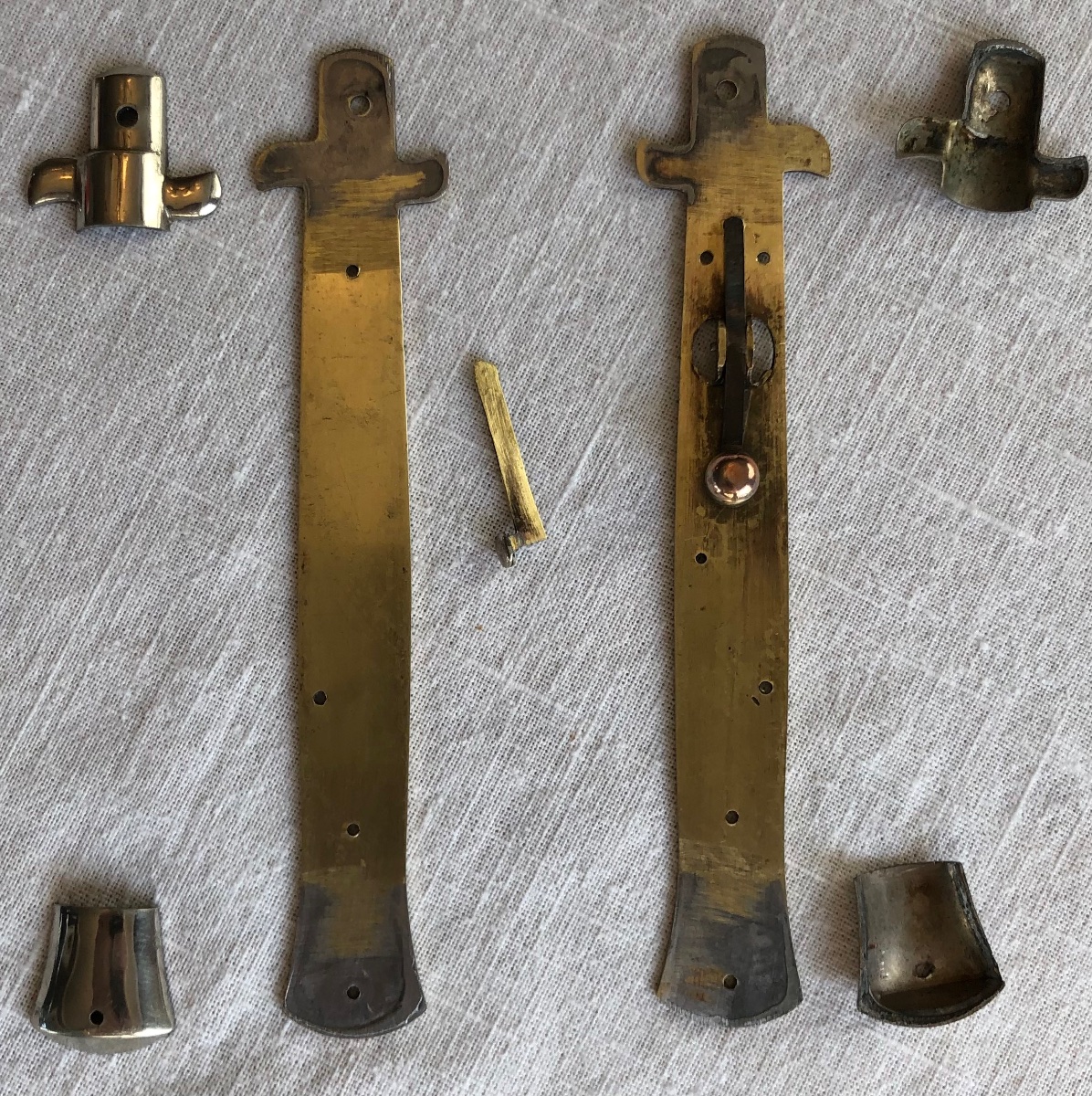

... I believe any stiletto style switchblade made prior to 1950 with flat guards will have the two-piece front bolsters with the "ears" soldered on... when the one piece stamped front bolsters started in use around 1948, the "ears" have a rounded look, and were integral with the whole bolster... however,.. the step line on the guards was very clearly defined, and looks almost like the early soldered on ones... a feature unfortunately lacking in later knives... I have an old Frosolone made switchblade with two piece brass bolsters, and the silver solder line is easily seen.... post some photos of your knife.....

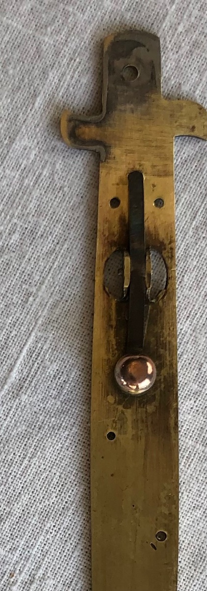

... HVAC,.. Great photos ....look like you have a 1950' thru 58 "D" stamped knife... yes, the bolsters are soldered on, but they are the die stamped one piece type, meaning the guards or "ears" are made into the bolster instead made separately and soldered together... it is a quality knife as the liners are full brass and covering the ears.. it looks like the button spring is missing... It is worth repairing.. are the handle scales and blade in good shape,..? ... is there a stamp or stamps on the blade,..? ... thanx...

The blade isn't marked it also is pitted butt I think I can work that out, it needs new handles I have the horn scale but that is out of my ability hoping to fine someone that can carve out the handles?tenntuxedo wrote: ↑Tue Dec 05, 2023 9:42 pm ... HVAC,.. Great photos ....look like you have a 1950' thru 58 "D" stamped knife... yes, the bolsters are soldered on, but they are the die stamped one piece type, meaning the guards or "ears" are made into the bolster instead made separately and soldered together... it is a quality knife as the liners are full brass and covering the ears.. it looks like the button spring is missing... It is worth repairing.. are the handle scales and blade in good shape,..? ... is there a stamp or stamps on the blade,..? ... thanx...

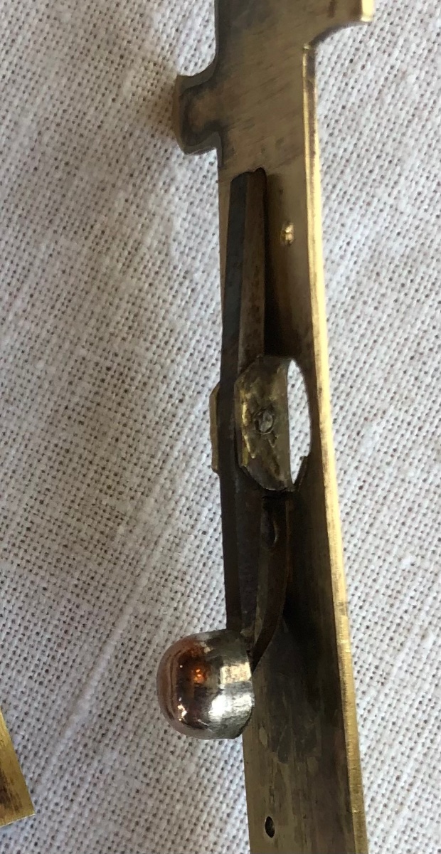

The button spring us under the button.

Yes, it is there,
