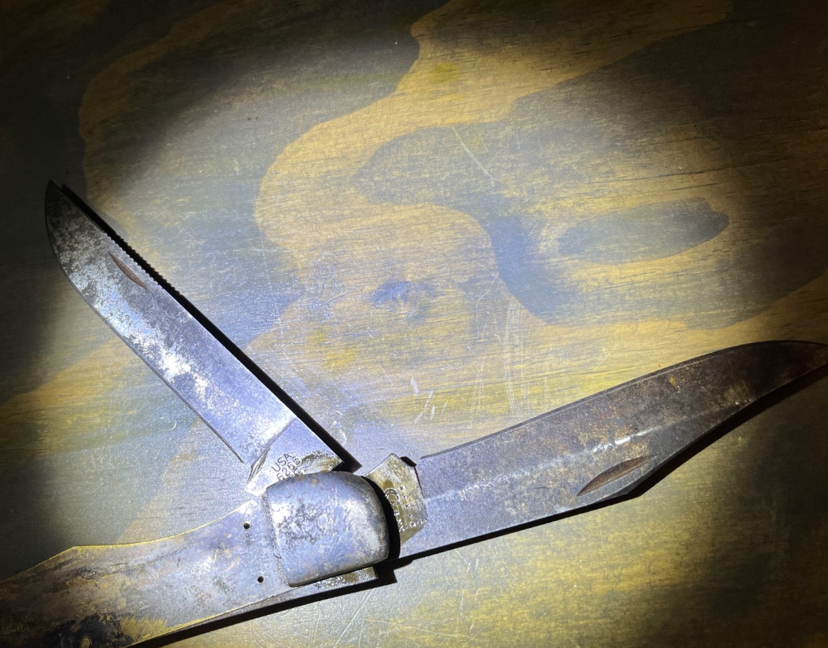

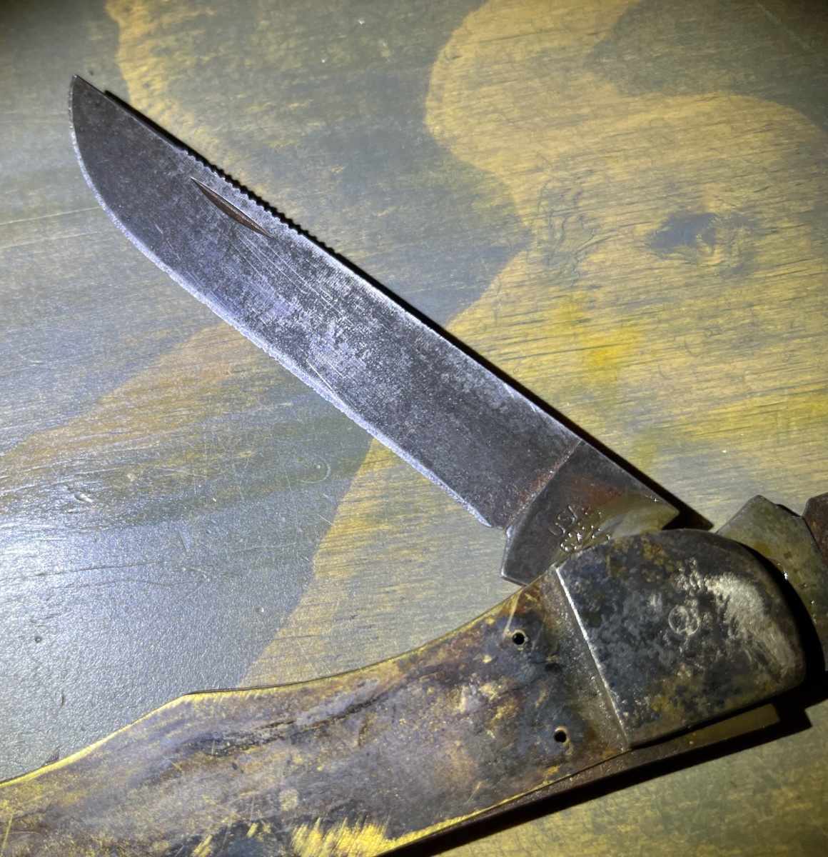

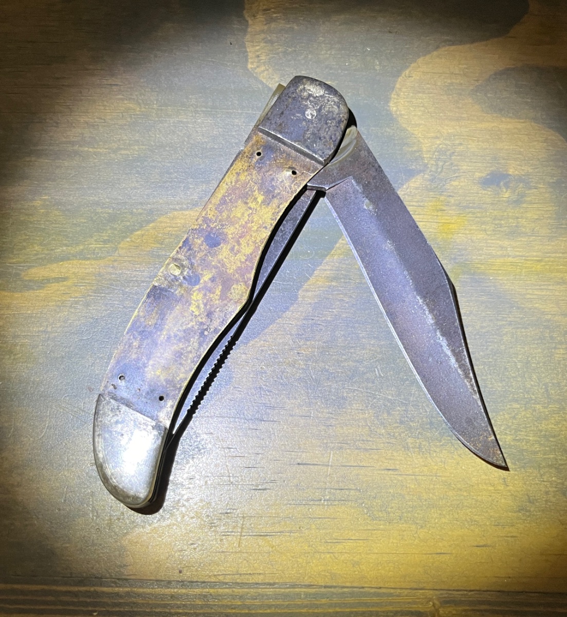

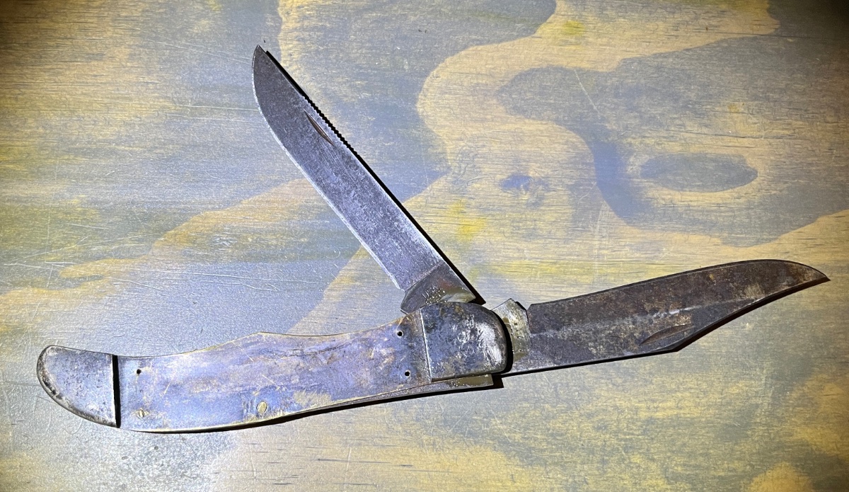

One weird Case 6265…hoping to “repair” it
Post by Walleye »
This is an odd one - recent eBay purchase. I got it pretty cheap but I knew going into it, there was a bit of a gamble here.
Based on the tang stamps, it’s a 2010 Case 6265. No handle scales present. The knife looks mostly unused, maybe even unsharpened, but it’s got serious issues. The entire knife is covered in a grey scale. There is still some snap to the blades but the springs feel kinda weak. The seller claims that a family member had lost it on some land he was clearing, and then at some point after plowing the land and doing some controlled burnings, he found the knife again. So, exposure to elements, possibly being burned and/buried in the ground. It doesn’t have any odd chemical or solvent odors, and it doesn’t look like anything has been done to clean it off - no evidence of sanding or wire wheel cleaning.
The steel parts of the metal don’t have the telltale rainbow discolorations that you’d expect to see if it was exposed to high heat, but I suppose that also doesn’t mean it wasn’t heated hot enough for it to screw up the steel and/or spring temper.
I’d really like to take this to the fiber or wire wheel and clean it to bare metal and put some new handles on it but I don’t want to polish the proverbial “turd”. If the steel or springs are too soft to hold an edge, it would be worthless for everyday use. Has anyone come upon a knife that looks like this and if so, what did you do?
If the blades were carbon steel, I might try disassembling it and rehardening / tempering them but stainless - not sure how to do that. I have also considered finally buying one of those Rockwell file sets - what should the approximate hardness of modern Case stainless blades and springs be? Does anyone here have a real Rockwell tester or any other suggestions to test the hardness with home methods?
See photos!

Re: One weird Case 6265…hoping to “repair” it
::hmm:: I wonder if this knife was in a fire?
ThatWeirdKnifeGuy
Posts: 1677
Location: Wisconsin
Post by ThatWeirdKnifeGuy »
I'd say its been through the fire 8)
The scale pins are missing, so it didn't just burn the scales, it melted the pins or disfigured them enough that they could fall free. I'm not an expert, so I really don't know if brass melts at or near the critical temperature of carbon steel. If it has indeed been heated past critical and lost its hardness, I would imagine that rehardening it would be risky. That would be the third time its been heated.
If it were me I'd put burnt stag on it, leave the blades and bolsters as they are and put it in a display. It's got a cool origins story ::tu::

Does it have any snap? If the spring is soft from being in a fire, I would think it would bend.

You can use a regular file and see if it “skates” off of the blades or springs. If it does then the heat treat and temper are probably okay. If the file bites into the metal then re-heat treating is an option. For re-heating and tempering you would need to know what steel you’re working with. For alot of stainless steel the heat treating recipe is similar.
Personally, I’d clean it up, put some scales on it and use it for awhile. If the springs and blades have been overheated you’ll likely notice the spring weakness in a short amount of time.

OLDE CUTLER wrote: Thu Oct 03, 2024 2:07 pm Does it have any snap? If the spring is soft from being in a fire, I would think it would bend.
Yeah it has some snap, but more like the snap you’d expect from a worn out 50 year old knife. That said, I rarely buy new Case knives so I don’t have a good feel for what a 2010 Case ‘65 pattern should snap like.
Let’s put it this way: it doesn’t snap like a modern Rough Ryder, that’s for sure - whole different issue, I know but I couldn’t resist ::facepalm::

Jeffinn wrote: Thu Oct 03, 2024 2:21 pm You can use a regular file and see if it “skates” off of the blades or springs. If it does then the heat treat and temper are probably okay. If the file bites into the metal then re-heat treating is an option. For re-heating and tempering you would need to know what steel you’re working with. For alot of stainless steel the heat treating recipe is similar.
Jeff
Good idea with the file. I’d assume it would bite somewhat but I can tell the difference between annealed steel and hardened steel when hit with a good quality file. Not sure how springs should feel under a file as I rarely would have occasion to file them. Still, sharpening and carrying it and using it would likely reveal a lot.

Update: after looking at the knife a little closer last night, I don’t think it got hot enough to melt the brass handle pins, as there is evidence that some were pried out. Also the brass main back spring pin appears to have been filed down and then crudely peened flush with the liners. There is also evidence of some file work to smooth the liners and part of the bolsters on the top of the knife.
I’m figuring it might have been found with burnt or otherwise damaged handles that were then popped off, the center pin leveled with the liners and some clean up attempted, and then for whatever reason they gave up. Who knows ::shrug::

It has odd notches, almost a fish scaler, on the skinner blade. I think they were deliberatly added before it was lost.
The web site Zknives wrote Case Surgical Steel is 420HC, the most common alloy in Buck knives. I think that covered 2010 but Case may have changed stainless steels.
Please keep us up-dated or show us the repaired knife.

If the knife was in a fire hot enough to melt the pins, the brass liners would have melted also.
I doubt it was in a fire-just exposed to the elements.
A file won't "skate" on these old blades.
