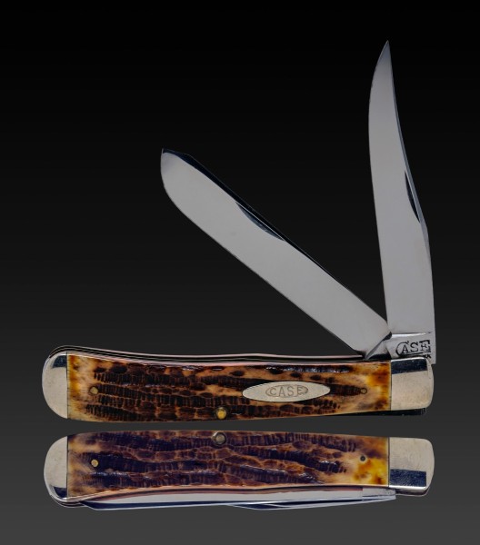

Posting this in case it is useful / interesting to see an authentic Case Tested XX 54 trapper knife. This knife is pictured multiple times in Sargents 7th edition. In some descriptions Sargent calls it 2nd cut bone which would make the pattern 6254. In another description Sargent calls it 2nd cut stag which would make the pattern 5254. There is no red bone Case Tested XX 6254.
Things to note are the width of the bolsters and the size and shape of the blades.

olderdogs1
Posts: 2538
Joined: Mon Apr 03, 2006 6:48 pm
Re: Case tested 1920-1940 6254 is it real or fake? I did shine the handles and blades with my sunshine cloth.
Post by olderdogs1 »
Here is one that I have that is pictured in my book that I have always referred to as 2nd cut stag.
RalphAlsip
Posts: 2347
Location: Southern Illinois
Post by RalphAlsip »
olderdogs1 wrote: Tue Oct 22, 2024 10:41 pm Here is one that I have that is pictured in my book that I have always referred to as 2nd cut stag.
Great looking knife! And the stag looks red to boot.
