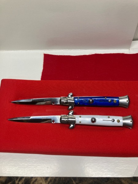

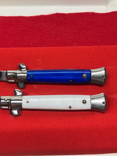

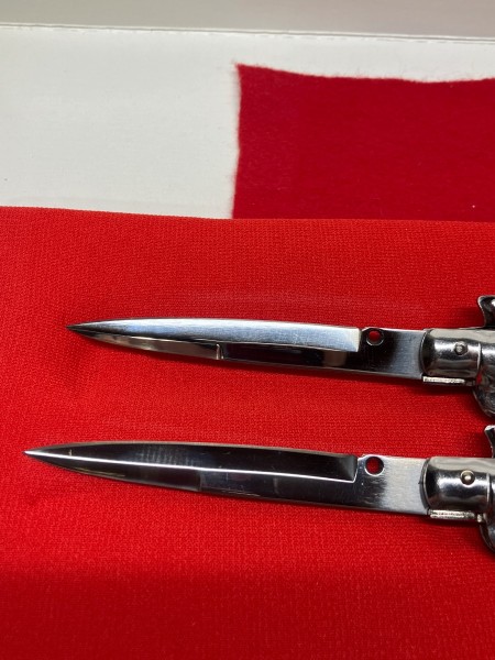

I recently bought a box of knives. These two came along in it. I don’t know anything about them. If anyone can share some knowledge with me. I would greatly appreciate it.

Those are Asian made kit knives. I bet they kick pretty hard.

They seem to open fast if that is what you mean by kick.
Are they junk?
Are they junk?

Indeed. Opening fast is that. They aren't the highest quality knives and many were made. Not high monetary value. Still cool for what they are.

Definitely Asian like QGoflake said. But I don't believe they are kit knives because kit knives tend to have screw pivots that allow just about anyone to assemble the knife. It would be a lot to expect the average person to properly peen a pivot pin.

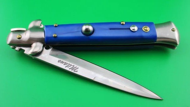

The "sex pin" that holds the spring in place might give the impression that they are kit knives, but that method of securing the spring is not an uncommon characteristic on Asian stilettos, particularly Taiwanese stilettos. The "Milano" marked stilettos are another example of this (pic below). Very similar to the "Stiletto" marked stilettos.

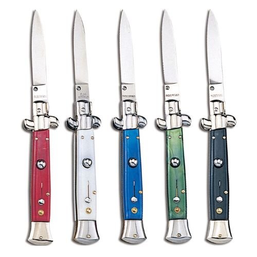

In regards to the use of the "sex pin" for the spring, the Taiwanese are still using it today. First pic below is from a Taiwanese manufacturing site currently offering fully assembled switchblades for sale in bulk.
As for the screw pivots on Edge Co. knives, I've added a pic of a few of the early Italian-made Edge Co. stilettos (made by Armando Beltrame, distributed by Frank Beltrame). Of course the visibility of the screw in a pic all depends on from which direction the owner installed the pivot, and which side of the knife is shown as the other side of the pivot looks like a solid pin. Later versions of the Edge Co. stilettos were made in Taiwan and only came with plastic scales. Those are lower quality than the Italian versions, but they had the same construction (screw pivots and two-piece sex pin).
The manual Edge Co. stilettos came fully assembled with a standard pivot pin, but it's my understanding that none of the Edge Co. stilettos switchblades came with a standard pivot pin. They were all sold without the blades and springs installed in an attempt to skirt import laws, and they all came with screw pivots and two-piece sex pins for the springs.
I've seen a variety of stiletto switchblade kits from different manufacturers, but I don't recall ever seeing any with a standard pivot pin that the buyer would need to peen themselves. They all had screw pivots.
For anyone wondering why it's called a "sex pin", it's because the "pin" is actually a two-piece rivet, a solid "male" piece, and a tubular "female" piece, and the male piece is pressed into the female piece. Although, on the non kit stilettos, the pin may actually be a solid pin peened at the factory during assembly since the knife doesn't need to be assembled by the average person.

That first pic (Taiwanese knives with the different colored handles) are sold as fully assembled knives. The only stiletto kits I know of that are still being produced are the little "Magic Knife" kits being sold by SKM.
I think you're right about the nail nicks. Probably there in case the spring breaks. Seeing as how the knives came from Italy and then Taiwan I imagine replacement springs would be difficult to impossible to come by. Of course a person could always just press the button and wrist flick the knife open.
I don't know why the Taiwanese (and maybe some Chinese makers) still use what looks like a sex-pin for the spring on fully assembled knives. Maybe it's simply a matter of, they have the tooling to do it that way, that's the way the particular manufacturer has always done it, so they don't see any reason to change. Who knows.
