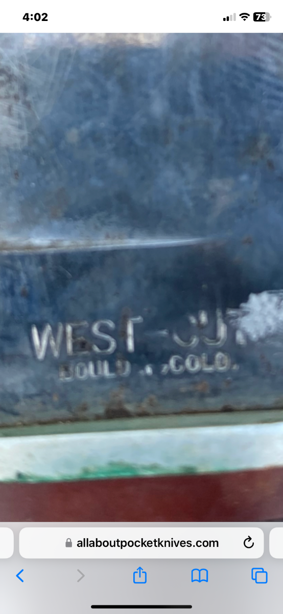

Mossdancer wrote: Sun Sep 01, 2013 3:47 pm coffeecup :
Hi Jim, Although not a bowie interesting anyway. Nice stamp of a West-Cut. My question is it does not have the split tang. Is it before the patent or a newer example.
I don't know if it will help but I also gave a close up of the pommel rivet.
moss
Obviously I’m not coffecup : Jim .For 1 year only (1958) Western brought back the West -Cut tang stamping . The K 1 ,K2, K 3., K 5 and 645. .The k series knifes all had leather handles , single pin in the pommel , and non bifurcated tang construction .The K 1-3 knifes had a flat grind blades .The K 5 and 645 were both saber grind .The 645 had a plastic handle material .

1931-32 WEST -CUT.
zzyzzogeton
Posts: 1805
Joined: Tue Jun 20, 2017 8:47 pm
Location: In the Heart of Texas on the Blackland Prairie
Re: Western Tang Stamps
Post by zzyzzogeton »
Thomasg wrote: Fri Nov 17, 2023 3:09 am 1931-33. WEST -CUT.
Actually, a little tighter than that - 1931 - 1932.
1932 - 1933 would have been "PAT. PEND." on the pile side ricasso.
Then just "PATENTED" for a bit in 1933, before the actual patent number was issued and stamps made with the patent number.

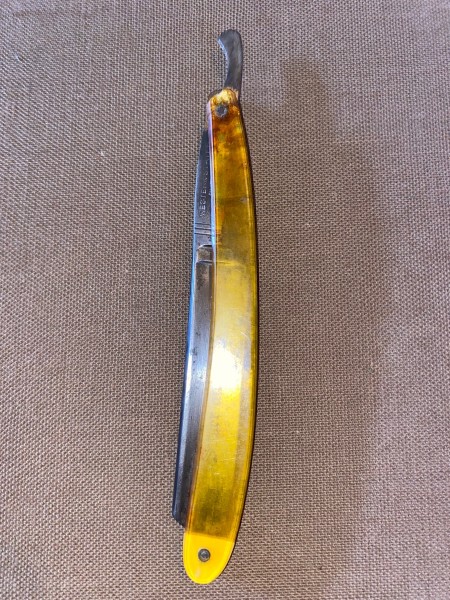

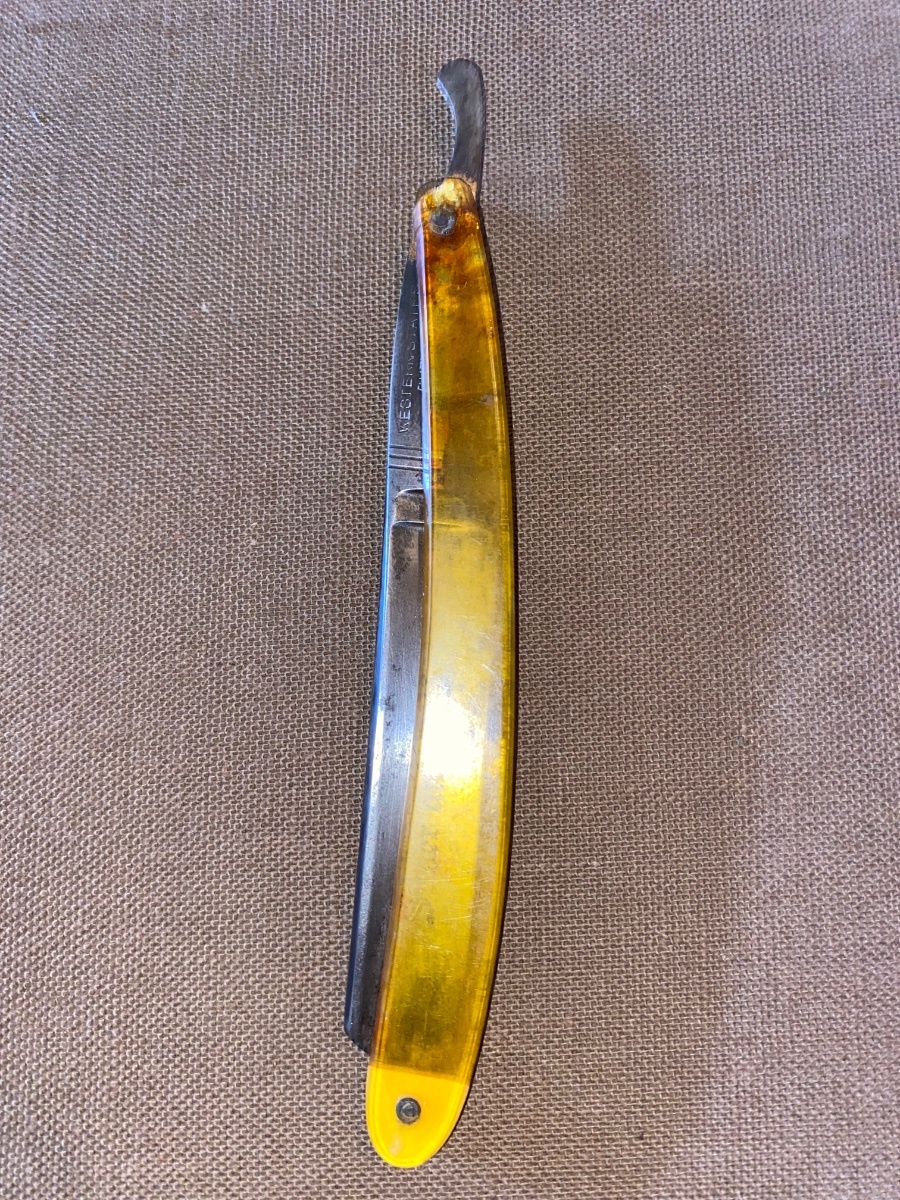

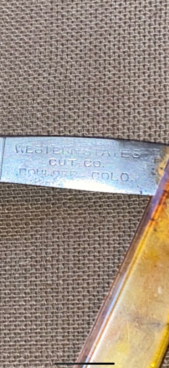

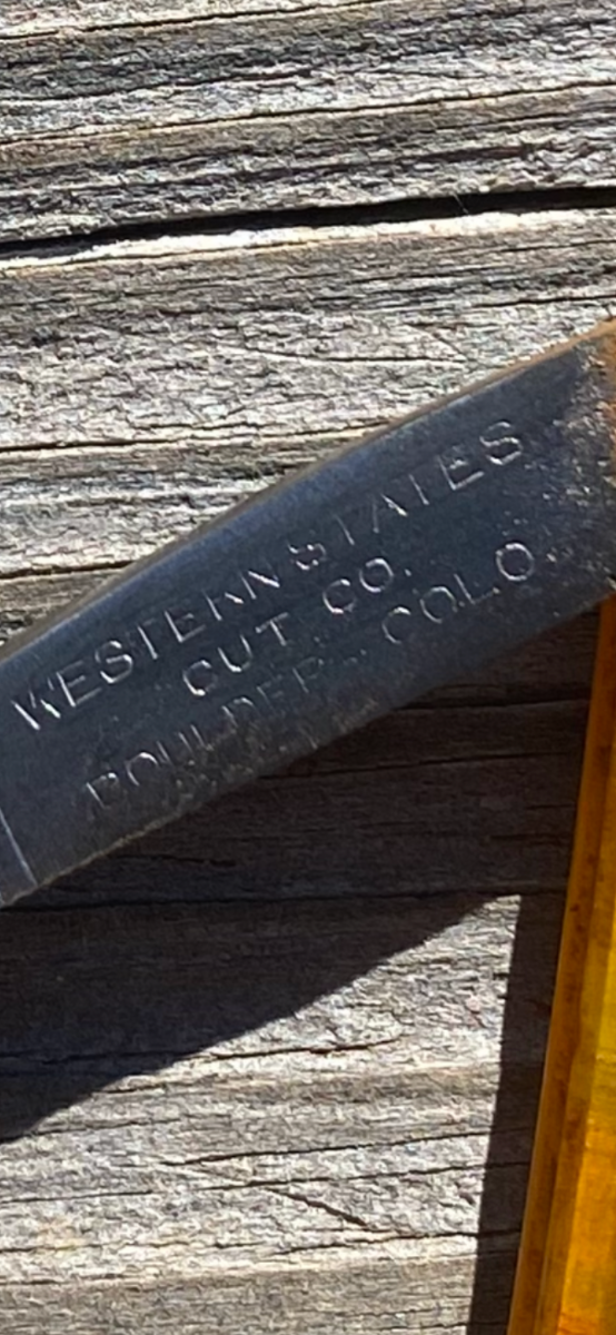

1921. Tang stamp western states cut co. .on model # 9-16 strait razor

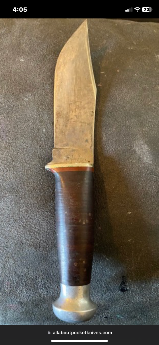

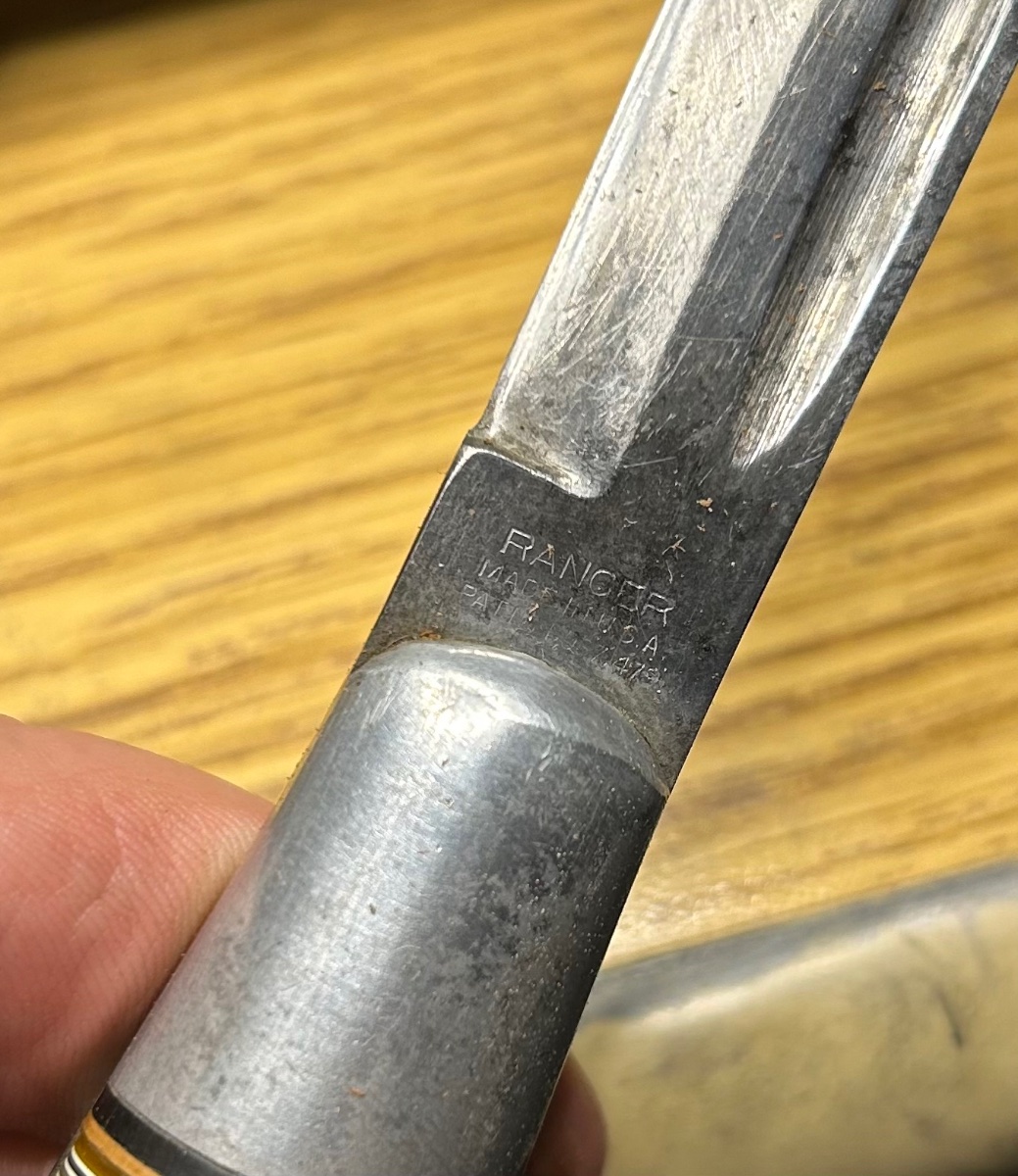

Rockingkj
Posts: 607
Post by Rockingkj »

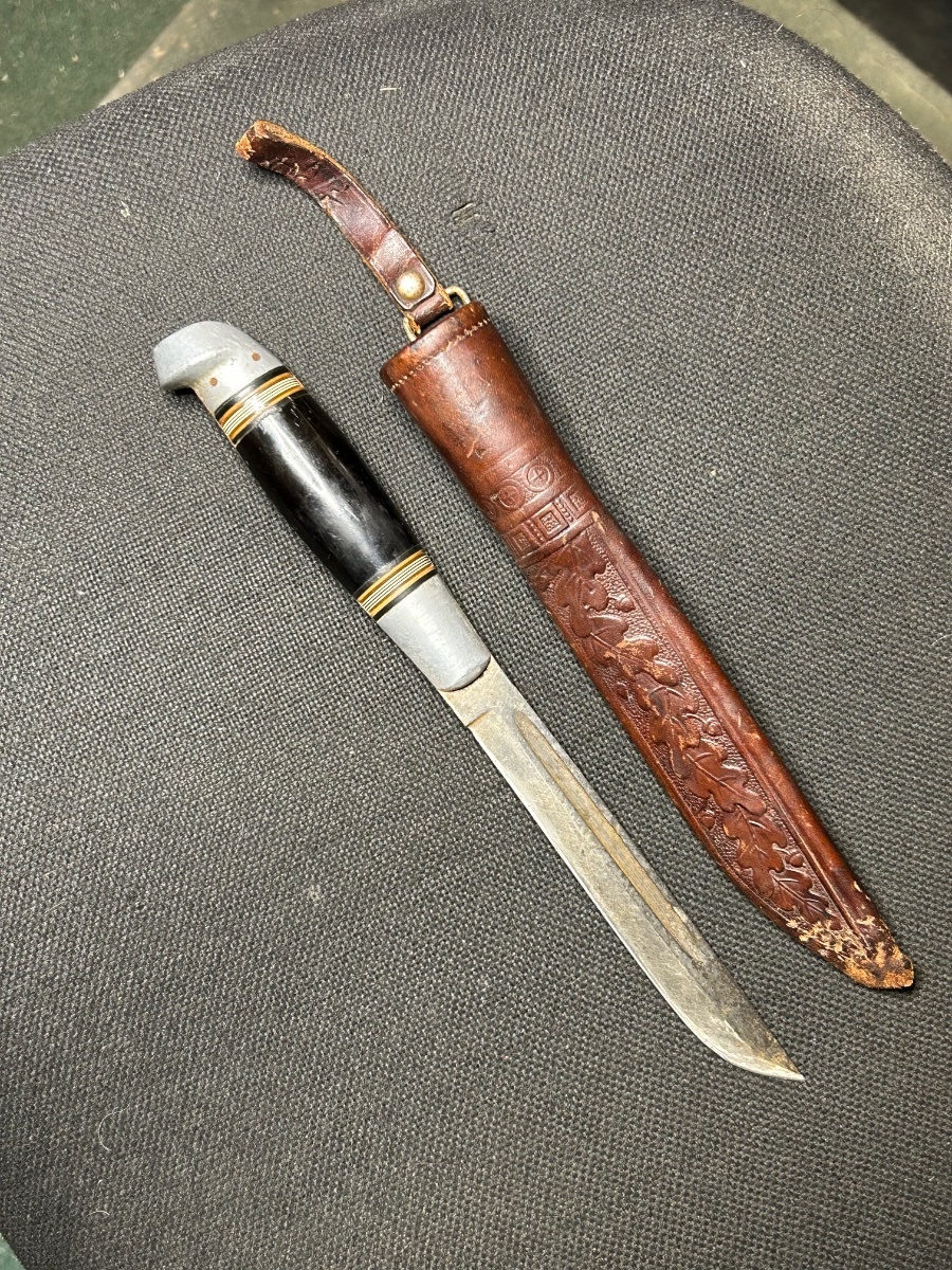

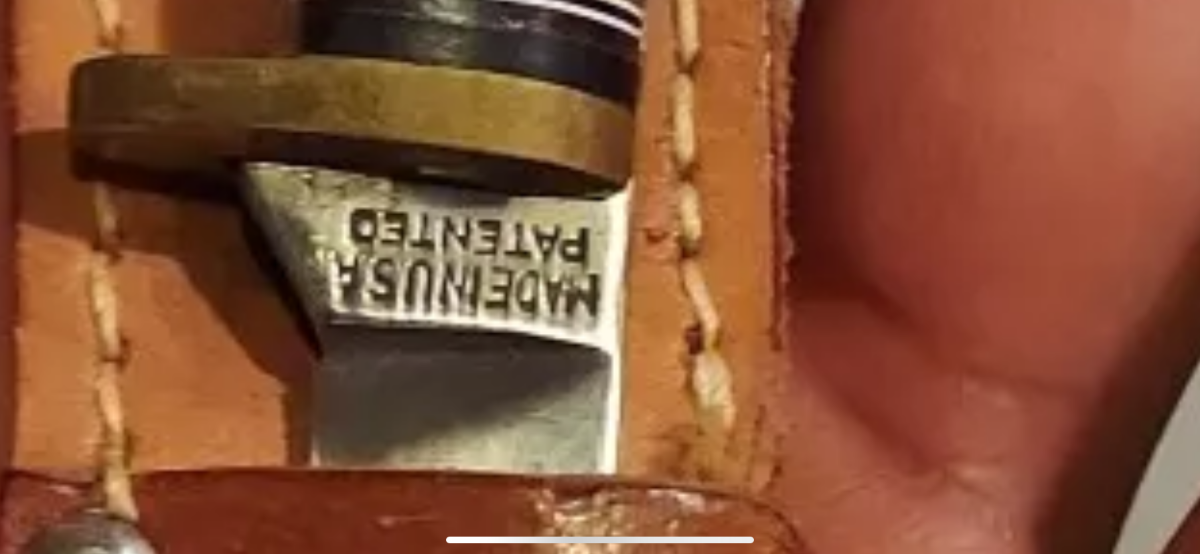

Western Puuko with RANGER mark. It’s said the Puuko was only made in 1941 if so that would establish a date for RANGER mark.
zzyzzogeton
Posts: 1805
Rockingkj wrote: Mon Feb 05, 2024 11:25 pm Western Puuko with RANGER mark. It’s said the Puuko was only made in 1941 if so that would establish a date for RANGER mark. D68FE46F-7855-4776-BA09-F41F602877E4.jpeg740C4331-38AB-40DF-9277-C82A8EB18E61.jpeg
That's an excellent find, along with a new date for the Ranger line.

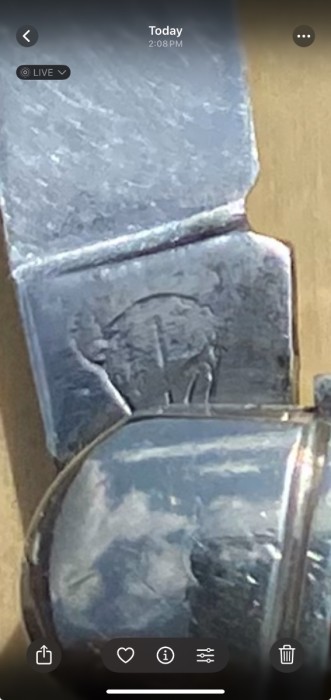

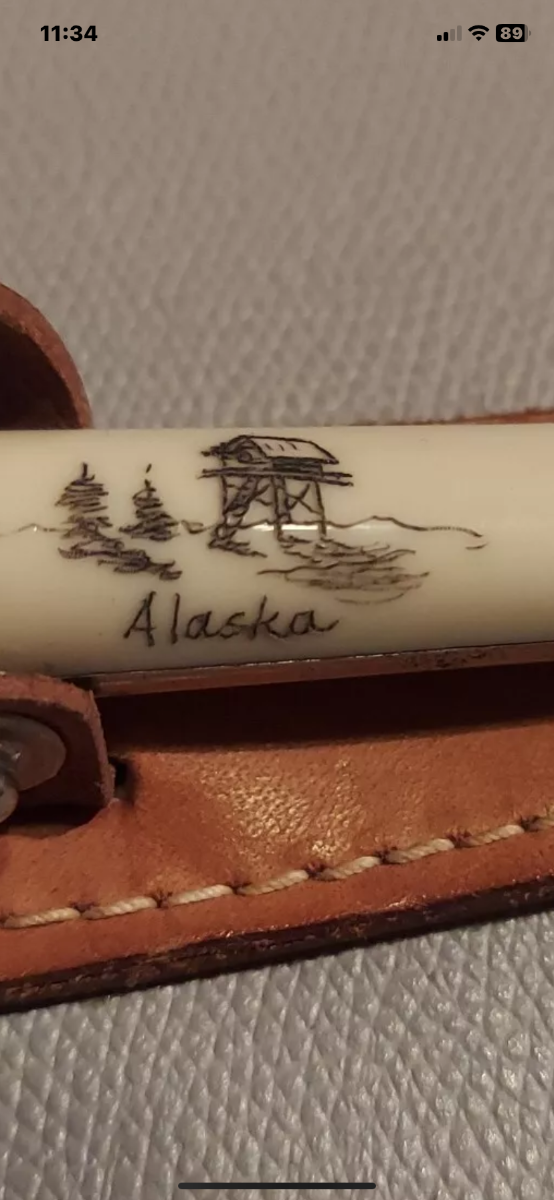

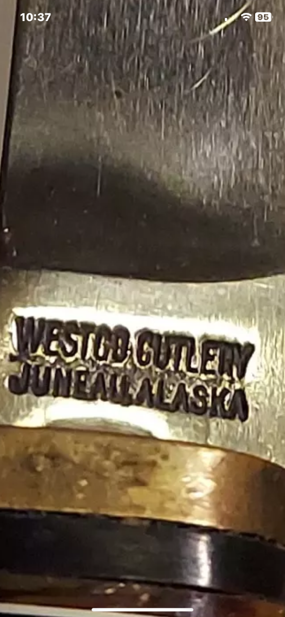

Westaco (Alaska tourist )
cdotye
Posts: 4
Joined: Fri May 24, 2024 11:13 pm
Post by cdotye »
Trying to get info on this tang stamp.
zzyzzogeton
Posts: 1805
1949 or 1950 to 1954
MADE IN U.S.A. did not appear as part of Western stamps until 1946 or 1947, but those years, it was hand etched (1946) or stamped (1947/1948) on the pile side ricasso.
Reference to the bifurcated tang patent was dropped in 1953/1954, depending on model.

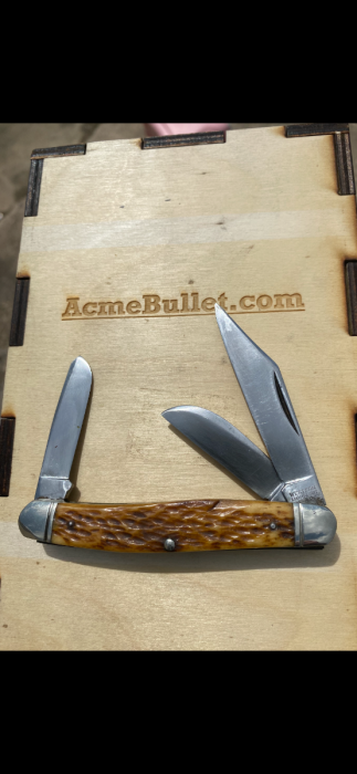

Western stockman
Western stockman
