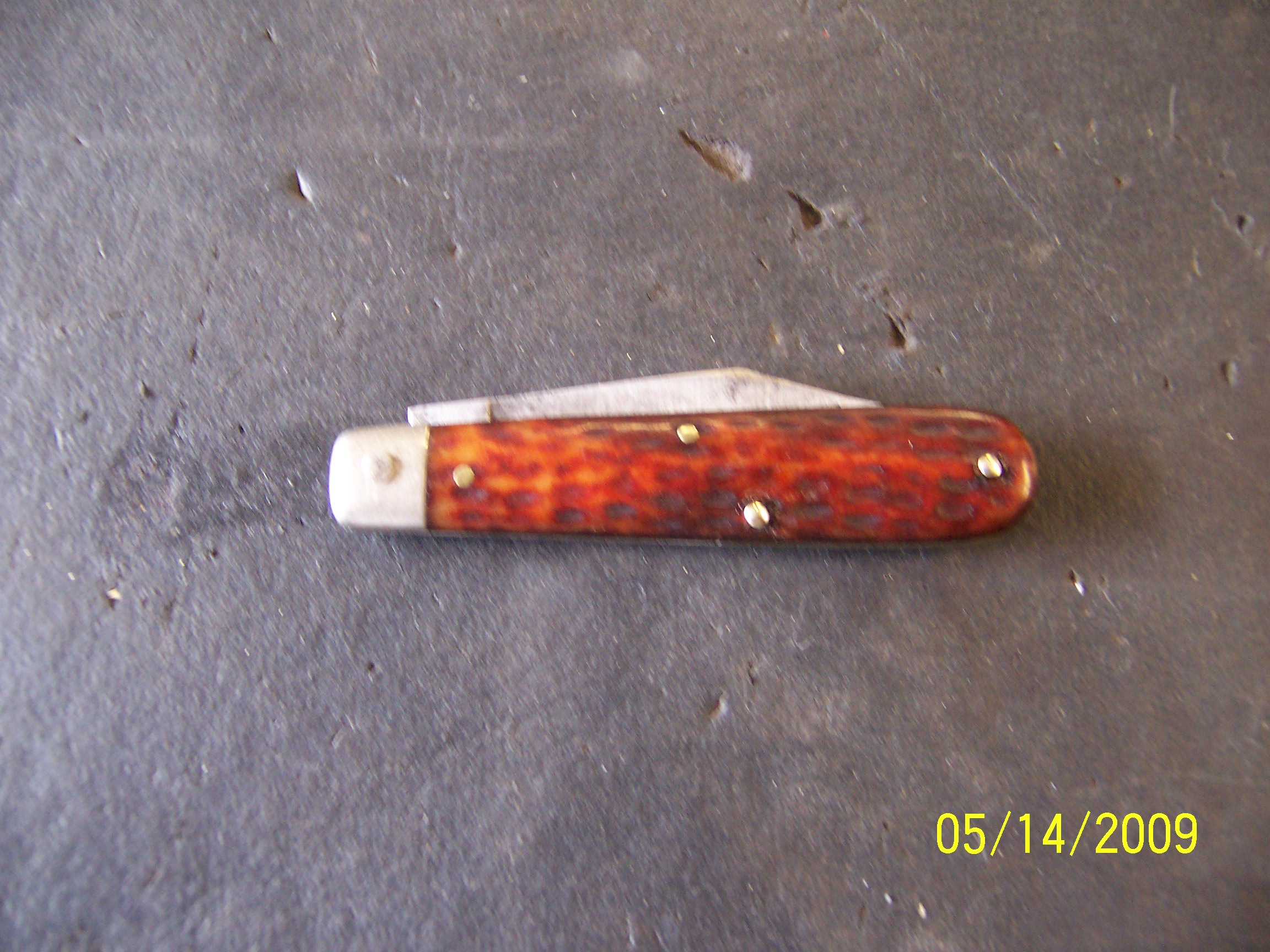

1- Start with the knife, file & a spring loaded center punch. Pic #1

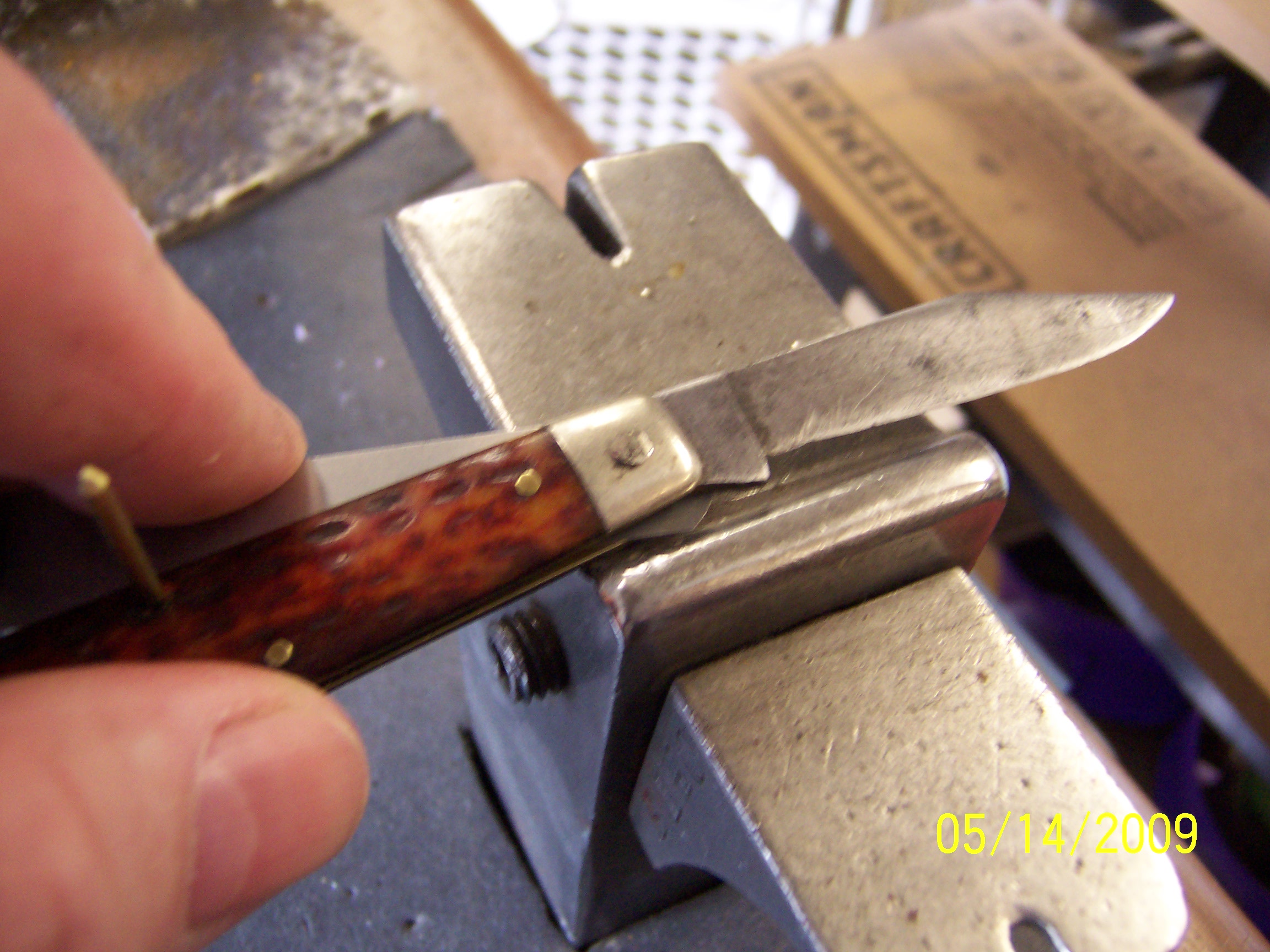

4- Open blade(s) of the knife and place in a spring compressor (Camillus type knife vise) to compress the back springs. Using a 1/16” pin punch tap out the rocker pin, releasing the spring pressure in the knife. Pic #5

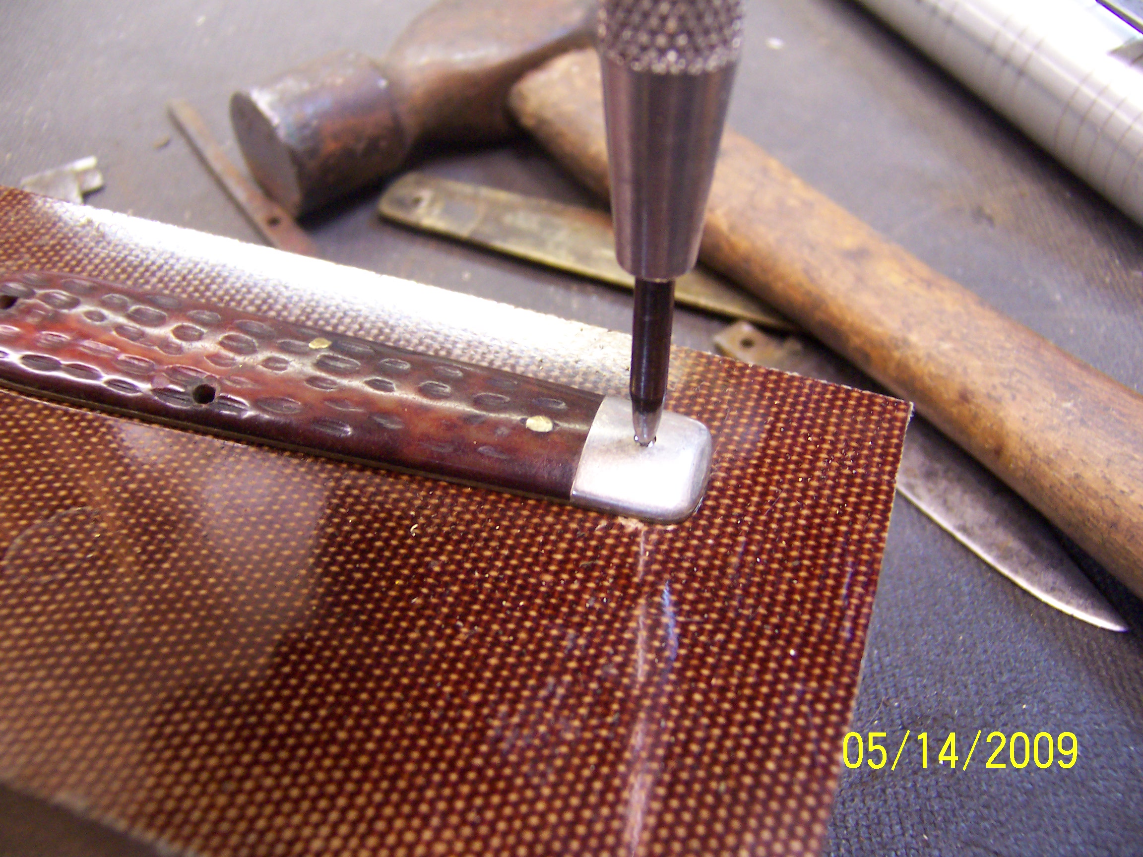

9- Using the spring loaded center punch, drive the pivot pin back in the hole. You can use the 1/16" pin punch for this, but you must be careful not to mushroom the head of the pin. I find the gentle action of the spring-loaded center punch is usually more than enough to push the pin back through tapered hole. Pic #10

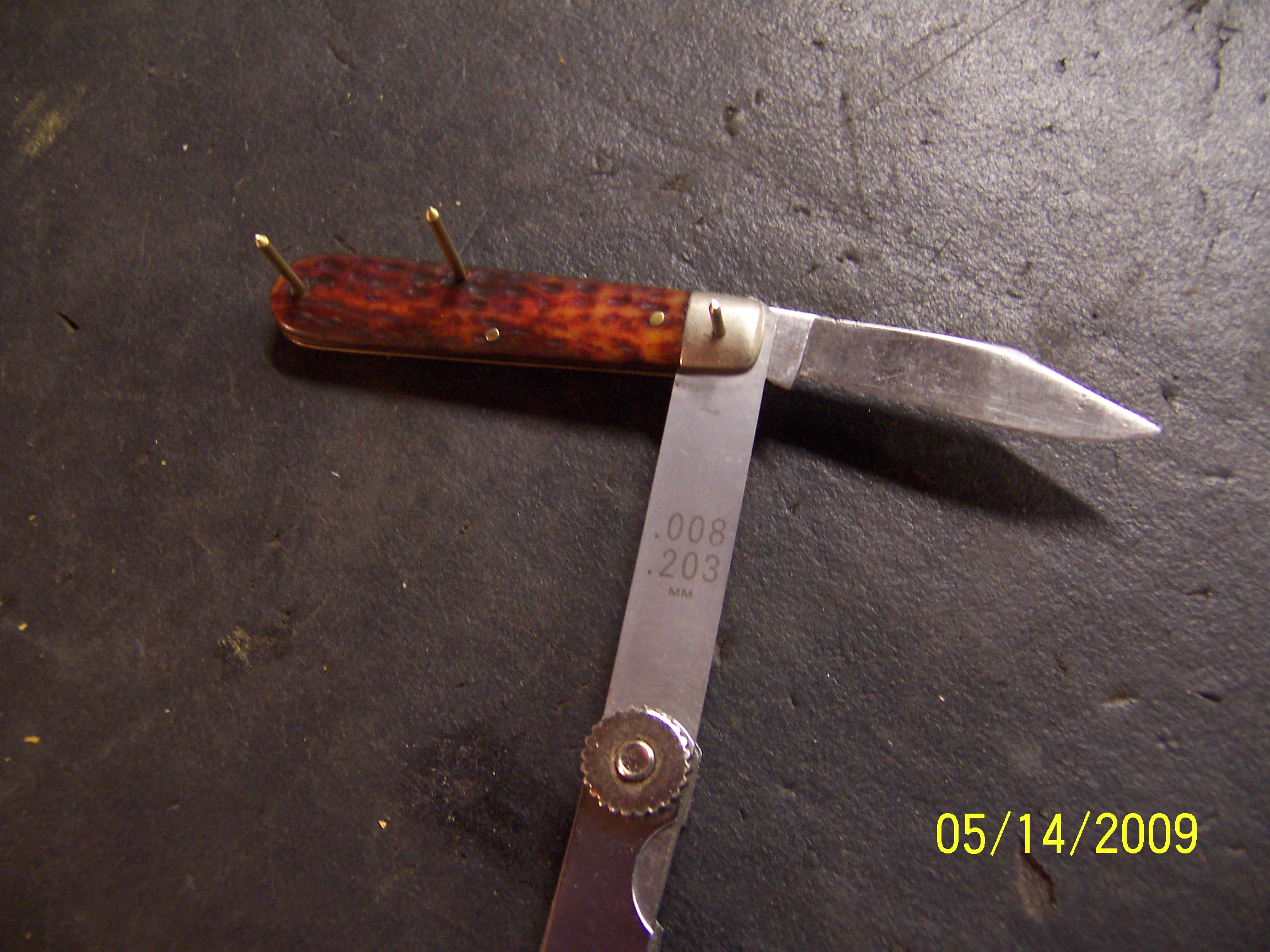

9- Use a 0.008” slackner to prevent blade pinch when peening the pivot pin. Pic #24
