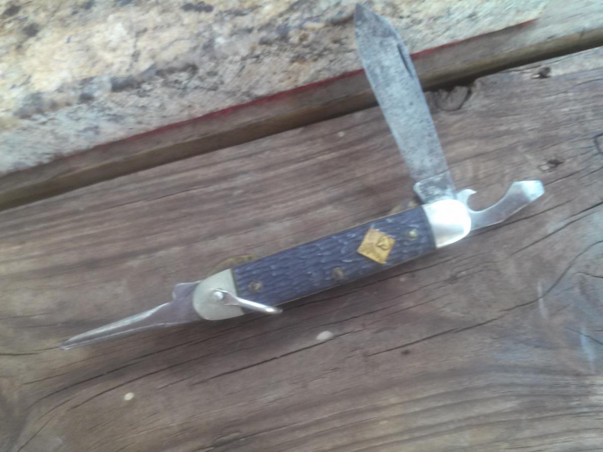

Assess the discoloration…..Try and avoid using sandpaper if at all possible to make an old knife shiny again.
BASIC 15 MINUTE KNIFE CLEAN/POLISH
The knife originally had light rust appearing. I rubbed with fine steel wool. Touched certain areas with #2 pencil lead, then hit with steel wool, then finished with a Flitz Metal Polish rub down on the knife’s blades and bolsters.
This process leaves the patina (stained steel) pretty much intact and helps the knife maintain its “aged” look. Took me all of 15 minutes to accomplish this 3-step polishing/cleaning process.
In addition I force a rag between the liners to clean the inner parts of the knife, then add a drop of Quick Release Oil to each blade tang.
DONE. Not shiny, but restored to solid working condition. (Most knife collectors who use their knives prefer patina.)

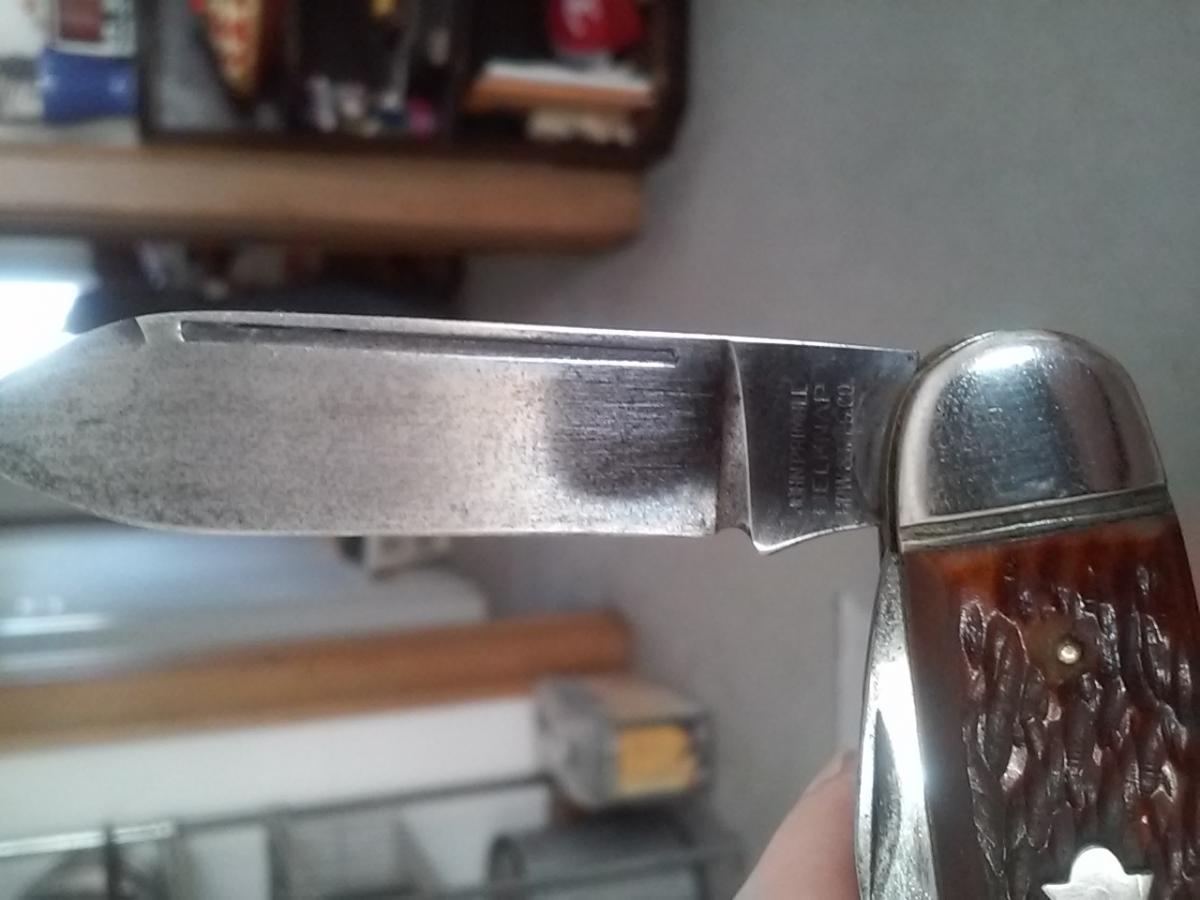

POLISHING KNIFE BLADES:
Start at heavy grit 100 and work your way up to 2500. Each time you move to another sandpaper grit try and obtain a reflection in the blade so you can see yourself…..kind of hard to do with 100 grit.
This the the ELBOW GREASE SECTION!!!
Using the sandpaper remember- Up, down. Left, Right. Mostly I go left, right strokes a few dozen times, then up/down strokes a few dozen times. What you want to try and avoid is making deep groves by stroking the knife blade ONLY left and right vigorously on the sand paper. Mix it up. Left right…...up, down. Do each way 20 times, then repeat until you're beginning to see a shine! :-)
After you begin to see a reflection, move to the next grit. From 100 grit to 200, then to 300, 400, 600, 1000, 1500, 2000, 2500. Repeat the above sanding steps until you can see what color your eyeballs are!

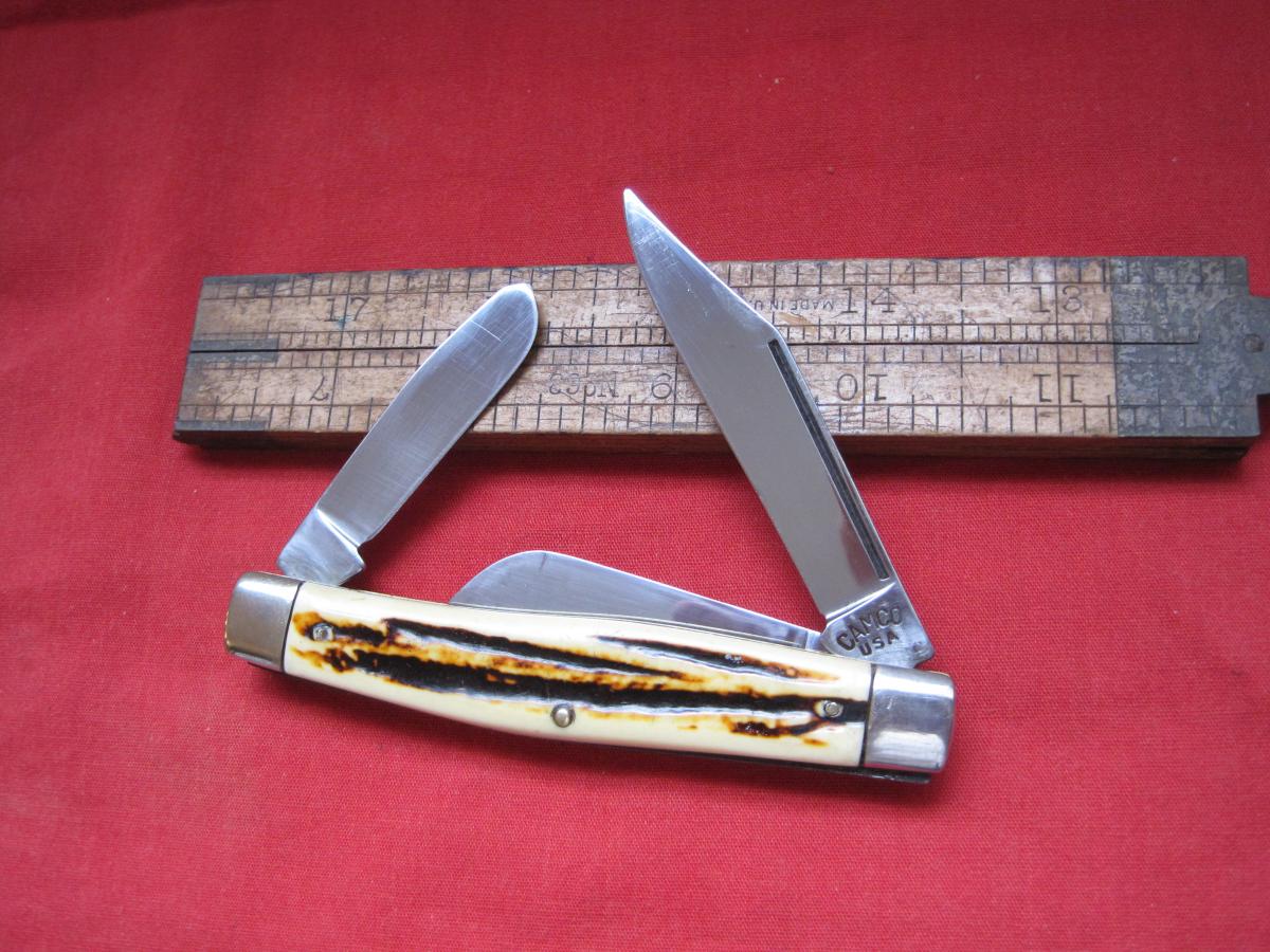

Just finished this CAMCO 772 today
SCOTT

TripleF wrote:Just finished this CAMCO 772 today
Well done it looks factory New.

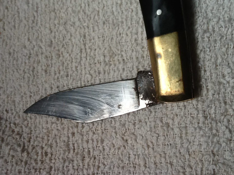

The tang of my prized Ablett got rusty through my prize neglect. ::dang:: I squirted oil in and worked the blade in a panic, then thought that oil prevents not stops rust. ::doh:: I also saw mention of wd40 on AAPK.
I have Fitz polish but can't disassemble the knife to reach the area around the pivot pin.
Do I degrease and then use wd40? Do I soak in vinegar? Do I bitch slap myself? ::undecided::
Getting to those hidden cracks and places is my problem. The exposed blade now has a liberal coating of ren wax. ::paranoid::
Is there hope for the tang? (is there hope for me?) ::disgust::
I also notice that the fine edge of some of my blades is prone to rust before the rest of the blade. Is ren wax enough to prevent that?

I would start by slapping myself, but then you should be ok.
Getting in and down around the pivot pin is near impossible, but you might try some dental floss. Then high pressure water and dawn liquid soap.
Then WD-40. Then compressed air.
Soaking in vinegar will make a patina that'll be tough to remove, BUT.....pouring a little vinegar then adding a little baking powder will create a "fizz" and may do some deeper cleaning.
Wax and polish are the last steps to a cleaned/polished knife.
