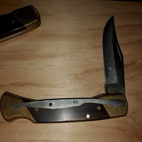

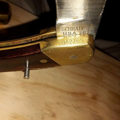

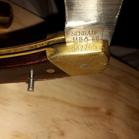

Pics of his lb7

Zed, if he peers into the the butt end of the knife from the bottom, can he see any remaining spring? If so is it round? If there's nothing is there a slot that held it? If none of the above it's likely the one piece butt/spring piece. I think.

That's not your typical LB7. It appears to me the knife has been heavily modified, perhaps to make it an auto opener.

Hi Eric,the bar is missing so sounds like it's the version where it slides in
Phil that's interesting,what makes it look like it's been modded?
