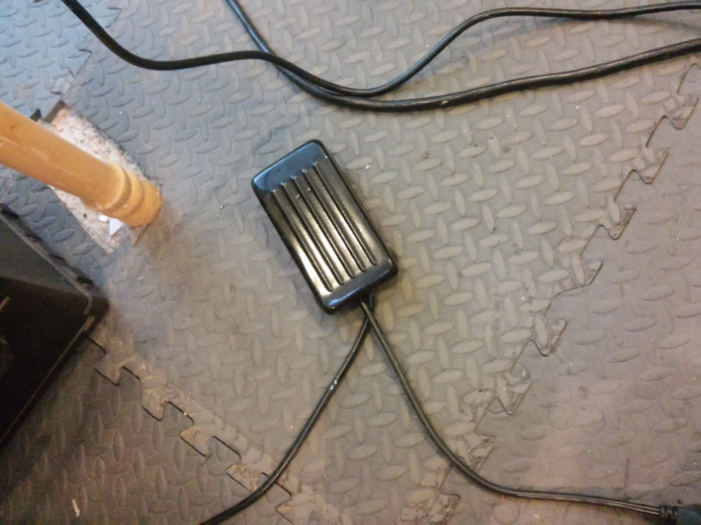

Wow, everyone has a nice looking shop! I got some new equipment this week. A cabled rotary tool with foot pedal control. Variable speed too. Both hands are free to work with. I have a cable attachment for my Dremel workstation but this is better!
And I discovered that I can plug my first gen Work Sharp into the pedal and now I have slow enough speeds that it has become very versatile.
Good tool so far. Got it on eBay. $60.00 shipped!
Has a real drill chuck instead of the system used by Dremel.

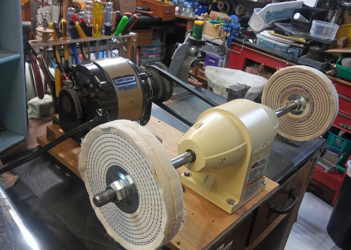

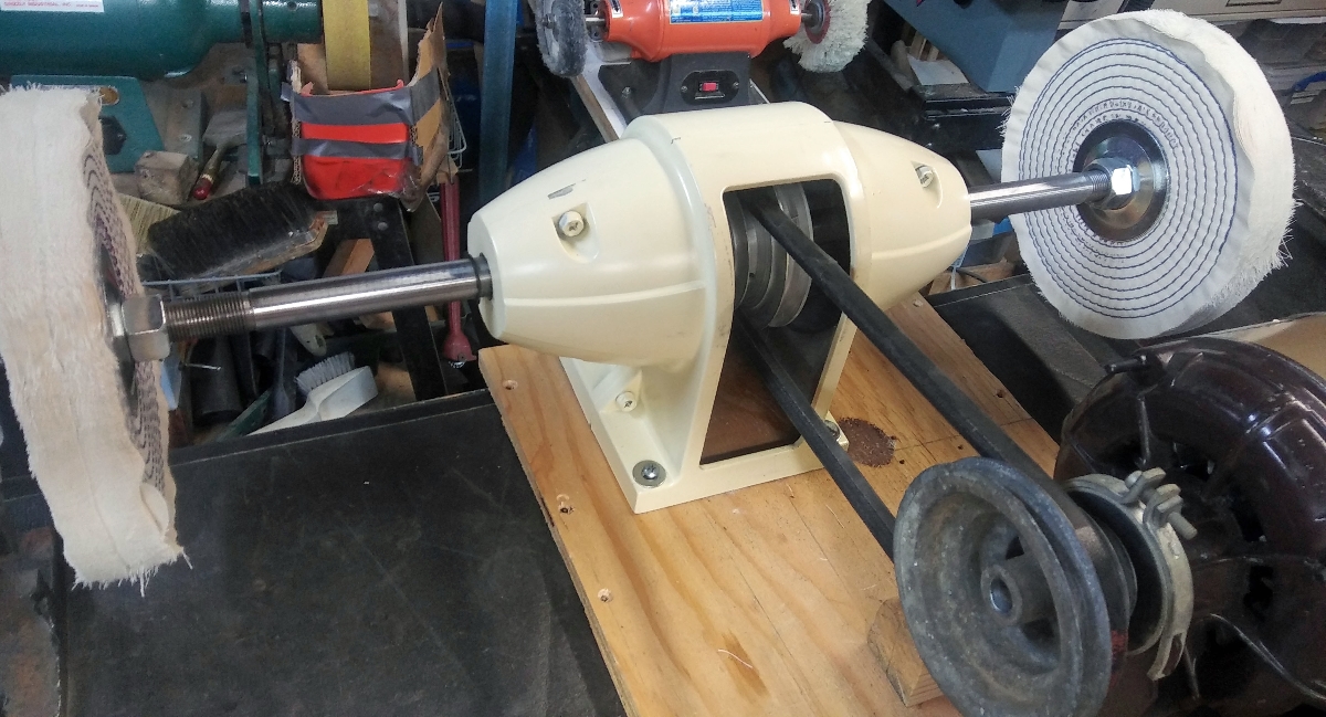

I have wanted to get another buffer for my shop for some time. Changing buffs can be pretty time-consuming and it’s nice to have one machine that can do your most common buffing tasks without changing buffs.
I found a buffing assembly with the three diameter pulley on sale at Grizzly Industrial’s website: http://www.grizzly.com/search?q=(buffer ... op+Fox%22)
I had a 1 HP Craftsman motor that I picked up at an estate sale for $5 or $10. It’s more motor than I need but I’m certainly not complaining. I got it set up and I have to make something to trap the dust because these new buffs will rain little threads until you get them broke in. I’m not sure where it’s going to be placed in my shop, that’s another issue yet to be solved. I would like to make a stand that would hold both buffers but I’m not sure how practical it would be especially with limited space.
The buffing assembly was around $130 shipped plus $10 for the old motor and everything else was things I had on hand. For less than $150 I have a variable speed 1 hp buffer.
Grizzly does sell a 1725 RPM 1 HP buffer for around $350. It’s a dead ringer for my old Jet buffer except for the color in the name on the front.
I just thought I would show you guys and if anyone is interested in making one of these for your own use, please feel free to ask questions in here or send me a PM.

That's a neat setup, Dale! I'd love to have a second buffer setup, but I probably don't have the room...

If you figure out a good dust trap for your buffer i'd like to hear it, I have black streaks along the bench, up the wall and across part of the ceiling in line with both wheels on my buffer LOL. I've tried a couple different cobbled together setups, nothing that I have tried so far works.

Re: Shops, tools, materials and tips
Use a pair of 90* terminal ends for a floor register, and one section of trunk.
You can cut the trunk to make a larger shield that will work for two 12" wheels.
All in you'll spend about 12 bucks.
Edit:
Use sections of sliced fuel line or similar hose to cover the sharp edges. Trust me on that one...
Edit:

That looks doable Ken.
Where do you get the ducting, Lowes?
Lowes, Home Depot ect.
Something that REALLY helps is pop riveting it all together. Sheet metal screws tend to vibrate loose, and you'll know it when you get "shot" w/ one.
I just found the link for Home Depot... They are almost 9 bucks there now. https://www.homedepot.com/p/10-in-x-4-i ... /100197347
I would try a local HVAC guy, and ask for a couple. They should be around 4 bucks.
The circular part that takes the duct can face into a 5 gallon pail or out of a dryer duct thru the wall, and into a bucket there. You'll want to use steel ducts so they are easy to clean. Those flexible ones actually trap the compound, and will start falling off or kinking.
Same issue w/ a dust collection system... the compound gunks it all up unless you use something like a piece of a central air conditioner filter.

I make my buffer hoods out of cardboard and duct tape. I screw them down to the bench.
Cheap, easy, effective and best of all-safe!

A man after my own heart Bill!
I appreciate a nice shop where everything is really nice, but I think having a table next to Wayne Goddard for 10 years at the OKCA show has had a lasting effect on me. Now when I see something I think how I can make it.
My existing hoods are cardboard, plastic jugs and of course duct tape. Two of my buffers are home made.
