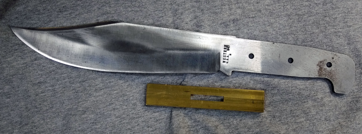

This is the starting point, the #47 blank and a piece of brass bar with the slot cut in it. The brass bar I got from Jantz and though the slot was not the right size to accommodate the tang, it was close enough that I was able to finish filing it to size without a lot of difficulty. I believe the bar cost $15 plus shipping which was a whole lot more cost-effective in my mind than starting with a three dollar bar of brass and drilling my own holes! :mrgreen:

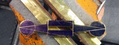

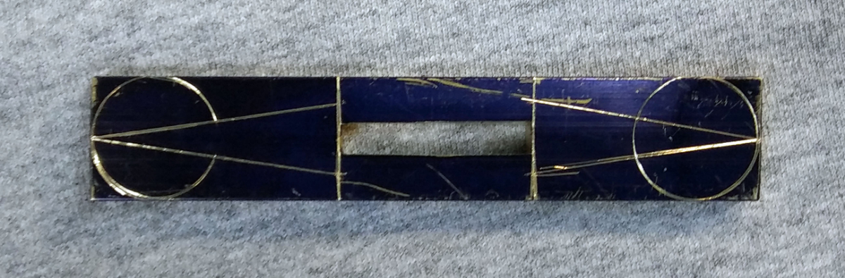

Here is the shape scratched and the brass after painting it with layout fluid. IMHO the layout fluid was also worth the price! It doesn't rub off like Sharpie does.

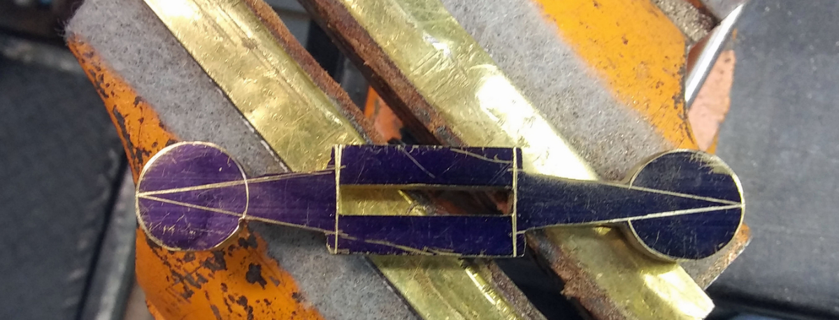

Hours of sanding and filing later, I have the shape of the guard roughed out.

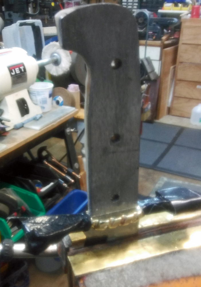

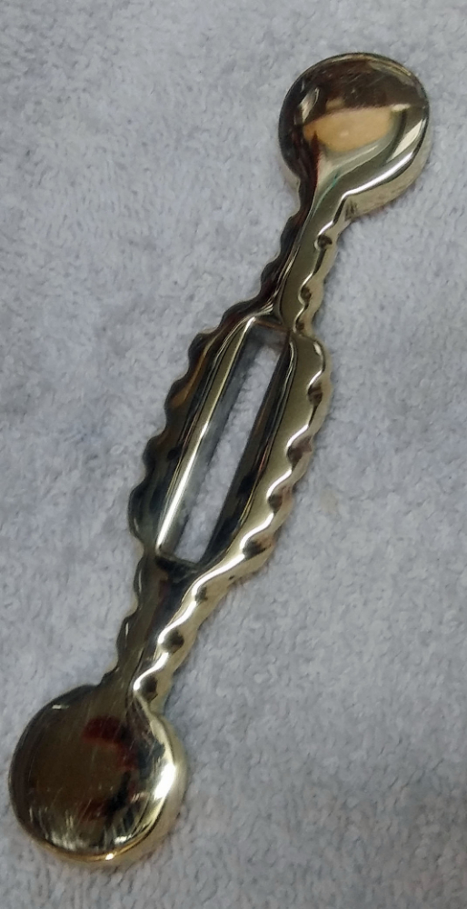

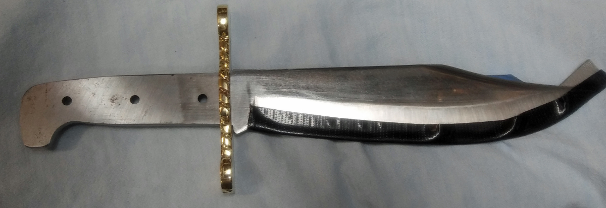

I could not be content with a plain brass guard and I wasn't very excited about bending the guard like some of the original Western guards, so I file work the edge of the crossbar between the circles or discs either end of the guard. It's getting close, but still a long ways to go!
This is a trial fit of the guard, nice and snug.

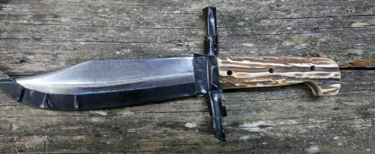

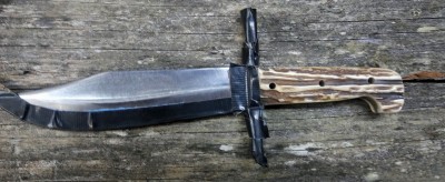

Stag is glued into place in mosaic pin holes are drilled. Notice that the edge and the guard are heavily taped to prevent damage to the guard while attaching the handle.
g- Attaching the Stag and being very careful of the guard so as not to ding it up.jpg

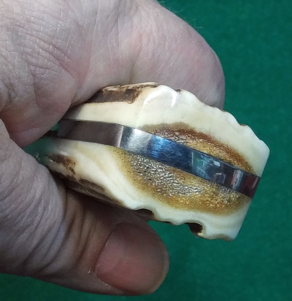

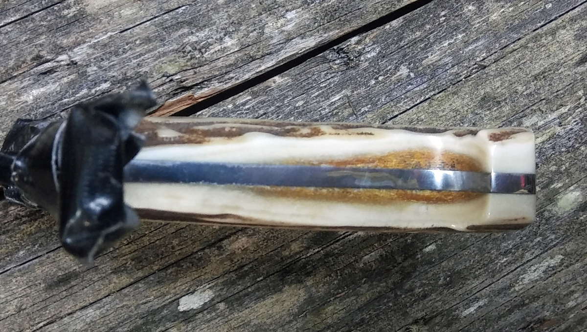

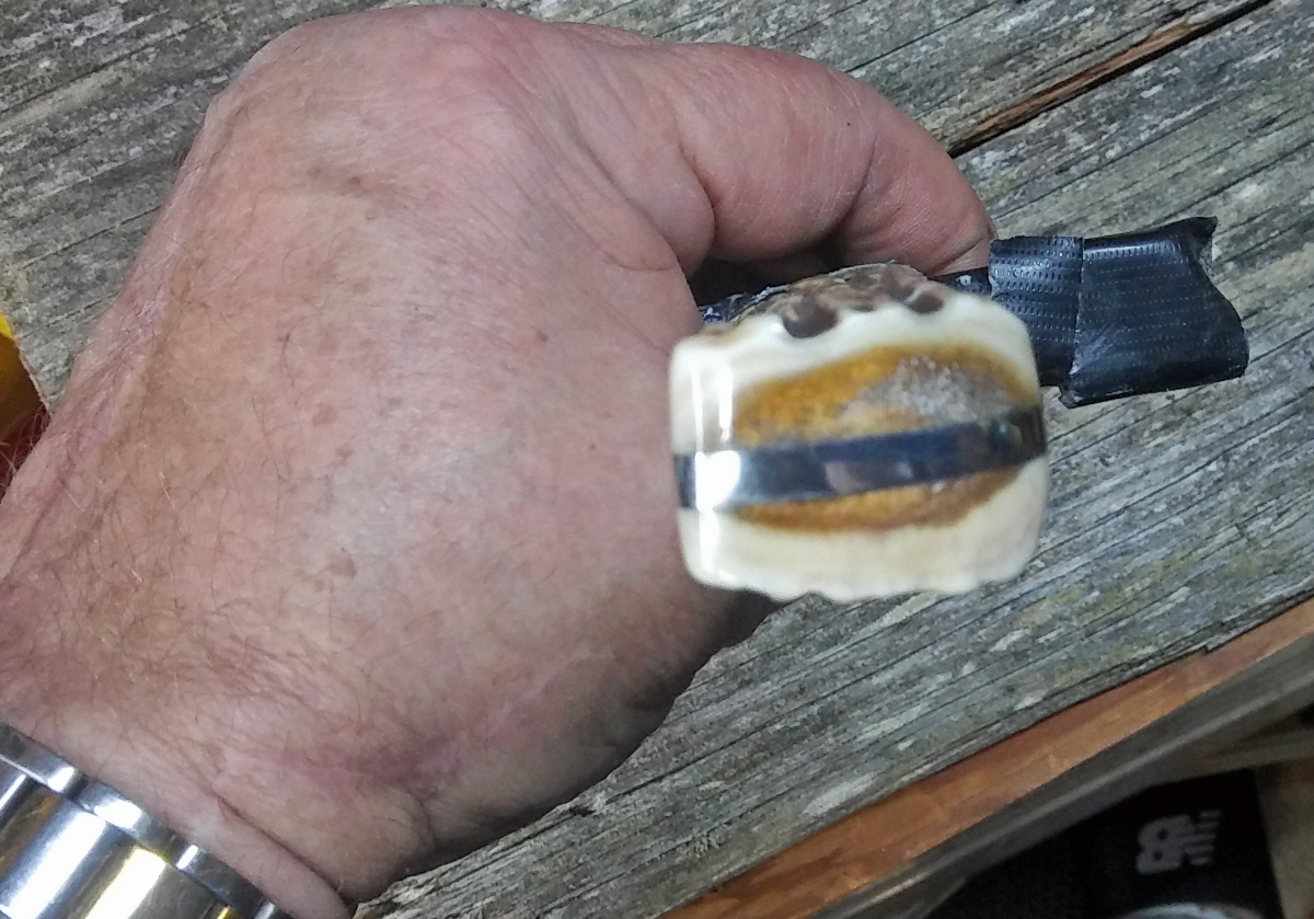

This shows pith from the center of the stag slab that is at the bottom of the handle. The top of the handle has showing it is all the harder stag exterior.
This is pith that shows on the end of the handle. It is almost impossible anymore to find thick solid slabs of the exterior hard stag without having to deal with some of the interior pith as well. My cost on the set of handles as it was was about $75 with shipping, so you can imagine what a perfect set of slab handles would cost for this knife! The cool thing is this can be hardened, if you're patient. It only takes a couple dozen applications of thin CA glue like Zap-A-Gap than and then a few applications of the Zap-A-Gap medium. When you are all finished it feels like it's been stabilized.

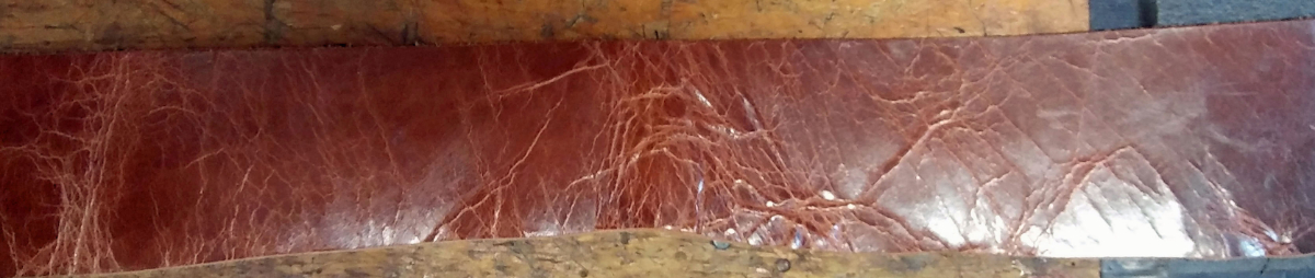

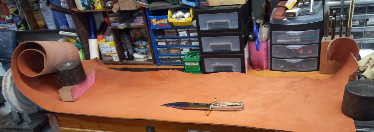

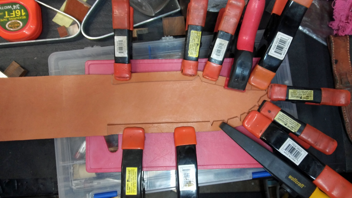

Next I needed to make a sheath for the knife. I patterned it after a number of other Western Bowie sheaths, all the while trying to keep it simple enough to be in my skill level. I had a big heavy cowhide to make the sheath with.

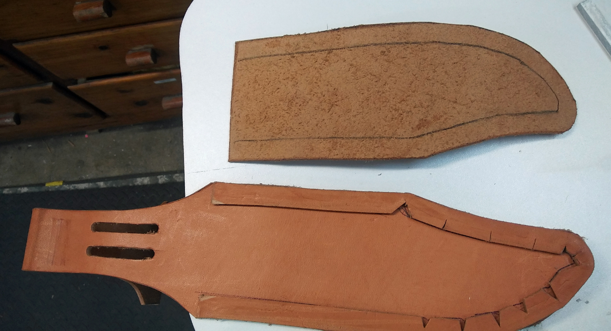

I visited my local shoe repairman/Tandy leather store and had a lot of chats with the new owner. He wants me to bring some knives in so he can sell them, or drool on them one I'm not sure which, probably both. He sold me the hardware I needed to put the sheath together, and also some of the tools. Here I am clamping the welt to the back of the sheath. This is the first sheath I have made that used a welt.
Here are the two halves of the sheath after the glue dried.

This was another type of hide we considered, but I'm glad we didn't choose this water buffalo hide. It has too glossy a finish on it for this application, IMHO.

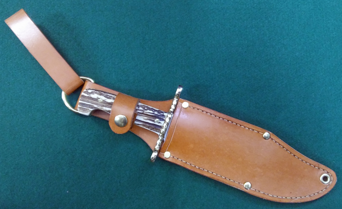

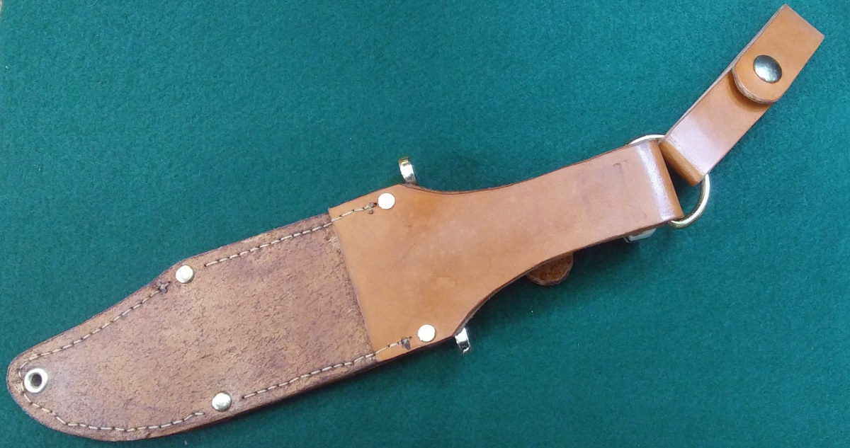

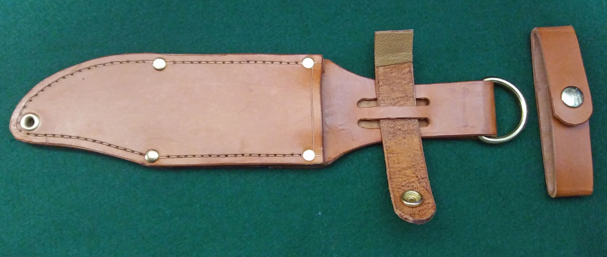

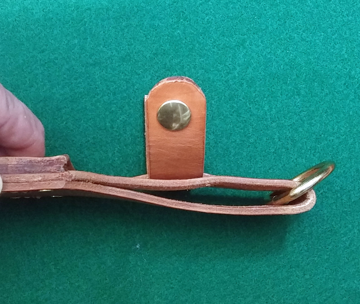

Here are some pictures of the sheath that shows you a the features:
Here is the sheath from the top view showing the strap open. You can see that the back of the snap is padded with leather so that the brass snap does not scratch the stag on the knife.

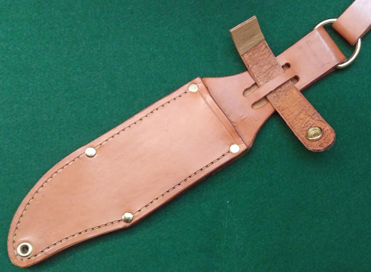

Most of the Western Bowie knife sheaths I have seen had this upper strap attached to the brass D ring. This allows the sheath to swing should you get into a vehicle and have the holster tied to your leg with leather straps, which I forgot to include for the pictures. This is with the upper belt strap removed. A large portion of the Western Bowie knife sheaths I have seen have that upper strap cut off of them. I made this one so it would snap so the wearer have the option of whether to use it or not.
If I were riding horseback, I would probably put my belt through the lower loop on the sheath and again tie the bottom of the sheath to my leg. There's not as much need for the sheath to rotate when on horseback because when writing in the open range you spend a lot of time with your legs extended the stirrups anyway, at least I always did.

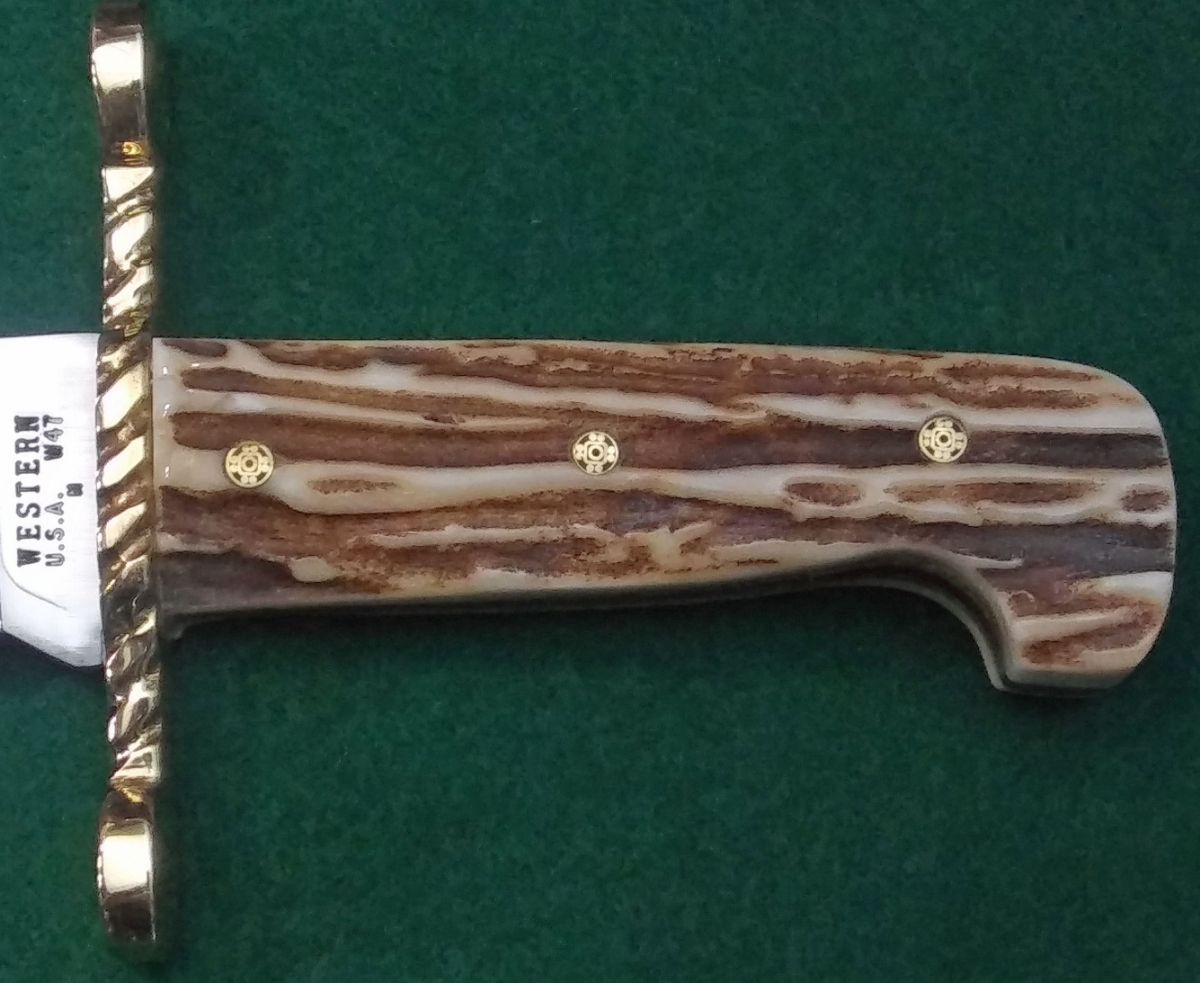

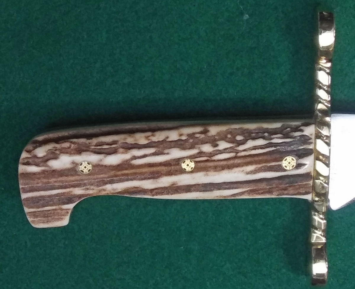

Here are some pictures of the handle, most of these are taken after the knife was finished:
This is the mark side handle enlarged.
The pile side handle enlarged.

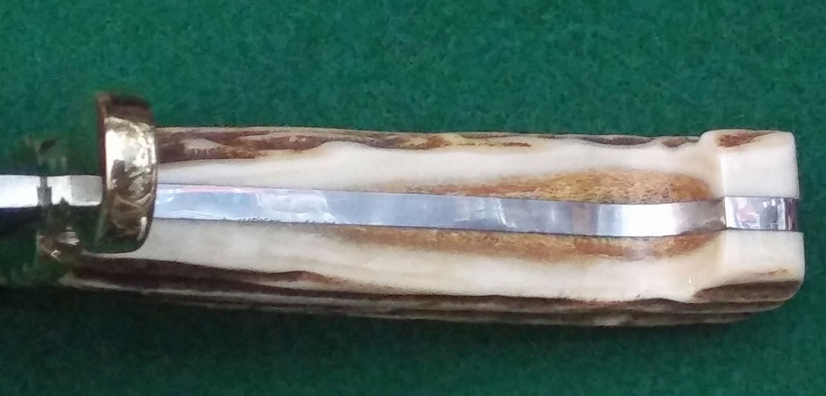

This is the top of the handle
This is the underside of the handle. Although there was no visible from the top of the handle, it was visible from the underside and I spent several hours applying Zap-A-Gap thin to soak into the pithy portion of the stag to stabilize it. It was probably two dozen coats of the thin CA and then six or eight coats of Zap medium CA to fill any porous portions.

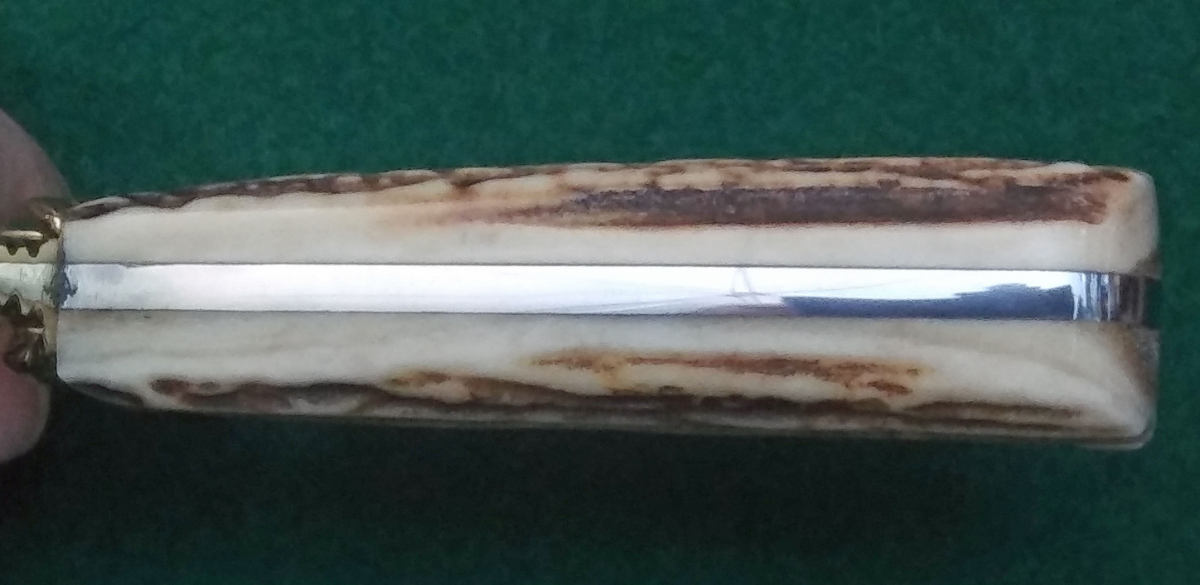

The end of the handle receive the same treatment on the more porous portions of the stag.

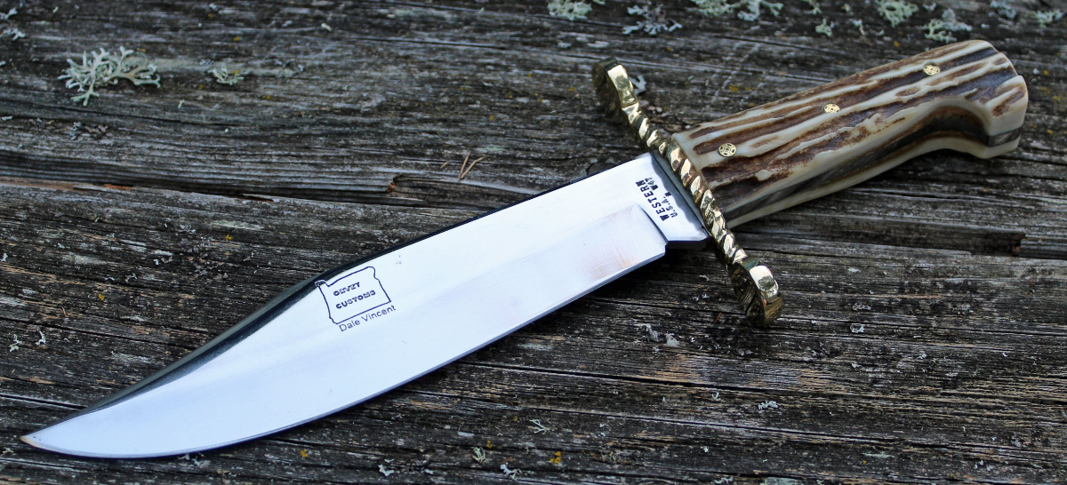

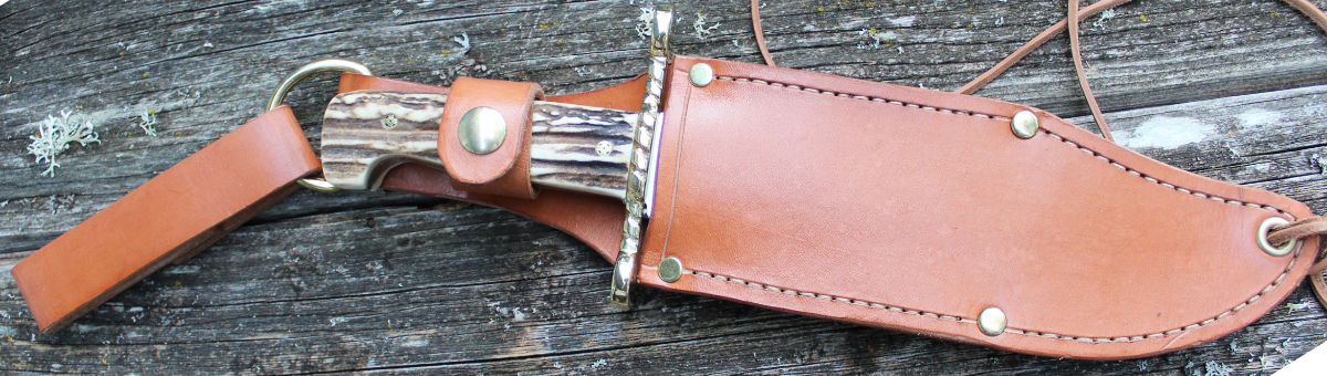

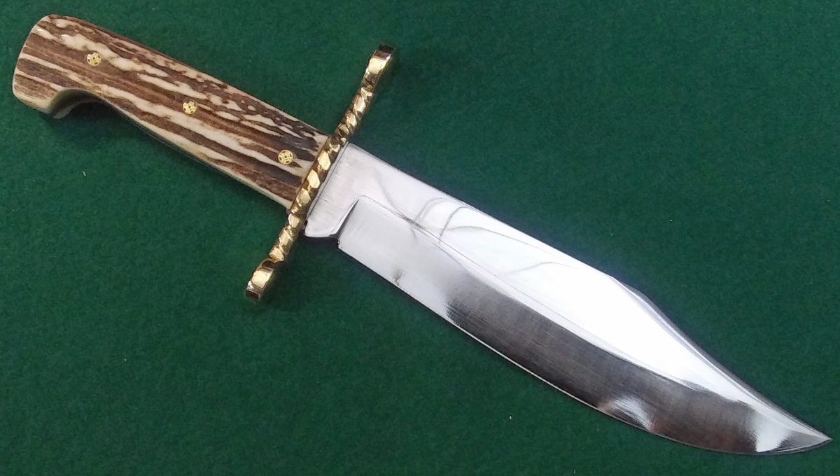

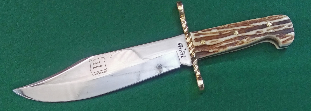

Here are the finished pictures of the #47 Bowie with stag handles.
These first two pictures are in the sheath in the last two are the knife itself.
I hope you enjoyed looking at the pictures is much as I enjoyed building the knife. It was lots of fun!
My apologies for the lousy indoor pictures, believe it or not it was sprinkling here today when I was trying to take the pictures. ::shrug::

Meridian_Mike wrote:Excellent... excellent job Dale!
Great job on the sheath. Your work looks like a pro leather worker!
One question I am sure you have considered. It looks like the leather is still untreated. In a case like this is it wise to treat the leather with Mink Oil or something like that?
I am wondering if a leather treatment will effect the knife.
Once again.... the whole project is a work of art!
::tu::
Thank you Mike and Tony, I appreciate your input! ::tu:: ::handshake::
Sorry I didn't get back to you yesterday Mike, I have to go to the doctor on Mondays, Wednesdays and Fridays for the next month or so to have the surgical site monitored and the packing in it changed. Sometimes I'm pretty well done for the rest of the day, it can be pretty painful.
As a matter of fact, I did treat the leather. My customer wanted the natural look of the leather and wanted me to leave it untreated. I advised against that and said I would look for something that would keep it as close to its natural colors possible. He thought that was a good idea so I went to my local Tandy Leather affiliate, basically a shoe and the leather repair shop with a fairly decent inventory of leatherworking products.
I explained that I wanted something that would change the color of the leather much but would help to seal it and protect it. One of the owners of the shop recommended Fiebing's Leather Balm, which is what I used on it.
Thanks to Tony for the link to Fiebing's, here is the product they used: https://www.fiebing.com/catalogue/top-f ... roduct=196
On the subject of storing knives in leather –
I am reluctant to separate the knife from the correct sheath (for fear of not getting the right sheath with the knife) but I don't want them to become corroded either. I haven't found a completely satisfactory solution for fixed blades but for the folders I use a small Ziploc bag, 3 x 6" is plenty large enough for a Schrade LB7. I put the knife in the Ziploc and squeeze out as much air as possible then seal the bag and put the knife back in the sheath. That way I don't have the sheath separated from the knife to which it belongs.
If you have purchased any of the late issue Camillus knives they did something similar except they did not use Ziploc bags. They used a heavier, probably 4 mil plastic pouch with a fold-over top. The folders with sheaths that I purchased in the Gran'pa series had the knives wrapped in blue plastic and put inside the sheaths.

I mentioned in an earlier post that my wife was going to try and get some better pictures of the knife then I could get in my shop.
Here's a couple she took and I think she may have of real future photographing my knives! :mrgreen:
Meridian_Mike
Posts: 4981
Location: Mississippi
Re: Western #47 Build with Stag
Post by Meridian_Mike »
Your wife did good. VERY nice pics of a VERY nice knife!
It's a beauty Dale.
::tu::
