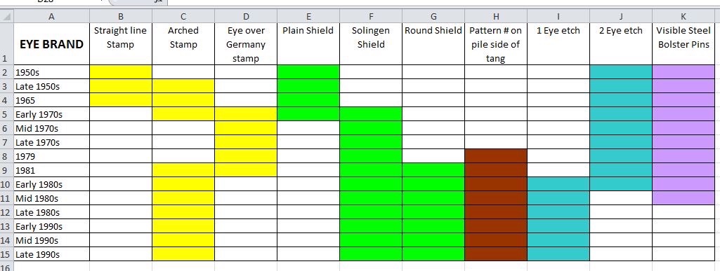

- XX Case XX
- Posts: 3623
- Location: California
Re: Reading German Eye tang stamps
Don't know if this will help you on your specific question, but you might find this information helpful in the future. (Click on the image to get a closer look).
