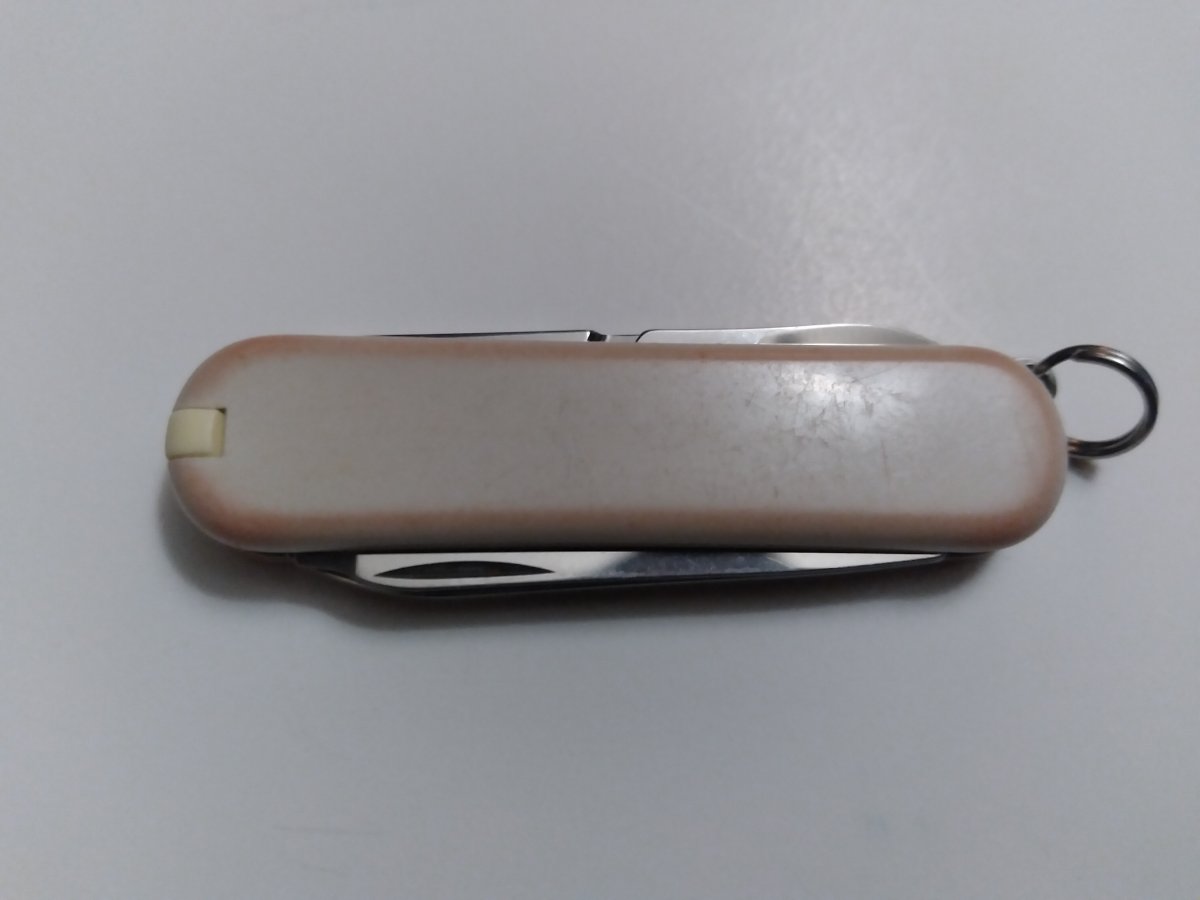

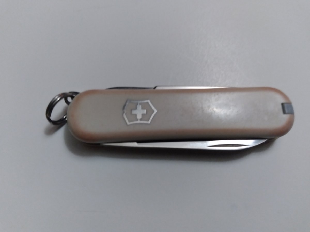

This white Victorinox Classic SD recently came to me in a lot of 10. For a per-unit price of $2.22, it's a decent carrier. However, the white scales have seen their better days, and I'd like to improve the knifes looks. Is there a practical way to return the scales to the appearance they had when new? If not, I'll have to start casting around for replacement scales.

If you mean just to brighten them up and remove some minor scratches, I have used either Flitz or Simichrome Polish on the plastic with good results. Don't get too wild with the polish though or it will remove the Swiss Cross logo.Dan In MI wrote: ↑Tue Apr 06, 2021 8:39 pm This white Victorinox Classic SD recently came to me in a lot of 10. For a per-unit price of $2.22, it's a decent carrier. However, the white scales have seen their better days, and I'd like to improve the knifes looks. Is there a practical way to return the scales to the appearance they had when new? If not, I'll have to start casting around for replacement scales.

Polish could well brighten them up and remove light scratches, but I am more concerned about the pinkish crud around the edges. What, if anything, might get rid of that?

That "pinkish crud" may be caused by exposure to UV light or possibly by hand oils and such. It may only be microns deep. If so, a light rub with some 0000 steel wool may remove it. It goes without saying you need to be careful, but if your alternative is to replace the scales what do you have to lose? Then, I would polish with Simichrome as suggested, or I have a special compound for my buffing wheel that is meant for plastics, I would give it a go with that.

That must be corrosion of the aluminum liners. The polish will do that too if it is not real bad and pitted.

I have some steel wool laying around, so if it's 0000, I'll give that a go. I'll take a better look at the liners; I'm really hoping they're not corroded.
The real issue with scale replacement is that a set of 58mm scales costs dadgummed near as much as a Classic SD! Yet all the same, I see no point in tossing any knife that is still functional.
