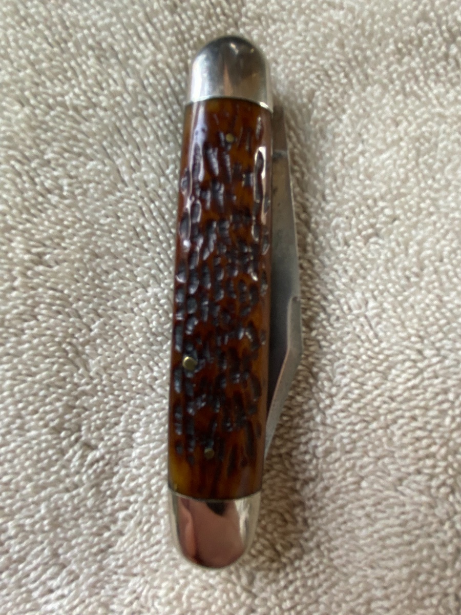

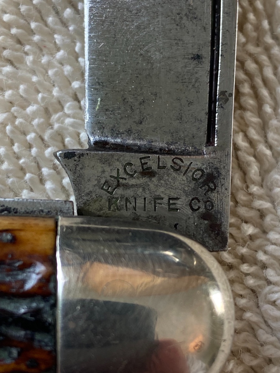

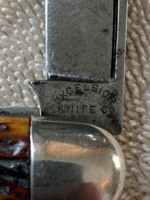

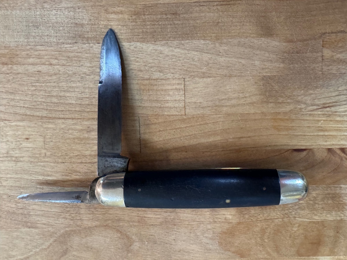

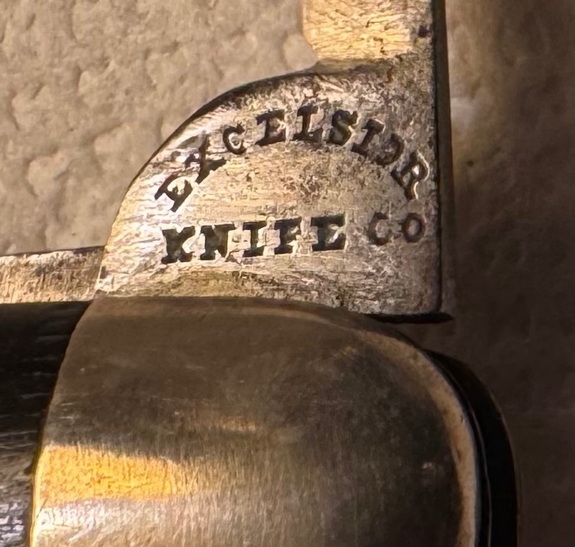

Look at the Co. in the tang stamp.It's not black like the rest of the stamp.Also the letters are not evenly spaced.The bone also isn't consistent with early Northfield bone.Another issue is the blade shape.On American made knives I've only seen that type of tang / blade transition on cokebottles or folding hunters.
Excelsior and Northfield knife parts were put together for many years by a fellow that was associated with Northfield for into the 1960's.This possibly is one of those.
Roger

Re: EXCELSIOR
Post by Oledadsknives »
Roger, it could be one of those, I have no idea either way. It was purchased years ago and been in this collection since. I like the knife for what it is fake or not.

btrwtr
Posts: 5483
Re: EXCELSIOR
Post by btrwtr »
I have followed this thread and reserved comment until now hoping Dimitri would see it and comment. His input along with peanut740 confirms what I had thought. Although an impressive looking knife it does not have the look of an old USA made Excelsior knife. My initial thought was that it was a more modern German made knife based on the bone jigging and overall appearnce. The lack of a blade kick stands out as very unusual for a less than folding hunter size jack. I have said before that when you see a knife that has no known comparators it can either be a very good or as in this case, not really what might be represented by the tang stamp.

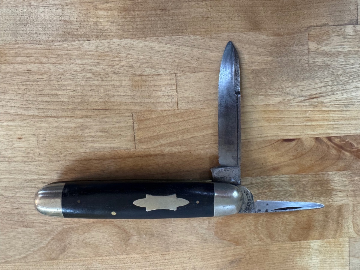

Mike V
Posts: 13
Joined: Tue Apr 06, 2021 11:07 am
Re: EXCELSIOR
Post by Mike V »

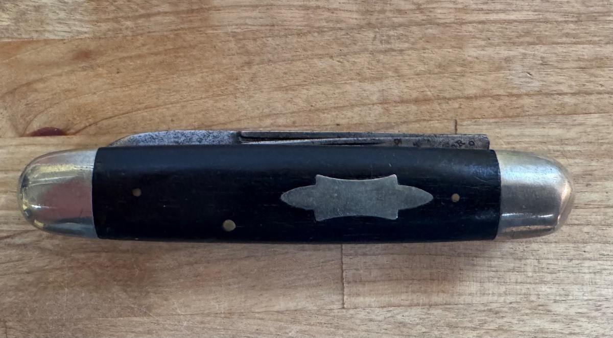

Can I show this cigar Jack. Thanks

Welcome to AAPK Mike. That a really good looking excelsior you have. Hope to see more posts from you and pics! We love to see pics!

Mike V
Posts: 13
Re: EXCELSIOR
Post by Mike V »

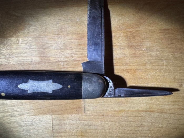

Thanks Jimbo! I’ve been a member for a while but that was my first post on the forum. I guess a picture of the blades would be nice too.

Mike V wrote: Sat Jan 14, 2023 7:29 pm Can I show this cigar Jack. Thanks
Of course you can show your knife Mike! We love pictures so show em' if you've got em'! ::welcome:: to AAPK too! ::handshake:: 8)

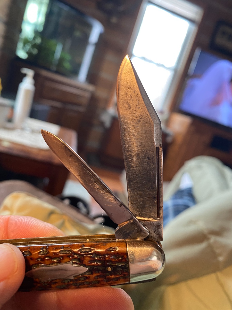

Picked this one up recently from a flea market .
Knife measure up at a whopping 4 1/4” closed , big heavy knife .
Early old brand , I believe late 1800s ?
If anybody else has one post them up .

ScoutKnives wrote: Sun Jun 01, 2025 4:01 pm If anybody else has one post them up
viewtopic.php?p=492898&hilit=Excelsior#p492898 (c)1884

peanut740 wrote: Sat Dec 31, 2022 2:43 pm Look at the Co. in the tang stamp.It's not black like the rest of the stamp.Also the letters are not evenly spaced.The bone also isn't consistent with early Northfield bone.Another issue is the blade shape.On American made knives I've only seen that type of tang / blade transition on cokebottles or folding hunters.
I want to correct somethings as I am proud of whom I consider my father and his history. They were knives created using the same tooling and steps by H. Gill as he bought the old factory and moved some of it behind his home. As far as I know none of these knives would have been marked with "Excelsior". It wouldn't make sense for them to have that marking.

I have a question
Is there any significance in the two different tang stamps, arched versus straight line?
Such as Excelsior built or Northfield built.
