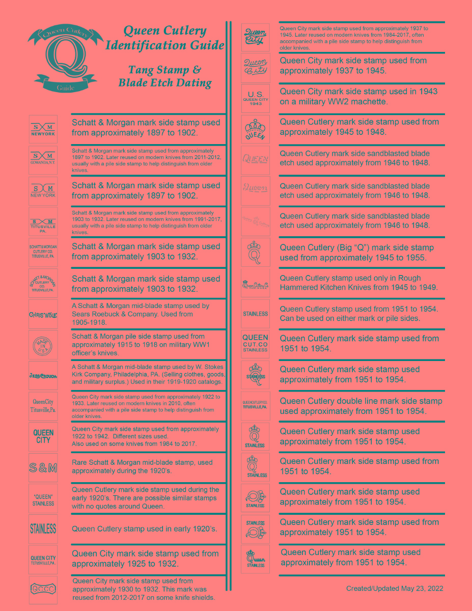

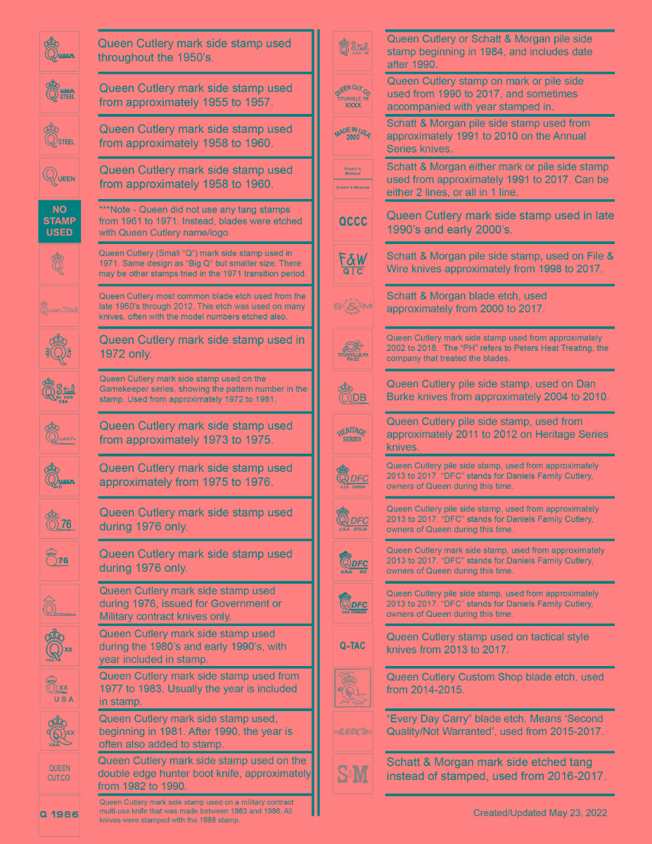

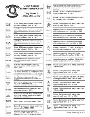

Re: Tang Stamps Charts
Just as an update to anyone using the Queen / Queen City / Schatt & Morgan tang guide, there was an updated version released May 2022 that included some additional stamps. Total list now has 71 different ones. I'm sure there are more out there to be found.
Carl B.

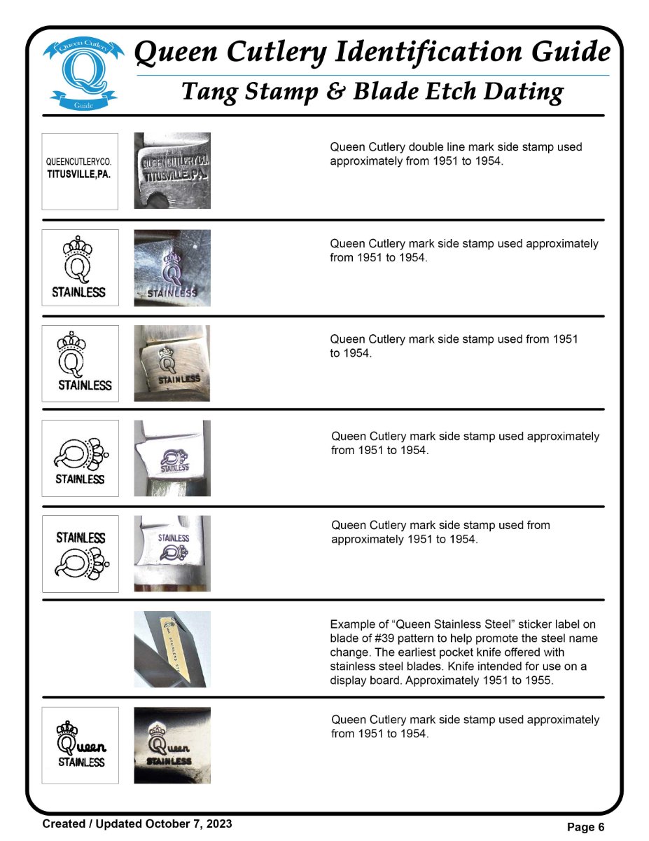

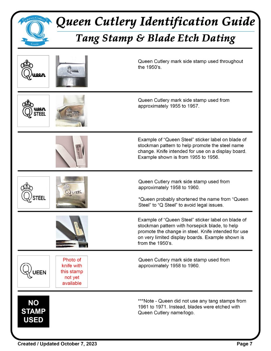

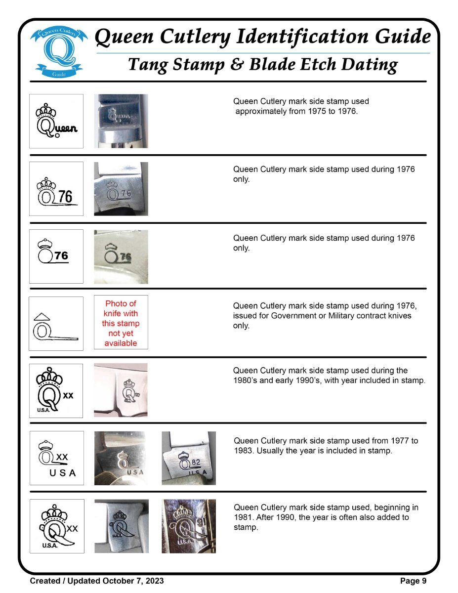

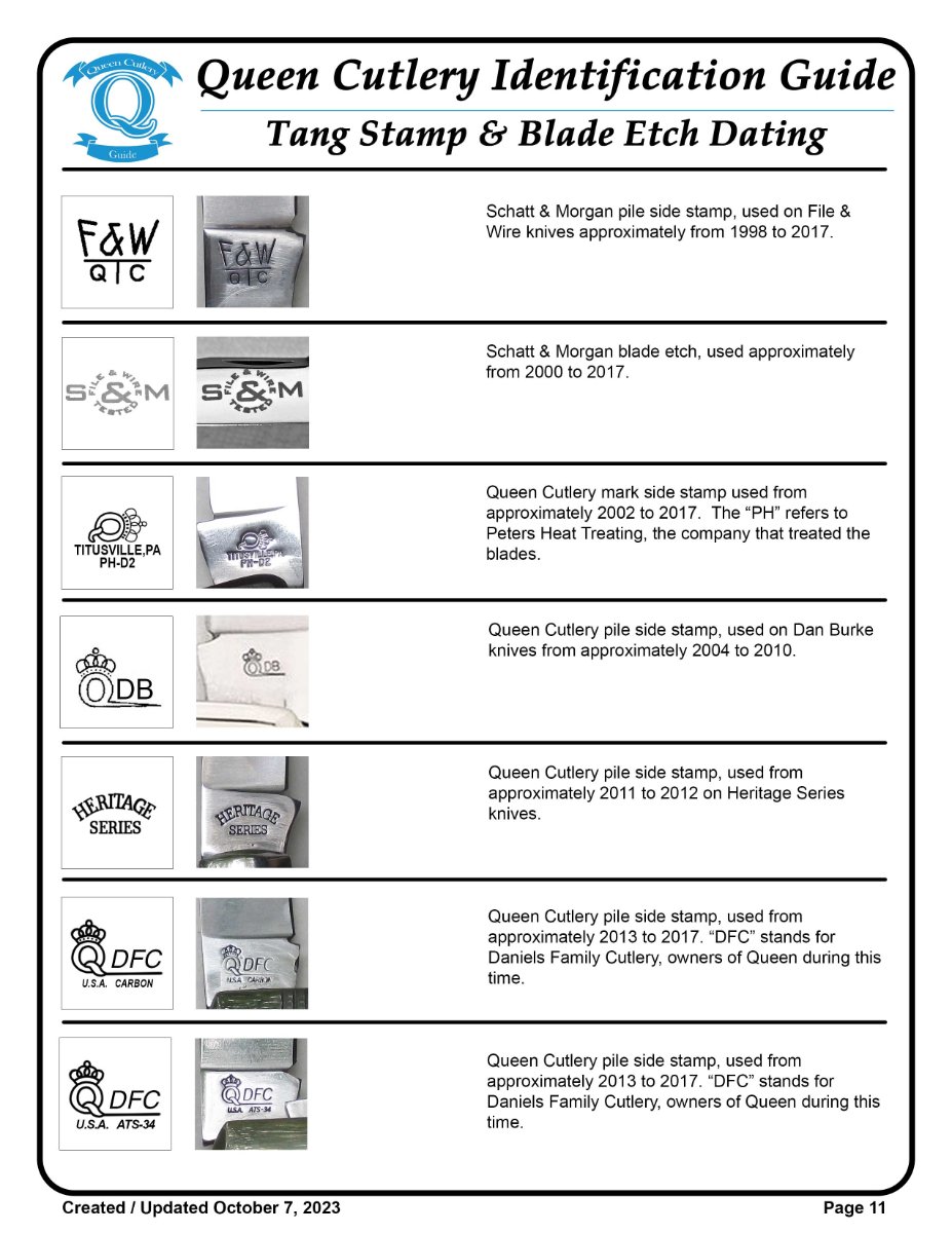

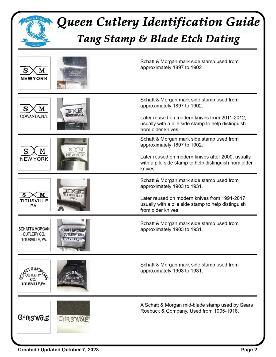

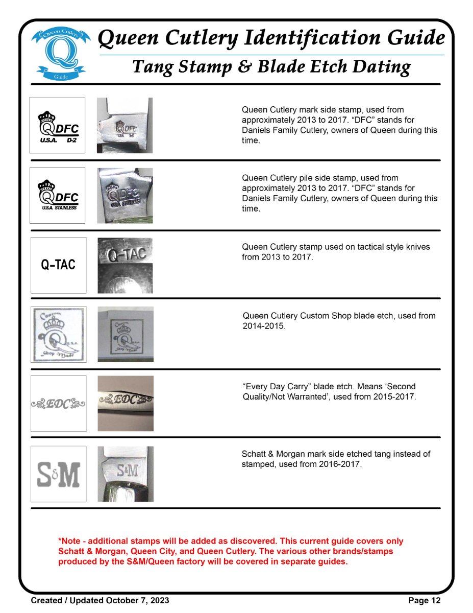

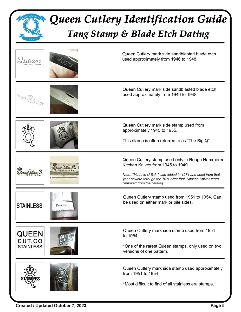

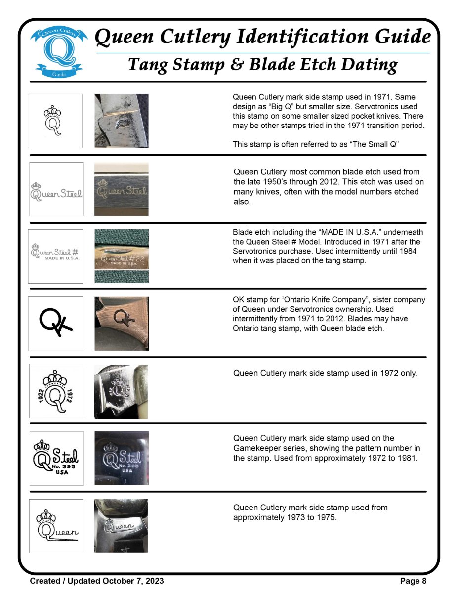

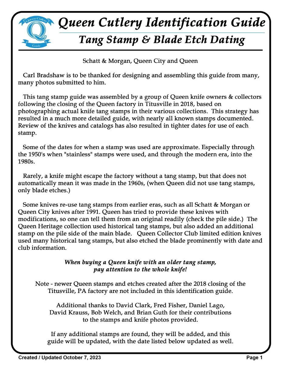

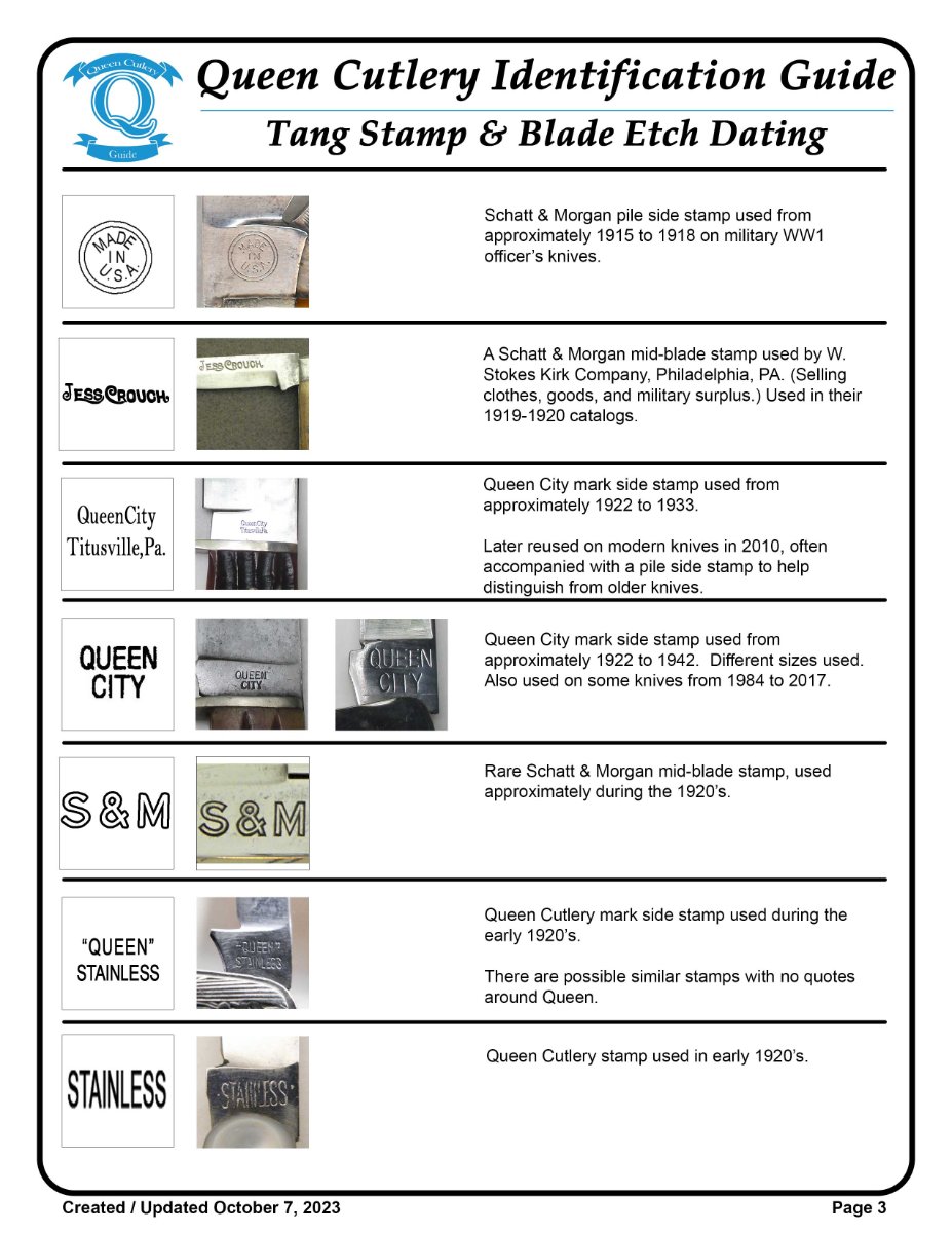

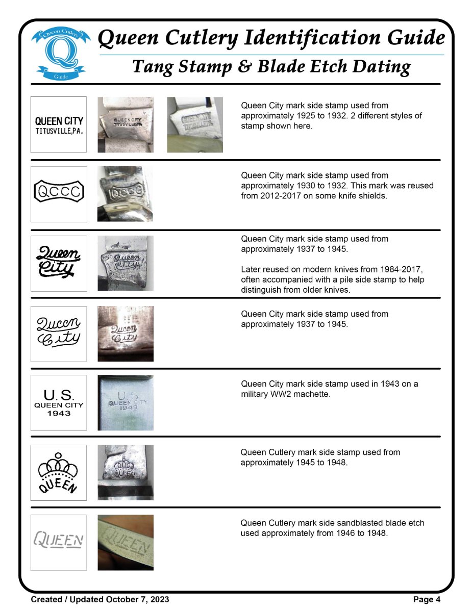

The Queen historians group has updated the Queen tang stamp chart. Making a few slight modifications, as well as adding in a few new stamps. This new version is updated as of October 2023.
Here are pages 1-6.
Here are pages 1-6.
Carl B.

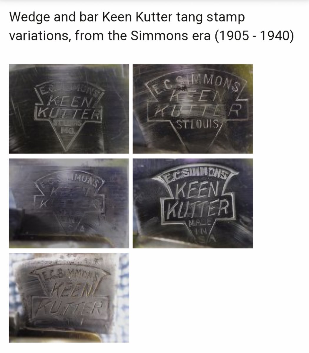

Ok, so this info may or may not have been tactically acquired from another knife related forum...
I was unable to confirm this, so the following is STRICTLY my uneducated opinion.
These Simmons KK stamps seem to be placed in chronological order, as follows:
St Louis, MO
St Louis
Made in USA
Made in USA (with ears)
Ears only
Does anybody have any info to confirm or deny the order?
St Louis, MO
St Louis
Made in USA
Ears only

- Mumbleypeg
- Posts: 14691
- Location: Republic of Texas
I can only advise that in Keen Kutter Pocket Knives by Alvin Sellens he states the Keen Kutter wedge and bar logo used on knives “prior to late 1939 contained the words St. Louis Mo. However, an occasional knife is seen that has the logo marked Made in USA. It is believed the Made in USA logo was used for a short period sometime in the 1920s. The logo used starting in 1939 has two variations both of which include only the words Keen Kutter.” (No St. Louis and no MADE in USA.) “A third variation, used after 1939, includes only the marking KK.”GringoBombero wrote: ↑Fri Apr 19, 2024 9:01 pm Ok, so this info may or may not have been tactically acquired from another knife related forum...
St Louis, MO
St Louis
Made in USA
Ears only
Based on that it seems very difficult to date a Keen Kutter from its tang stamp unless marked Made in USA (therefore 1920s) or simply KK (after 1939). St. Louis Mo. included in the stamp would be pre-late 1939.
Wow, thanks for all the info.
I figured it would be a long shot to get things in chronological order. Any stamp that says EC Simmons is going to be pre 39, and I guess that's as best as we can hope for. Aside from the USA stamp.

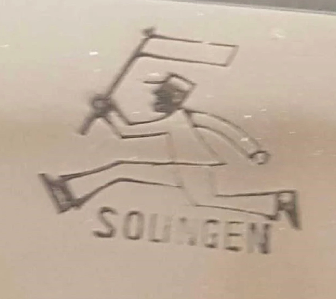

Is anyone familiar with the tang from Solingen of a man running with a banner? Tried finding some info on this and not having much luck
