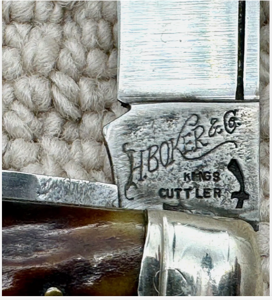

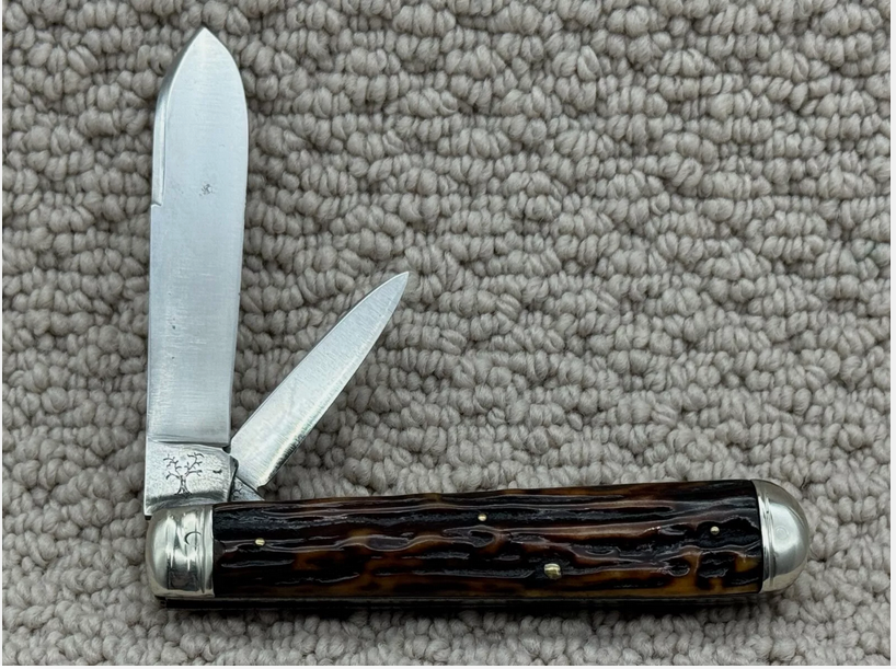

Here's an H. BOKER and Co the seller claims is authentic according to some unnamed 90 year old who is a 75 collector and former owner. Beautiful knife I'd say, fake or legit.
https://www.ebay.com/itm/315574650829
Won't let me copy image, but check the link.

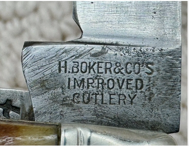

The Boker book by Neal Punchard and Ricky Ray does not show that stamp at all. If you want comments on this knife you should probably post it as a new topic in this forum. I will be happy to add the pictures.Ivoryman wrote: ↑Sat Jul 27, 2024 4:54 pmdanno50 wrote: ↑Sat Jul 27, 2024 4:16 pm I have 22 of the 23 pics from the auction saved on my desktop. I can start a thread in this topic and post them all, if anyone wishes?

I cannot speak to the authenticity of the knife, but I do have a few observations:
The pivot pin looks to have been replaced. That and the gaps around the springs makes me think it might have been taken apart before.
The tangs look original. I am unfamiliar with those stamps, but the metal appears to have age on it. The rest of the blades look far more polished than the tangs, so I believe that it has been cleaned up with a Scotchbrite belt. The backside of the main tang shows some machine marks.
The stag looks old, and beautiful. But it and the bolsters have been overly polished.
Legit? Cobbled? Repaired? I don't know, but it is beautiful. I would not pay what they are asking, but I do enjoy looking at it b

Thanks a ton Danno, you just confirmed what I suspected. I looked at every tang chart I could find, found none like this. Plus it looks too shallow, unlike any stamp I've ever seen. Thanks for the confirmation.

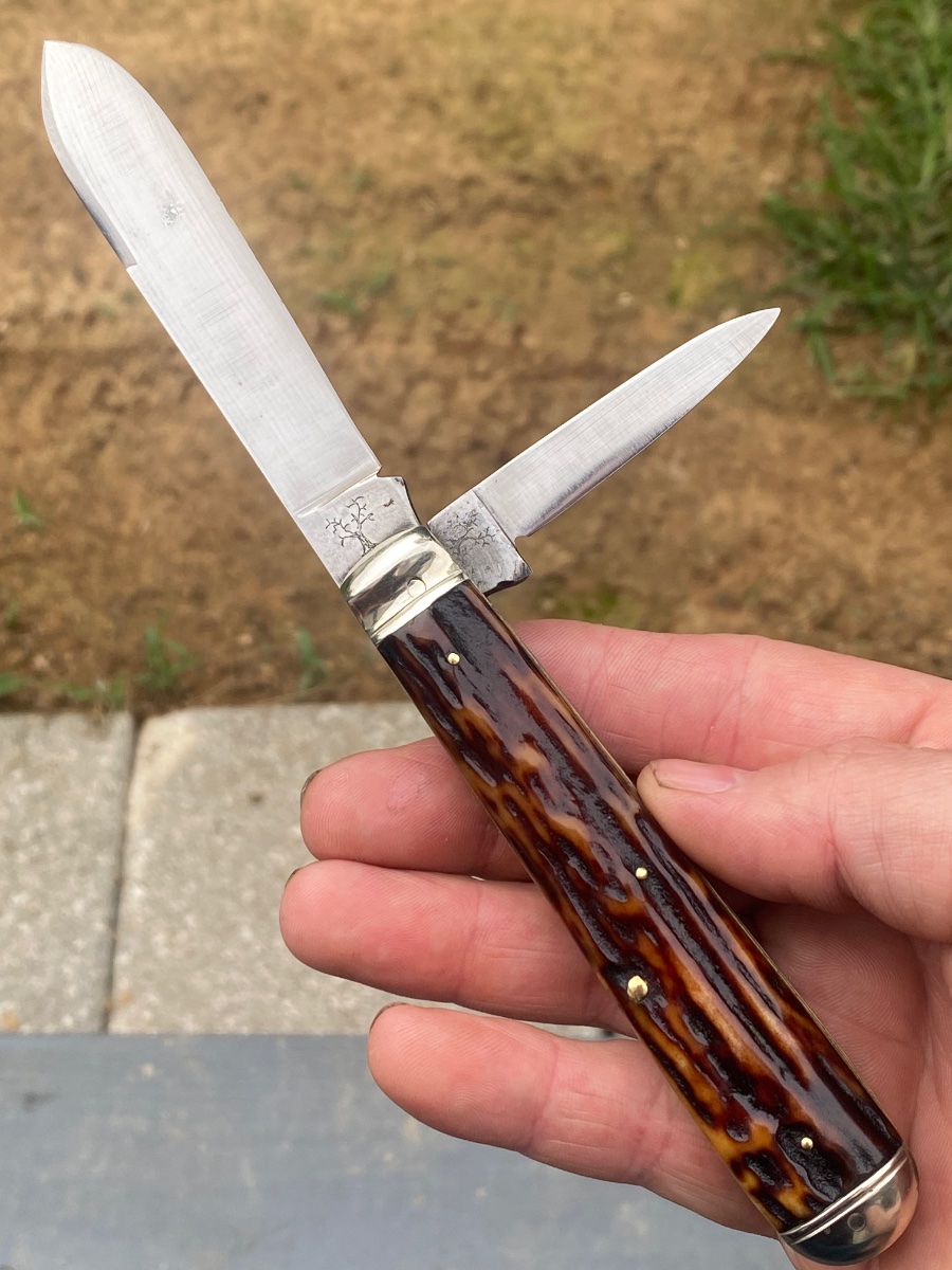

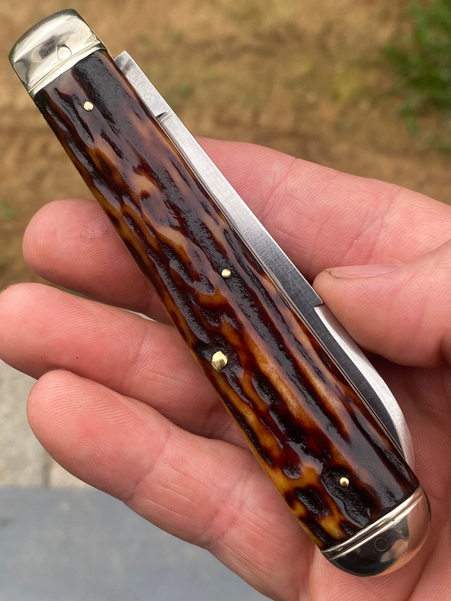

I ended up getting the knife knowing the main stamp already to not be correct, it’s a nice knife and quite a handful at 4-1/2” closed. Some fabulous looking stag on it.
- Posts: 21423
Re: A Suggestion For Those Who Post In The Counterfeit Forum
Those are beautiful handles.
