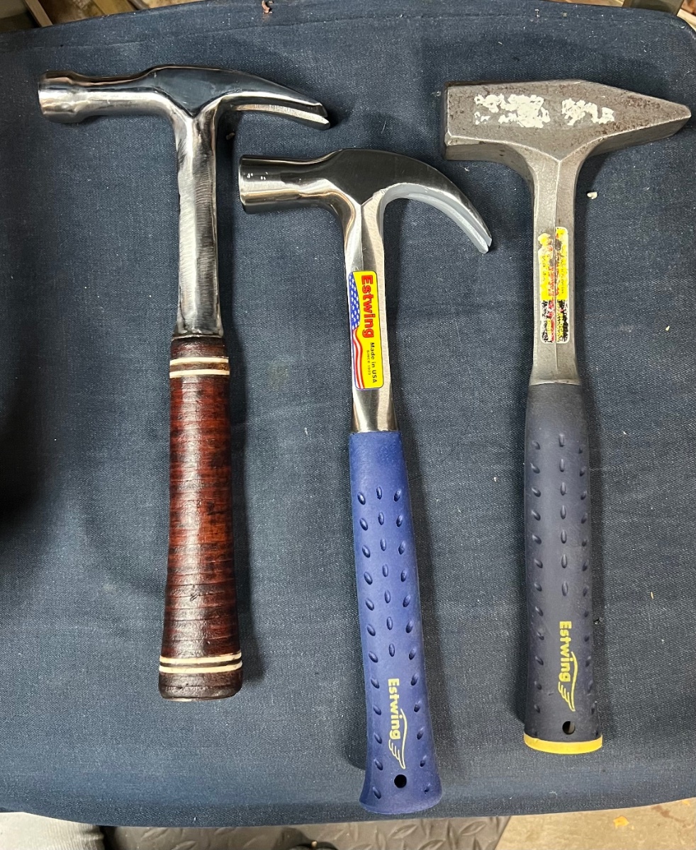

Here are some new rare Estwings I’ve added to to my collection recently.
Left side is an Electrician’s hammer. The long nose is for nailing inside junction boxes.
Middle is a 24 oz English pattern claw hammer
Right is a 32ounce cross peen.

I did not know electrician’s hammers existed. I can see where an electrician’s hammer would be handy but I've never leared what a cross peen is for. What distinguishes a English claw from other claws?

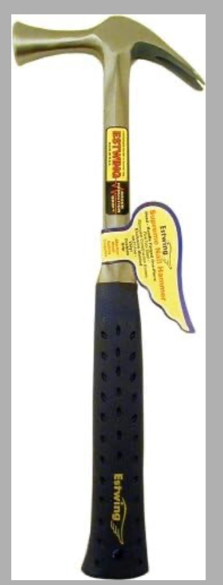

I think the Electrician hammer became obsolete when cordless drivers and screws took over. Probably was handy for nailing next to conduit and pipes too.

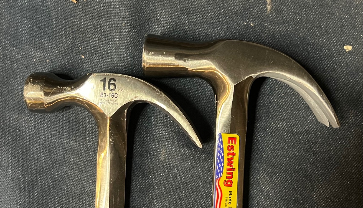

The English pattern has a different head its isn't as bulbous. It is also I think the only 24 ounce curved claw Estwing. Here it is compared to an American 16 ounce hammer. It doesn’t have that dramatic reduction behind the head.
They also make an English straight claw. It has proven to be elusive.
The Cross peen is for blacksmiths and metal working. For stretching or drawing out material.
You are correct I do not have a fireside friend yet. I have a large maul I never use. But I was wondering if a Straight peen could be made from the fireside friend? They are kind of heavy for the light blacksmithing I do anyway.
I’m also missing the small sledges. They call them drilling hammers 2,3&4 pound.
I only collect the Estwings with the classic flat steel shafts. Not the fiberglass or wood ones.

It looks like the English hammer is another way to increase weight and the Asian hammer is a variation of electrician's hammer, a long head without increasing weight.

Very interesting ::tu::
I will have to look at my hammer pile.

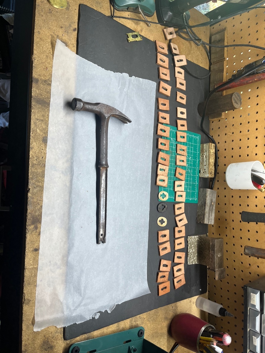

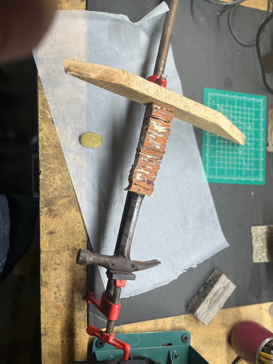

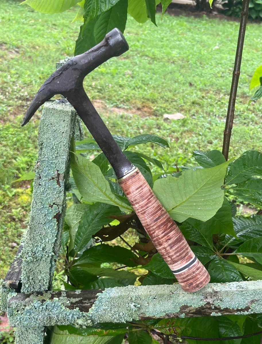

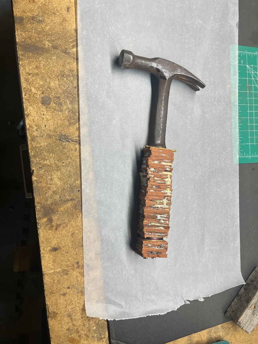

My Dad's old 1970's-vintage Estwing framing hammer has done a LOT of work, but last year I noticed that the leather washers had dried out and were breaking off.
I took it apart and cut out new leather washers, but I somehow lost the steel butt-cap.
I started repairing the hammer anyway, and made a new butt-cap from brass, but I was never satisfied with it, so I left the hammer in my "unfinished" pile.
A few weeks ago I was shining my dress shoes AND THE BUTT CAP FELL OUT OF ONE! I don't know where it was hiding, as I have worn those to church for the last year, but it fell out onto my lap!
Anyway, finally finished the hammer today. Dad was tickled with it!
Naked hammer!
Naked hammer!
Made a frame with scrap wood to help compress the leather

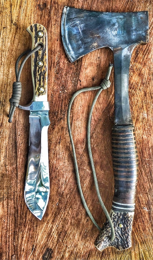

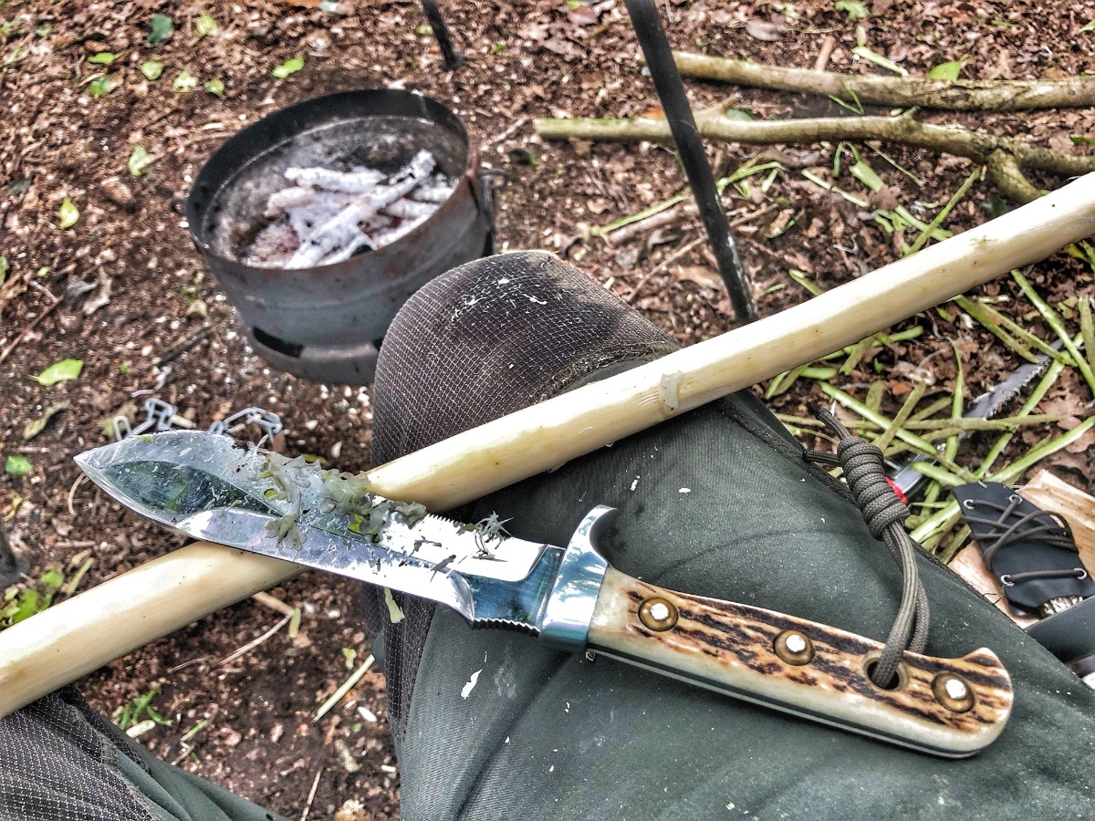

Love Estwing , used there hammers since the 80’s , restored a few as well over the years , my go to camp axe is a Estwing ::tu::

Wow! That came out great. 👍🏻

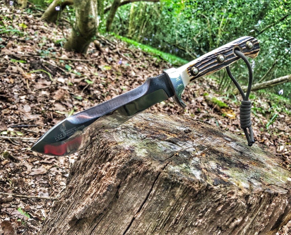

The Eastwing is great ,but that Puma😍!!

Excellent repair job! ::tu::
