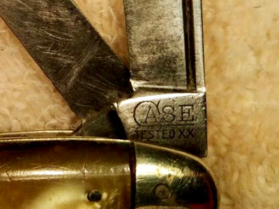

There’s a lot to “unpack” here but I’ll give it a shot - not sure I can explain in a few words what has taken years of handling and studying knives to learn. When a cold stamp is applied there is metal “mashed out” and up around the letters. An authentic stamp appears cut into the metal, not mashed into it. Think of pushing a spoon round-side down into mashed potatoes - you’ll see mashed potatoes pushed up and outward around the edges of the spoon. Then turn the spoon so it goes in edge first - you’ll see a smooth clean divot cut by the spoon.
An example of a good crisp old stamp. And a good grind line. Note how the letters appear to be cut into the metal, not mashed into it. The corners and ends of the letters are “squared off”.

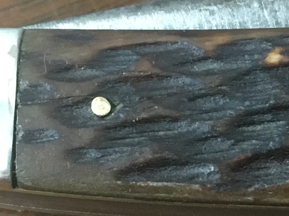

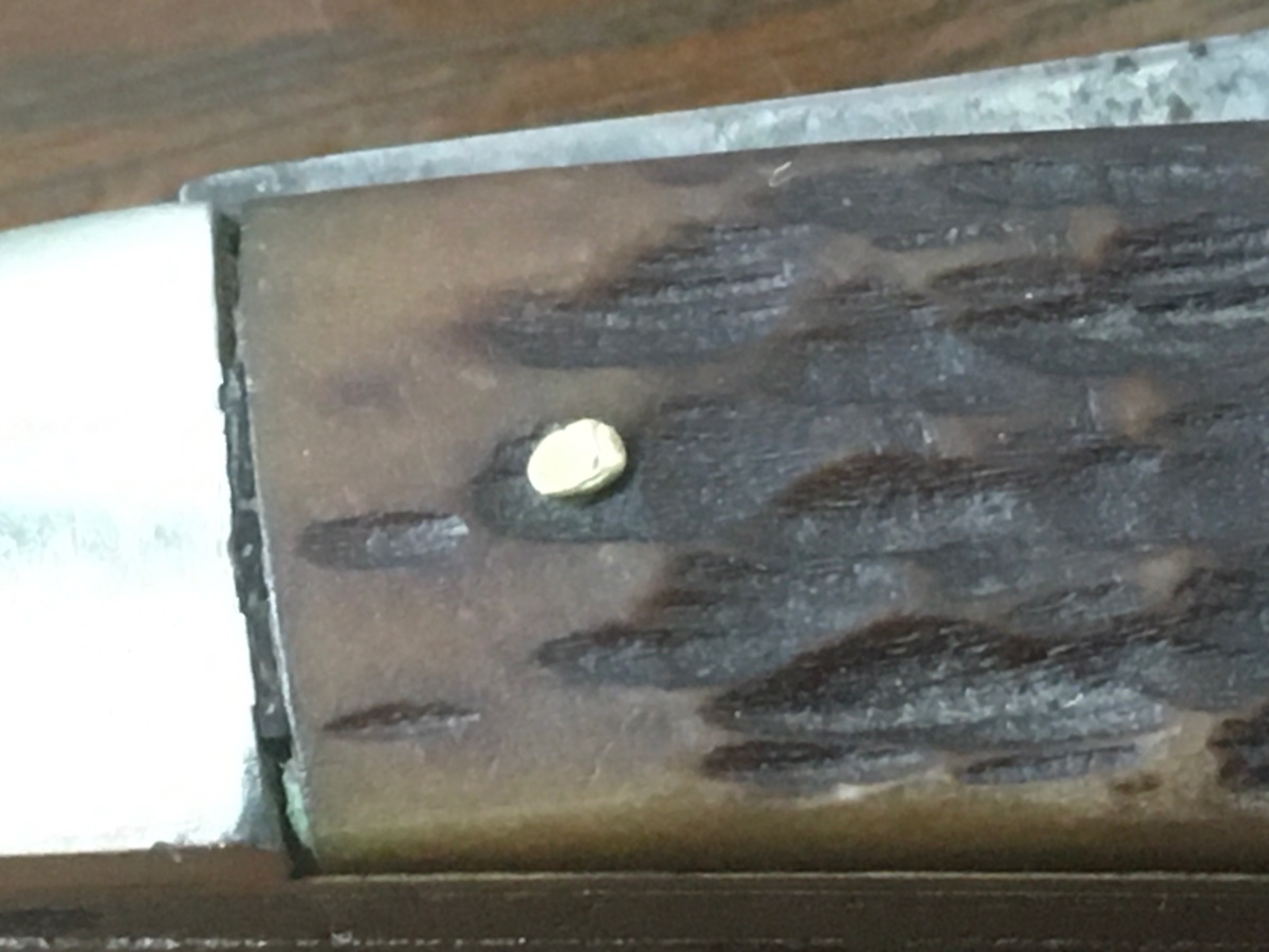

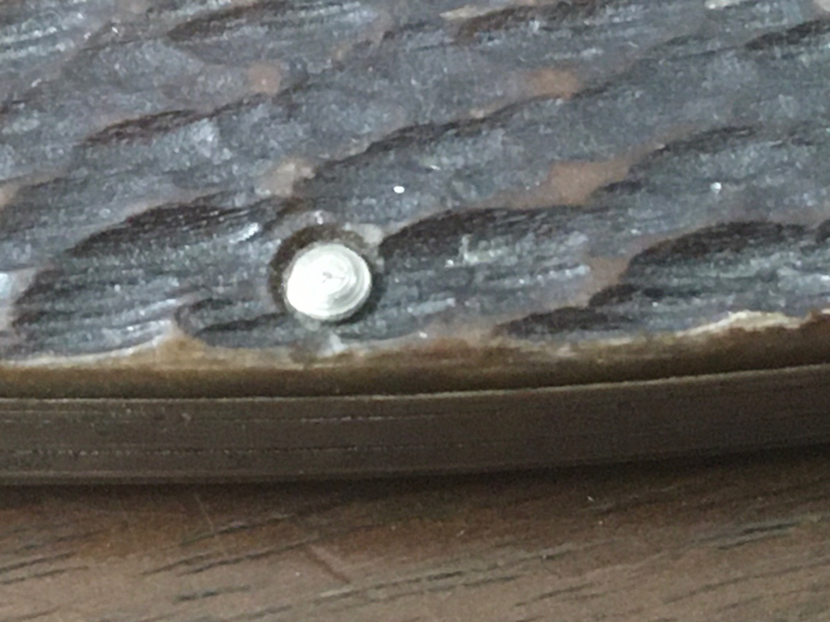

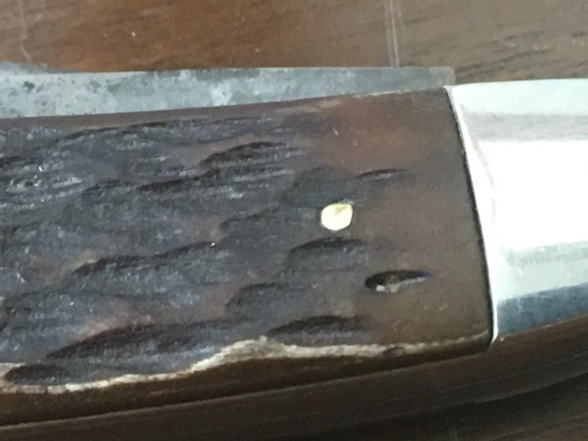

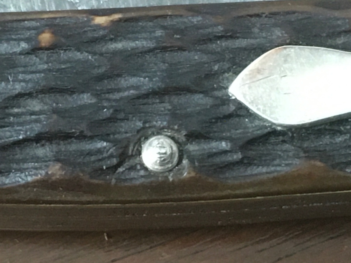

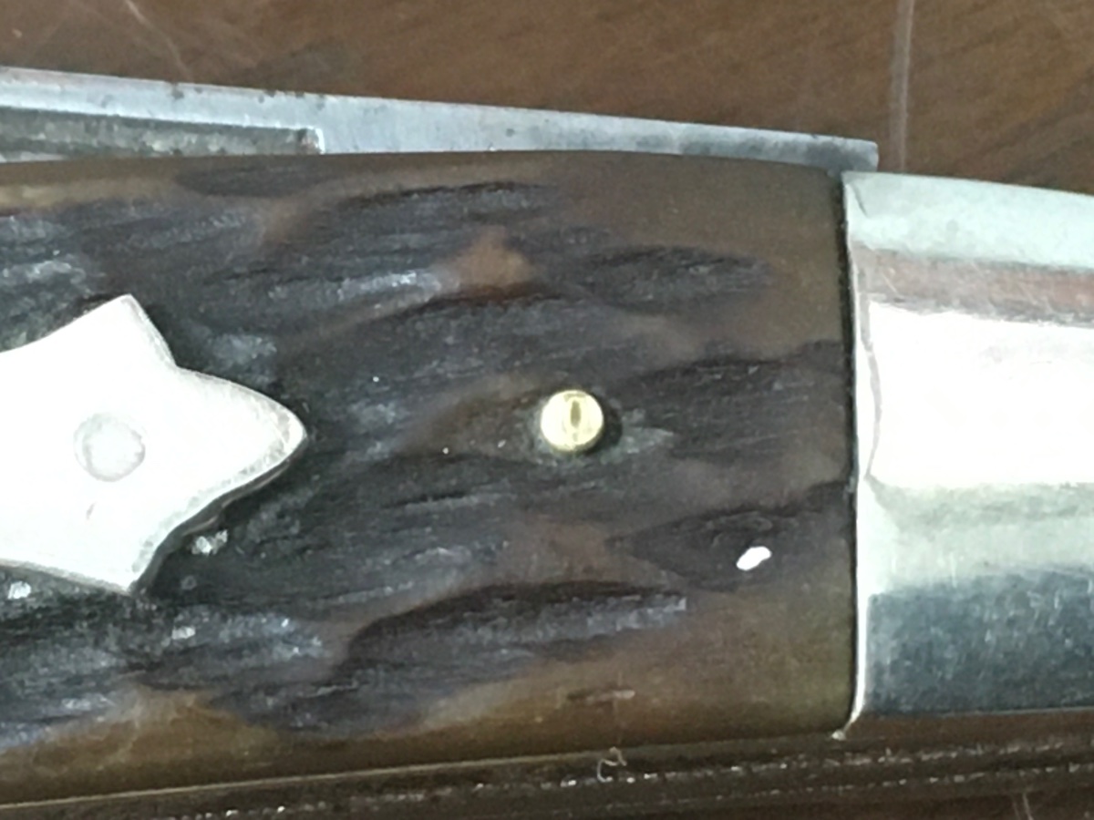

Here are closeup photos of the pins….

The center pin is clearly shown in these pictures as spun , you can see the circular marks from the process on the bone and pins .
It’s still a very nice knife , carry and enjoy it .

The bone is not of the era.It is also poorly fitted to the bolsters.The center pin is obviously spun.Tangs are shaved an cold stamped,and not centered correctly.Kicks on the tangs have been monkeyed with to make them fit.It all adds up to be a cobbled knife.Take it back,or put it in your pocket and use it.
