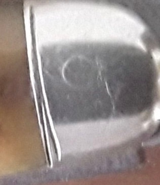

And this is a mite sloppily suspicious:
DE OPPRESSO LIBER
Sidlow Baxter
ea42
Posts: 3195
Location: Wallkill, NY
Re: Research not making sense
Post by ea42 »
RobesonsRme.com wrote: Sat May 21, 2022 1:19 am And this is a mite sloppily suspicious:
That's what makes me think that a punch blade was at some point switched out for the pen blade. Although it could also be the result of excessive twisting or prying.

Remington 5 blade sowbelly knife never came with a punch.The blade combination appears correct.The knife has undergone some kind of transformation.

Good points Charlie. There is enough about this OP knife that doesn't quite add up. The messed up bolster groove is hard to reconcile as being factory. Very unlikely that the knife at one time had a punch blade since I don't believe Remington ever made the R4283 five blade knife with a punch. The shield is incorrect for the knife. I don't like the fact that the handle center pins look to be so deeply spun into the handles.
The sowbelly pattern is an uncommon in any brand so parts for repairing this type of knife would be hard to find. The blades all look correct for an R4283 pattern. I think it is plausible that the knife is a knife made from Remington parts to make a complete but not quite correct R4283 knife. The Remington 5 blade sowbelly pattern could be a very lucrative knife to repair if the handles were broken or the knife was in some way compromised and needing repair. There is always a thought that knives that have been altered were altered to make a knife serviceable rather than to create a counterfeit knife. "Research not making sense" is a good title for this post.

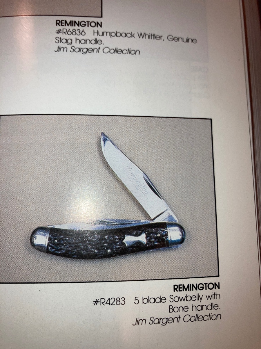

Thomasg
Posts: 744
Joined: Sat Jul 23, 2022 8:12 pm
Location: Batesville Arkansas
Post by Thomasg »
Picture borrowed from Sargents 3rd edition
Remington 5 blade sow belly
