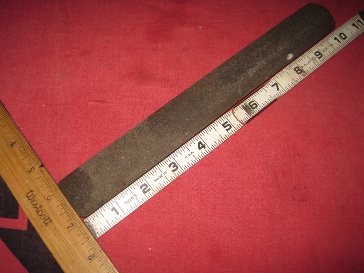

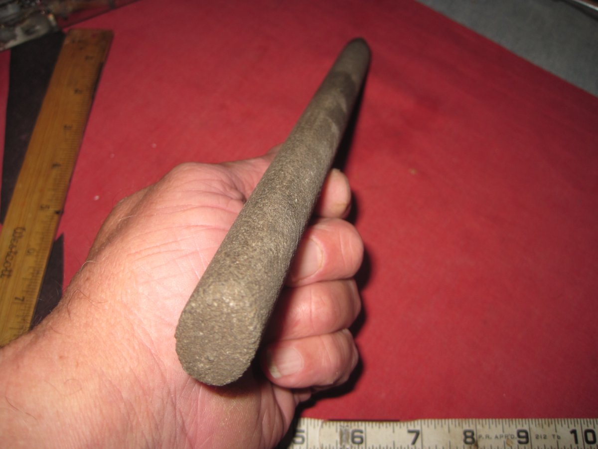

I assume this is some sort of sharpening stone.....It's oval in shape the entire length.
Just wanted to share.....will be listing on ebay in a few.

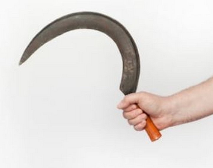

Nice find Scott. Those are for sharpening a sickle or scythe. I think they still make them for that purpose. I used to have a few sickles, but when our boys were teenagers, for some reason they all disappeared. ::hmm:: ::shrug::

Thanks Ken. ::handshake::
Just learned something else here on AAPK!!

Nice one Scott! Often when I see them they have a crack in the middle of the stone.
Ones I have seen broken have a wire in the center. I guess they are a composite stone formed around a wire core. Nice find! ::tu::

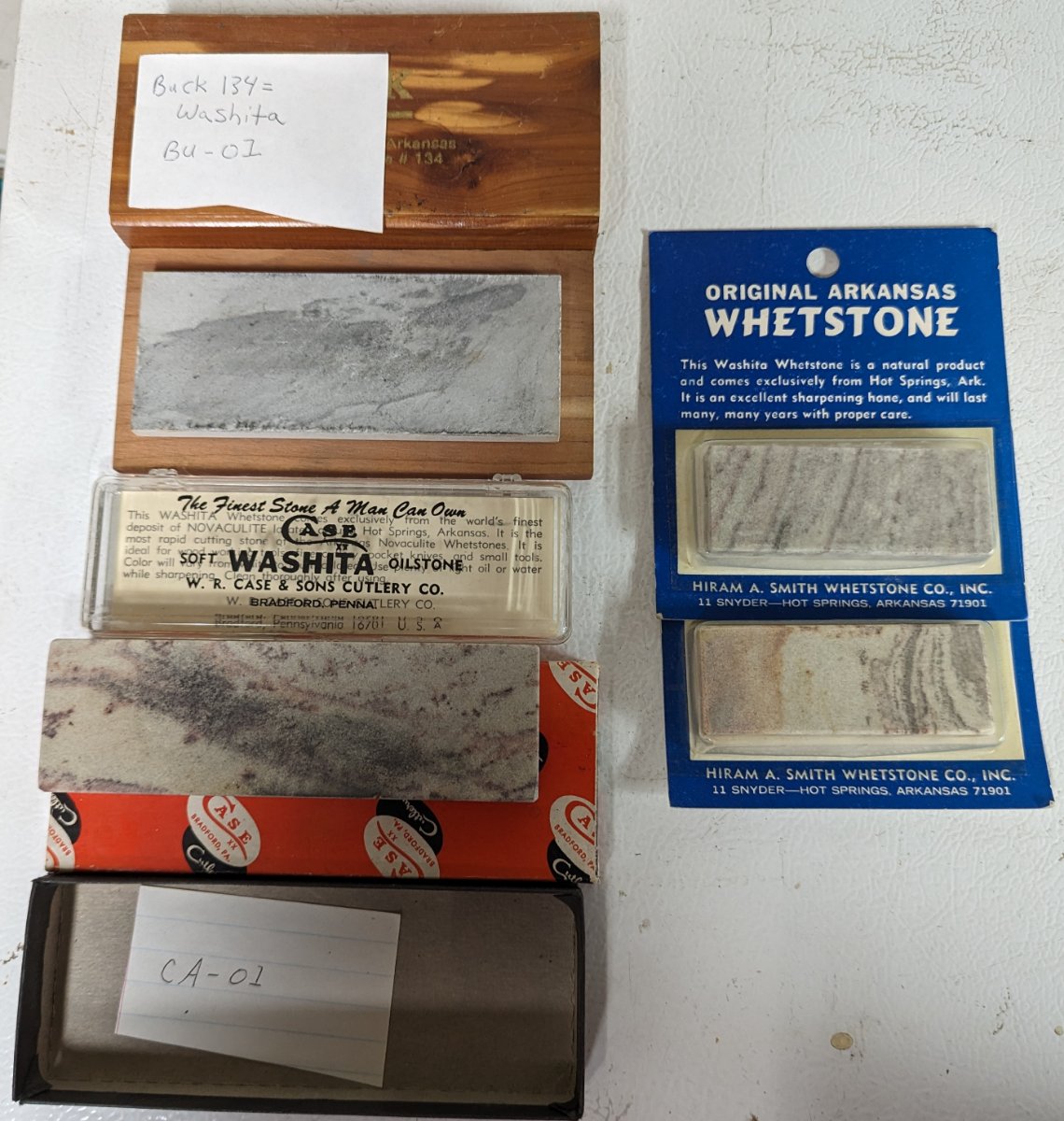

Dinadan wrote: Wed Aug 02, 2023 12:44 am Any chance of some photos of your stones?

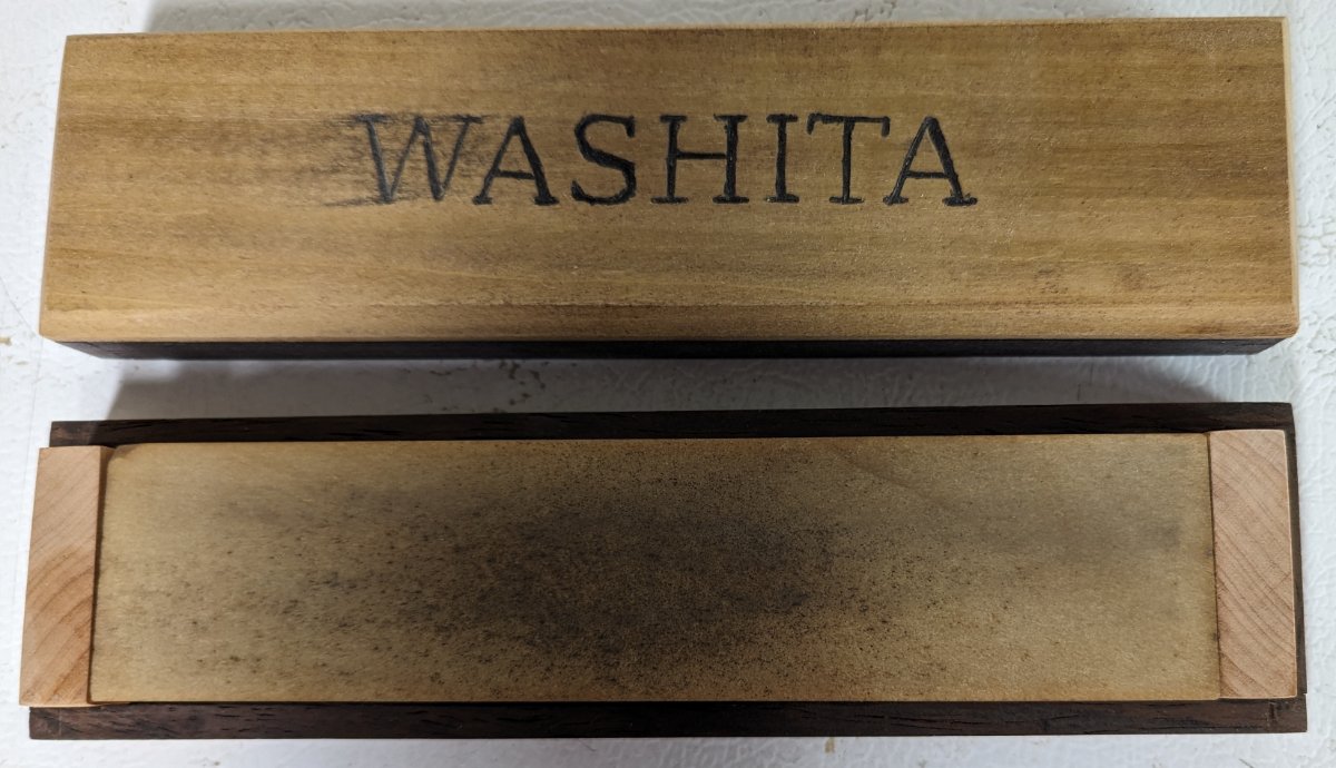

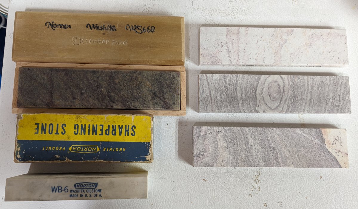

Lets start with my newest Washita stones from Norton. The four stones of the same size (one is in a wooden box that I made are all the "new" stock that I was able to purchase a few years back (near December 2020 I think). The one in the box is used and is colored from the oil. Even these four have different patterns and coloring. This matches pretty closely those of some Soft Arkansas stones that I see from say Smith. Note that the WB-6, which is one of the newer Norton Washita stones and it vaguely looks like a Lily White to me.

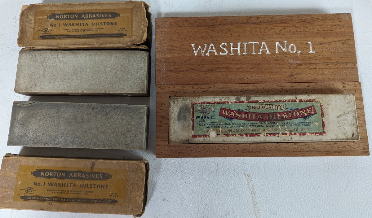

Next I have some Norton Washita stones labeled as No. 1. The stone in the African Mahogany case is older back when it was just Pike rather than Norton. This one looks like a Lily White to me, but it is labeled No. 1 Quality.

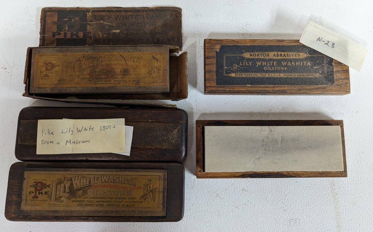

Here are three different Lily White stones. The bottom Left I purchased from a museum when they were getting rid of their woodworking display. Notice that the two pike Lily White stones appear discolored as opposed to the Norton stone that is white. I do not think that any of the Lily White stones here were actually used (ever).
It was explained to me once that only Norton can sell a true Washita and I forget the reason for that (I probably have it written down somewhere so if you really want to know, ask me and I will see if I can find it). That said, these are Washita stones sold by Buck, Case, and two from Hiram A. Smith.
I accidentally purchased on a Washita that look very much like all of the Washita stones that I see for sale in the UK. It was lightly dished so I flattened it. This came in a wooden box that was in horrible condition so i made a new box (and saved the old and marked what it came with). This is one of my favorite stones to use. Some of the Norton stones I do not use just because they are so collectible. Even fresh (meaning after I wore down the surface to flatten it) there was an orange-ish color to the stone.

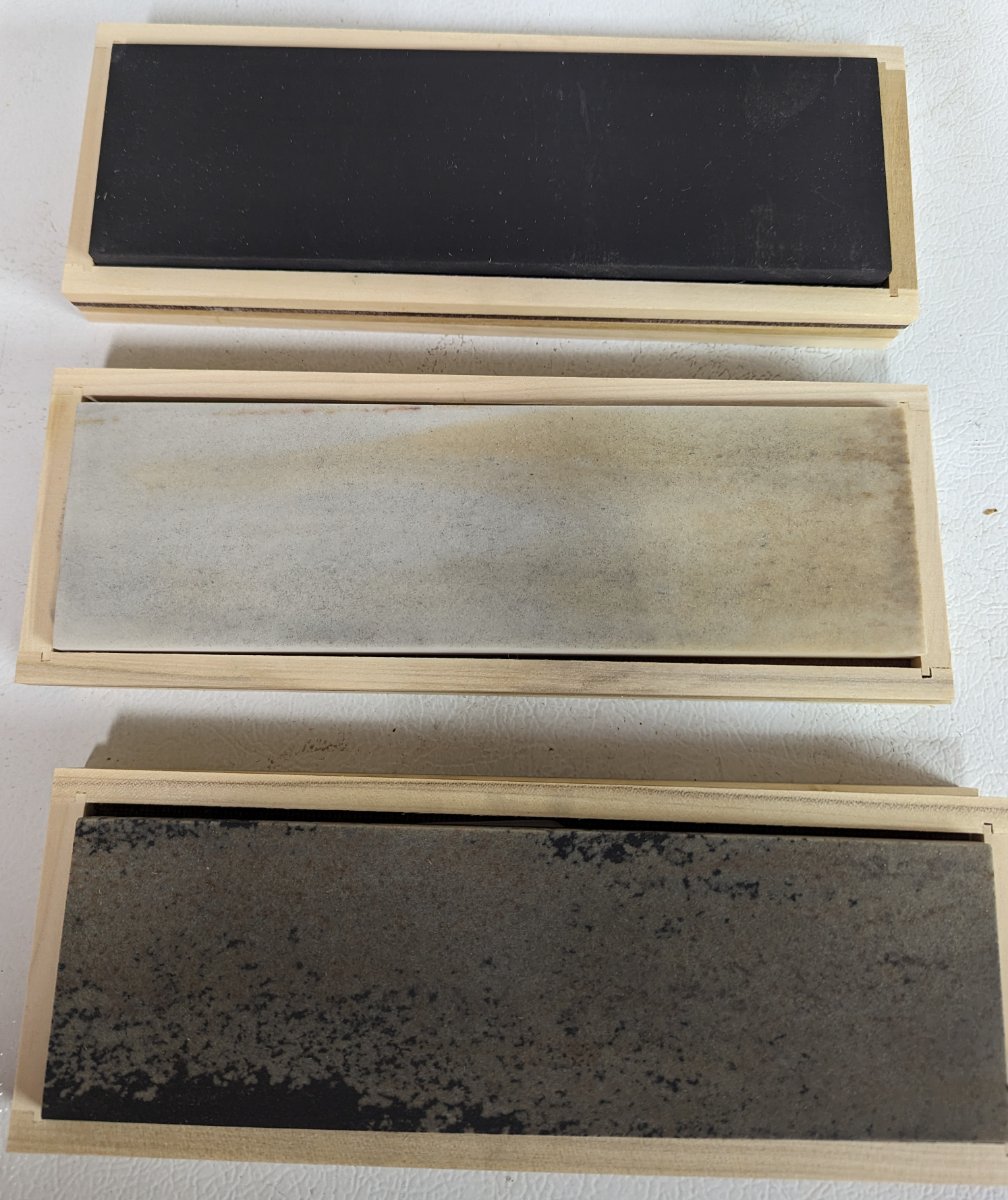

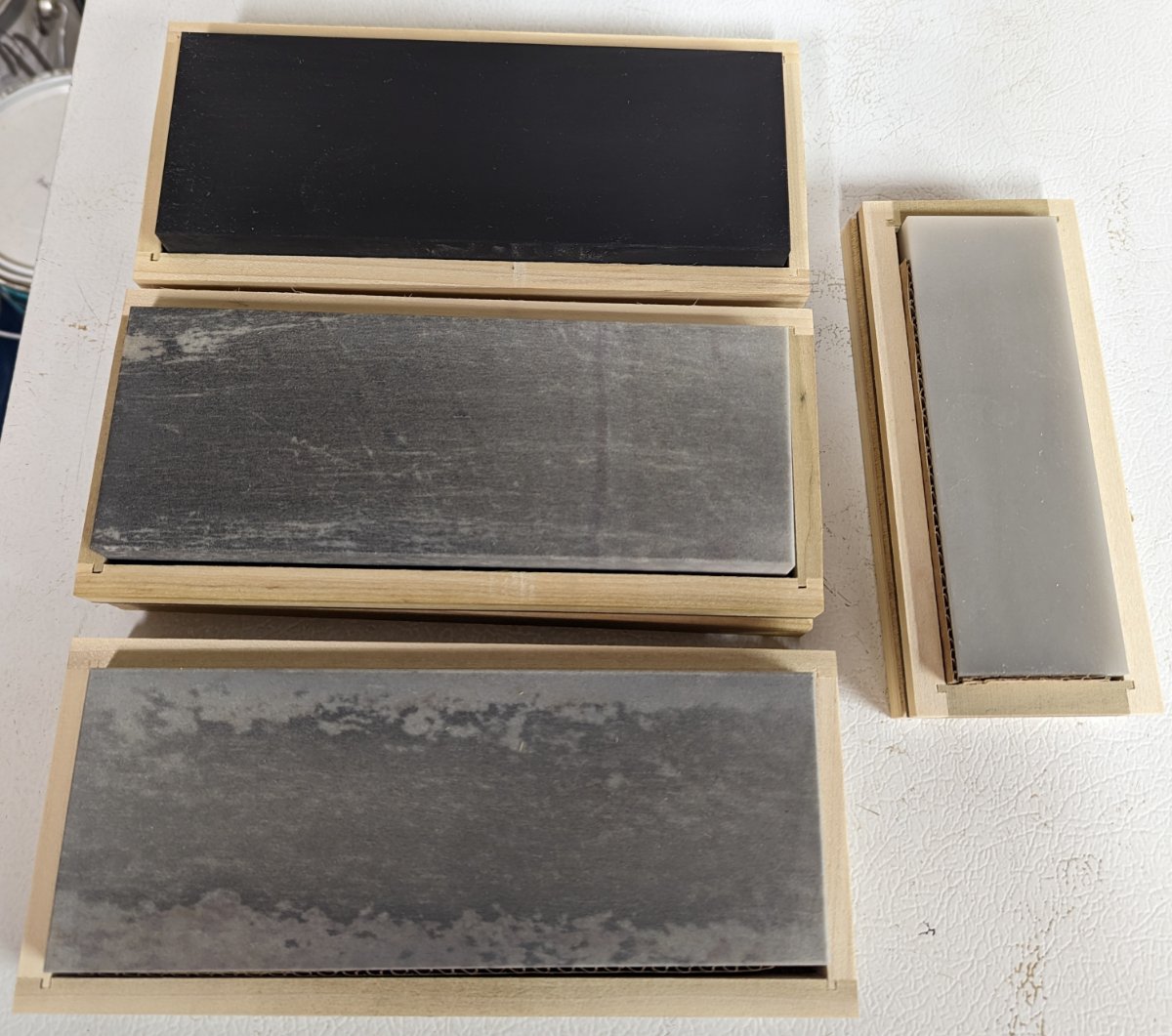

To get a feel for how some other stones look, consider this (top to bottom) Surgical Black, hard, and Soft Arkansas stone from Best Arkansas Stones. These all look different.

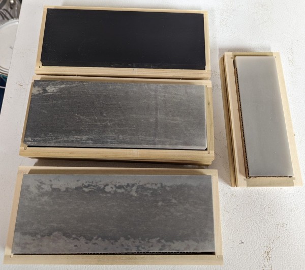

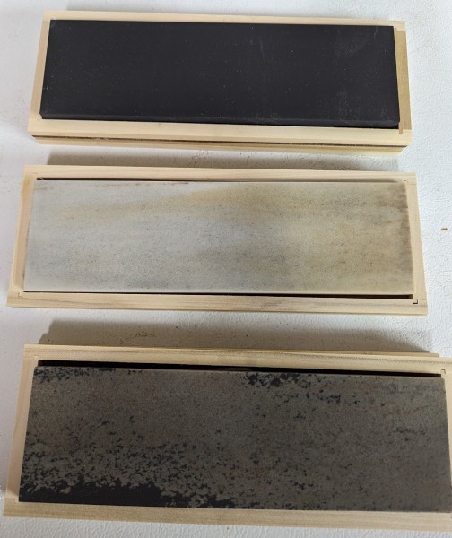

Now my stones from Dan's Whetstones; they have my favorite Arkansas stones.
Top to bottom I think I have Black, Hard, and Soft. The stone on the right is a translucent. I did not include a picture of their True hard stone which is supposed to sit between Black and Translucent. Note that you can shine a light through the translucent.
There are actual standards based on the Specific Gravity (think how dense is this stone) to categorize an Arkansas stone. Each company seems to have different names for their different stones and where they rank.
Dans ranks their stones Soft, Hard, True Hard, Translucent, and Black.
Preyda ranks their stones Soft, Hard, hard Black, Translucent, Surgical Black.
Best ranks their stones Soft, hard, Black Surgical, and then Translucent.
Best claims that although their Translucent stone has a lower specific gravity than their Black stone, that it produces a finer edge.
Enough for now and I will resist the idea of posting more stone pictures.

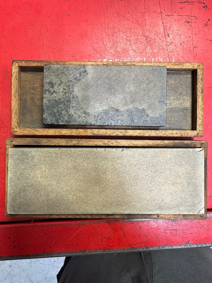

I bought these stones at a garage sale a while back. The larger white one in the wood box I believe to be a Washita. The smaller in the lid I believe is a soft Arkansas. What’s your opinion?

The larger white one sure looks like a Washita to me.
The smaller one could be Soft or hard.
Note that you can probably go directly to hard from a Washita with no problem.

You have quite a collection of stones, Pitonyak. Thanks for posting them. I like the labels on some of those old stones.
Wade, smaller stone looks just like a couple of my soft Arkansas stones. The larger one is hard to say from the photo, for me.

Dinadan wrote: Fri Aug 04, 2023 1:27 am You have quite a collection of stones, Pitonyak. Thanks for posting them. I like the labels on some of those old stones.
Yeah, I love those old labels. The problem is with those old labels I do not want to use the stones :mrgreen:
