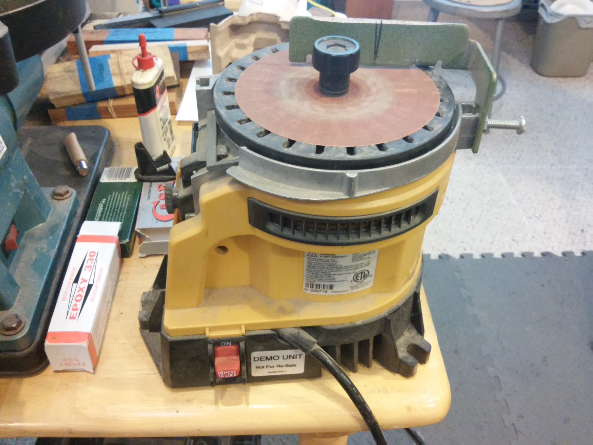

Wow, everyone has a nice looking shop! I got some new equipment this week. A cabled rotary tool with foot pedal control. Variable speed too. Both hands are free to work with. I have a cable attachment for my Dremel workstation but this is better!
Has a real drill chuck instead of the system used by Dremel.
And I discovered that I can plug my first gen Work Sharp into the pedal and now I have slow enough speeds that it has become very versatile.
Good tool so far.
Got it on eBay. $60.00 shipped!

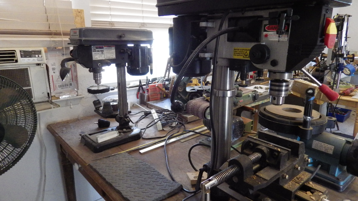

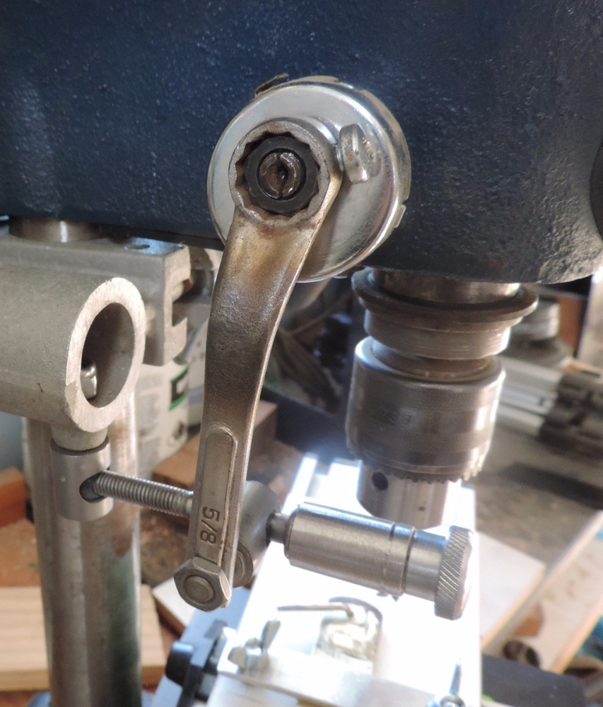

Also I wanted to start relieving the area of the scales where the tang rotates. I don’t have a Mill or access to one so again to ‘that auction’ site for a small east/west vice $40 shipped out of China. Some other bits & bobs out of my handy shed pile and a basic drill-press becomes a rudimentary mill. I still have a few minor adjustments to make but the test-runs are going well.
Edit ... I should have added the Chuck is pinned to the Drill press shaft to prevent it shaking loose.

Nice set up Derek! The tools in my shop are all re-purposed. I have one drill press that a dedicated buffer as I dont have a bench mount buffer. I like it better as the speeds are slower and I have a choice of speeds. I like the way you set up your shop Derek!

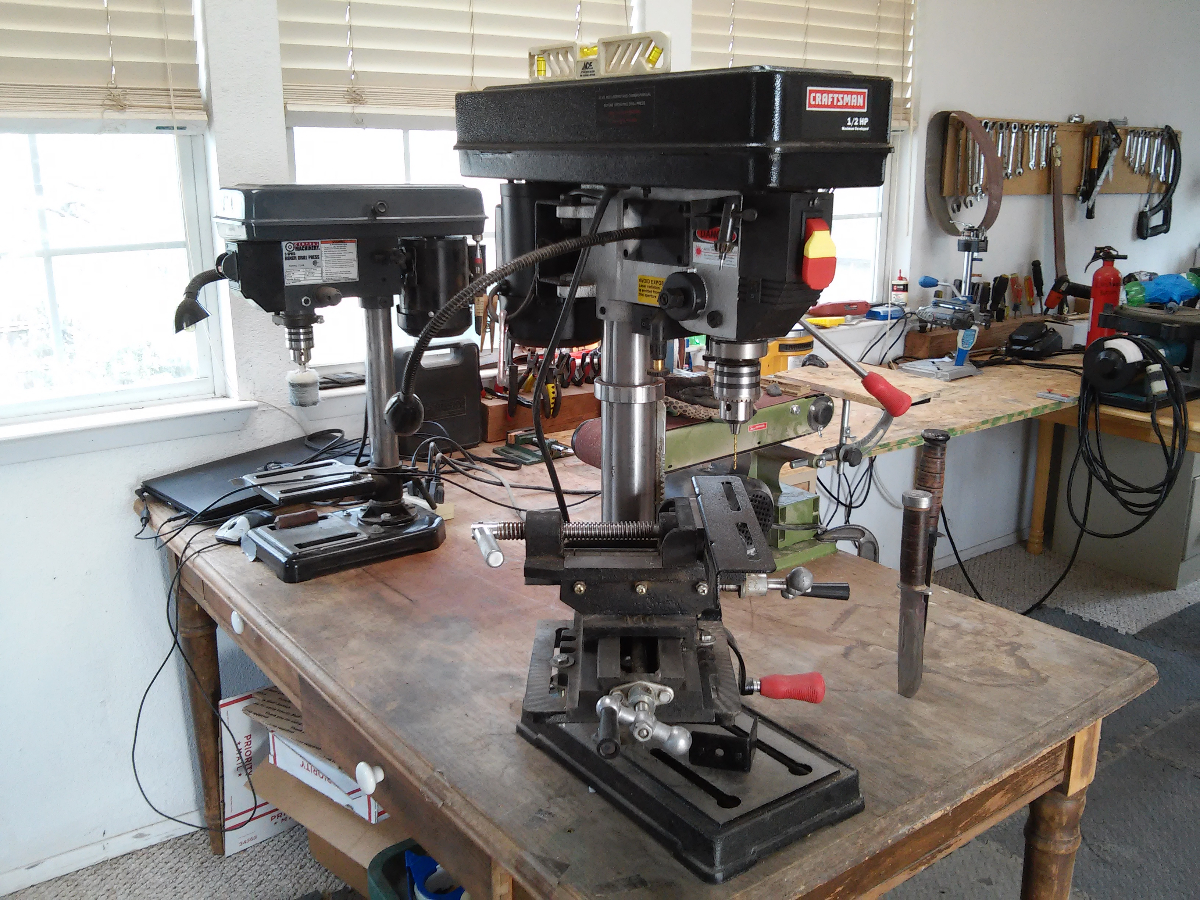

Well I decided to spend a few days arranging shop to make it easier to get to things since my my neck was bothering me too much to work on knives.
Here are some earlier pics from I first set things up about a year ago.
It seems I was always getting up to look for something. Along with a bad neck I have a screwed up lower back as well. Instead of unnecessary trips for sand paper or what not I arranged things so I reach what I need without getting too often.
The drilling and buffing stations are the same, just needed to be cleaned.
The Work Sharp, 1 inch belt sander, 4 inch belt sander and wet grinder are all located together. Makes the large grinding chores easier.
Sand paper, files, rotary grinder and accessories all together.

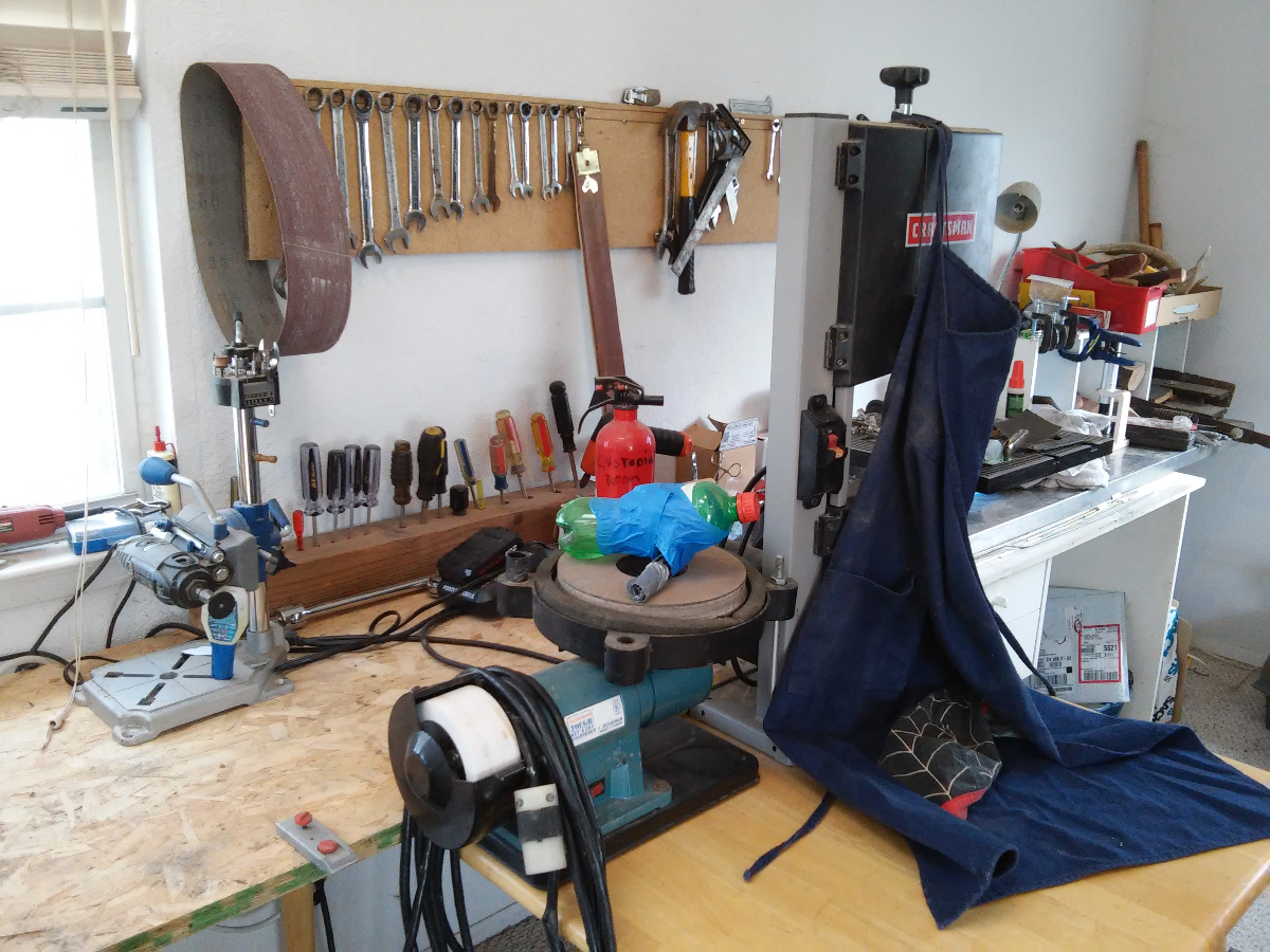

Breaking things up a little bit.
I have had a stainless work bench top so I though it would be a good time to use it. Besides a such a solid work surface makes things like cutting knives apart as well as pinning them back together easier.
This work surface gives less than just the 2 layers of plywood that I have been using.

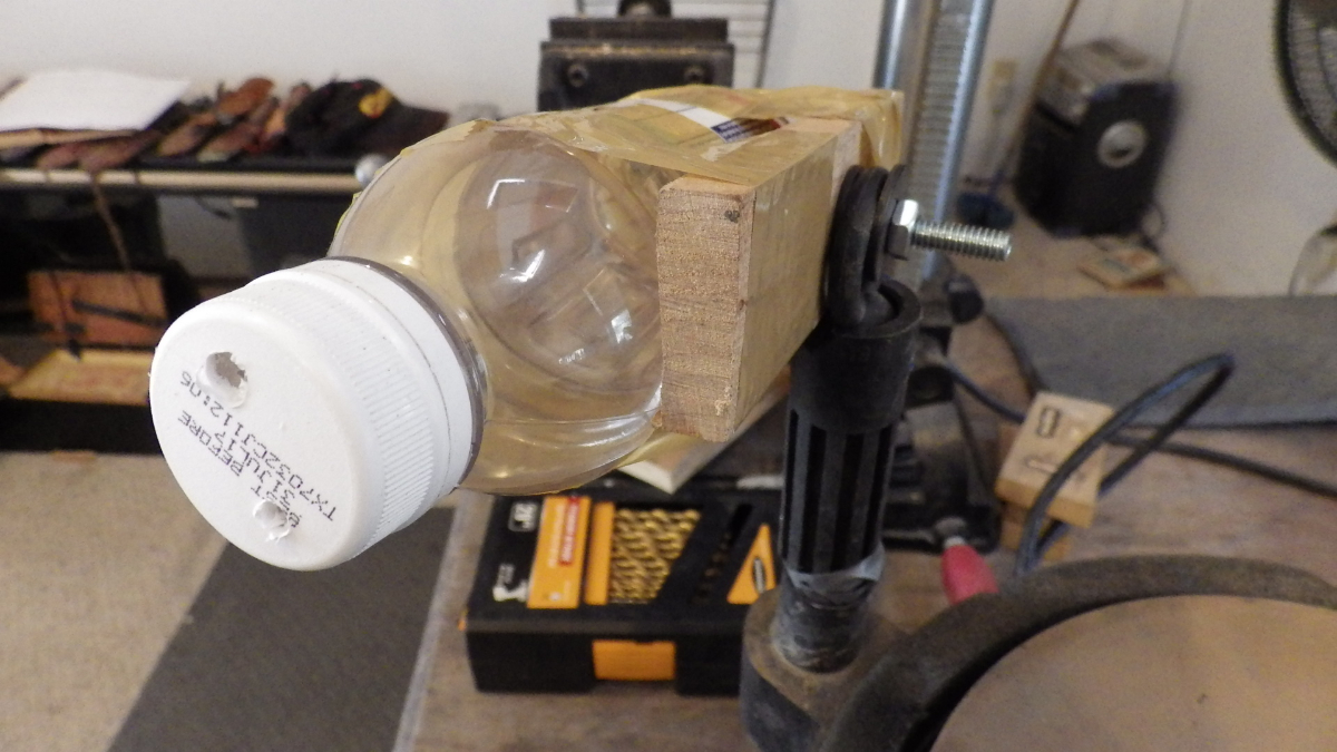

A friend of mine gave me a wet grinder some time back. It was missing the water tank and such so I had to rig this bottle to do the job. I drilled a hole in a block of wood and used a bolt to connect it to my "post" in order to tip it up for off. And tip it on its side to get the water flowing. Change the angle to control the flow. I made two holes in the bottle cap. One for water to come out and one to let air in. Gets the job done cheap!
Well its time to get back to working on those small Colonial lock backs. But now I don't have to hunt for all the things I might need to take a knife apart. Or put one back together!

Posted: Fri Aug 25, 2017 8:00 am
by Brumbydownunder
That is just way too tidy to be 'normal'
Nice work space it would be a joy to work in ... I'm envious>

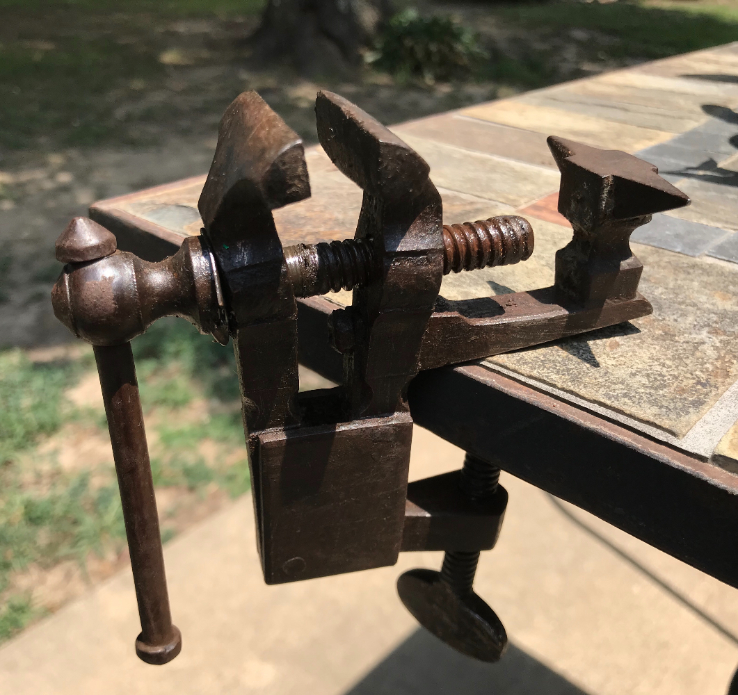

This thread needs a bump.
Received this small jewelers vise for Father’s Day.
Re: Shops, tools, materials and tips
Posted: Sun Jun 17, 2018 7:38 pm
by doglegg
Bumped it is. Nice little vice. Good for decoration as well as useful. I like the little built in anvil.
Posted: Tue Jun 19, 2018 5:15 am
by orvet
Great old vise Tony!
Is there a brand or any name on it?
